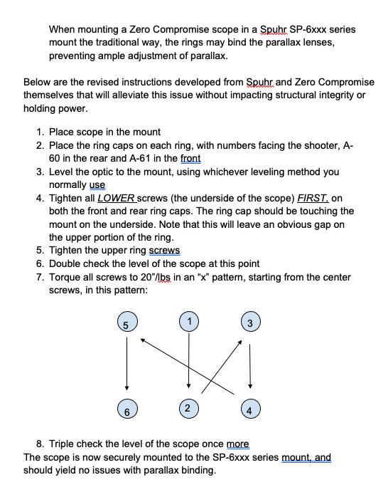

We sold HTI-416 his rifle and the scope along with a Spuhr mount back in May of this year. We mounted up the Spuhr mount according to the instructions from Spuhr, keeping an equal gap on both sides of the ring cap. Torquing everything to spec. Recently those specs changed (months after we sold this scope). Now mounting a ZCO in a Spuhr, you are now to tighten the bottom ring cap to where it touches the scope mount. The scope ring caps are then tightened to 20 in lbs in an X pattern, not the previously specified 25 in lbs.
Below are the Spuhr mounting instructions for anyone who is curious.

Did you mount the Spuhr to the rifle or just the ZCO to the Spuhr?
I ordered the ZCO mount as recommended for the replacement optic, followed the mounting instructions I received on the phone right down to 18 inch lbs and 20 inch lbs on the ring screws, even spacing with no metal to metal on the ZCO mount and there was no change to the results.. In fact the results were worse than the first scope..
