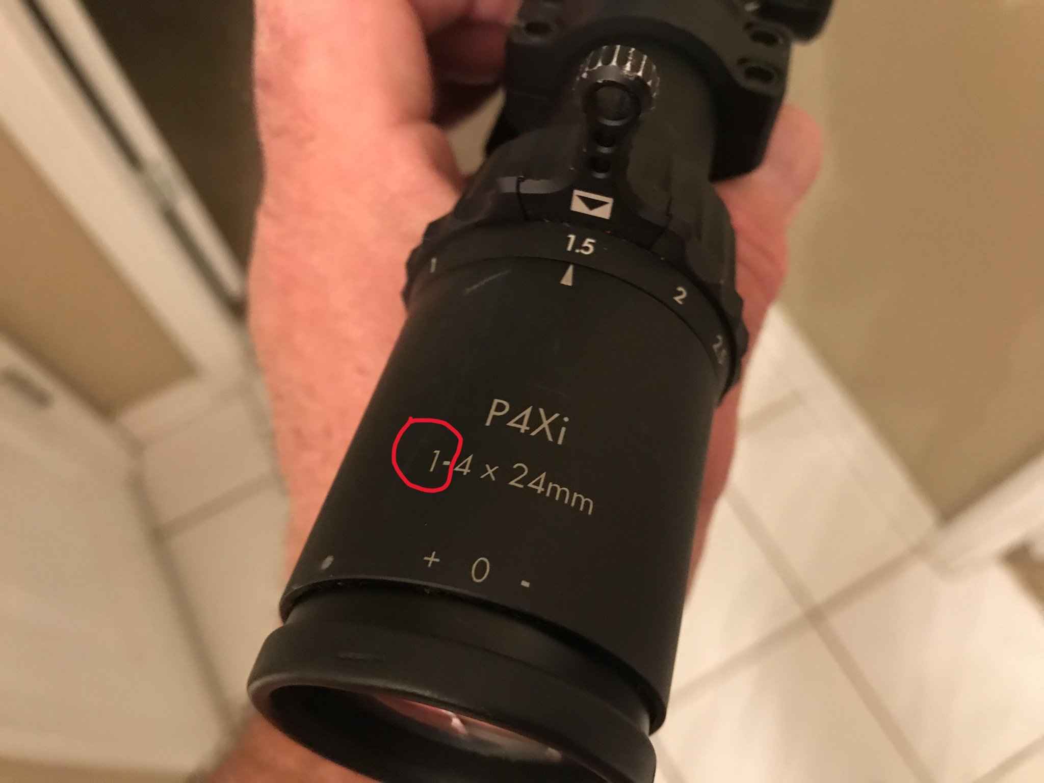

(And, FWIW, I also have a P4Xi 1-4 and have had one since they came out ~10 years ago, and it appears you're the dumb one as they don't really hold a candle to the speed and ease of use of a good red dot and you should know that.)

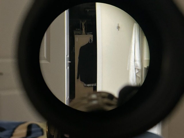

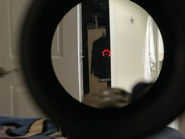

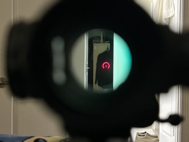

Really, I land on a red dot for one reason. It is always on.
Below are three pictures taken inside my home. I hung a black dress shirt in my closet, with the light off. The room adjacent to the closet (master bath) has its lights on. The bedroom is illuminated by a lamp. The “shot” is from the master bedroom, through the bathroom, into the closet.
I pulled 2 rifles for these pics. One has a LPVO; the other wears a red dot. The LPVO was off when it came out of the safe. The red dot was on.
LPVO, illumination off.
LPVO, illumination on.
Red dot, always on.
The closet is certainly sufficiently well lit to make a target ID, but without illumination the reticle is missing in action. The LPVO has a relatively short battery life and is stored off. The red dot has a ludicrously long battery life and is stored on.
Yes, it is only one more step, but it is one more step. And, this optic only requires a single click on the illum knob- in either direction- to be bright enough for indoors. But, it is not ready to go when I pick it up.

Your problem there is with a poorly designed ACSS reticle on that LPVO. If that LPVO had cross hairs that extend towards the edge of the view, you’d know exactly where you were aiming.
As for battery life, the Elcan spectre does have more than two months of constant on battery life set on a rather bright setting. It can get truly red dot right. There are also options like the Primary Arms Nova that will give you red dot brightness, a usable reticle with full length crosshairs, and a shake awake/“auto-live” option to extend battery life.

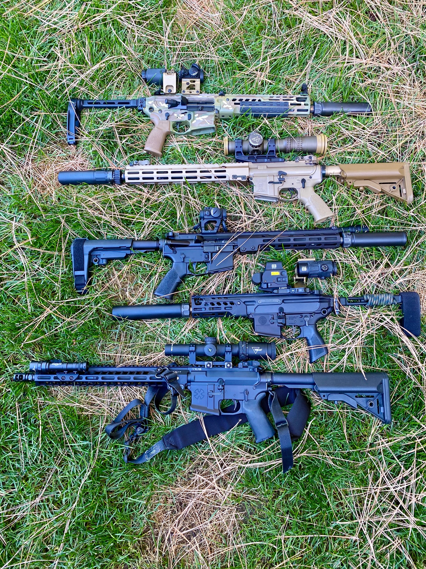

So you know I'm not pulling your collective legs, I am including a picture of some recent builds with optics I am enjoying. Note, that I have not put these through hard use, but I feel very confident in these optics setups.
Top, MCX with T2 on Unity mount and Scalar Works front iron. Aimpoint magnifier in Unity mount (I have not yet put any rounds on the magnifier. RC2 supressor (love it) if interested in my thoughts.
Geissele Super Duty 14.5" with ATACR 1-8 DMX reticle with Unity mount I believe (not sure I'm using this mount long term), heart this rifle, probably will be my GoTo for the coming end of civilization LOL. Troy irons. I've got a Griffin Explorr 224 with a B+T SF hub adapter, no miles on the supressor yet.
11.5" Super Duty with Scalar Works 1.93" and T2, Surefire light in the grass. Our bump in the night gun, RC3 supressor still to be fully tested. I have a set of Scalar Works 1.93" BUIS to install and zero. I have a magnifier for this, but I'm not sure I will install it for everyday use.
Sig Rattler 300 Blackout, going back to Sig due to light primer strikes. Truck Gun LOL (no one would leave this in their truck). Set up with the pictured EXPS two dot reticle on Unity Riser. I just put the 5X magnifier on there for the photo as a joke (EOTech 5X on Unity mount). Seems to be a pretty good 5X magnifier, but haven't had enough time on it. SF SOCOM 300 SPS supressor, unfired as of today.
Bottom; One of the Commiefornia guns I built with Trijicon Credo 1-6 Second Focal Plane w/BDC reticle. I have 2000+ rounds through this, so it did get some use. I do like this scope for it's clarity, utility and reasonable cost. I give it a thumbs up.
