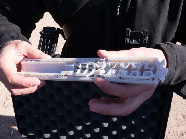

I looked at this at SHOT and didn't "get it" until I saw it in person.
Here’s a picture that explained it’s functionality for me.
The Flash Hider Muzzle Brake core that’s user replaceable for wear, caliber change, and multi weapon usage, is either a reflex design that surrounds the barrel (as pictured) or conventional end of barrel attachment (not pictured).
Gas is directed backwards along the outside of the Flash Hider Muzzle Brake core when it hits the three baffles near the end, and the surrounding Back Pressure Regulator shroud itself looks to have a sandwich of fins and is slotted at the rear, so the gas moves forward again and exits into the Signature (Sound?) Reduction Module.
The Signature Reduction Module itself has four baffles and is similarly vented to it’s shroud.

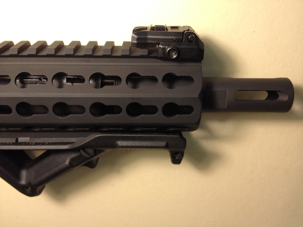

I went with a Griffin Armament RSTA reflex design suppressor on a 9" AAC MPW.
Here's a picture of it's FH with a MicroMOA Govenah AGB, so I can shut off the gas for a single shot with no back pressure, and an upgraded KAC URX 4 8.5" rail;
