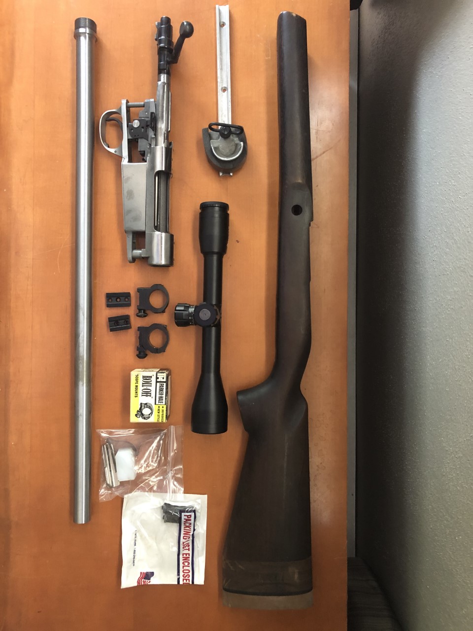

New old member here. I have been away from the Hide for about 10 years, and feel it's time to get back to some precision projects now that the kids are gone! I always wanted a Parker-Hale M82, but, they are un-obtanium, and when one pops up, they are super expensive. So, I have planned to build a "clone" for some time, so here goes. I found Old West Scrounger had M81 "cadet" stocks available. The profile is the same as the M82, but they are single shot, and use a different accessory rail. I bought a couple to play with. Pro's, they have the internal magazine outlined for in-letting and are beautiful Walnut stocks made by Parker Hale, with spacers and a recoil pad. Cons, as mentioned above, different accessory rail (Anschultz style versus the PH threaded rail), no internal magazine, and as they were single shot, large round recesses for excrussions. I plan to inlet the magazine well, and found a PH accessory rail for the Cadet stock, which will be , not quite right, but, is what it is. I started searching for a large ring commercial 98 action, and decided to use a Zestava action for the project. I found a good one in 30-06 on gunbroker, and pulled the trigger. A day later, three nos, in the white Santa Barbra actions came up for sale. Santa Barbra produced the commercial actions for PH. To much to resist, bought one. I also scrounged a set of PH 22 and 28 scope bases, and found two brand new RAHS3 scope rings in 1 inch. I plan to go with a 10 power fixed Bushnell 1 inch scope. The M82 used the RALS3, but the high rings will work with my scope. I sent the Santa Barbra action to my smith, who advised me it was actually a magnum action, and would need the bolt face welded up if I was going to run .308 through it. As I also had the Zastava action, I had him swap bolts, true the lugs and bolt face, and she will work fine for .308. This leaves me with the Zastava machined action, which now has a magnum bolt in it. Next build, .404 Jeffery Safari rifle... Last is the barrel. I had McGowan Precision build a 26 inch 1-12 twist on the M82/1200TX profile. Barrel arrived, and is a thing of beauty. Time to put all of this stuff together into a rifle.
Where did you find the PH rings? I’m after a set of RCH4s but they seem rather than rocking horse s***!
Ebay stalking. They pop up now and then. I found the RAHS new in the box, had probably been sitting on a shelf somewhere since the 70's. I found a second set a couple weeks later. The box is actually a small work of art. No bubble packs, inked cardboard. "Another fine aid from Parker-Hale"!

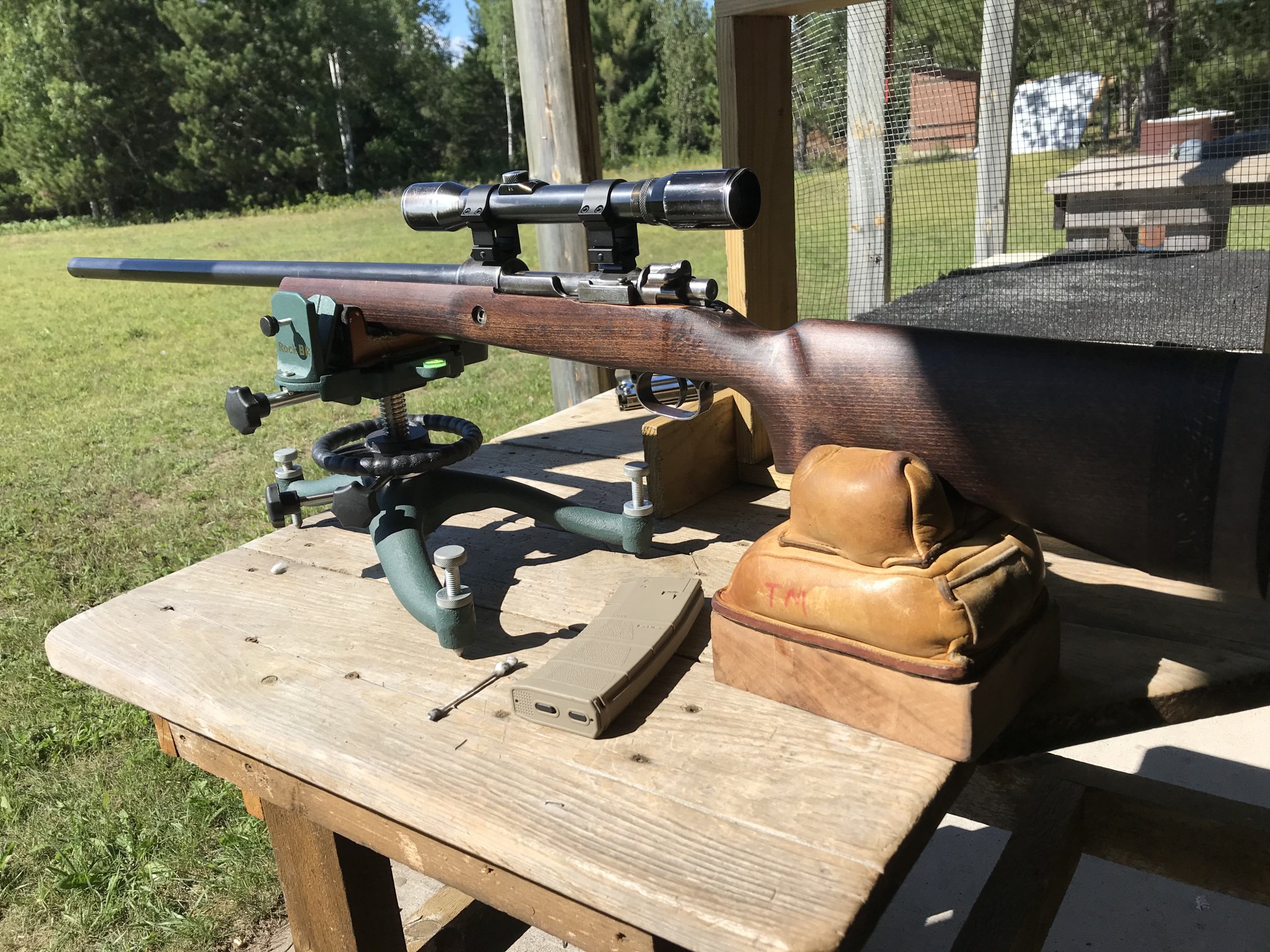

I did like you did and started with the M81 cadet stock. My action is a ...can’t remember right now... I’m at the beer tasting room, M98 of some kind with the crest ground off. Cork Soakers! I got it cheap, but the barrel is a Parker Hale. You might see the profile in the barrel in the sunshine shot.
Anyhow, it looks mid-fifties to mid seventies. The scope is a Unertl 4X Hawk. Not used for military that I know of but it looks that way. It looks all snipery, but in truth it’s an “across the decades” idea of a useful sniper rifle of days gone by, but past WWII.

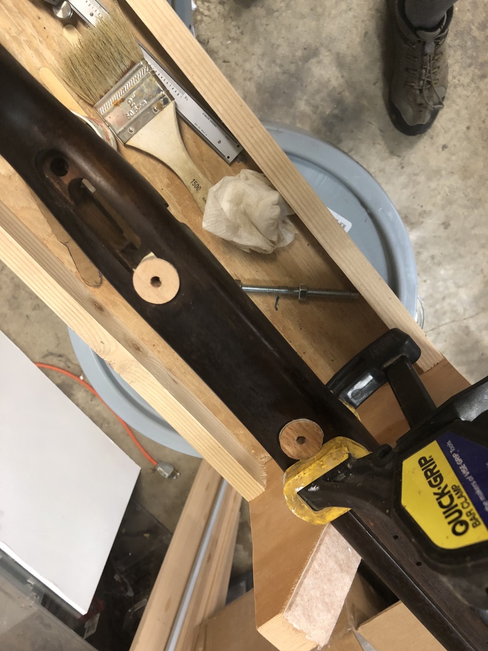

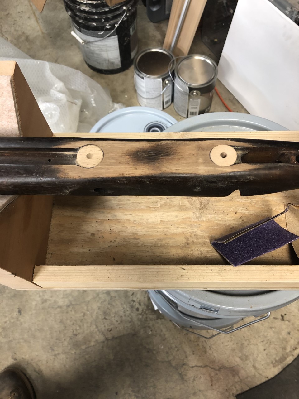

Does your stock have the circle inletted where the bottom metal would overlap the rail?
I didn’t quite know what to do with that. I think I’ll dig the bedding out there and see if I can’t carve some half-disks to fill that.
And, get a template to inlet he bottom. I’ve gotta add filler. Different shape on one side of the bottom metal to the other. PITA inletting if your action is not a SB. All the stupid little corners and what not are different than the basic Ph inlet.
That was my second step. I got my action inletted, and sent the barrel and receiver off today to have the barrel installed. The big circles presented a little head scratching, but I decided to find a hole saw with the ID close to the escrution holes. I pulled the spacers off the but, as they are made of similar wood, and cut a couple plugs out of the middle. Mixed up some wood glue and left over sawdust, and glued them in. Filed and sanded them down, and now it is time to cut in the magazine. My action was not a drop in, unfortunately. I had to take out quite a bit of the stupid little corners to make way for bedding compound. The action set up pretty high in the stock, but looks better now.

View attachment 7388347View attachment 7388346
Also, as what you can see, this birch stained to look like dark walnut. I suggest getting the darkest walnut (added: stain) you can, as a 'natural' that I didn't have on hand, left the stained wood very light.

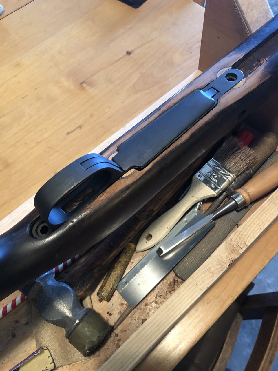

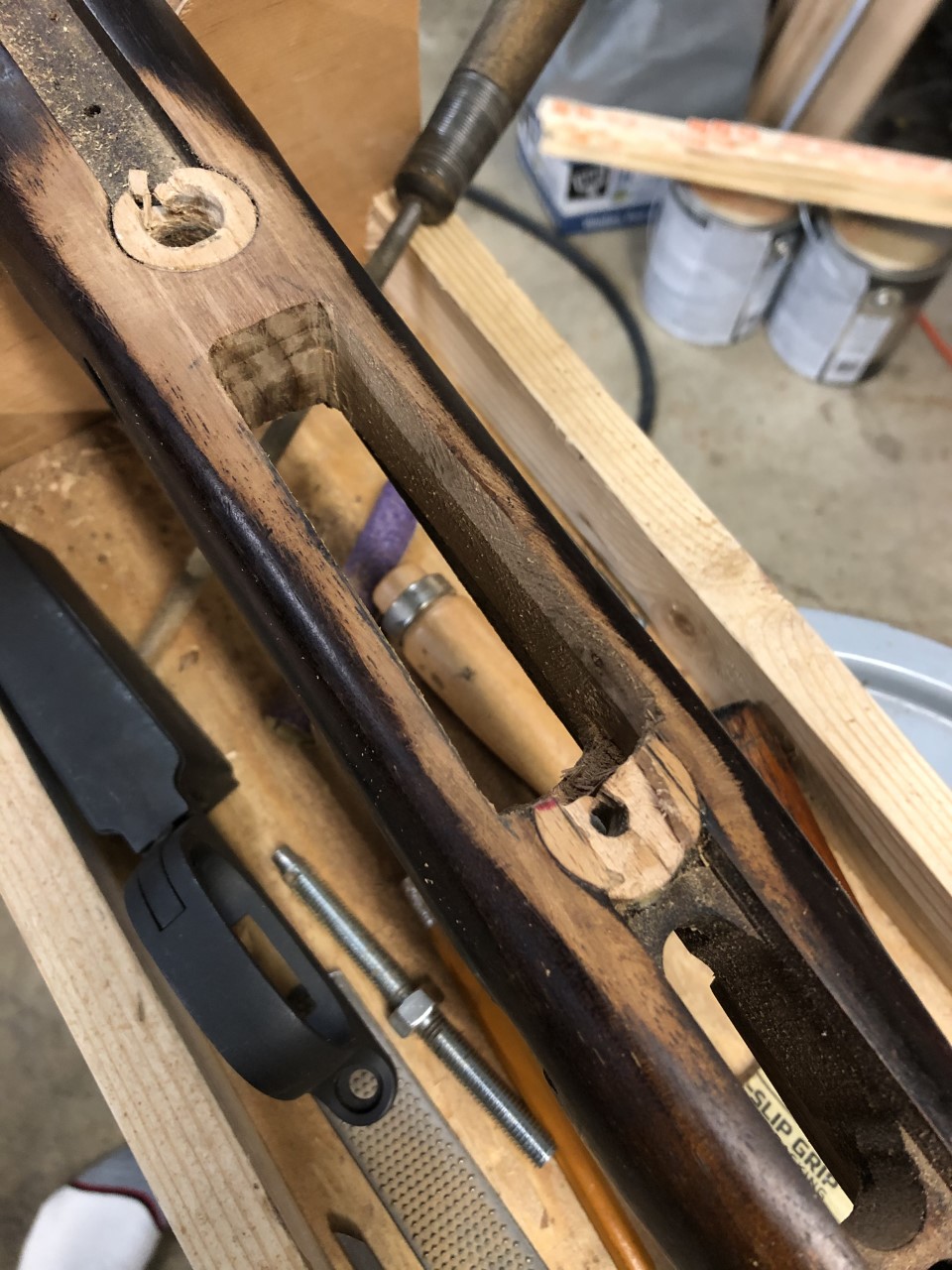

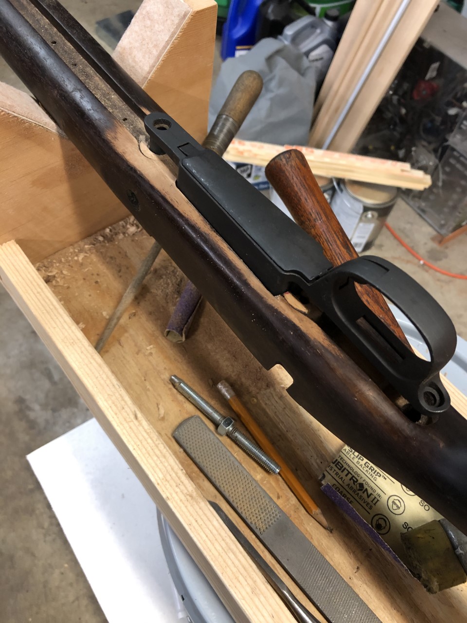

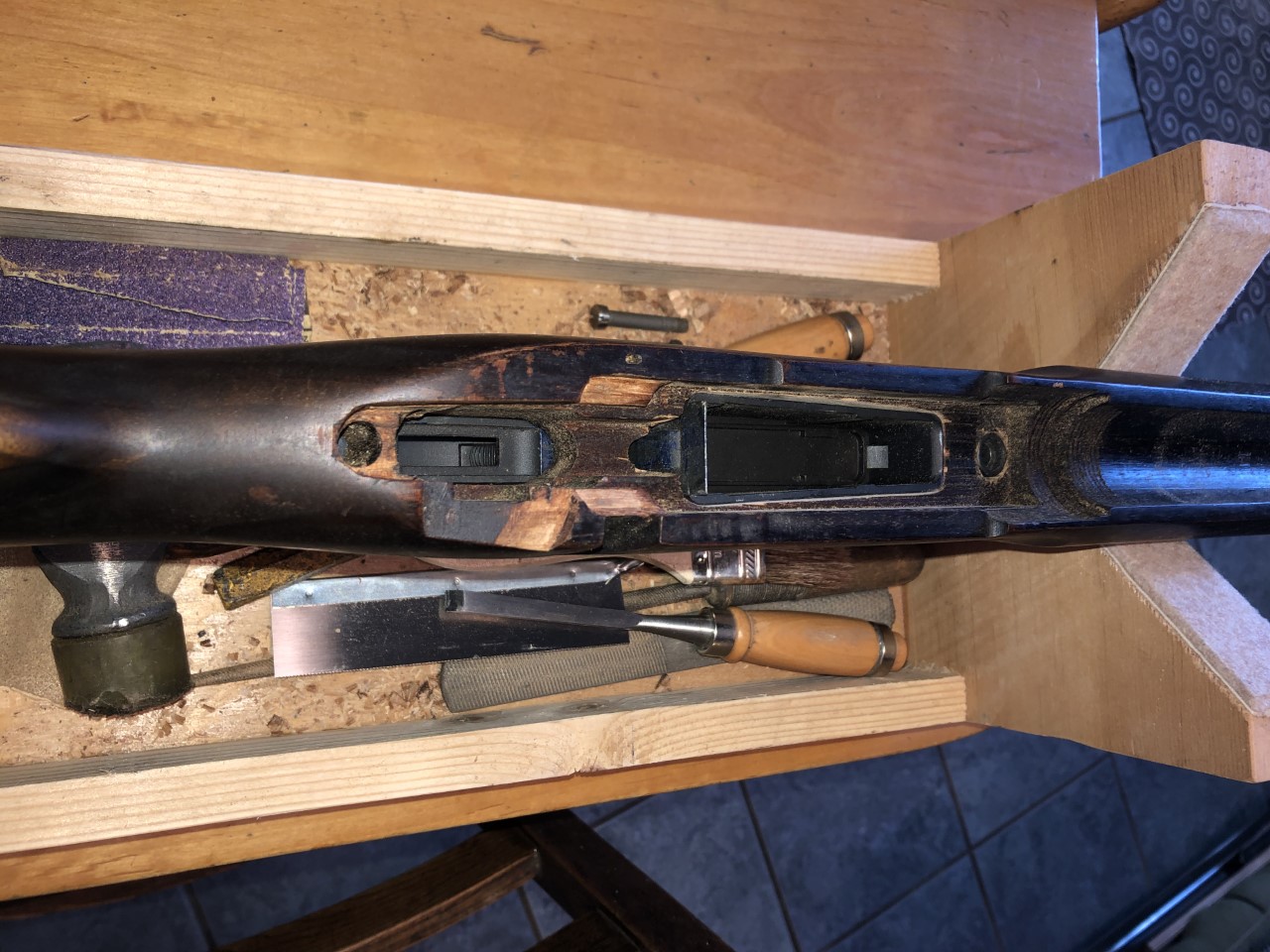

Magazine starting to sink into the stock. I drilled out the bulk of the material to be removed, then took it down close to my scribe marks with a router. The rest of the work is with files and chisels. Working at a snails pace, as I don't want to screw it up. Wood glue was a poor choice to secure my plugs. They popped out. Put them back with epoxy. View attachment 7391694View attachment 7391698
I love the hoof trimmer rasp! They come in "handy handy" when you gotta remove a big face like the side of a magazine box and you've still got an 8th" to go. :rolleyes: :rolleyes:
Magazine is pretty much in. Waiting now for the barreled action to come back, and finish the in-letting and bed it. I might need to sink the magazine a tiny bit more, depending on what my magazine to action gap looks like. The rear tang of the of the trigger guard is quite a ways below the level of the stock, so I think I will thin the bottom of the pistol grip a bit to make it look smoother. My plugs popped out for a second time. Epoxy was also a poor choice. JB weld for the win.
I'm glad you're taking pics of this. I was having fits with the gaps, then realizing they were gonna be there no matter what because my action and bottom metal were not the same shape. I still have to fill them in, but got all wound up and had to go shoot it!
Added: The Gorilla wood glue was my ticket. I did bed the rifle with JB Weld. 😜

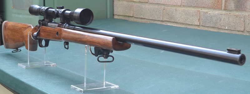

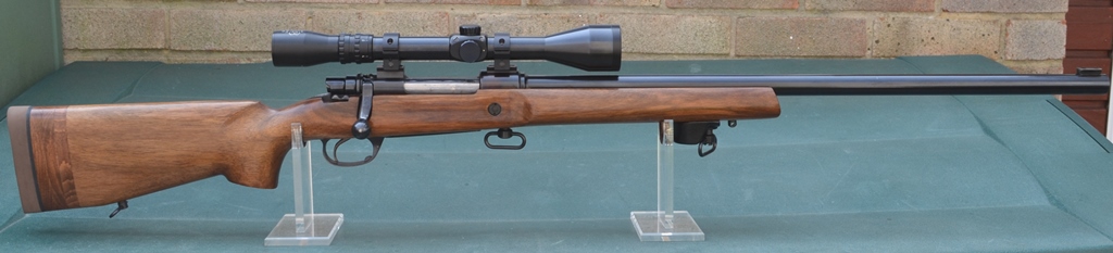

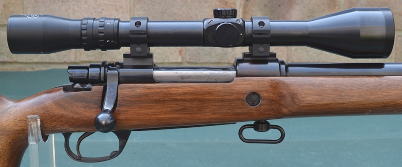

Based on the decent color pic I have in a book re an M82, I'm pretty sure it has a polished, blued bolt, but the Mauser-style extractor is 'in the white'. The receiver itself and barrel appear to be a dark parkerizing or black oxide type finish (flat black/dark grey is how I would describe it). Swivels look blued. That's my opinion fwiw, but I have never handled an M82.
ON EDIT: I stand corrected, based on these high quality pics: bolt, receiver and barrel, etc are all clearly polished and blued - at least on the TX1200 Model . (Note: This example is a civilian TX1200 target rifle converted into an M82 configuration- but I would guess that a military-ordered sniper version of the M82 could have been parkerized finish?). Excellent article on this rifle: Good profile pics (also attached)

I have been using that Thames Valley gun as a model for mine, it is a good write up. From what I can tell, the 1200 TX was blued. Some of the M82's were blued, and some parkerized. When they went in for service, it appears some were enameled black. I'm thinking Armors Black from Cerakote, and maybe lighten it a bit with sniper grey. With most hand made guns, there really seemed to be no set standard....
That’s a thing of beauty, thanks for chronicling your build It looks great. Love how you got a modern match barrel blank turned to the correct PH profile, lots of guys don’t get that level of detail. Awesome. The stock work looks great as well. My introduction to target rifle shooting was as an Army Cadet in Canada as a 16 year old back in the early 80’s. I went on a summer course where all we did was shoot every day on a military 1000 yard range on Vancouver Island. We shot traditional 308 target rifles all day, coached by experienced civilian shooters.
