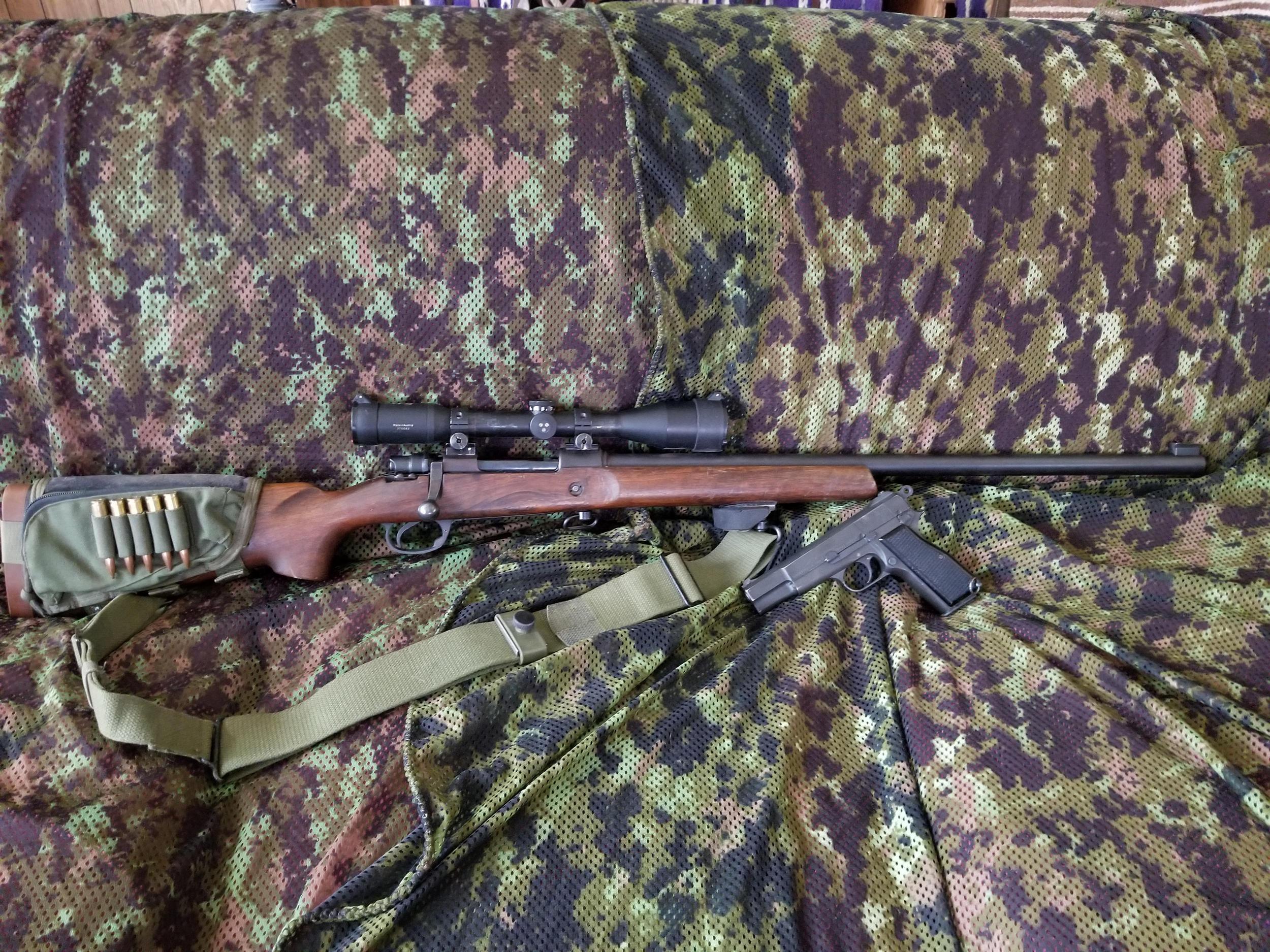

This Kahles-Helia-Scope: nothing is wrong with it IMHO ;)🙃 See this mentioned above as a canadian equipment.

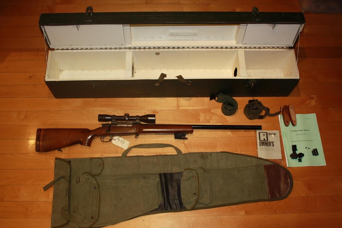

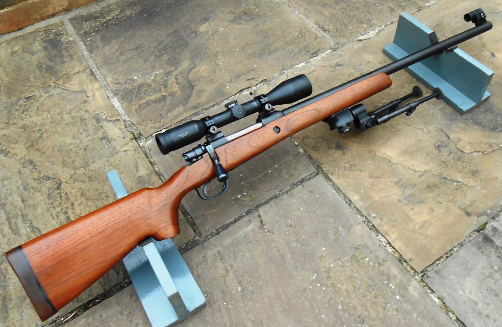

Good to see we are still going on this post. I am ready to start M82 part 2. Just picked up a minty ZF69, but looking for a set of 26mm rings. I have several sets of 1 inch lows, but no 26's. This one should be more correct than the last one, as it will have an original barrel, rail and scope.
What about the progress here ;) in the meantime, please ?...

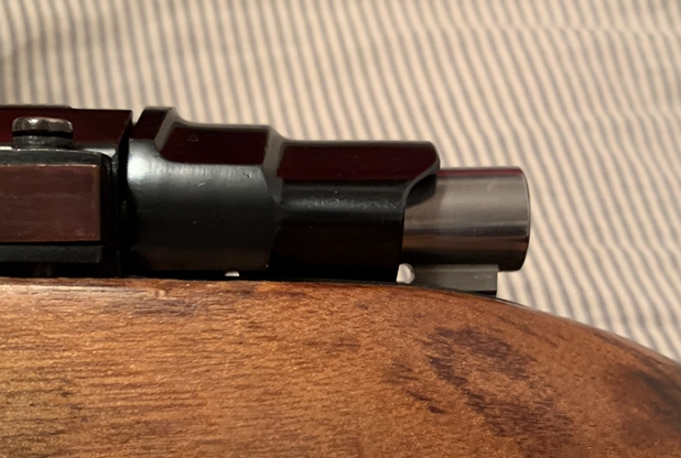

Would someone mind putting a up a picture of the safety and bolt shroud on their rifle or an original? I understand this rifle has a different safety than typical Mauser rifles do. I was hoping to get a good look at one. I think the action I’m thinking of using has a safety that’s pretty close.
Basically, I want to get a rifle put together, even if it isn’t a perfect clone. I figure I can always “upgrade” to more correct parts if I find them later.
I had planned to use a Pecar 4-10 before I got my ZF69. The far more common 1” rings can be opened up to 26mm depending on your final scope selection. The correct rings are RALS4 if using a ZF69. The bolt shroud is a run of the mill commercial variant, and a flat bottomed cocking piece is used. I’ve attached a picture of what the trigger assembly looks like. You will sometimes see them with golden triggers, but you want it blackened. Easy fix.

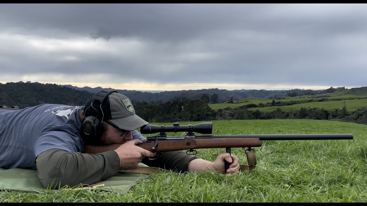

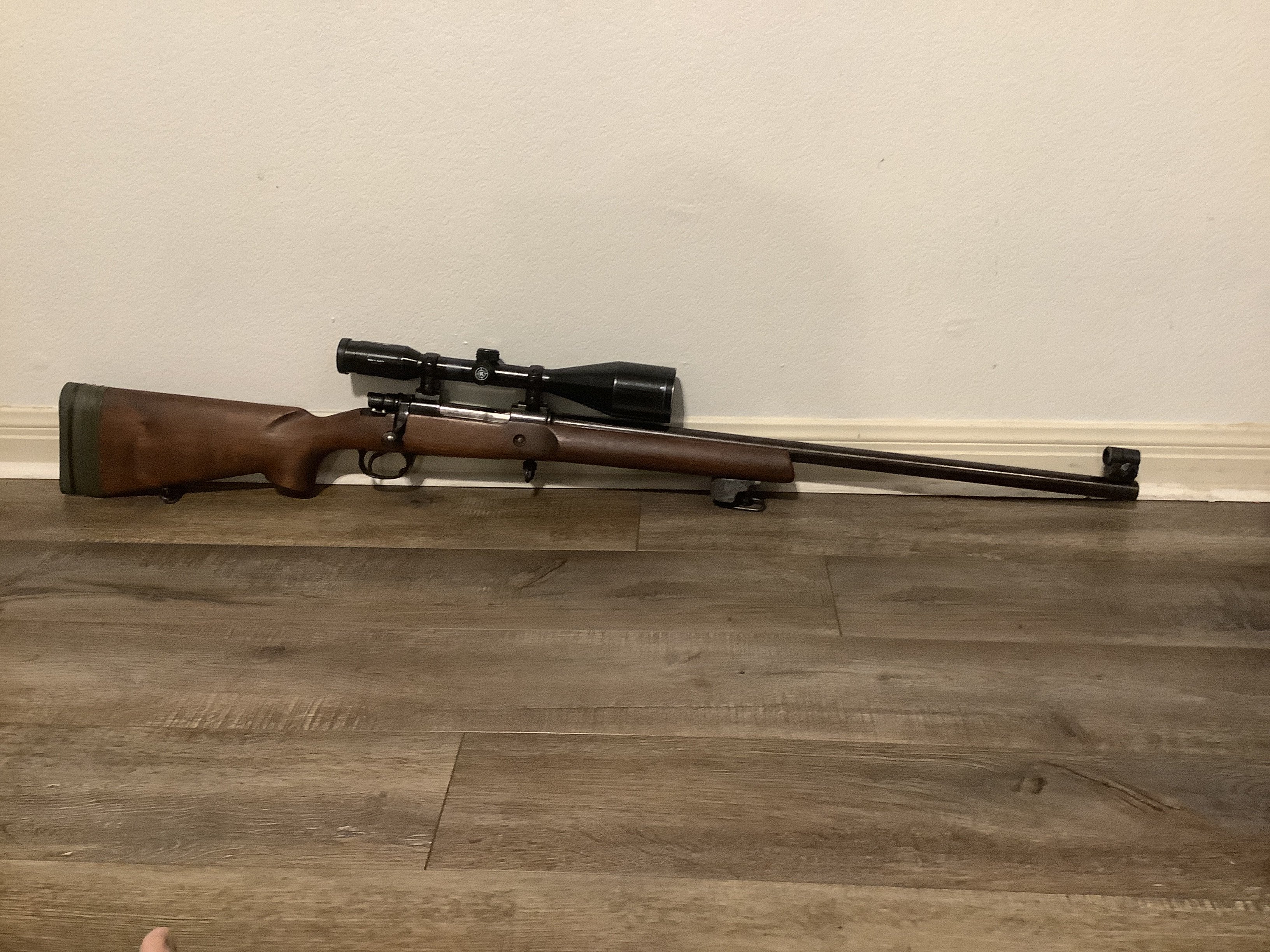

Well now there is a story to this, so in my infinite wisdom I decided I did not like .308 and changed to a Match Krieger barrel and chambered in MATCH 6.5-284 Norma. I have not had time to take to the range yet, will update. I kept the original Parker Hale barrel so if I ever decide to switch it back I can.
So I had a great range day with the rifle. Shooting 142gr ELD match rounds at 2850fps I was achieving one beautiful hole at 100 yards. We then switched up to shooting a 12" gong at 500y, it was effortless. Just a pleasure to shoot all day long...
