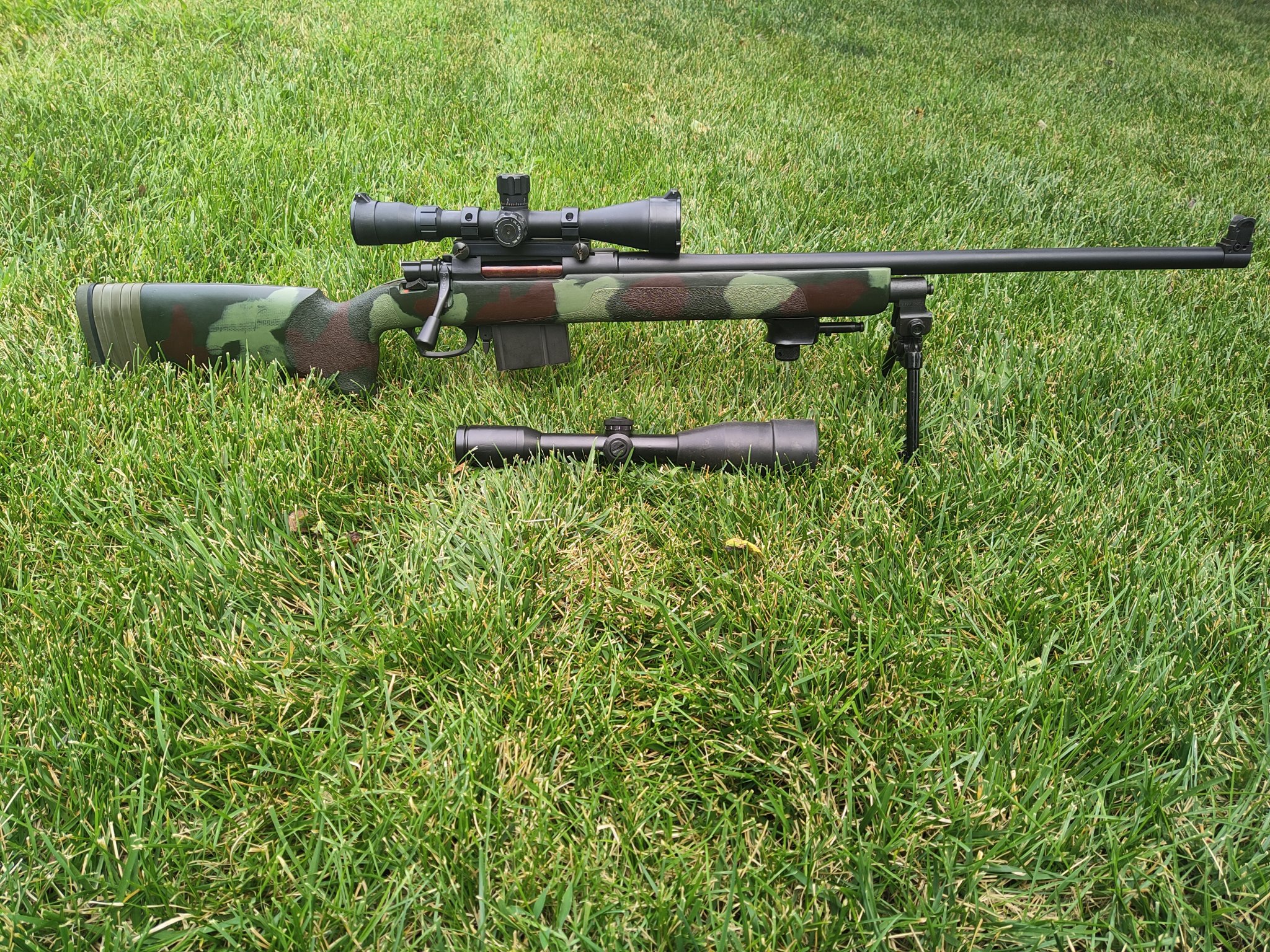

Not a problem on the digression. History on these rifles is fascinating. Nice to hear from people who shot the real McCoy. I finally got out to the range and started breaking in the barrel. Site in was pretty straight forward, and she seemed to be grouping well on hunting ammo, which I'm using for break in. I haven't run any match through it yet, try to get back out to the range now the 5 feet of snow is melting off.

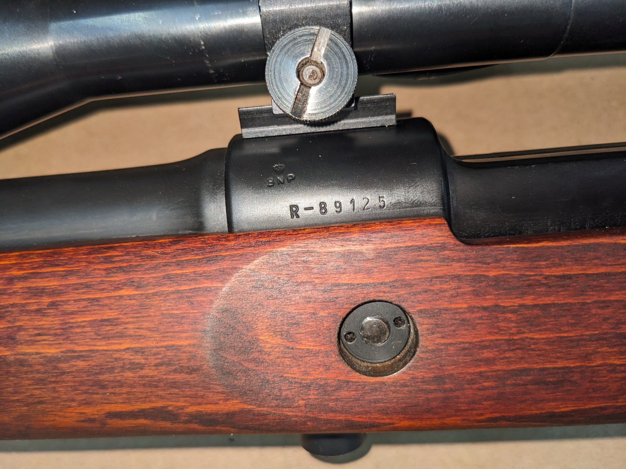

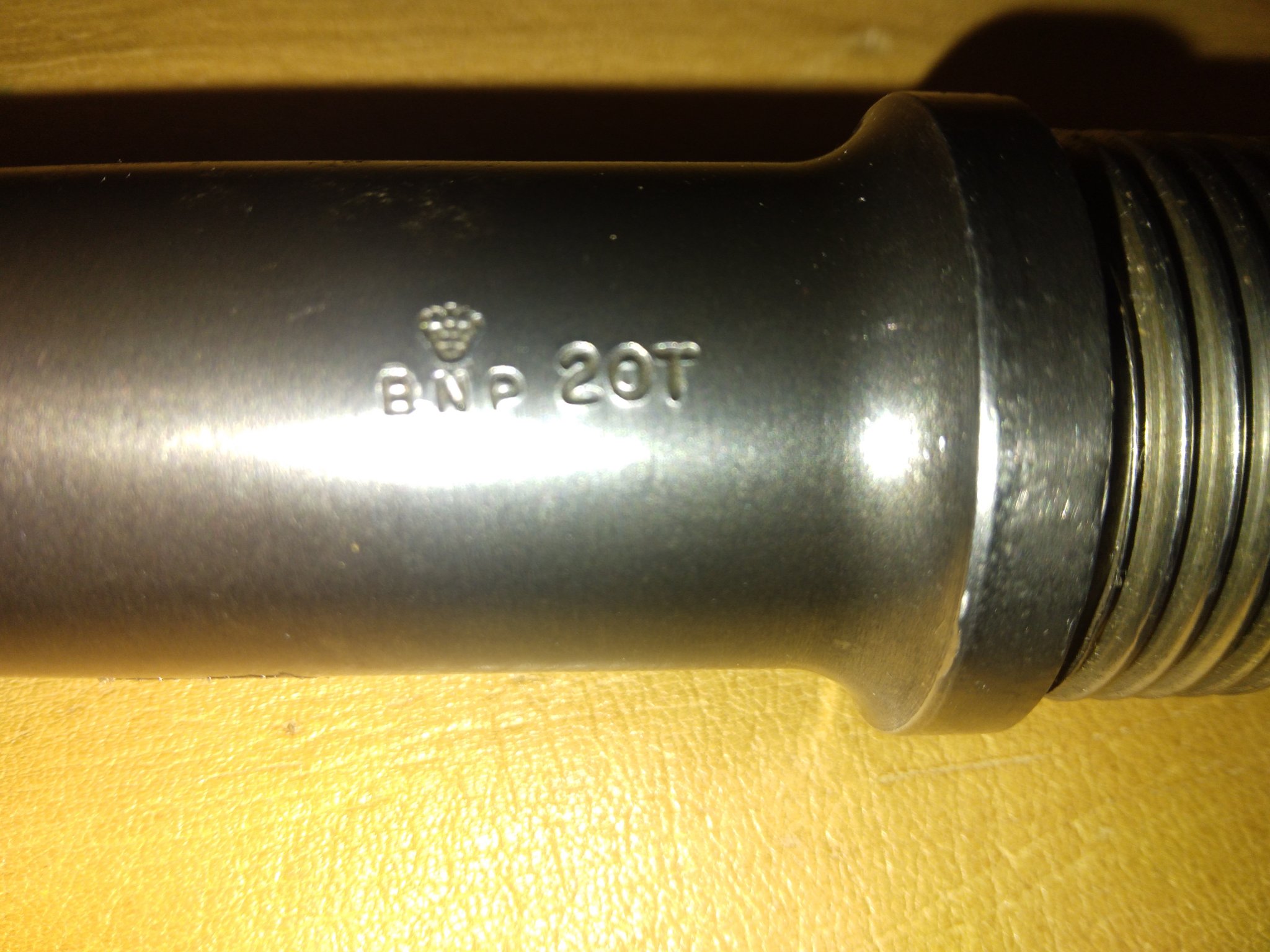

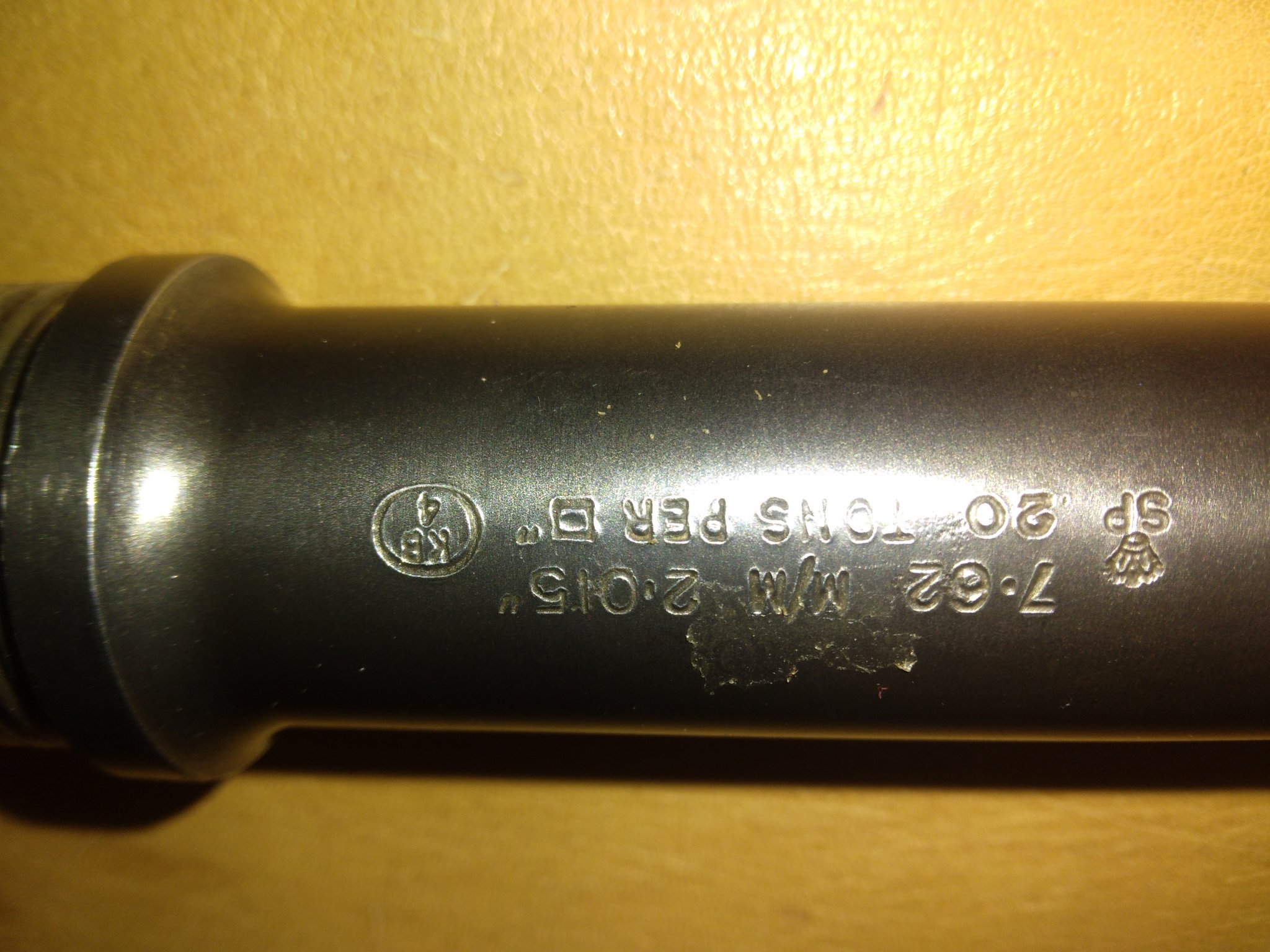

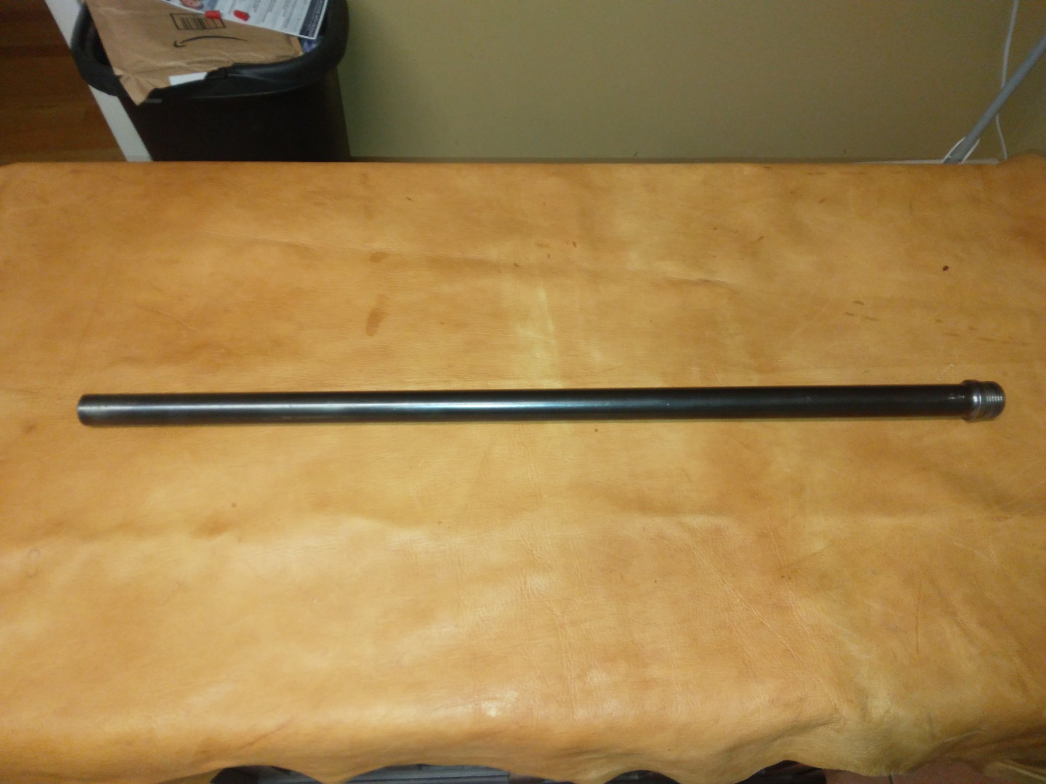

Wondering if you help me out identifying a couple of barrels that I won at an online estate sale. I think they may be M82 barrels...
I have a 26" heavy barel. 7.62 Mint bore. Had some surface rust pitting but not too bad. Drilled for front sight base.
Here are some pics of the markings.

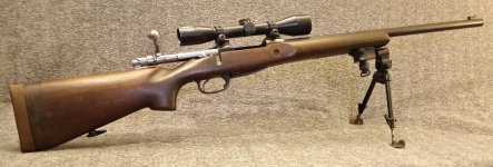

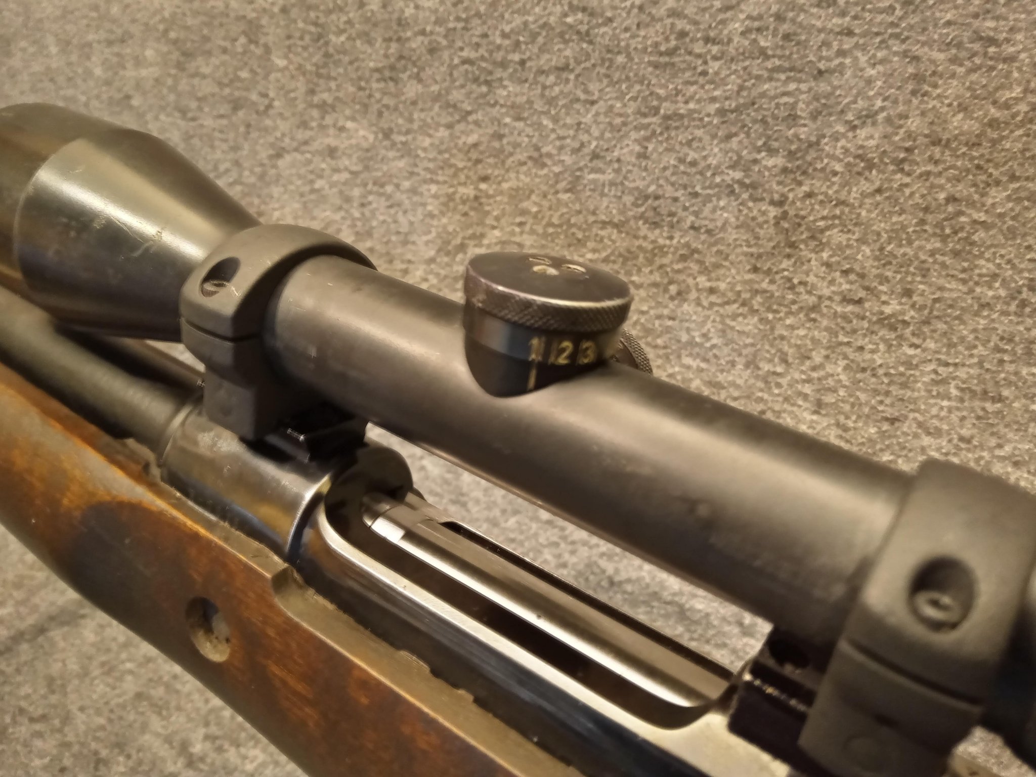

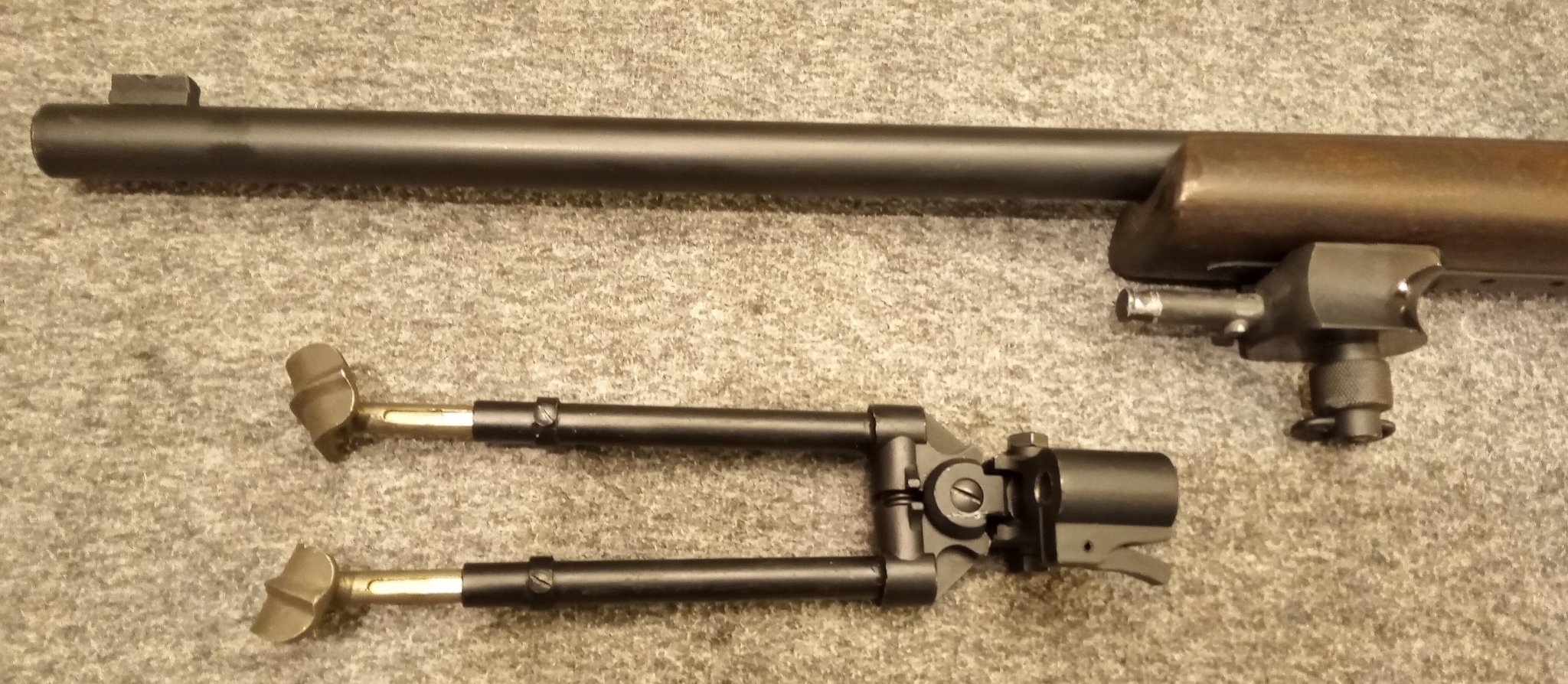

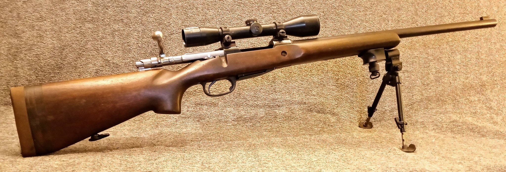

Nice job partner, I just finished my C3 clone. Original PH action, original PH barrel ,C3 stock, PH rings and bases, bipod, original scope , PH rear sling swivel this is as close as I can get to the real deal , plus cleaning kit , original sling original front and rear target sites ,best I can do at 100 yards is 3/4 moa ,
Strange they have straight bolt handles and the trigger isnt the usual parker hale trigger either. looks like a military straight bolt and trigger dropped in a PH action maybe
Looks nice! I'm getting ready to start my second M82/C3. I acquired all the correct PH parts with the exception of an accessory rail. Will probably have to machine one up.

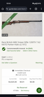

Was anybody watching this auction last week? Went a lot higher than I thought it would.
Is a Z prefix even correct? I thought those were 1200TX, not M82.

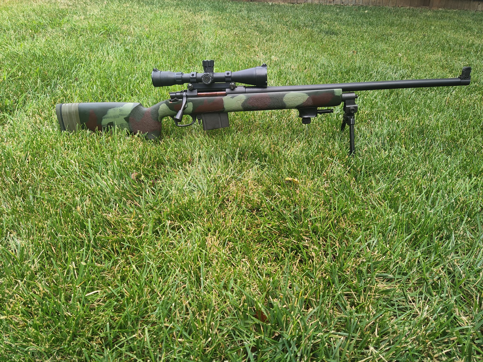

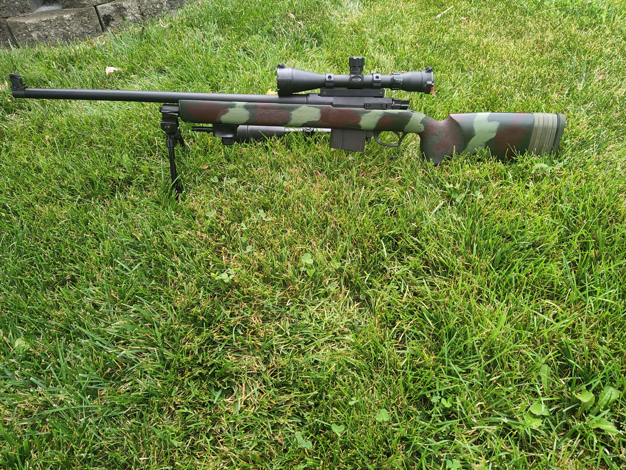

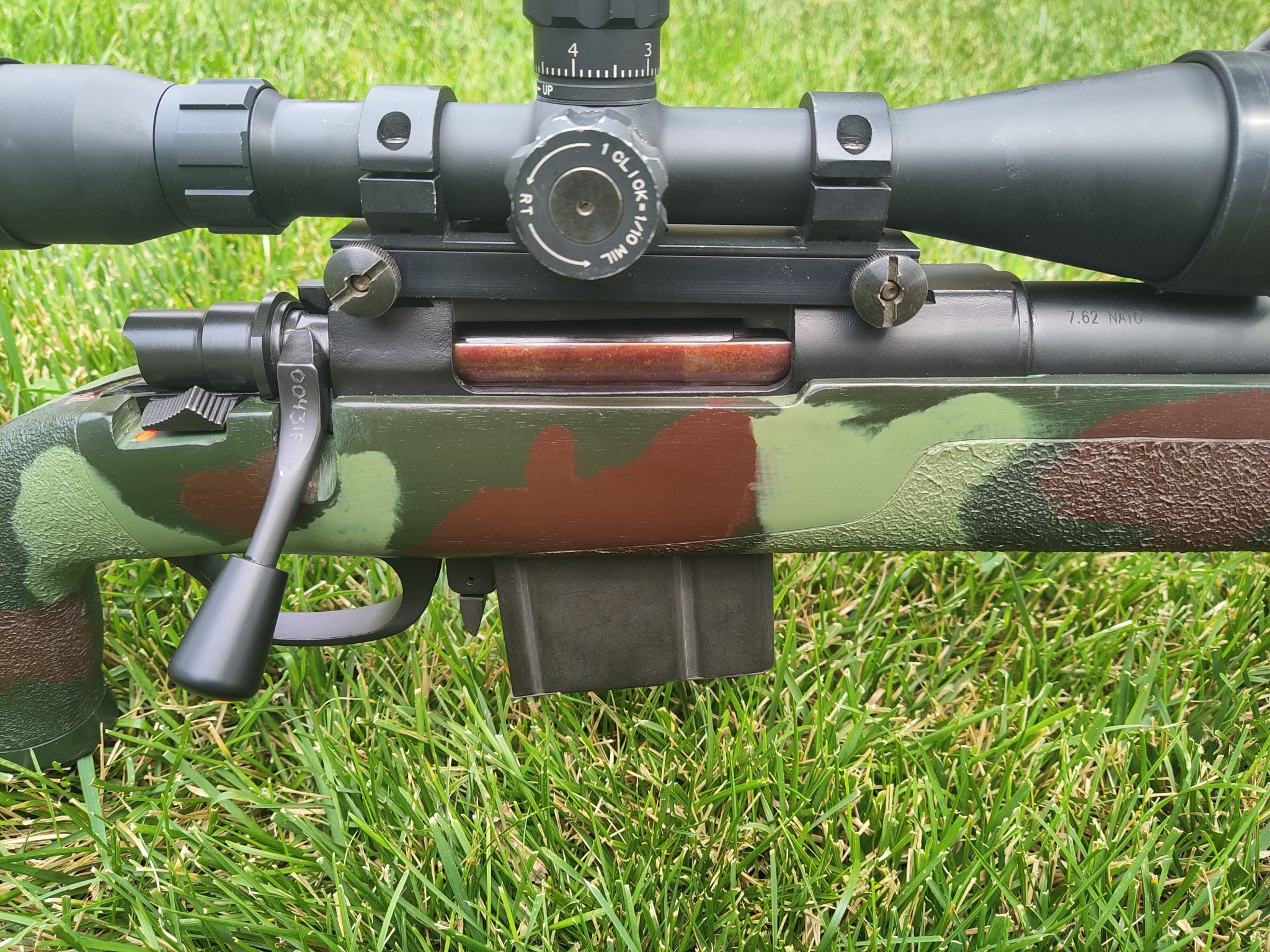

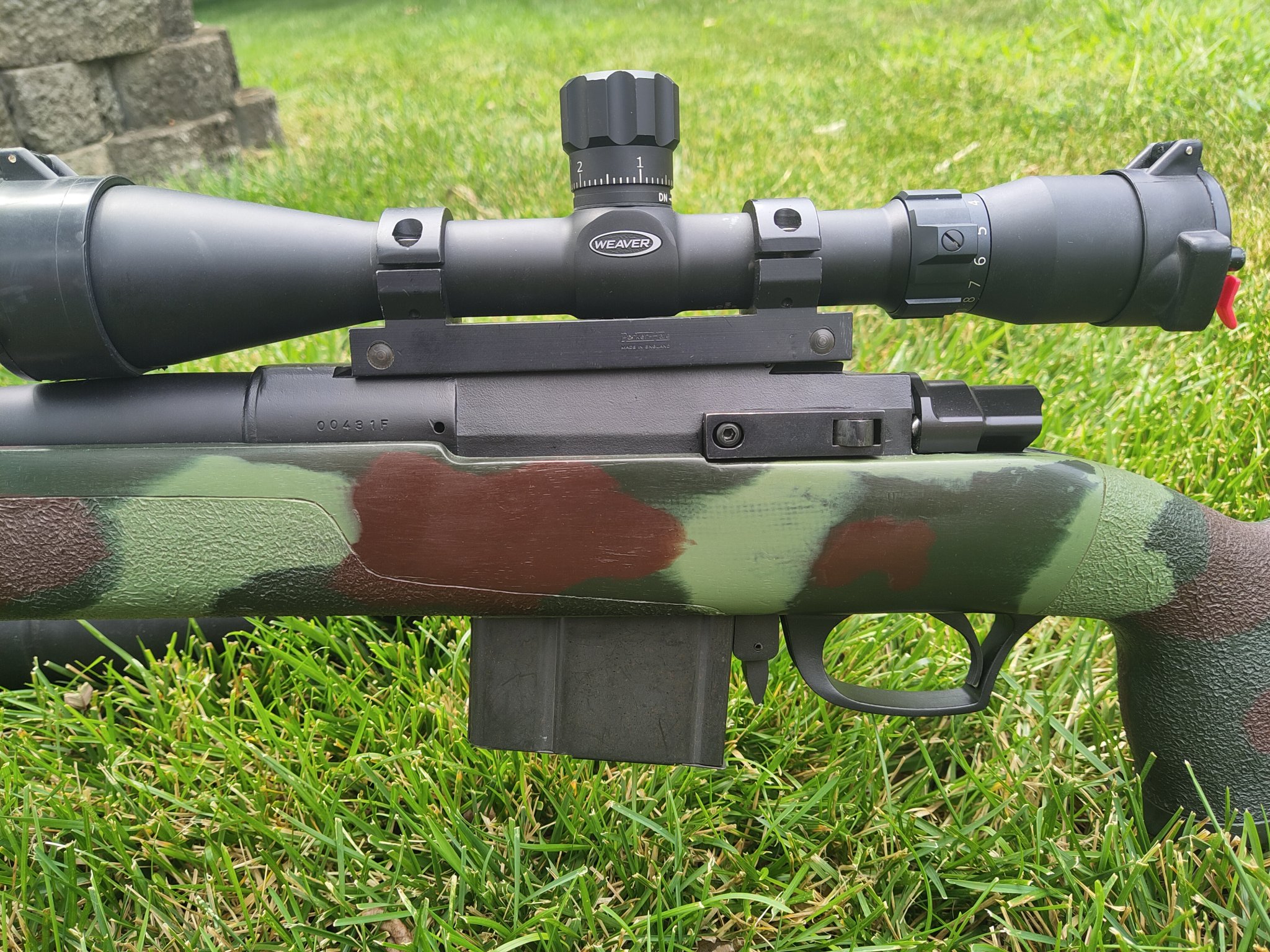

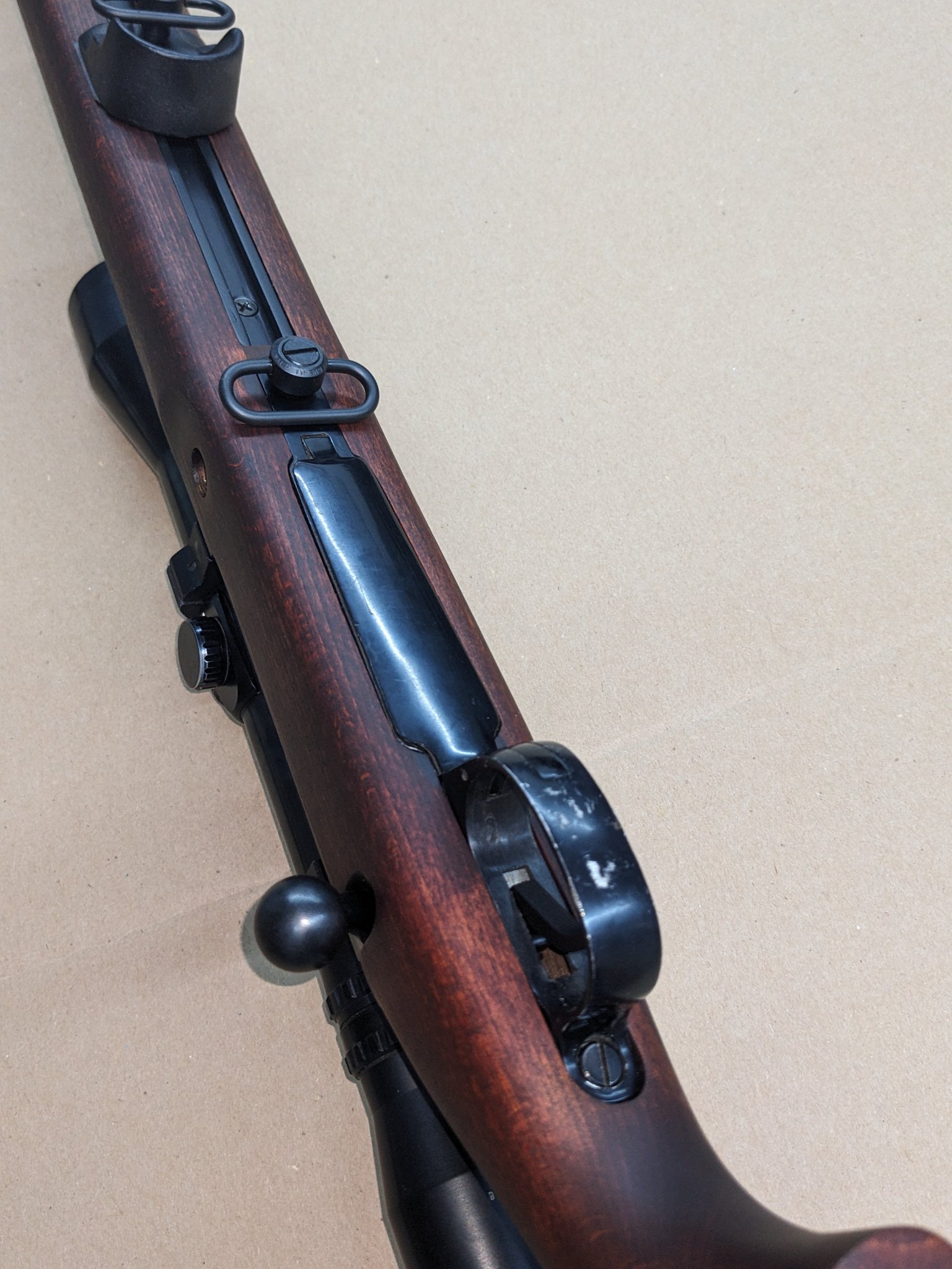

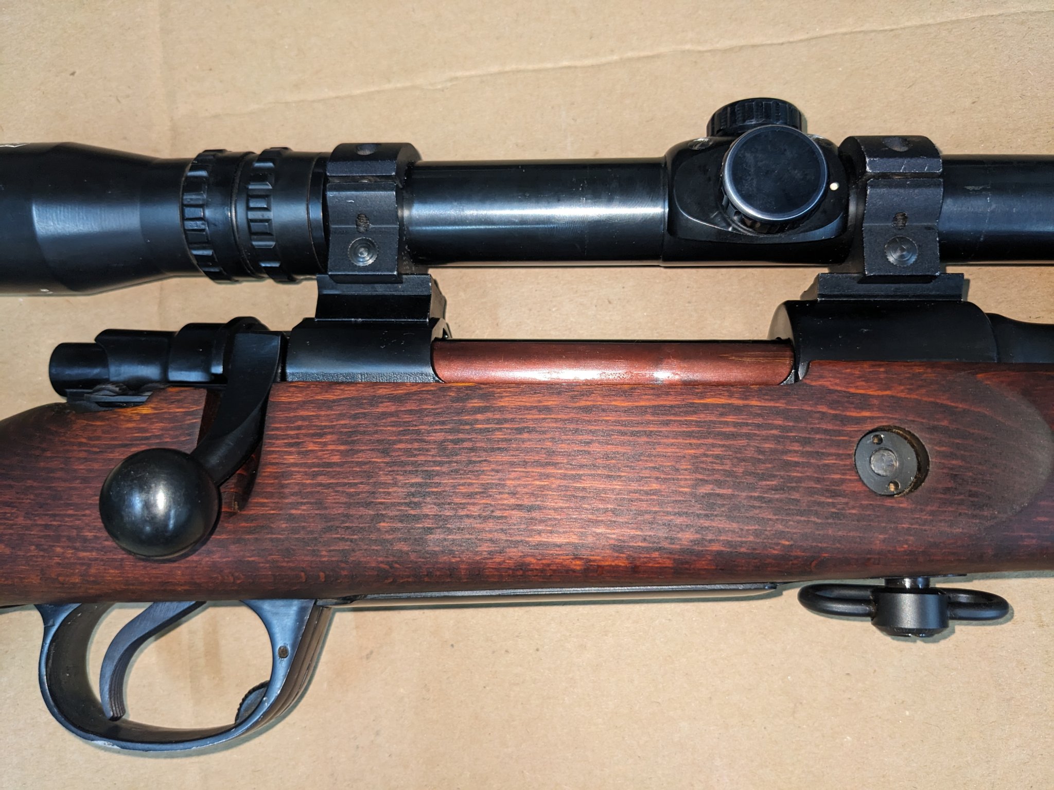

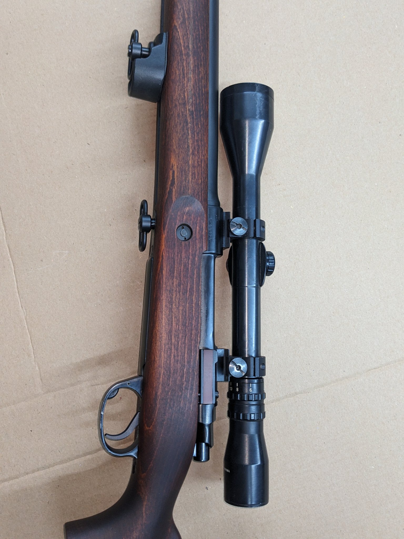

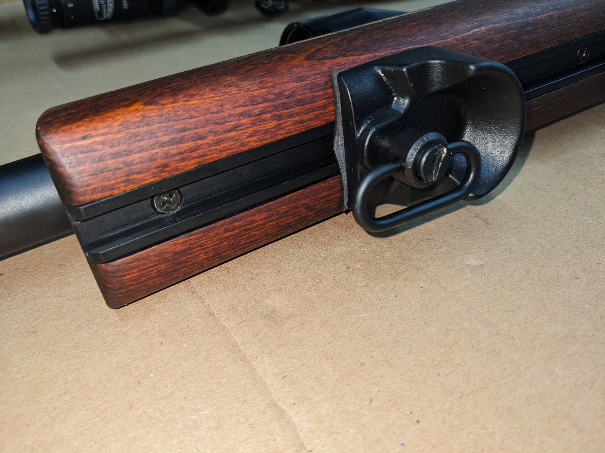

And, I finished up my own clone recently as well.

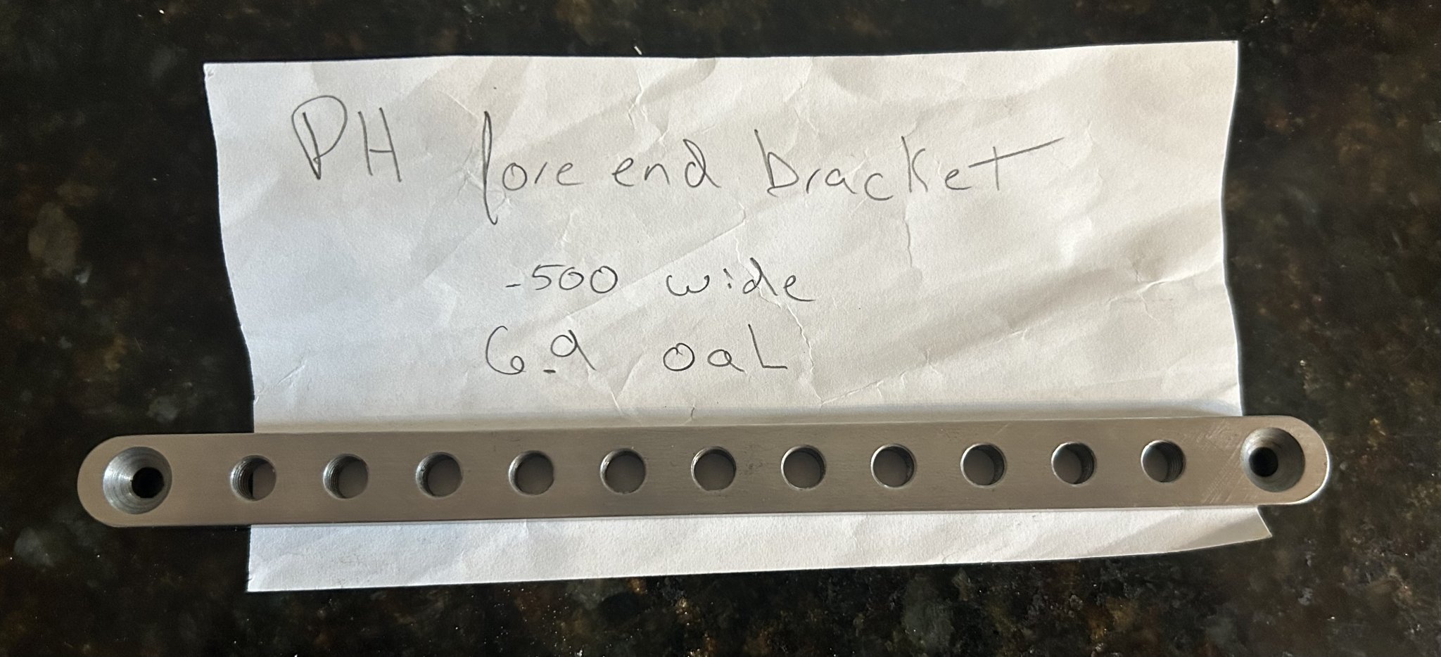

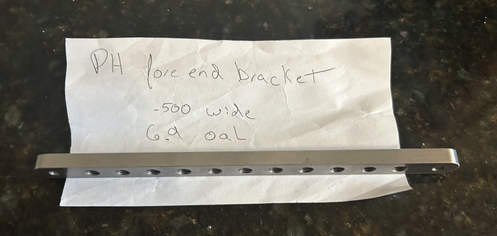

Is this the PH accessory rail you need for that project? It’s made of steel, but I don’t think its correct for the M85 stock that I have. PM me if this is what you need for an M82/C3. (I think it’s the same rail seen in post #127).
Reactions: sandwarrior
That is the rail for the L81 "cadet" training rifle, which actually is the correct one for the stocks Old West Scrounger has. I used one of those on my first build. The M82/C3 used the 1200TX rail. It has 2 screw mounting holes and 11 threaded holes for your palm stop. I don't know why PH made the cadet with an ARCA-like (but not quite, and long before ARCA rails were a thing) rail and the service rifle with a proprietary rail. These guys were in the pre bi-pod era, so I guess they were experimenting with ideas. Anyone else have any input, I would love to hear it. I plan to fill the slot and the round escrution holes in my cadet stock, and blend in the correct rail on this next build. If I do it right, it should be barely noticeable. I hope. Unless someone has a proper stock out there.....

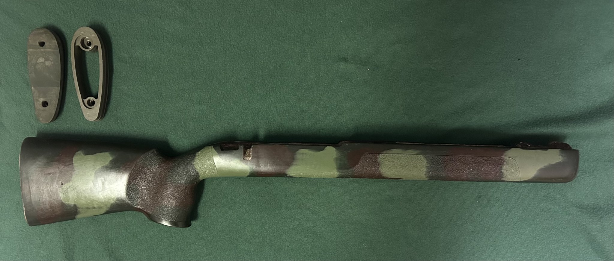

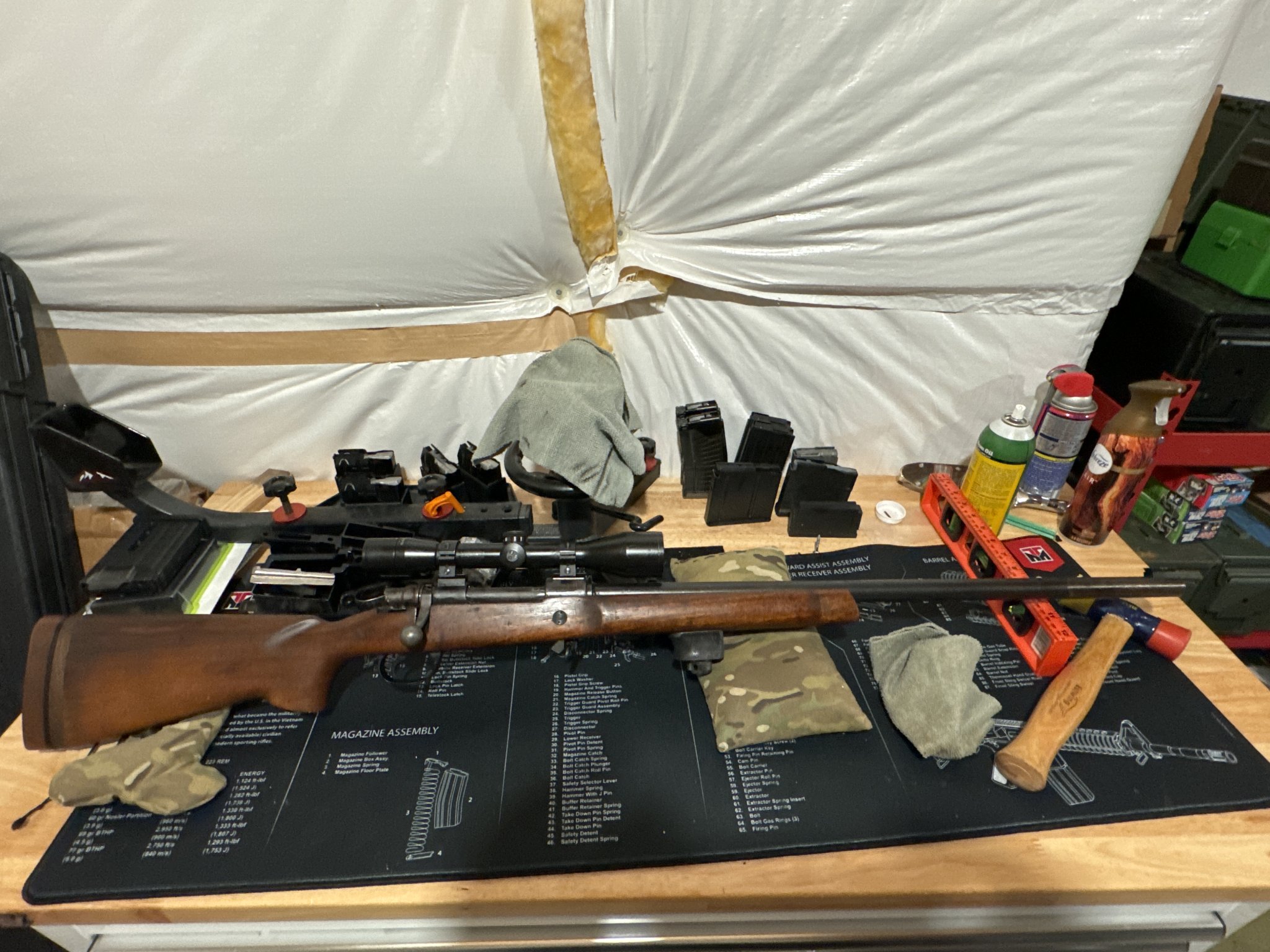

This is my contribution to the M85 thread. I traded a Dillon square deal for a box of rifle parts with a receiver with "Parker Hale" stamped in it, a barrel, bottom metal and magazine, stock and a few other odds and ends. Here is the finished product. I had a boatload of help from a couple close friends of mine to get this rifle finished. I sourced the remaining parts I was missing from Norman Clarke in the UK and a friend who happens to be a rifle enthusiast.
Be advised!!! The Weaver is just a place holder until I can get the other mount machined out to fit the 26mm ZF in the second picture (the second mount I have is made up of parts so don't worry about me ruining an original). When I purchased them, I was told both the mounts were 26mm, but neither were.
That looks fantastic. I want to build the same rifle but I need a few miracles to make it happen. All I have is an un-inletted M85 stock, M85 trigger guard, the scope mount and ZF95 10x scope….if you know of any more spare M85 parts, please keep me in mind.
