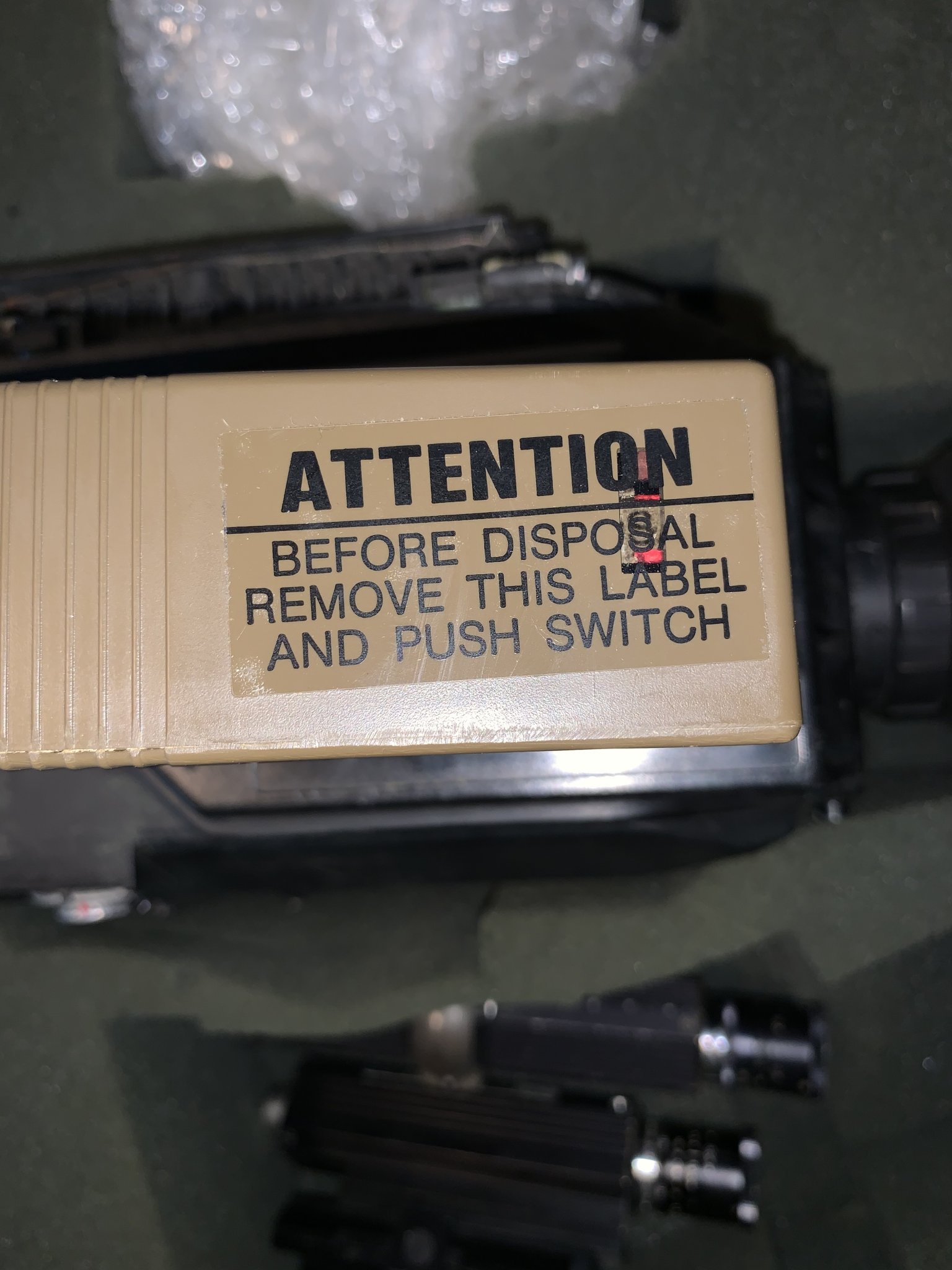

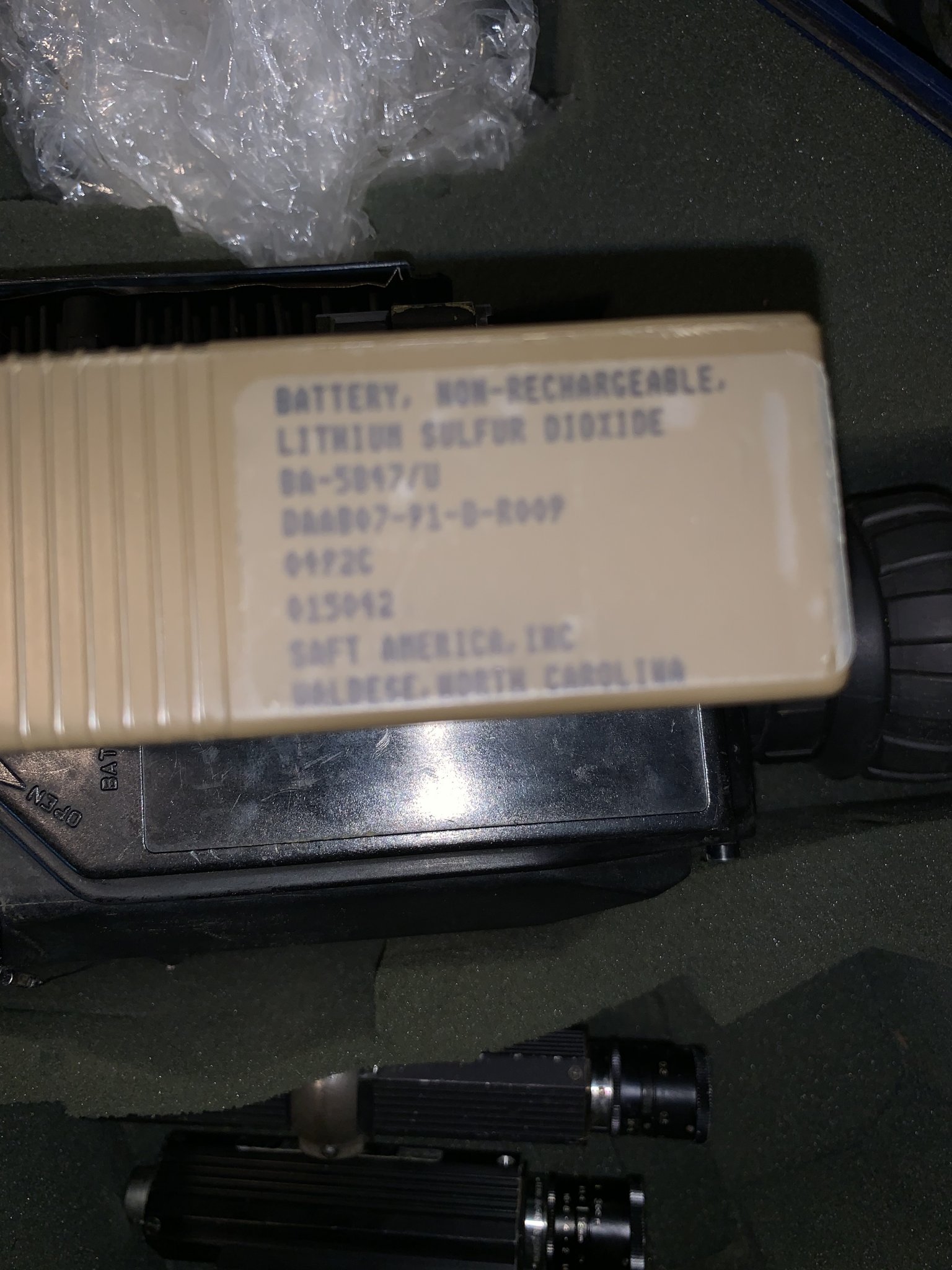

I was wondering if anyone has any leads on where to find An/ PAS 13 TWS batteries for sale less than 100.00 or rechargeable batteries as well as a charger?
I have a buddie in a NG unit that has an old PAS 13 in his arms room and they are not able to get batteries for it through the supply system for some reason and they want to know if it still works and don't want to go through the de-militarization process unit they know the status of it. Any help would be greatly appreciated.
Attached is a photo of the non rechargeable battery for reference.

Roger, I'll pass this along. Do you know of any alternate power source? that can be used? I have found this for him however they cant use unit funds to procure. https://www.batteriesdirect.com/product/details/military-grade-batteries/military/ba-5847
It does look comparable but I couldn't tell you for sure. Maybe some of the older guys who are more familiar with the older PAS13s can help. I used mostly the version 3s that use AA batteries.

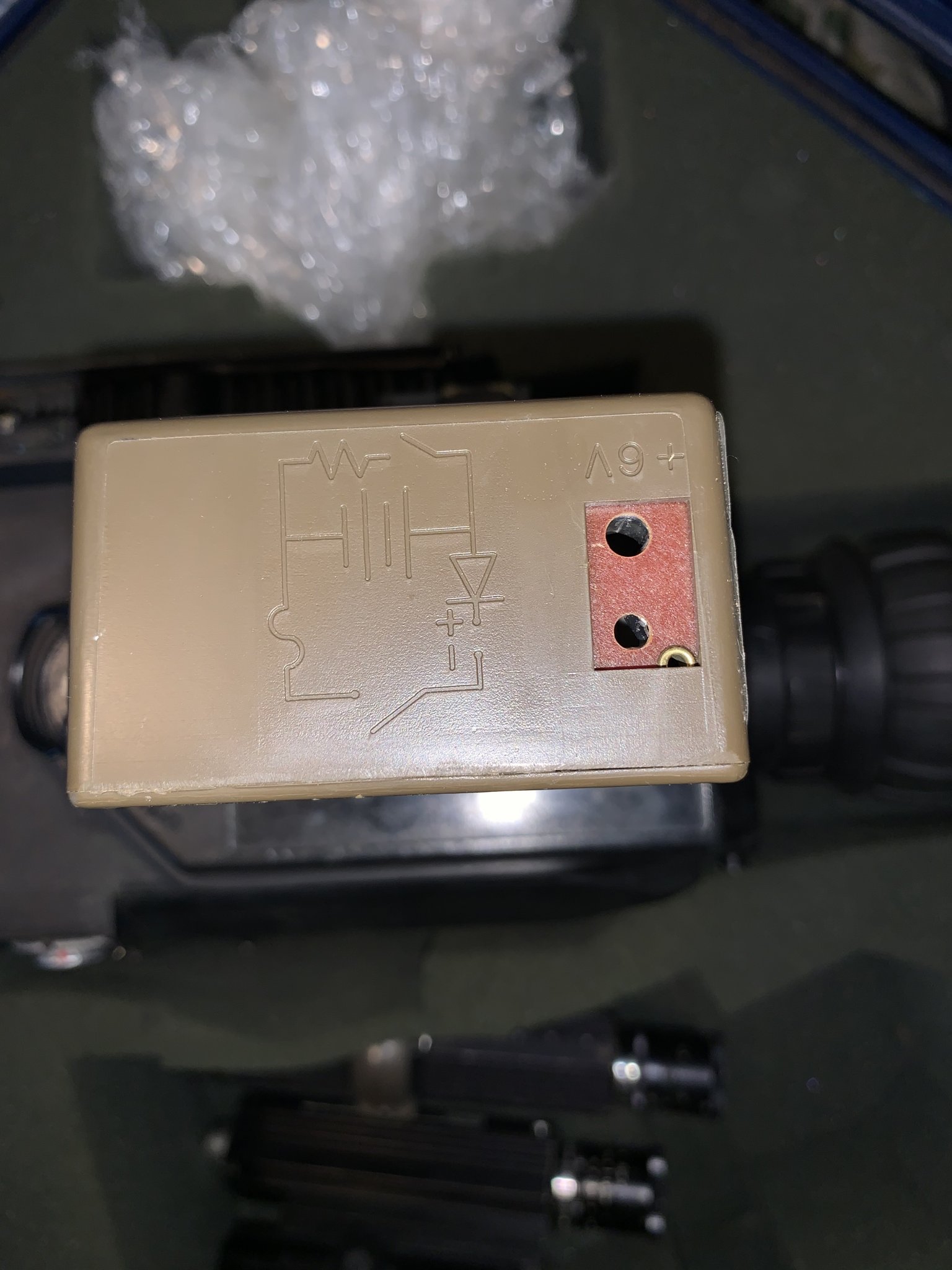

Ok soooooooo I'm a pretty field expedient guy and would so try this if I had the unit. Here's my thoughts- a 6V battery is well within the 4.5V to 7V range of the AN/PAS-13 unit soooo:
Prove a theory-
Take a dead battery shown above and gut is leaving only the + & - leads, connect them to a 6 volt battery then connect it to the unit (top open of course) and see if the unit powers up. if the unit powers even for a short time, he should be able to cycle through the function seeing and check WH and BH mode prior to the unit draining its power.
If this proves to work, all they may need so 6 volts and chargers to run their optics?
Whatcha think?
Depending on the construction of the housing it may be possible for a local specialty battery shop to take it apart and replace the internals. I've had it done to some bespoke rechargeable batteries that were no longer available.
