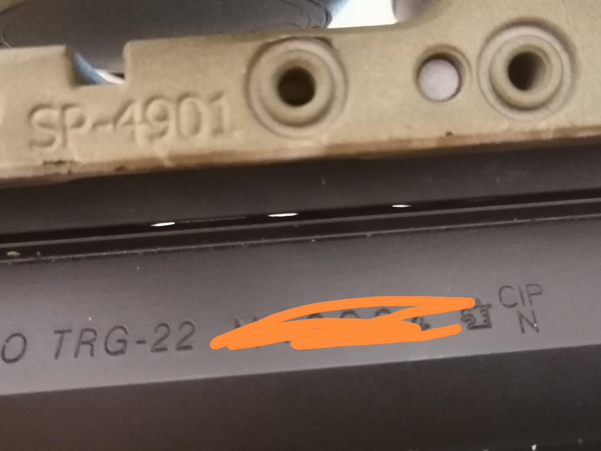

I have some weird things going on with my TRG and the contessa pic rail. Mounted it about 1.5 years ago with screws and blue loctite. For some time, after shooting the rifle hot some how loctite seeped into the chamber. Usually just whiped everything off and went on. A few days ago it happened again after a long time and decided that I would clean out all of the loctite and remount everything. After doing so, my zero shifted 0.2mrad up and 1mrad left at 100 meters. Was kinda surprised about the amount of windage shift. My ocd kicked in and redid everything. This time my elevation shift went back up to normal, but windage shifted again 1mrad left.
Both times shot a group at 100 and 300 meters, and the rifle holds still an amazing group and its zero and there is no weird alignment issues, ie no windage shift at 300m compared to 100m.
Im just super weirded out about the amount of windage shift and especially since it shifted 1mrad left both times so it has shifted a total of 2mrad left from original mounting. Is this in the normal parameters? Everytime mounted the rail with the first screw infront, and the rear most screw in the back to align the rail, and proceed to tighten the rest.

Lets try to have an actual conversation: Im used to the accuracy of my spuhr mount, which I never have to rezero my scope when I use the same setup on my 22lr. Every time I remount it to my rifle its dead on. This was the first time I ever took a pic rail off and remounted it, so how can I know how much zero shift to expect after remounting?
And the first mounting was succesfull, there was nothing wrong with it. The only thing prompting me to remove it and clean up the action and base was this blue gooey liquid on my case after firing it. Next cartridge I chambered and pulled out and it had the same thing. Since you have so much knowledge, can you please use it and explain what the substance could be if not loctite? The only reason I came to the conclusion that it could be loctite is thats the only blue liquid I know that has ever touched the rifle.
Maybe my use of loctite was wrong, but when removing I did have to use some force to pull the rail off so it did do something. I know there are epoxies, but like I said I didnt want to make a "permanent" bond.
Like I said after test firing I didnt find any windage shift from 100 to 300 meters which a crooked base should cause. So I guess everything is still aligned correctly.
Maybe it would have been easier to just ask has any one ever tested how much zeroshift you get when removing and re-installing a picatinny scope base, since that is what I really was curious about.

Hard to say what the blue stuff is in your chamber without a pic to see for ourselves... but it shouldnt be loctite. If it is loctite in your chamber you used loctite seriously wrong. Thats all anyone is saying.
We cant say whats a typical amount of shift would be with your personal set up but 1 mil isnt a whole lot nor very surprising after a full breakdown. Especially if the base was floating on a sea of loctite.

Thanks for the helpful response. For me the biggest thing weirding me out was that when I re installed the re install, it shifted left 1mrad again, so basically 0 elevation shift and 2mrad shift left from the original install 1.5 years ago. After whiping the cartridge the substance seemed very similar to loctite. But I cant really figure out where it could have hidden for 1.5 years without curing and having a hole to get into the chamber. Every screw hole had remnants of brittle loctite after removal like expected.
I have twice done a "full" break down with removing the scope mount, and barreled action from the bedding block for a clean and after reassembling didnt have any zero shift at all. But as mentioned, never have I before removed a pic rail after it has been mounted.
But since I didnt have any weird impact shift at range, I guess Ill just leave it be and trouble shoot again if I get weird windage shift or if the zero starts shifting.

Blue gooey liquid... You didn't happen to clean the rifle prior to this happening, did you? Possibly just didn't clean out the chamber well enough and had leftover residue on the cases? Doesn't explain the POI shift, but might be the source of your slime.
Understand why you want the versatility of a pic mount. I'm just pointing out that if your OCD is concerned about modest shifts during complete disassembly and reassembly, then you may be better served by removing one component in the tolerance stack.
I see your point, but removing the pic rail isnt part of a normal procedure for me so once I make a more thorough test that everything is still aligned Im probably going to make a more permanent bond.
And I rarely clean, and usually only clean with oil. Only once have I cleaned with any copper solvent (after about 1500 rounds) and I had the same slime prior to this and now. Basically the "slime" hasnt really been an issue. If I see it I have just cleaned the chamber thoroughly and continued on.
I think I found the reason why the zero shifts after reinstalling the mount. The mounting is solid enough that it holds zero after being mounted, but seems like there is enough play in the system that enables the rail not to align the same way every time. The air gaps are in a location where sako has machined holes for the recoil lugs
So your POI shifts from a complete removal and replacement by ~1" at 100yd?
100yd * 36"/yd = 3600 inches
1/3600 * 7" (length of rail, approx.) = .00194"
So front to back, the rail shifts orientation in the order of a thou or two on the ends by removing and replacing it. Shocking!

OP, when installing you know you need to shove the rings forward until they contact the pic rail, right? Otherwise there’s a chance that recoil will move the rings forward. There’s always some gap.
When you install a chassis, same thing. Move chassis foreword until it hits the lug. When installing the rail to the top of the rifle, same thing, shove the rail foreword.
When not tightened, I have had exactly zero pic rail attachments with zero play, back and forth, when placed in the pic rail. I mean, if that was the case you would be lucky to even be able to install the attachment and have to resort to press fit/hammer or freezing the rings before installing.
I thought Id give an update just for fun. After removing all of the loctite and remounting the pic rail with only a dab of loctite on the screws (desided not to epoxy the rail on, since it has two recoil lugs on it and its just a 308) all of my issues with the blue smudge on casings went away. My theory is that close to where the barrel threads in there is one extra hole, and me using a shit ton of loctite with the first installment it got into nooks that are not air tight. After extended periods of fire it most likely just got the loctite moving into the chamber area.
