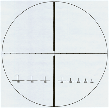

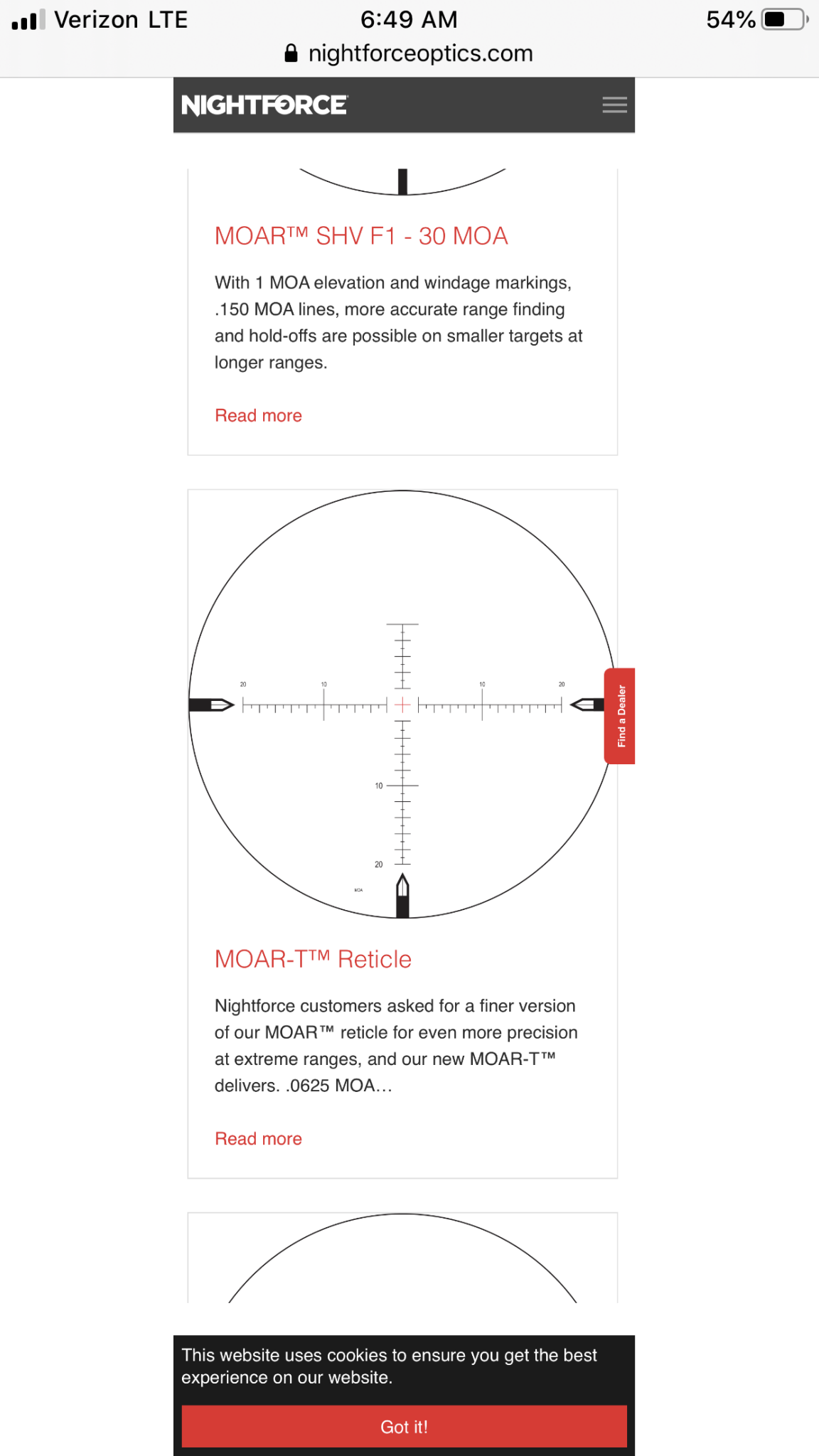

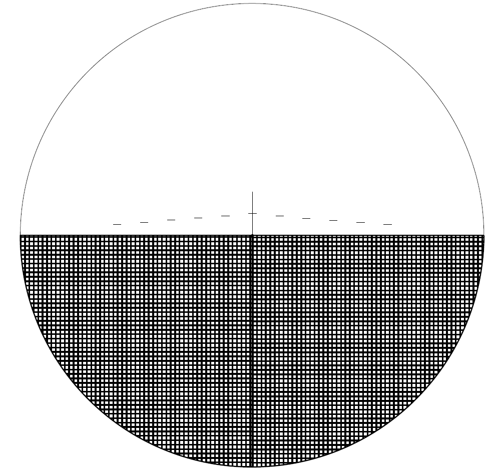

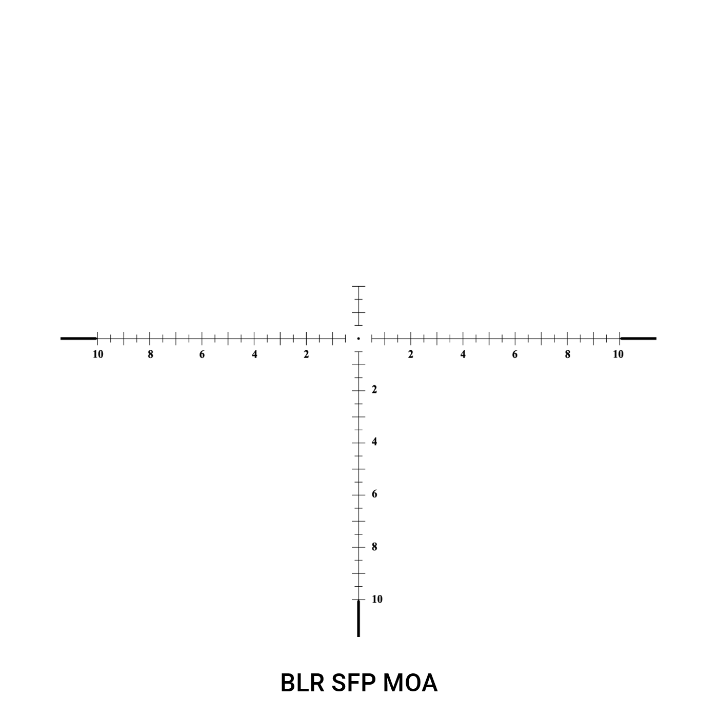

have any of you guys ever seen this? I like the idea of it. I just dont know how I would actually like using it.

I've come to appreciate reticles like the MR4 because it's relatively clear above the horizontal line.
I've had trouble spotting rounds in the air when there too much clutter above the point of aim and keeping it open really helps spot bullet trace.
Most of my shooting is done in places where we don't see the off plate rounds hit the ground, so seeing it in the air is key for me anyway.
For the same reason, I'm not much of a fan of the Christmas tree in the lower half. I just find it distracting and would prefer less interference so I can see impacts, or trace when holding high as well. So MR4 without the Christmas tree would be perfect IMO.

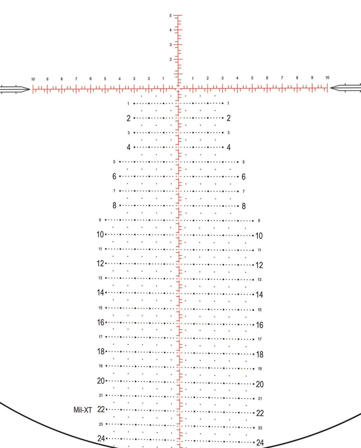

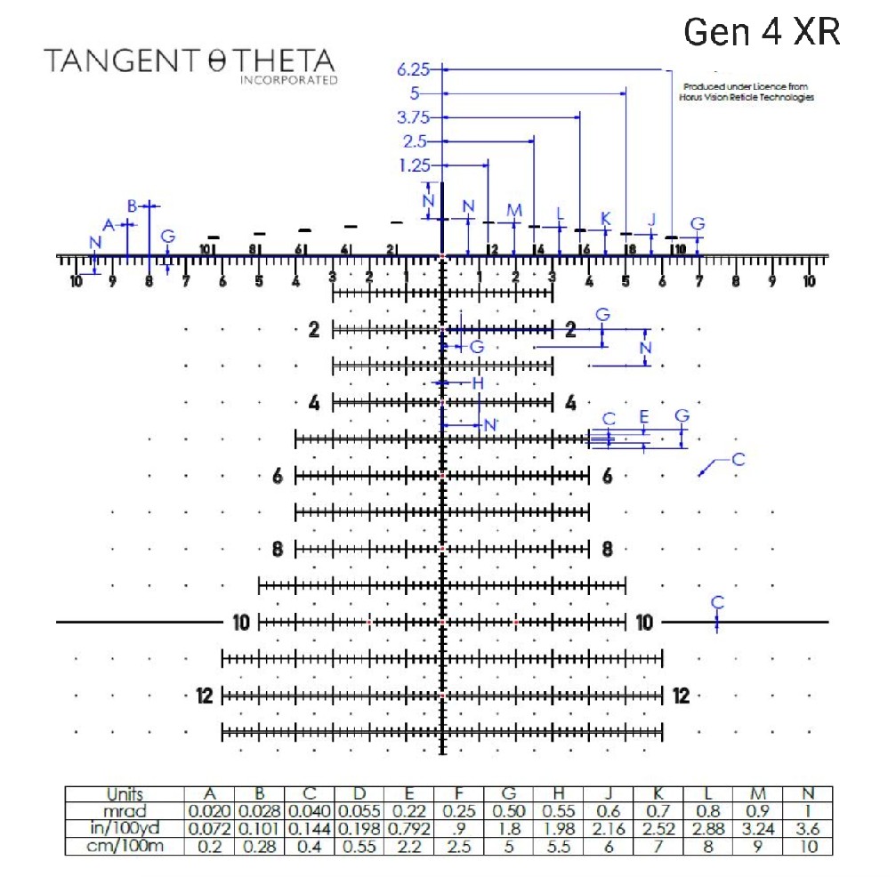

For target shooting, I really like the mil-based simpler Christmas tree-style reticles such as EBR-7C in the Vortex Razors, the Mil-XT in the ATACR or NX8, or the SKMR 3 in the Kahles.

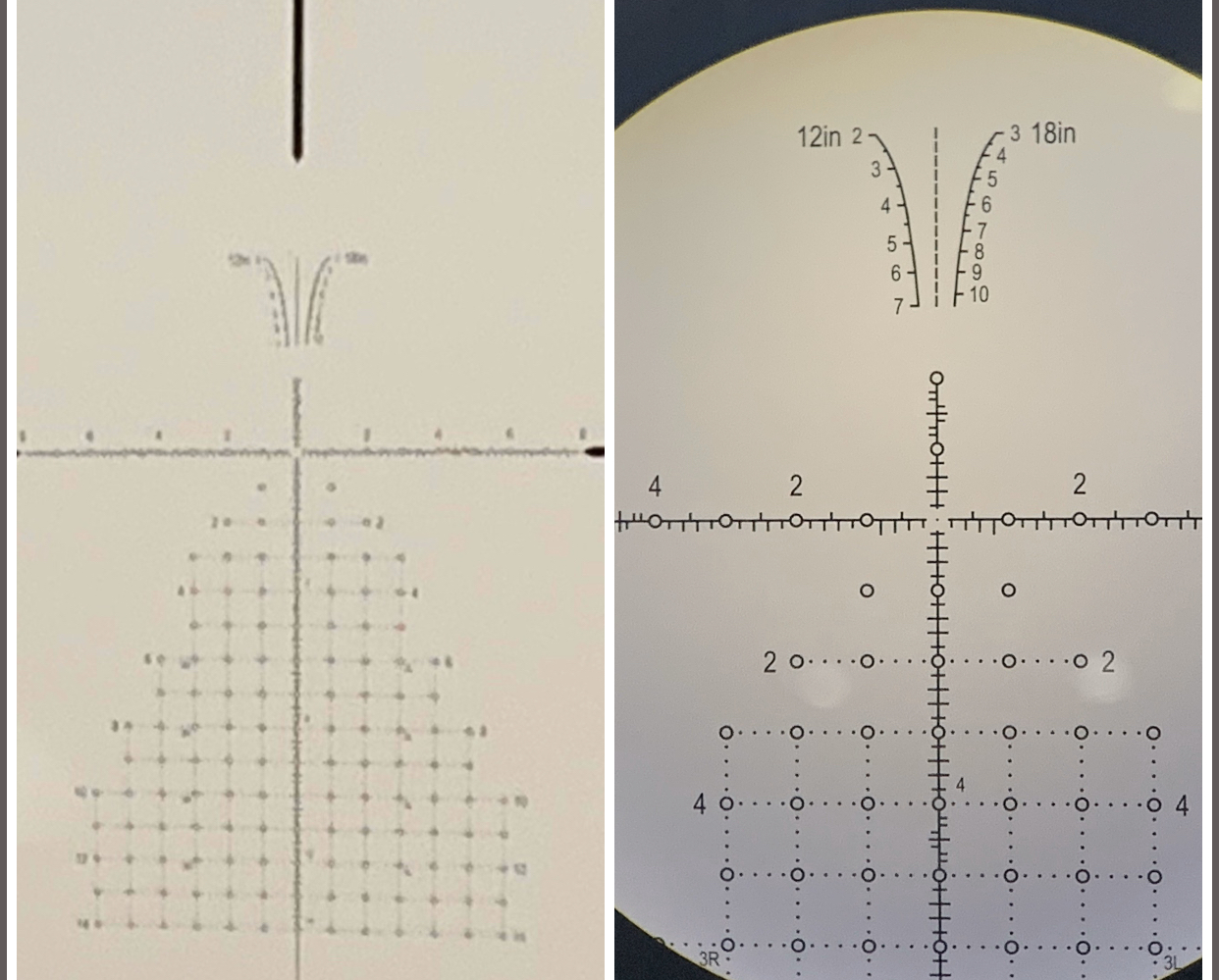

Anyone interested near Brownsville, Texas, there is a Zero Compromise 527 MPCT3 demo at Masseys Gunshop (@trophyhunter )for a couple days. Then it will be at the Rifles Only Brawl this weekend and then back to ZCompOptic.
Check it out while it’s down here.

I can’t stop thinking of an ibex when I look at that reticle…sorry for the crap pic.
