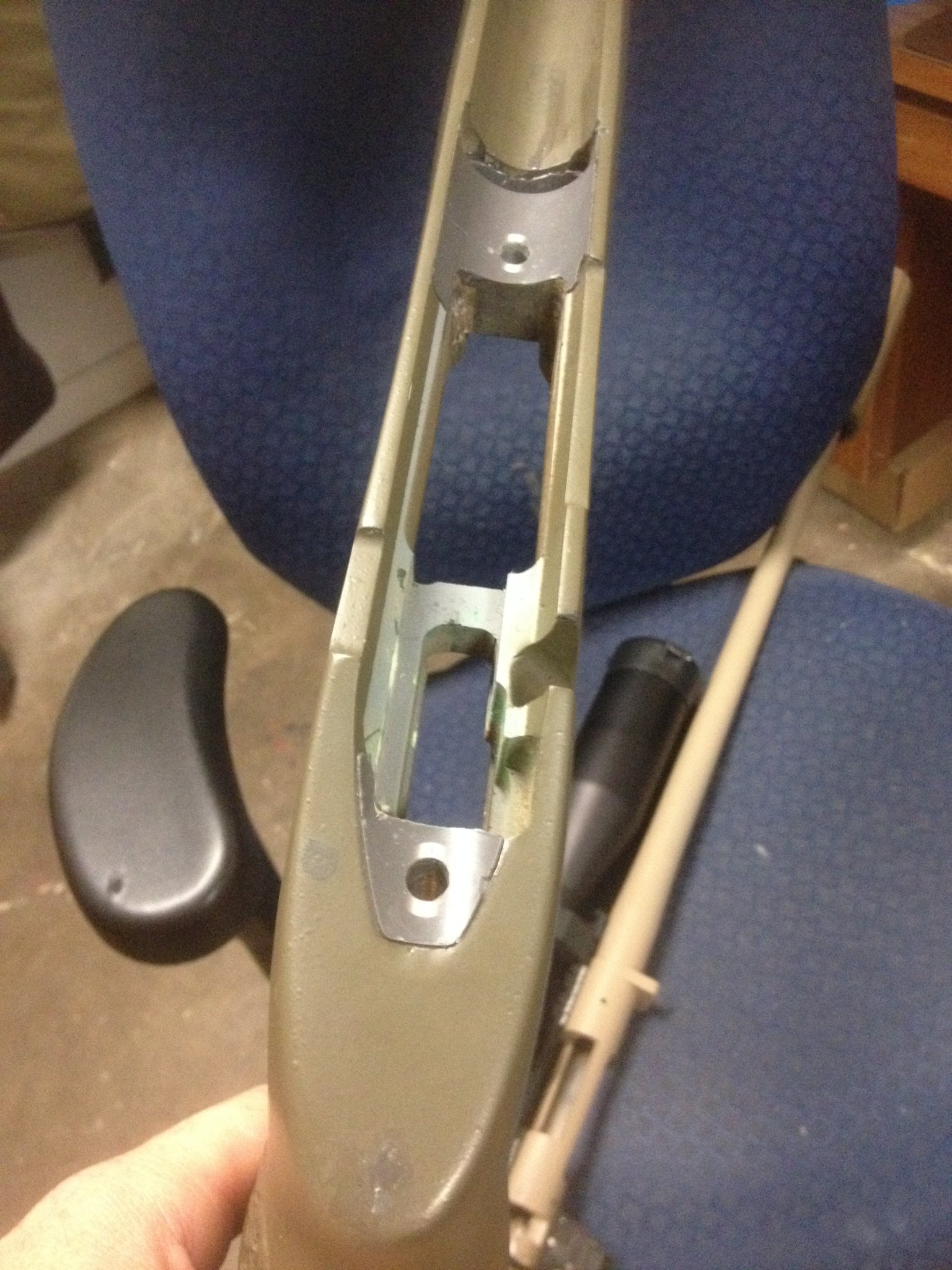

I like to work from the bottom up on M5 bottom metals, that way I can set the metal even with the stock in inlet from the get go. Hopefully this DBM is ok. It appears like the guy who had it was shooting it with no pillars installed. Just the giant gaping holes, and the action screws appear to have been tightened so tight, it bubbled the the DBM under the action screw and forged threads into the hole. I had to drill them out and file it flat.

I preferred the idea of gluing them in and doing the pillars alone. So I could set the DBM flush in the stock with the pillars.
