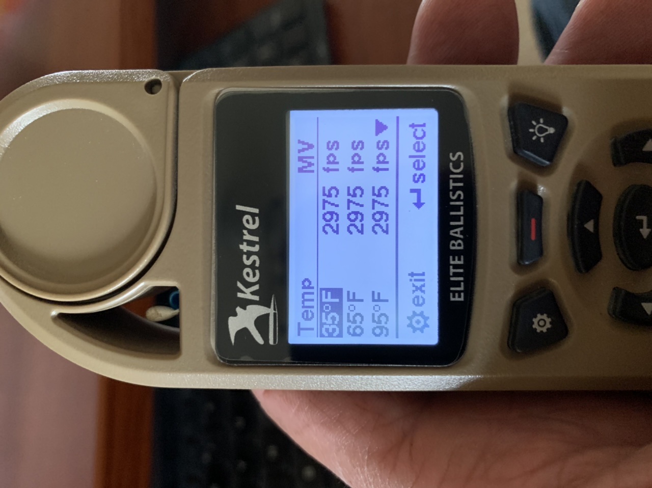

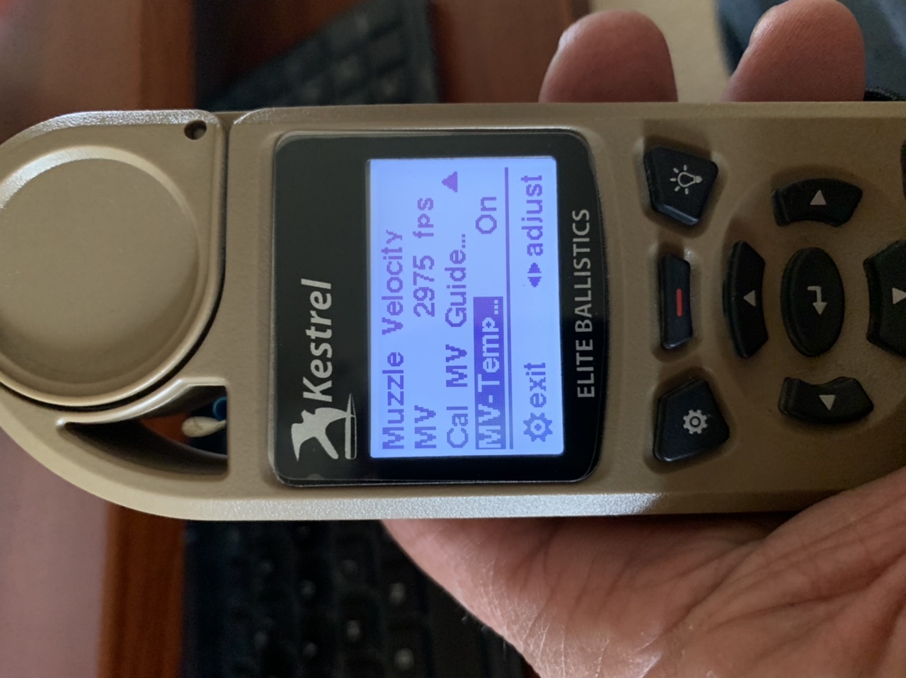

there is a muzzle velocity temp...i just turned it on and set it ill true it up tomorrow and see if it adjusted as the temp changes.
I think he is saying get real world data by replicating what you are likely to encounter in your AO.
Me living in the NE - 30' low, 60' median, 90' high MV numbers.
got it thanks! im about the same here...25ish 65ish 95ish should work...im going to do this tomorrow when i shoot ive got everything to make it happen...thanks.

MV- temp table.
I have a similar function on ballistic AE and it’s really helpful in getting my 7 saum data lined up as R26 is definitely a bit more sensitive than the R16 in my 260.
on my kestrel it’s this....just not sideways LOL!

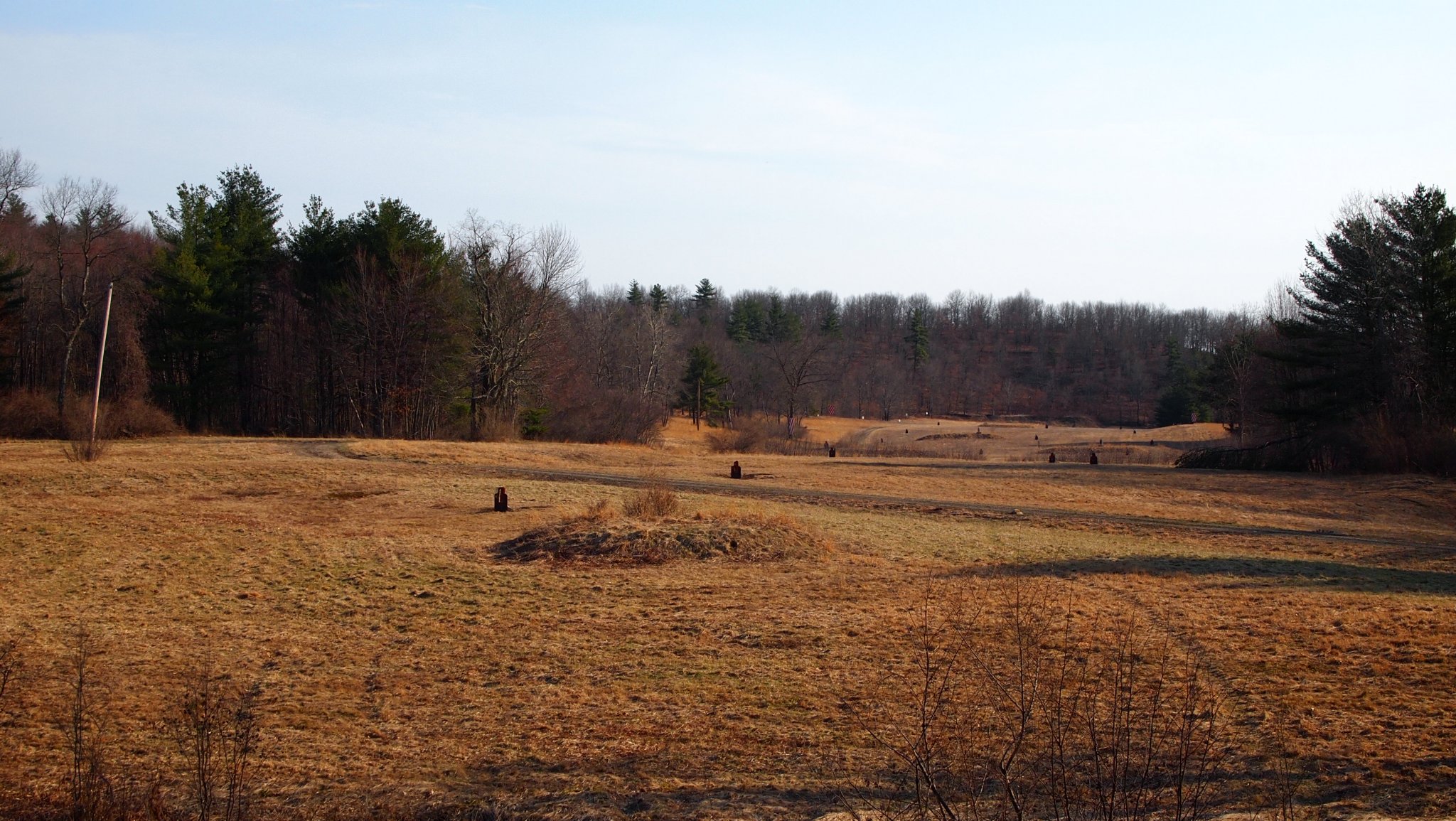

One of my life endeavours is to shoot here...
Its kind of a storied range on the local mil base. Steel out to 1000 meters. Twenty targets.
A perfect day would be my .308, one box of FGMM 175.
Draw up a range card, mil the plates through the scope, eat a sammich, attempt twenty first round hits.
Torso plates so every things bigger than MOA.
Holding to the .1 mil wouldn't be necessary but 20 rounds 20 hits would be a challenge for me.
