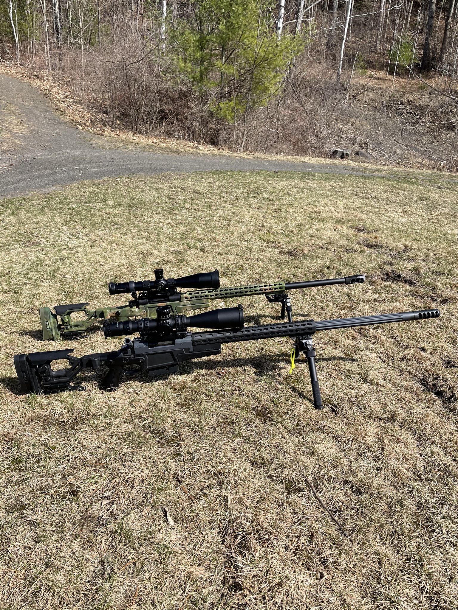

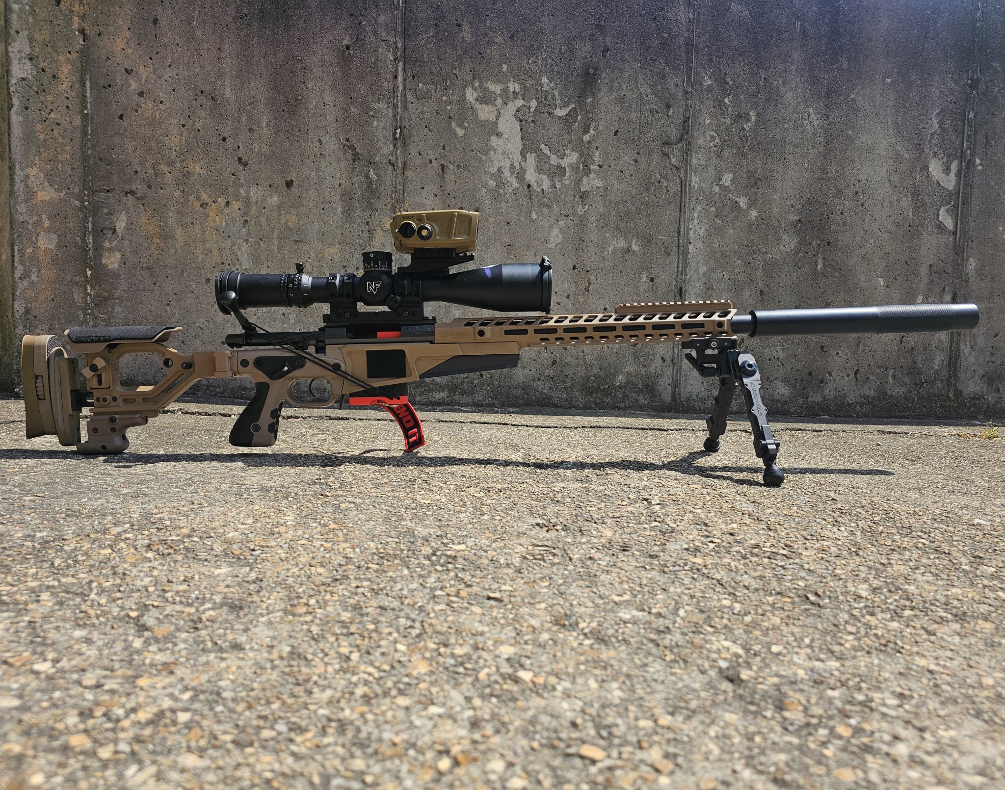

And they both shoot as good as my AI AXSR at half the price 😉

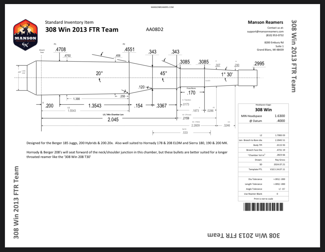

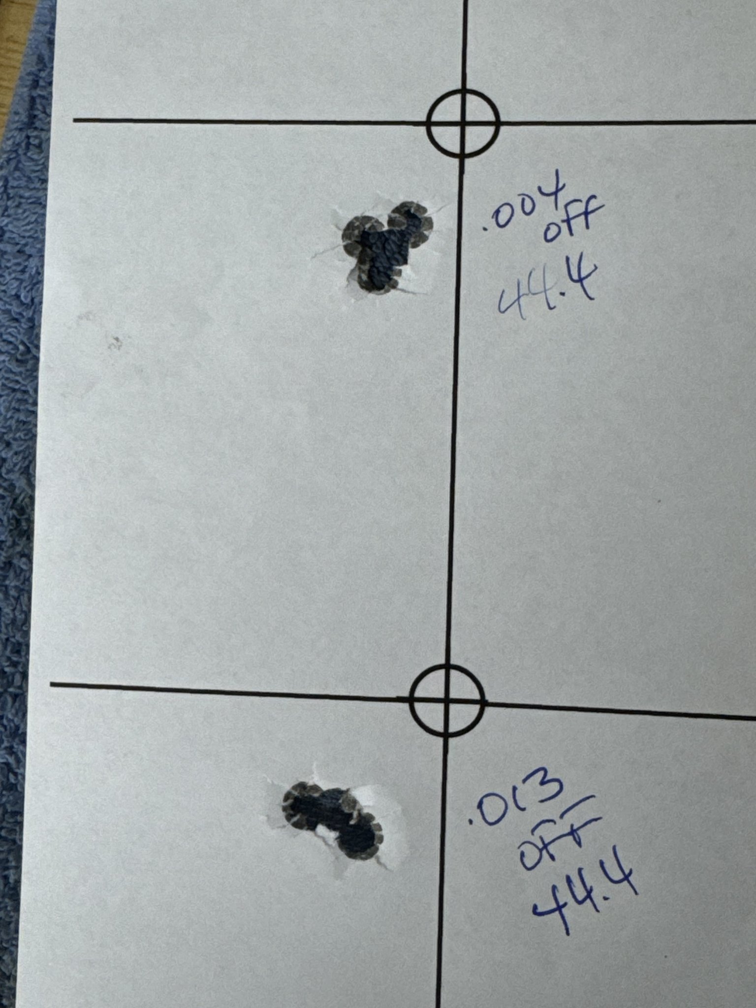

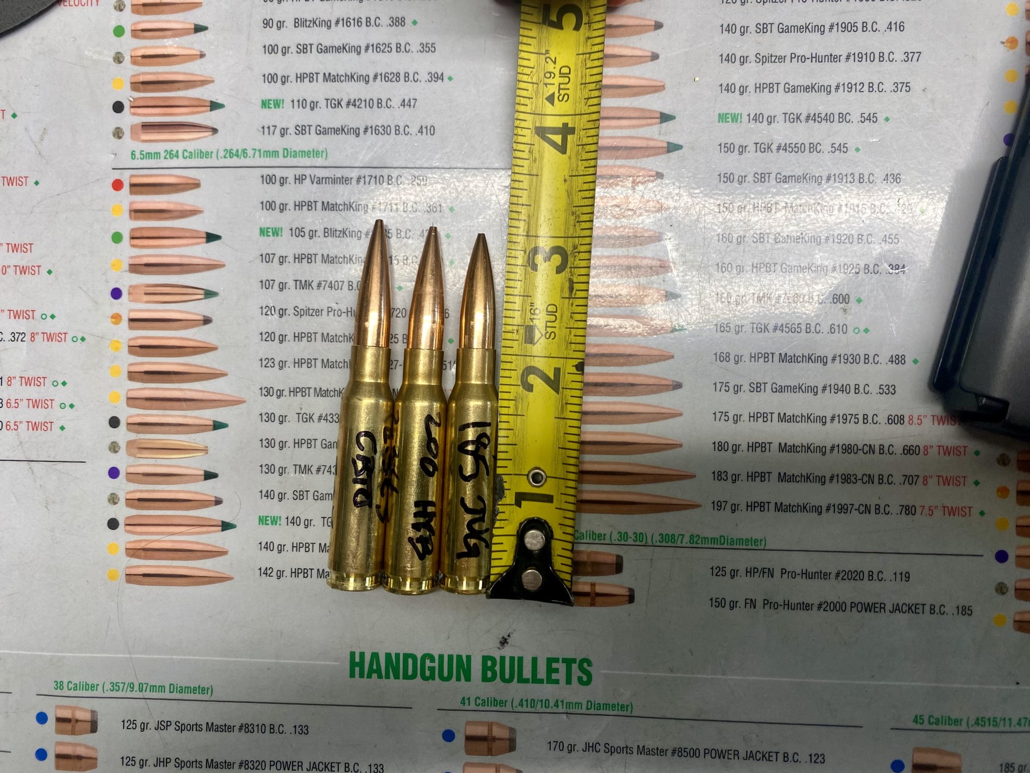

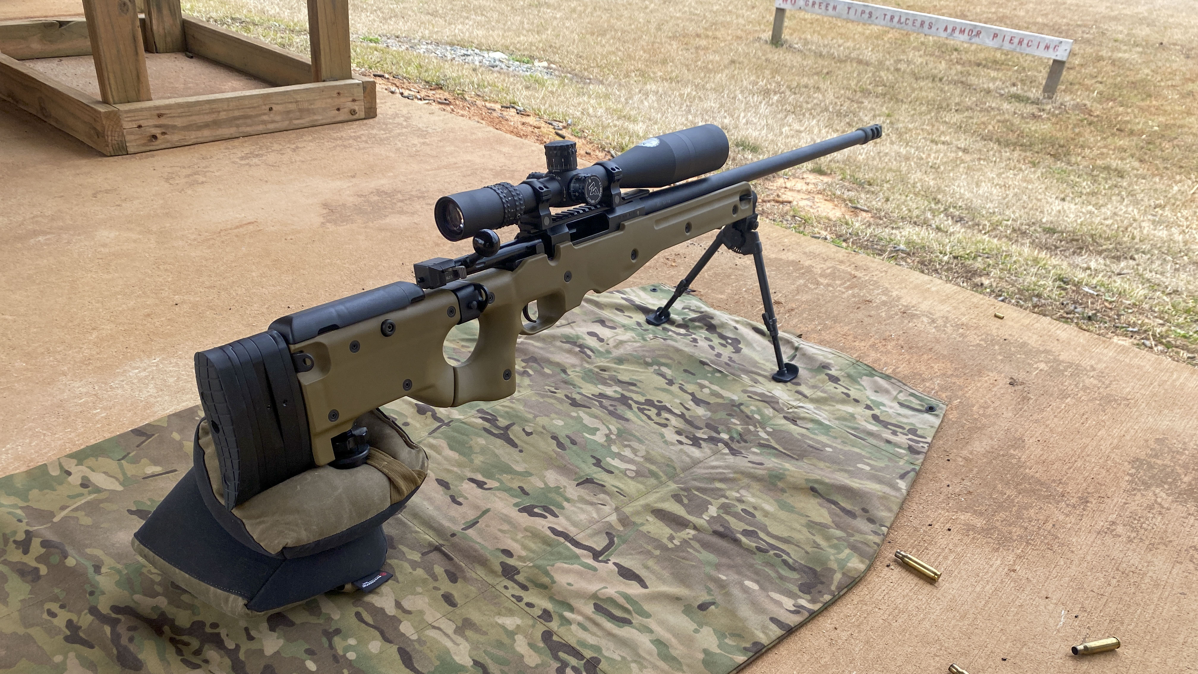

New long action 308 build in DRMO Mk13 chassis.
29.5” Brux HV 10 twist w/ Manson FTR reamer w/ .170 free bore
Built specifically for Berger 200 20X bullets w/ over 3.0” COAL
Break in w/ 185 Berger Juggernauts

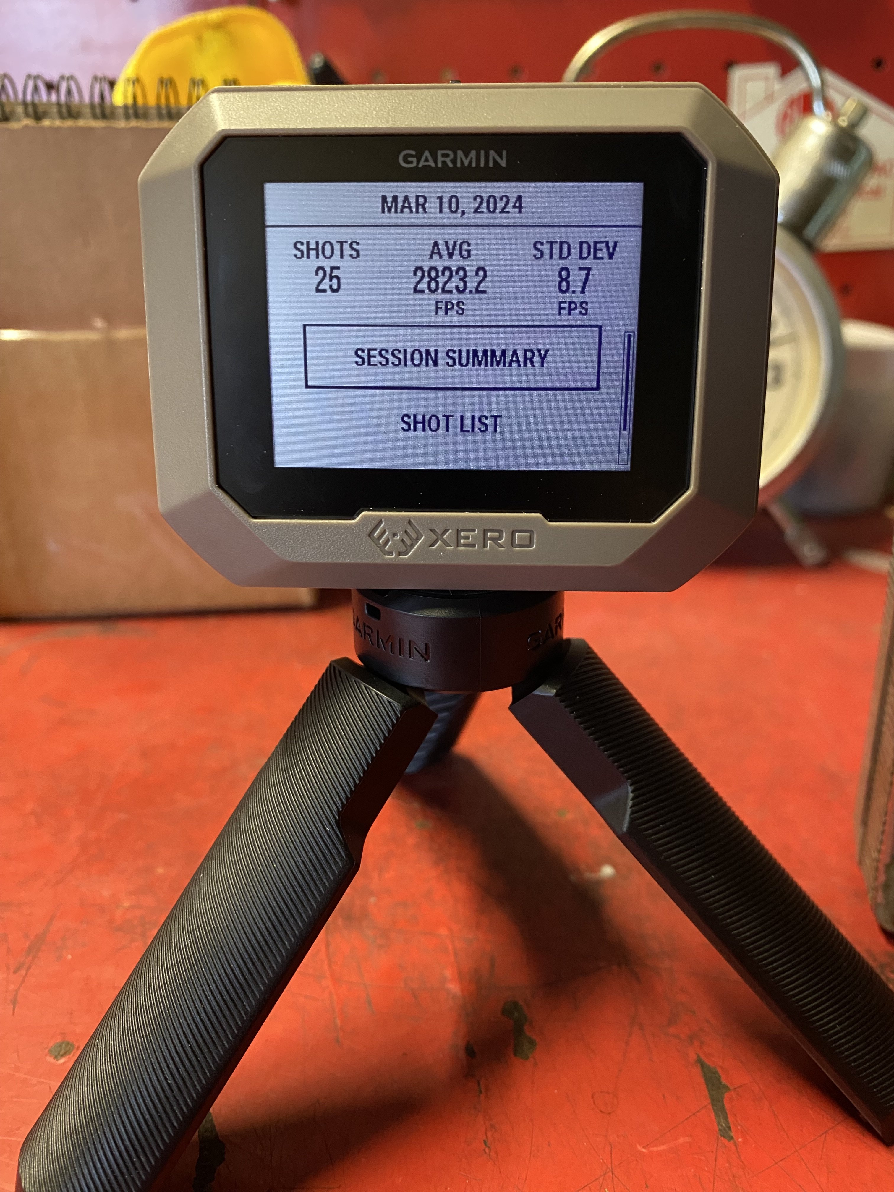

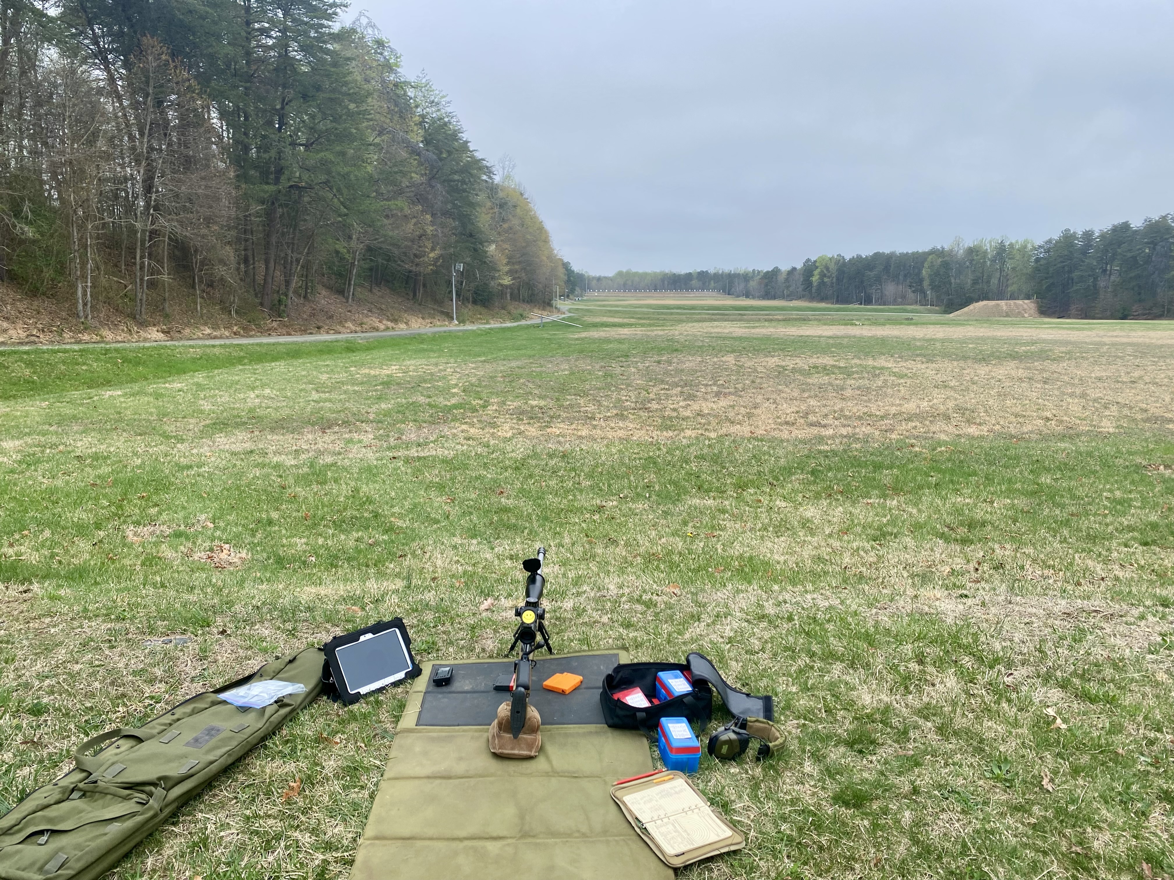

Load development 200 20X over N150 @ 100 yards:
Grand plan is 1K on Range 4 in the spring.
Edited to add: It works!

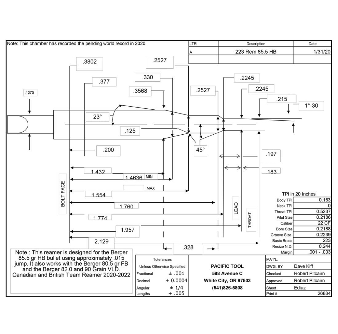

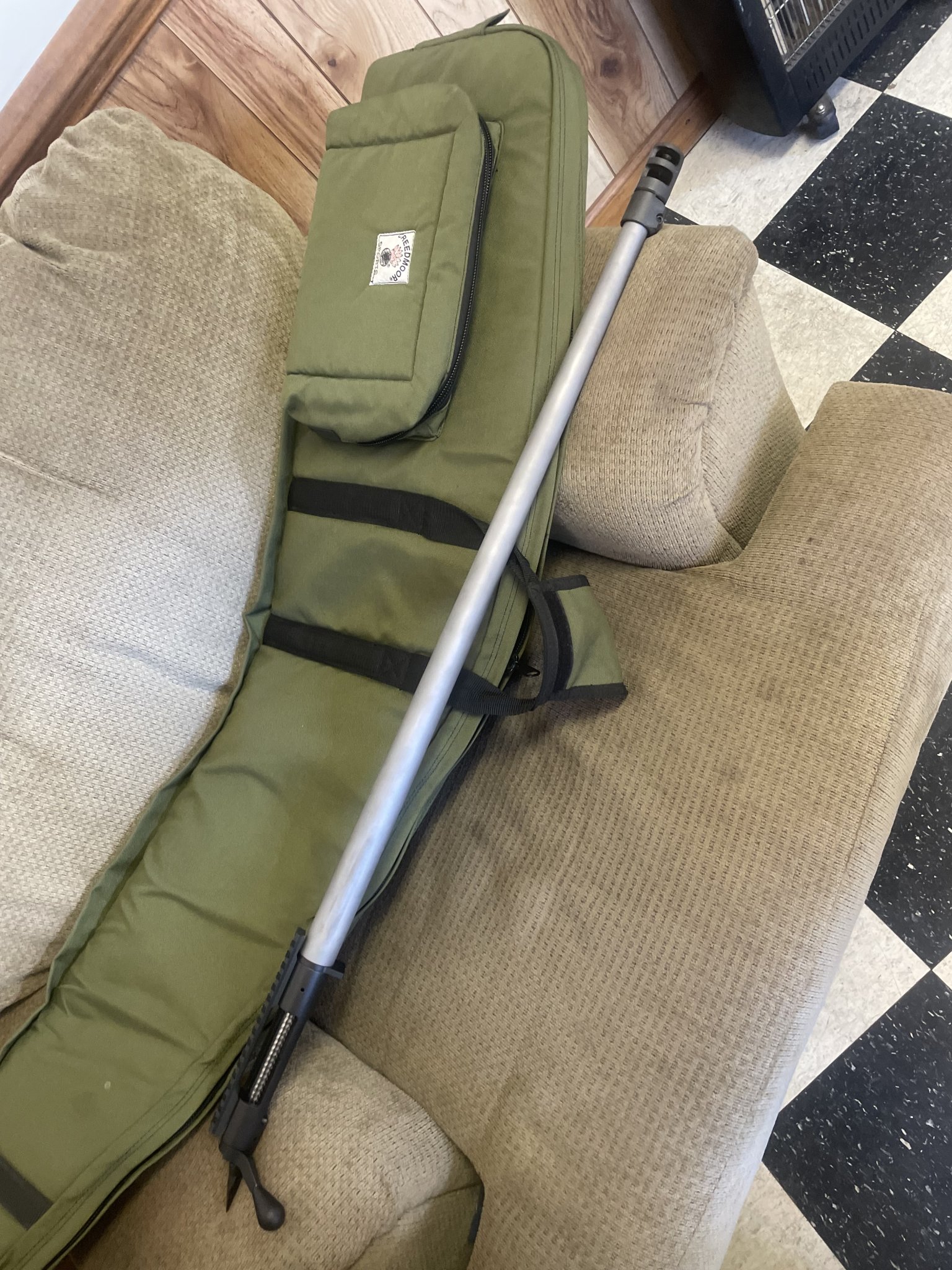

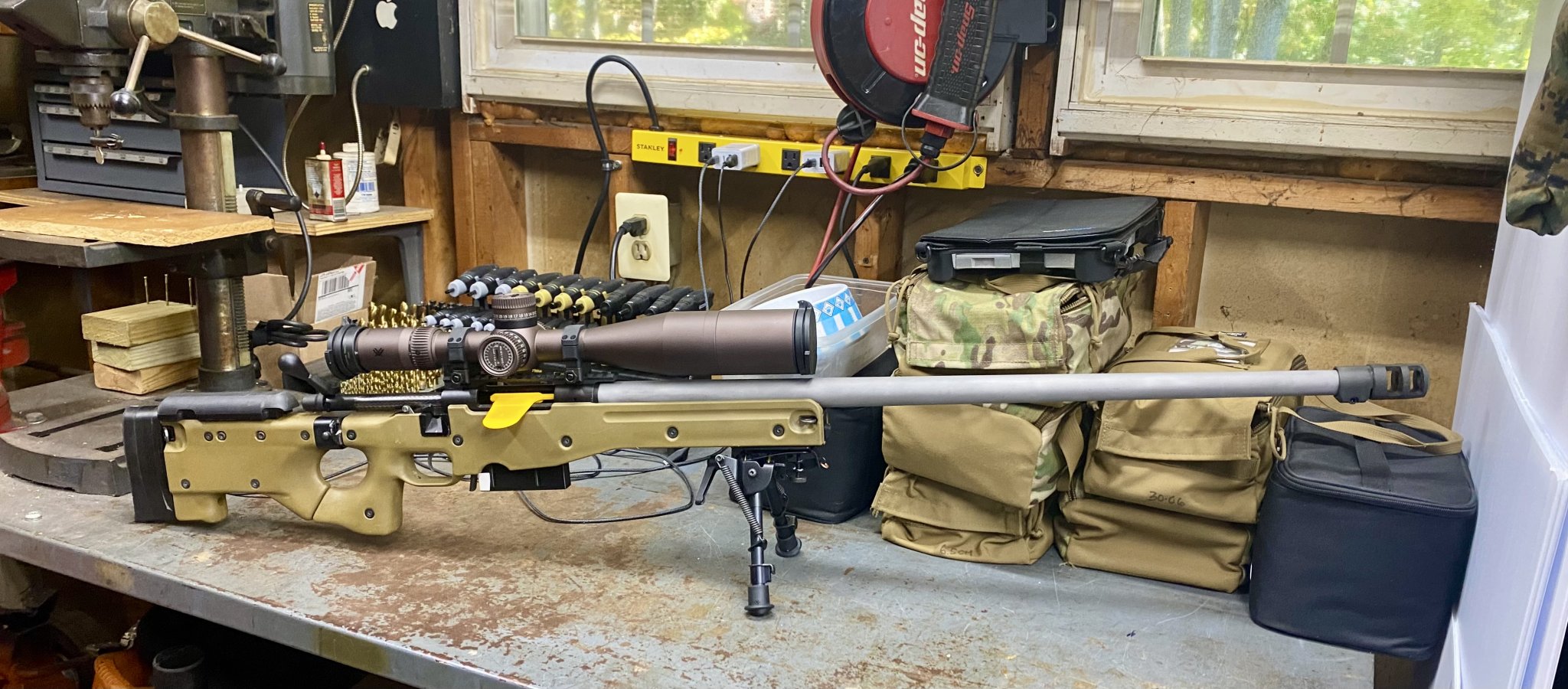

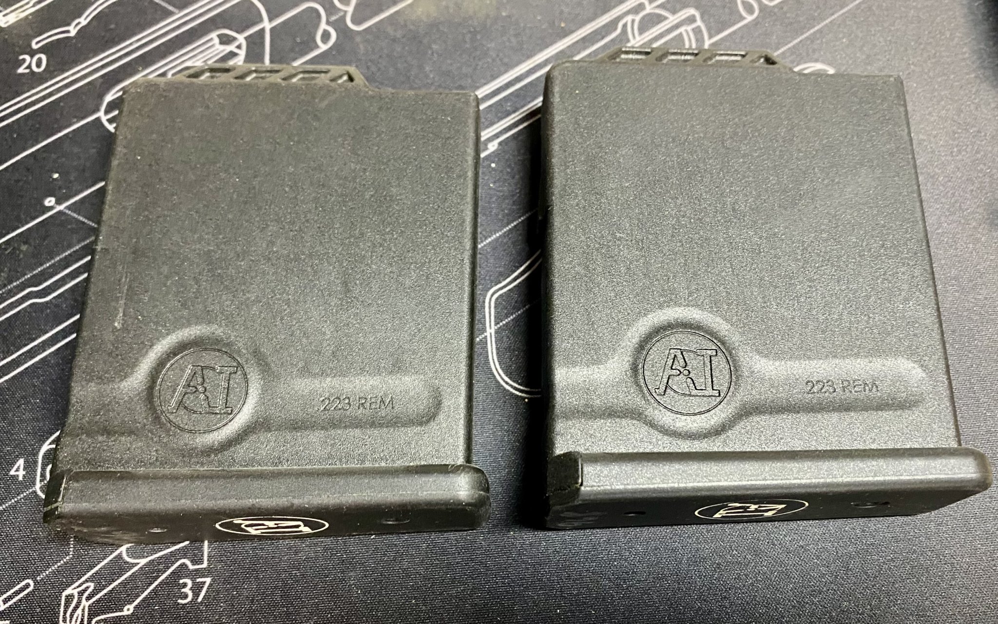

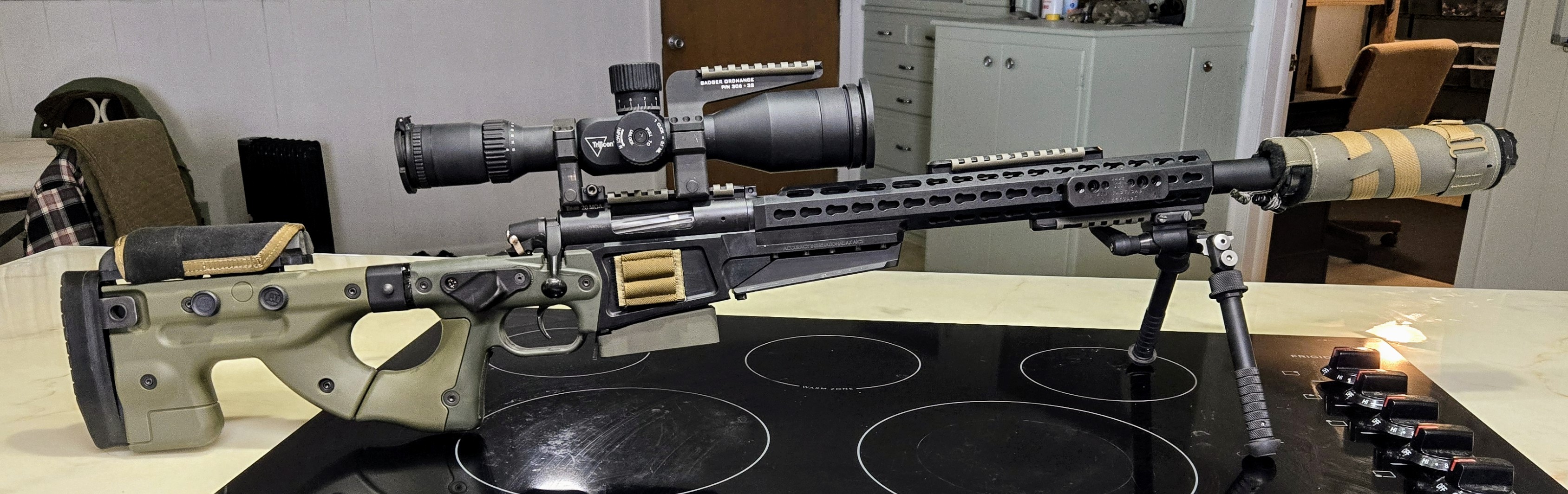

New build. G prefix R700 w/ bolt knob by @Hateca , circa 2005 AICS 2.0 SA, Jewel, Proof Heavy Palma 29” 224, Badger 20MOA base, Badger FTE brake, S&B PM2 w/ BO rings. Waiting on 223 Rem .183 FB Canadian FTR team reamer for 85.5 Berger Hybrids. First run AICS 223 Rem magazines from 2008-9 (can’t remember)

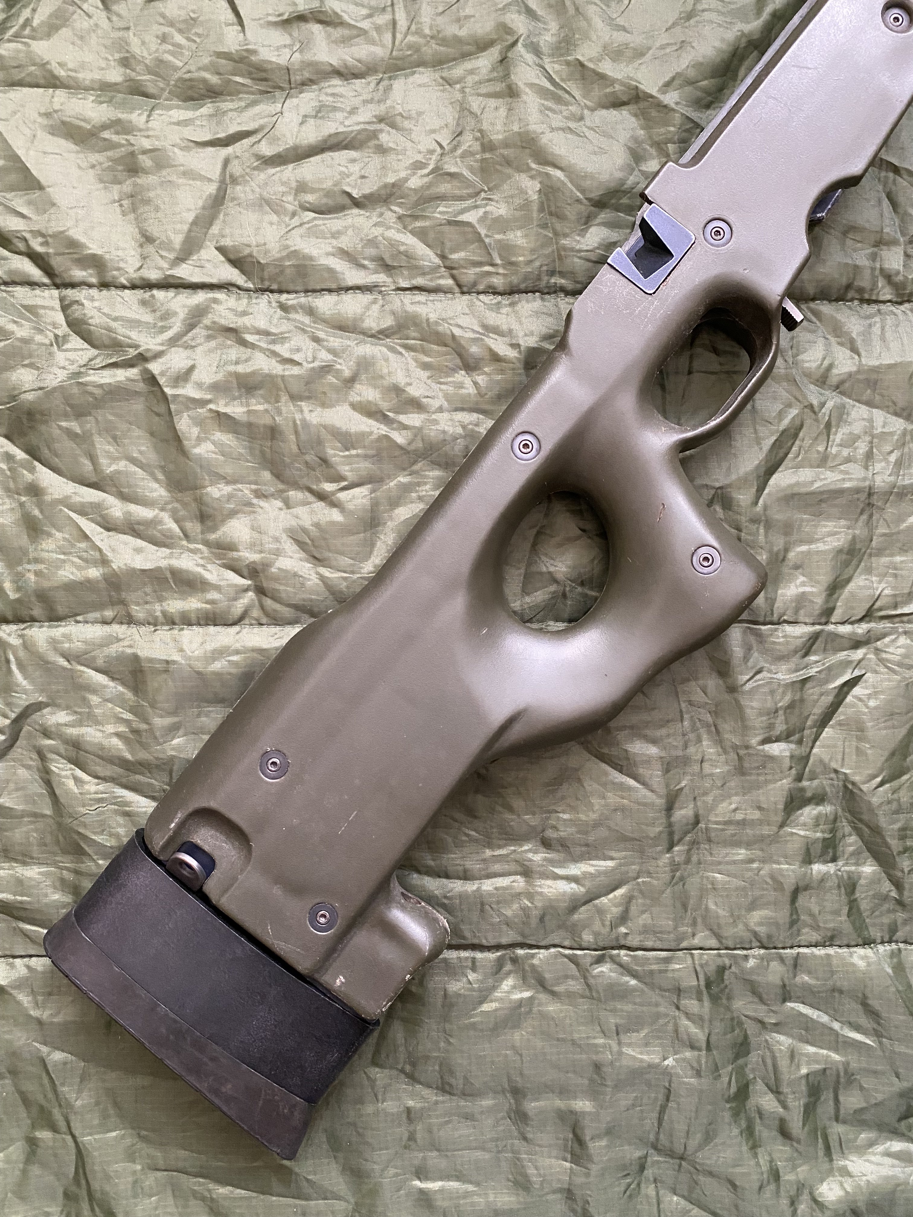

Isn´t that a AICS1.5 Folding Chassis? Looks like an amazing setup, though! I´d really like to see it assambled (y)
Though there are occasional odd balls, the legacy AICS chassis (and corresponding AW rifles the AICS chassis was based on) numbering is as follows:
1.0 = fixed (non folding) stock and fixed cheek (hump molded in the rear skins)
1.5 = fixed stock and adjustable cheek piece
2.0 = folding stock and adjustable cheek piece
Though I have seen pics of an AWM 2.0 that had rear skins with the fixed cheek molded in still. 🤷🏻‍♂️🙃

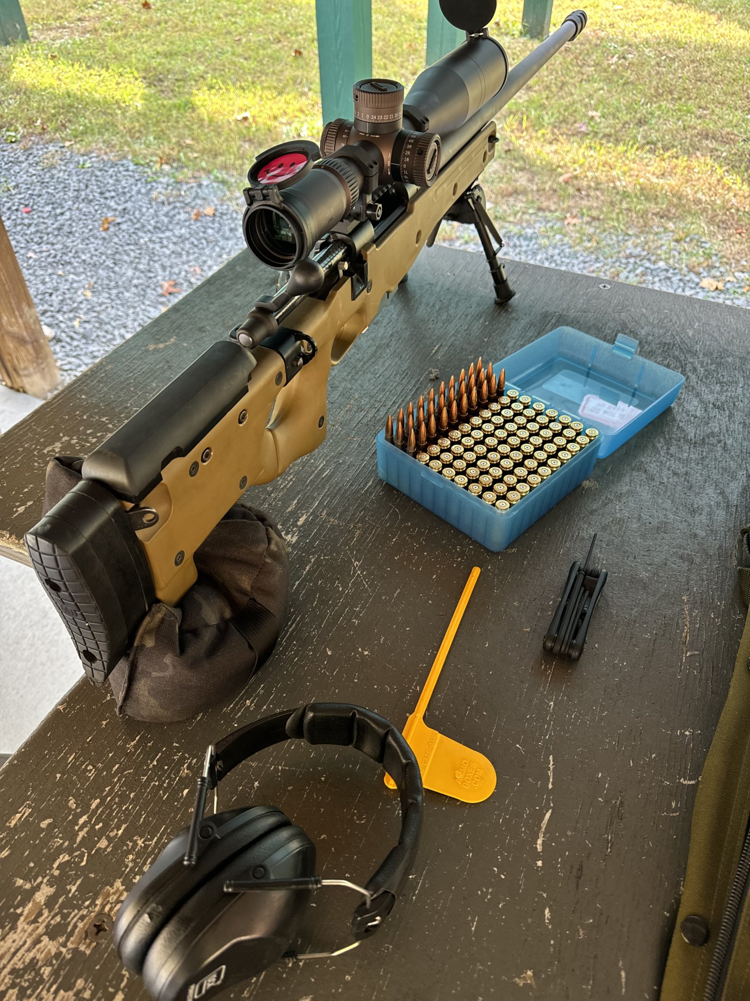

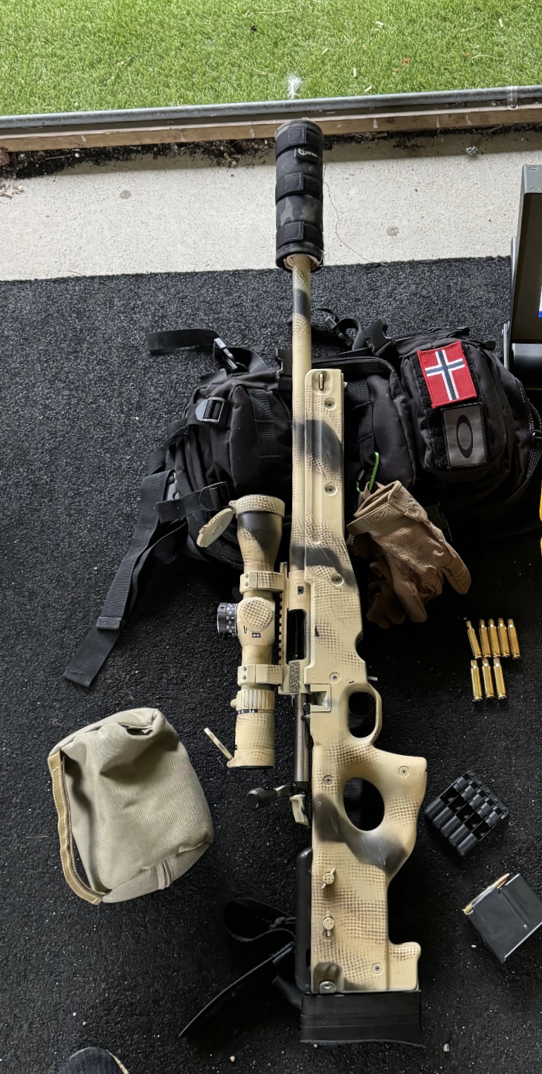

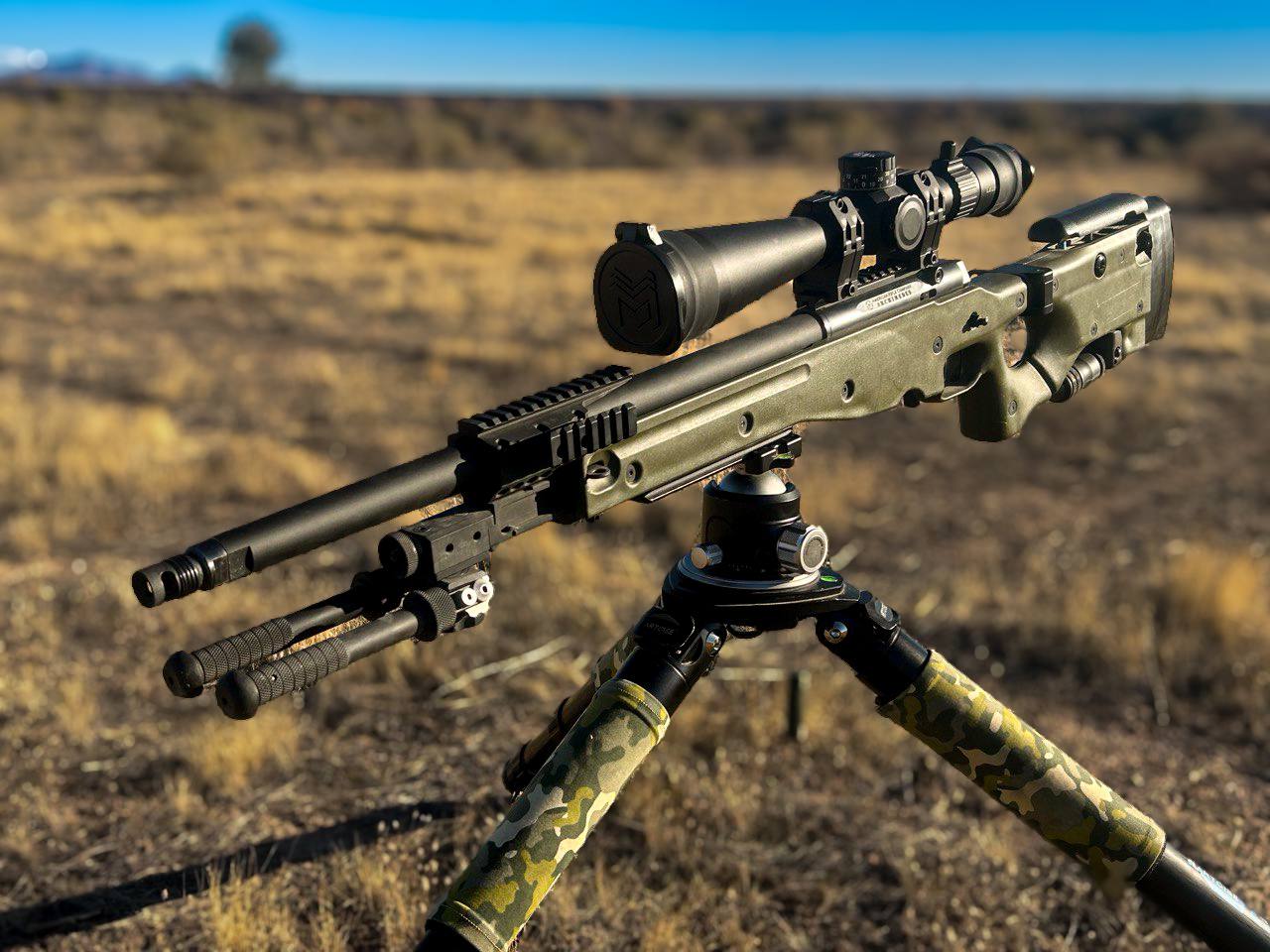

-AICS 2.0 SA, 6.5CM
-G prefix R700 action with M16 extractor
-20” M40 contour Bartlein
-Geissele Super 700 two stage trigger
-Badger rail
-Badger rings
-Badger IMUNS
-Leupold MK5
-Otter creek PR65L
-Sawtooth Rifles Arca

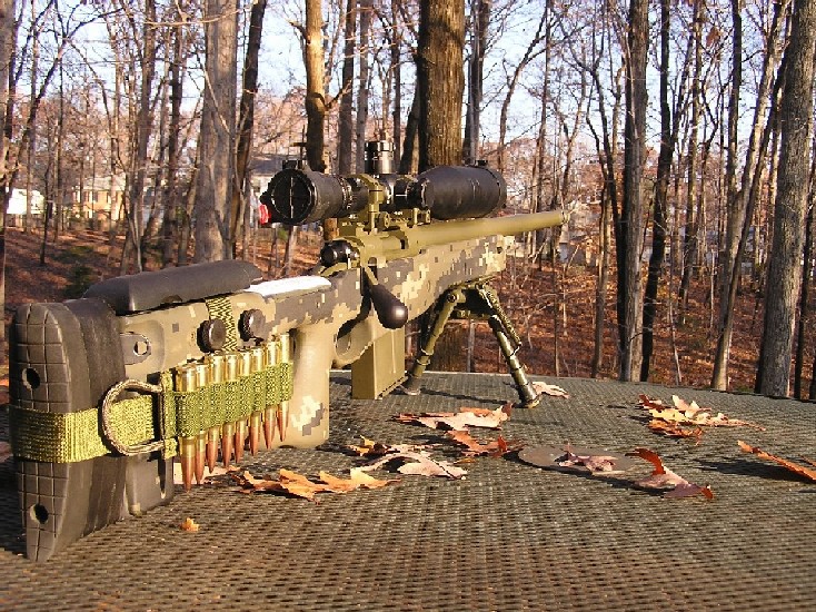

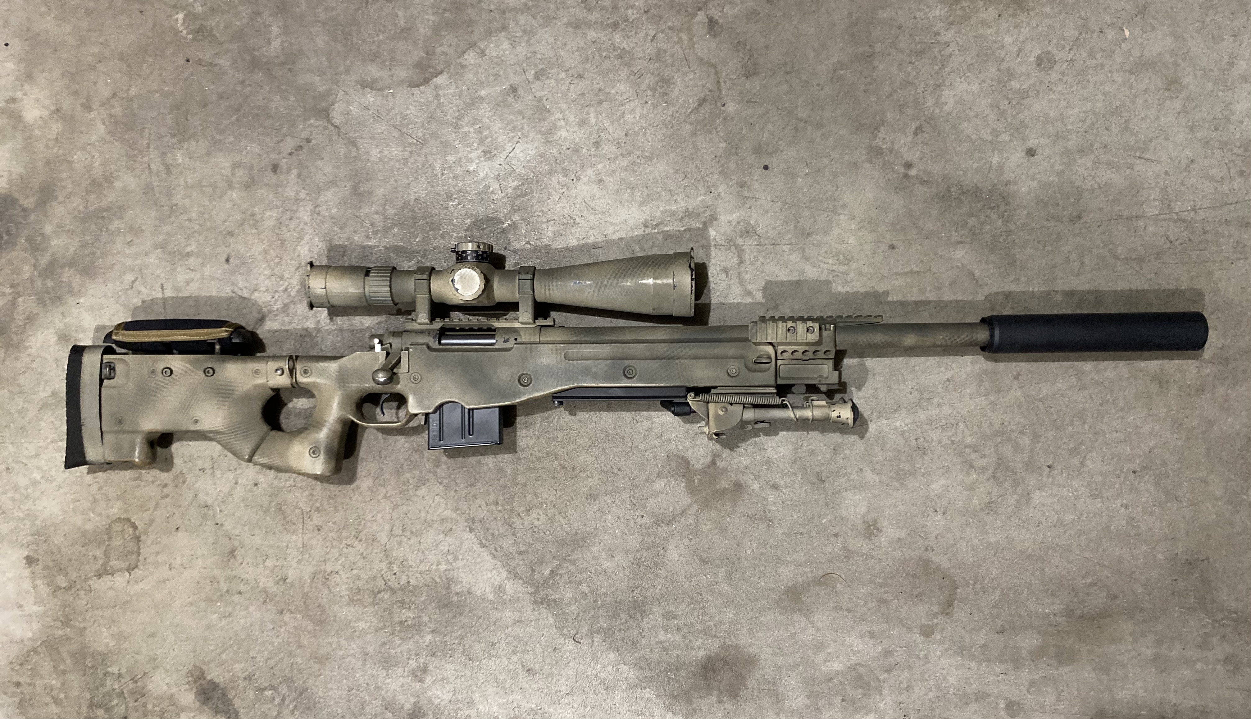

Since 2004, it’s the only chassis I’ve used for bolt guns. Here’s my very first one, an AICS 1.5 purchased from Impact Guns, a company that probably doesn’t exsist anymore. I think it was less than $500 and came with one five round magazine. Later, Sniper Country PX sold them, and by 2006 or 07, you could buy them from Midway USA. In those days a 2.0 was $850 or so, MSRP.
It was the hot lick in 2003-05, but then it fell out of favor with the cool kids and guys began selling them.
In those days, Tac Pro shooting in Mingus Texas was the US distributor for AI and it was the only place that had 10 round magazines.
I still have the skins for this thing, although the 1.5 skeleton wss converted to a 2.0 years ago.
And there’s a giant wooden deck in my backyard where this plastic table was.
Edited to add: picture was probably taken with a second generation digital camera that looked like a yellow camera.
Ooooh, early slant bolt opening. Is it welded or pinned, Ken?
The frame is welded. I’ll take her apart and share some photos. I actually have a 2.0 that is the same (fully swept back bolt handle notch and welded frame). Did not think the 2.0 folders were released that early on to have those characteristics…
Probably a 2.0 UK model that made it over here.

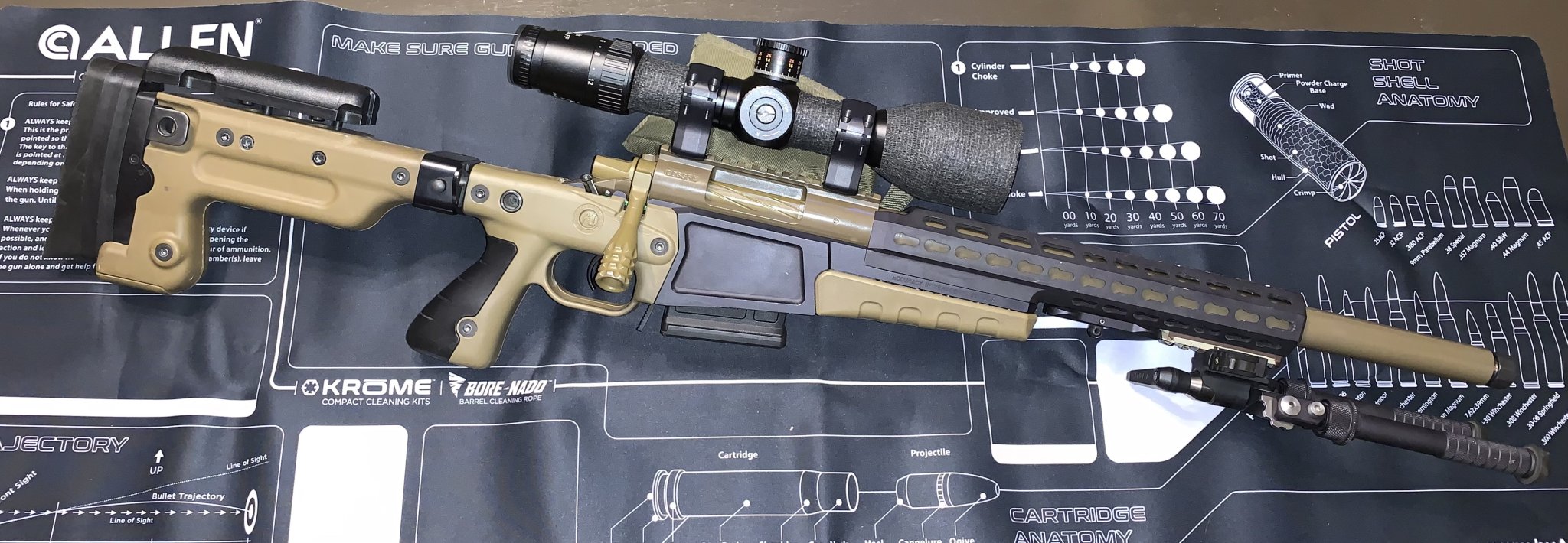

Thank you for that. Folder is/was definitely part of my thought process. My 300wm has a 26" barrel, so it fits in nothing. As much as I like it, I think a KRG would be a step back from my A5a, just to get the folder. I'm not versed enough in the product to know how correct that statement is.
I tried krg too and run one pretty successfully in prs for a season then sold it off. Again I’m more of a stock type of guy. With that I hated shooting anything other than short action calibers. It wasn’t until I shot the m2010 (300wm in a chassis) that I started coming around. A buddy of mine has a Remington 30-06 in a post 14 AIAX chassis and it’s nice to shoot. If it weren’t for the weight of the chassis I’d put my Bergara 300wm in an AIAX.

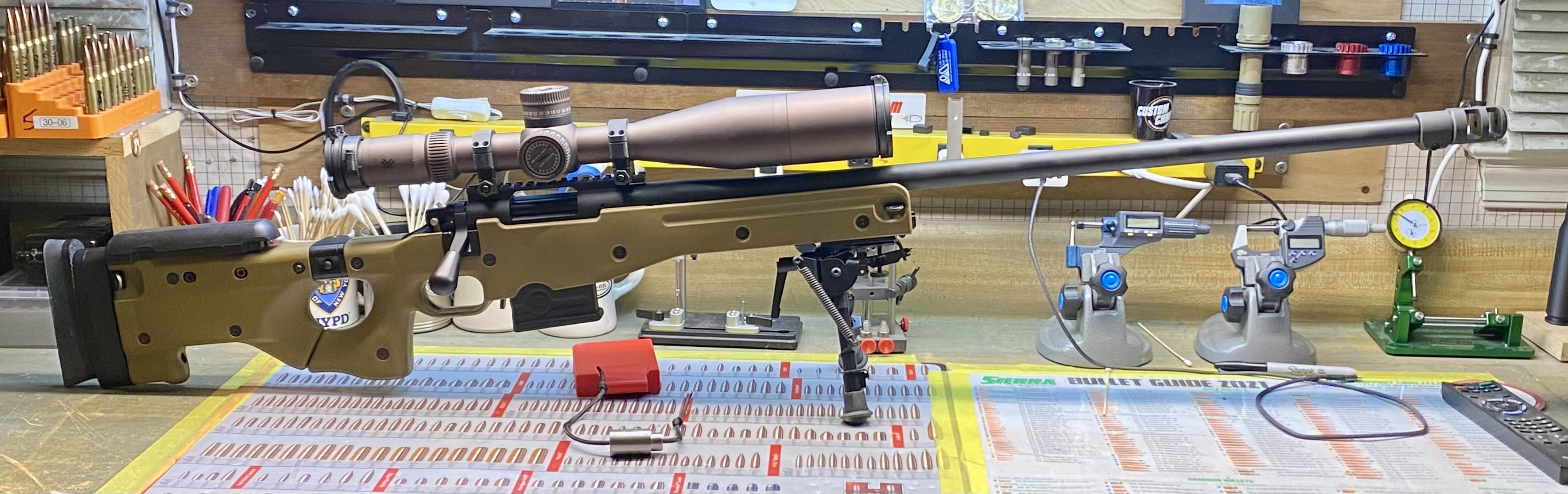

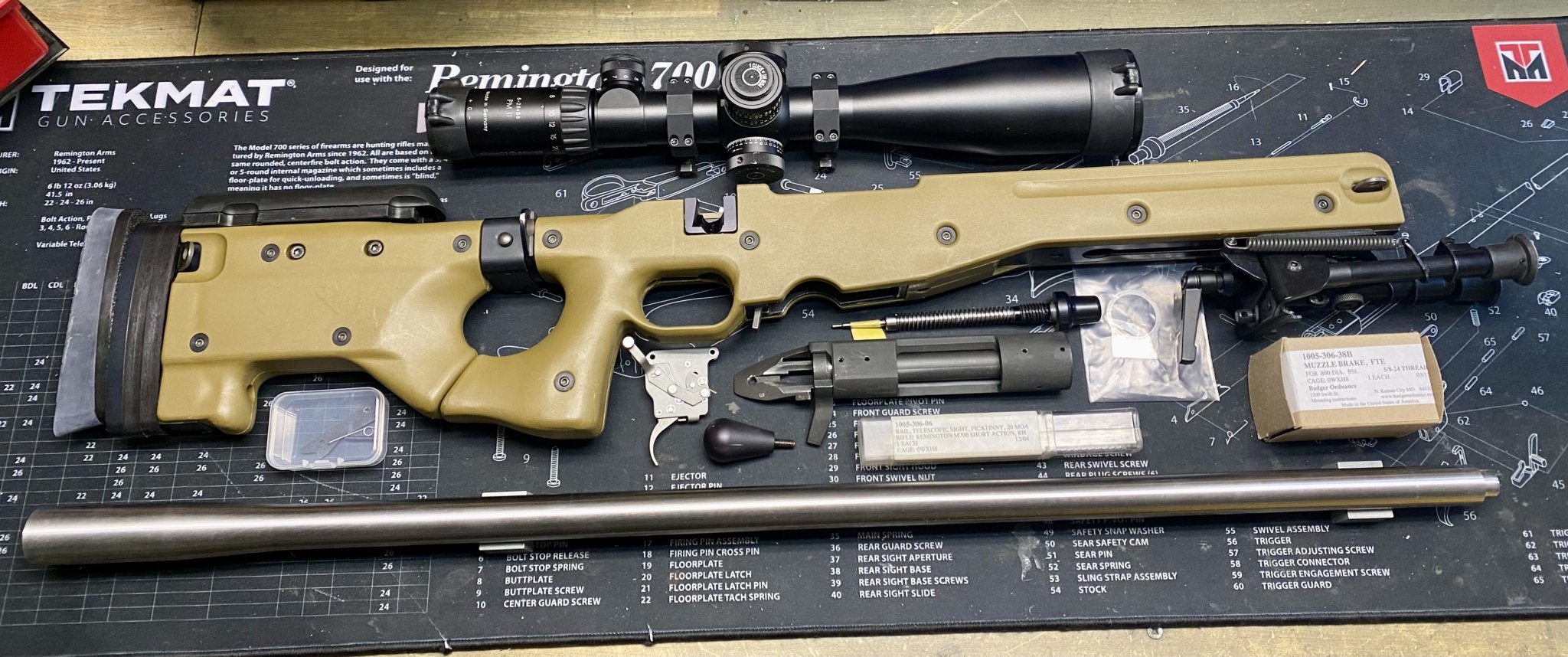

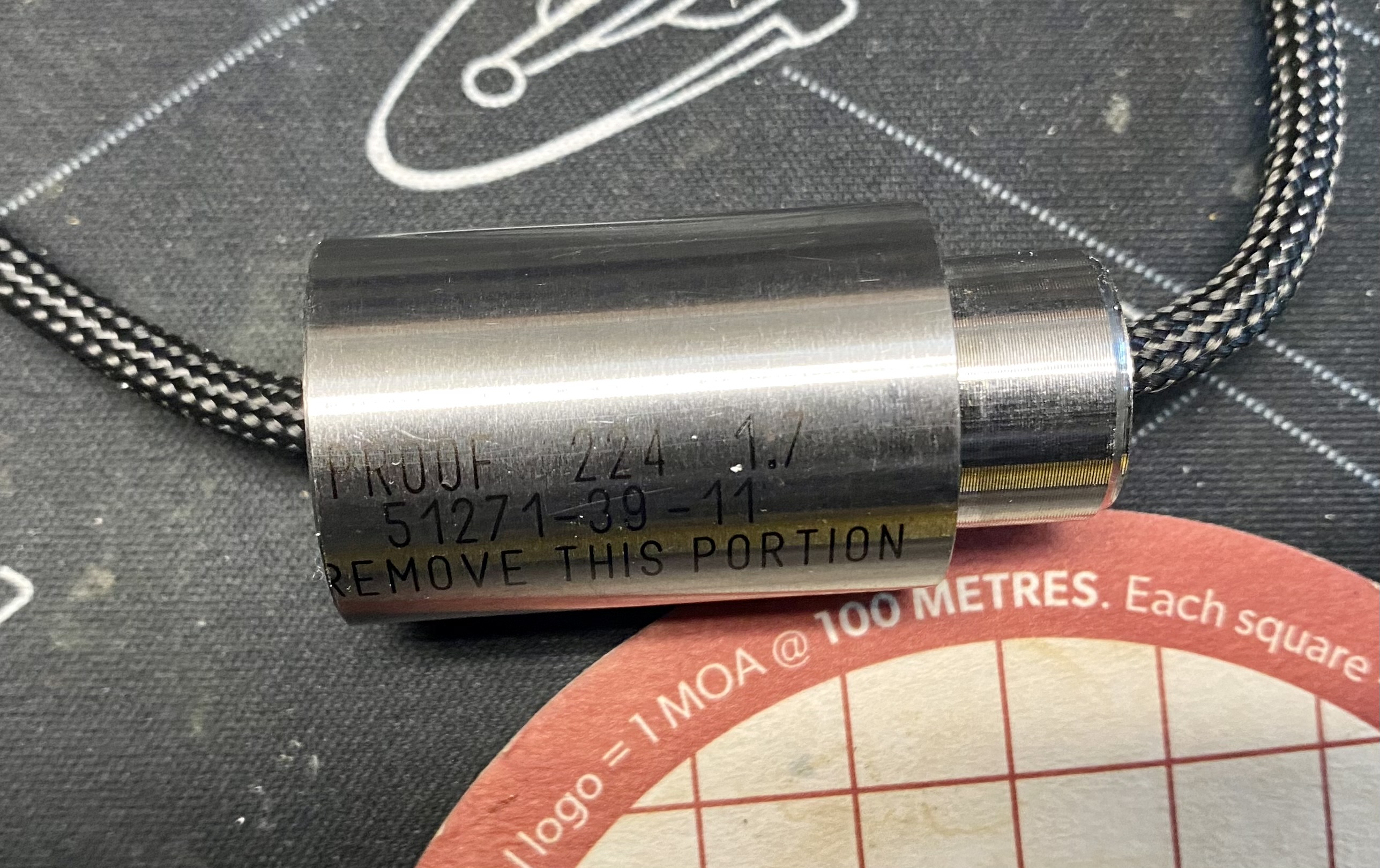

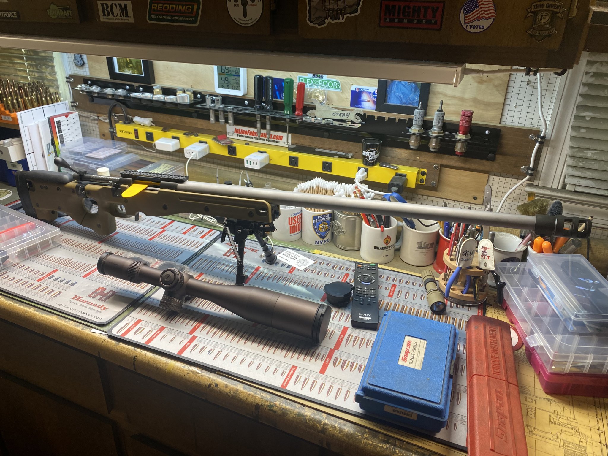

Go my stuff back from my 2112 this morning and assembled it. He even saved me the “Remove this portion ” end of the barrel.
This is a 7 twist 223 build with the Canadian FTR team reamer: .183 free bore for 85.5 hybrids and 90VLD Bergers.
Decided go go with a spare G3 instead of the PMII for the time being.
Reamer has .183 free bore.
Longer free bore means bullets can be seated longer, meaning more case capacity is available.

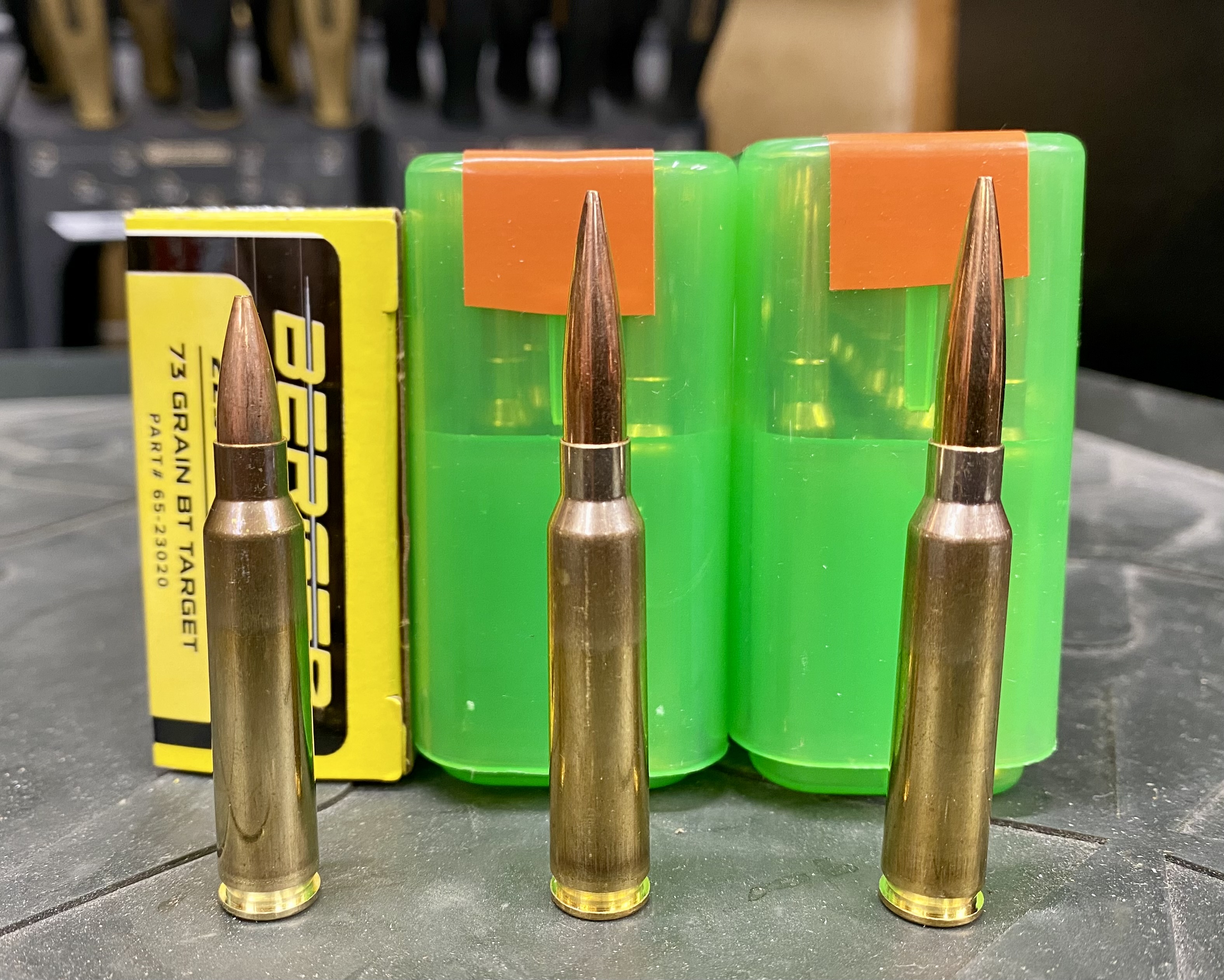

From left to right:

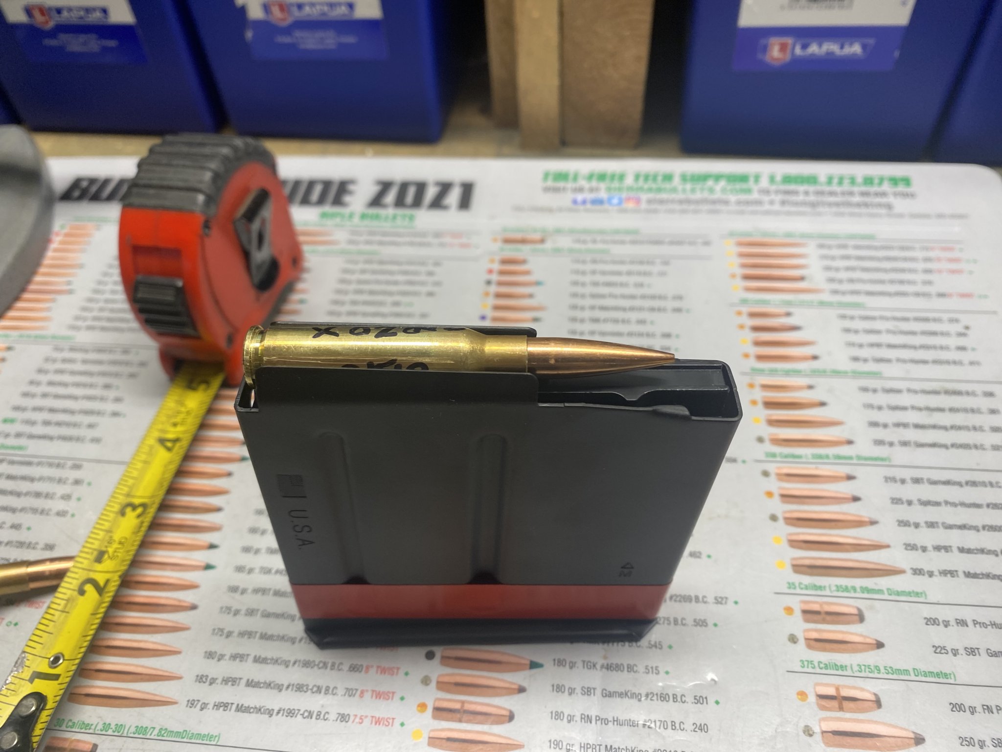

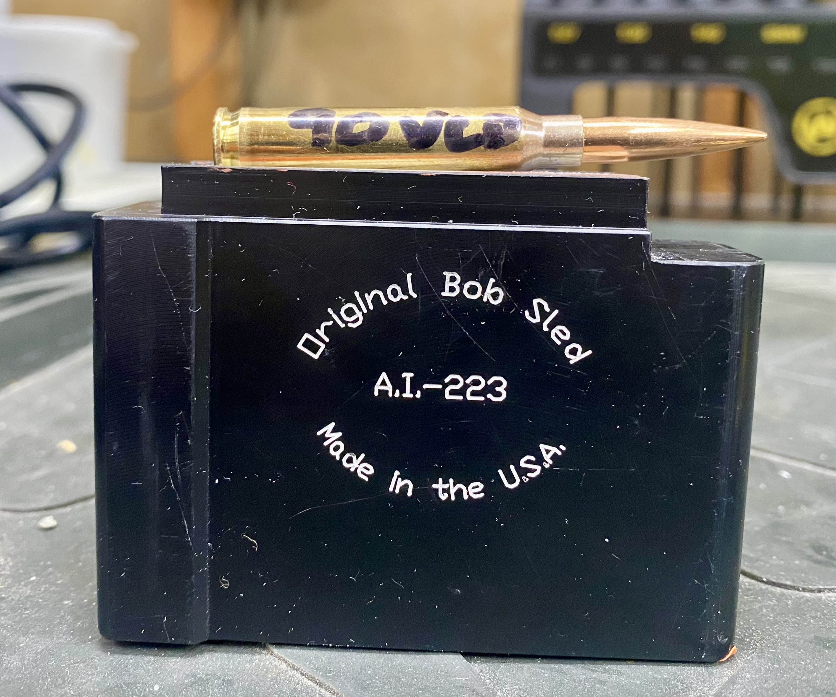

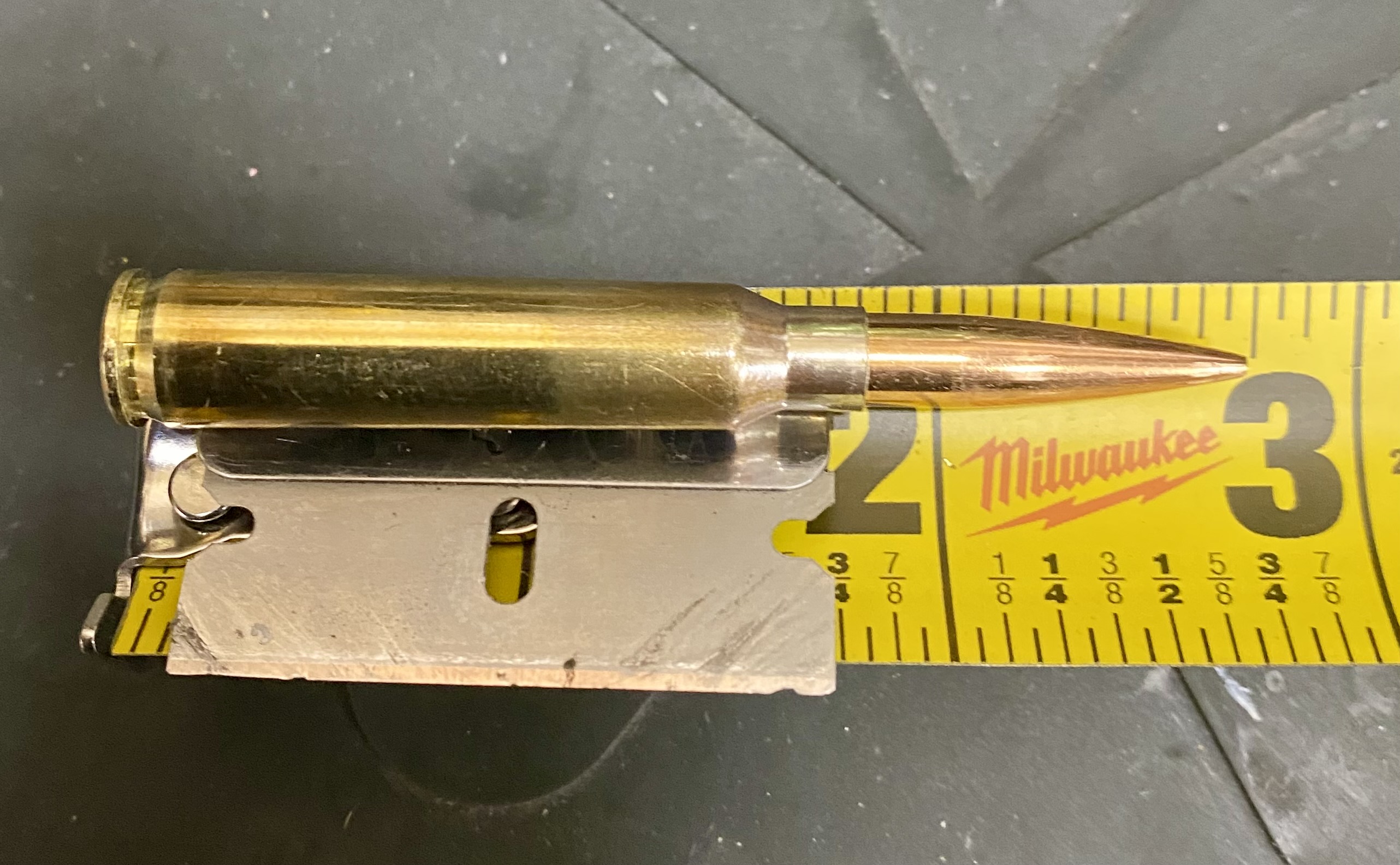

Berger 73gr BT Target, Berger 85.5gr Hybrid, Berger 90gr VLD. The two latter projectiles are currently a significant distance off the lands. This’ll change as load development advances, or not.
Berger 90gr VLD.
Modified sled to tip long pointy rounds up so they don’t crash into the feed ramp or the face of the barrel when moved forward by the bolt face.

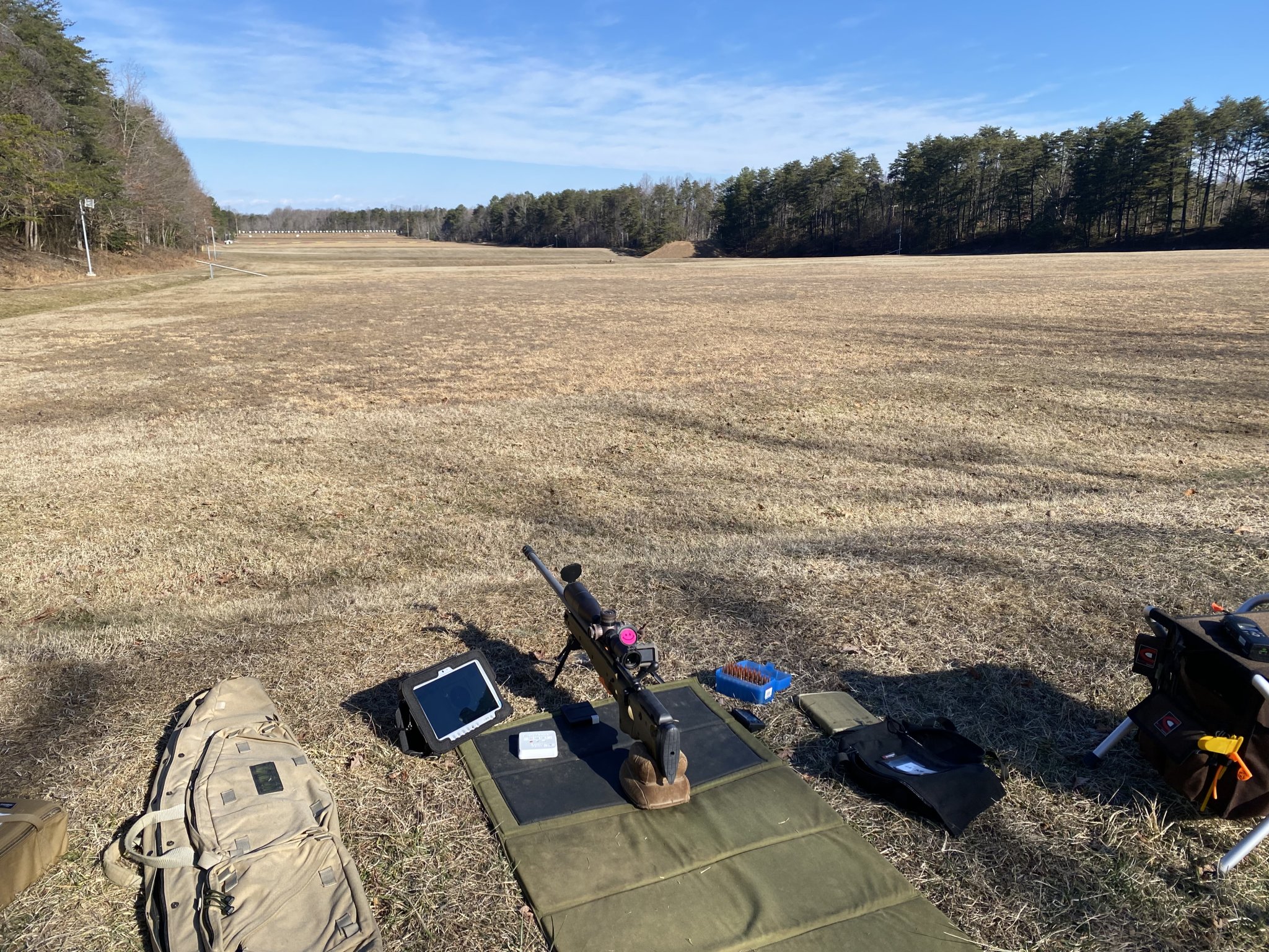

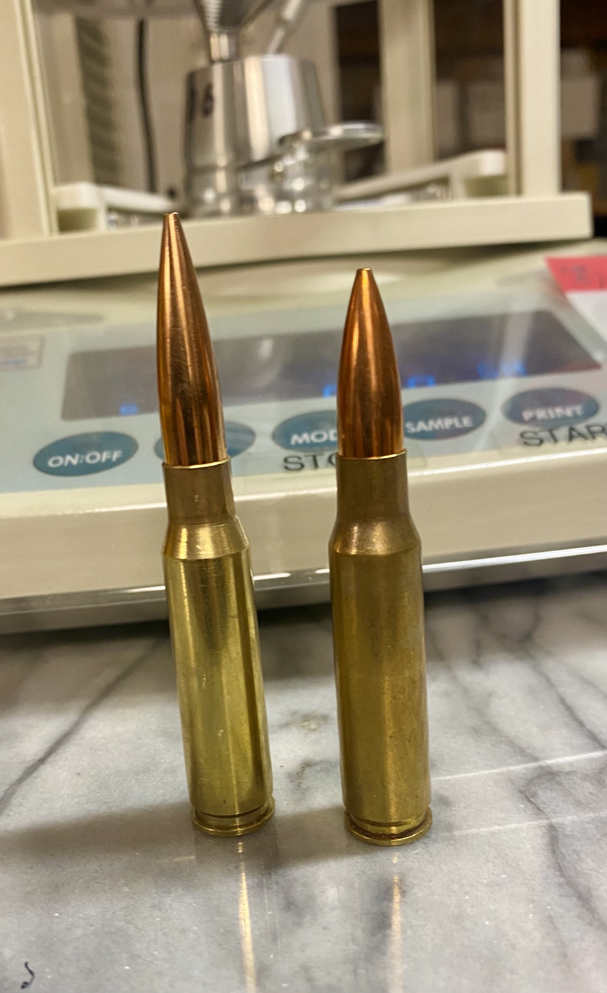

Speaking of doing shit the hard way, I’ve had real success @ 1K with the 308
load on the left.
200.2gr Berger 20X hybrid left, 175 SMK right.
I also run a 30-06 at 1K with 300WM velocities, but that’s another story.

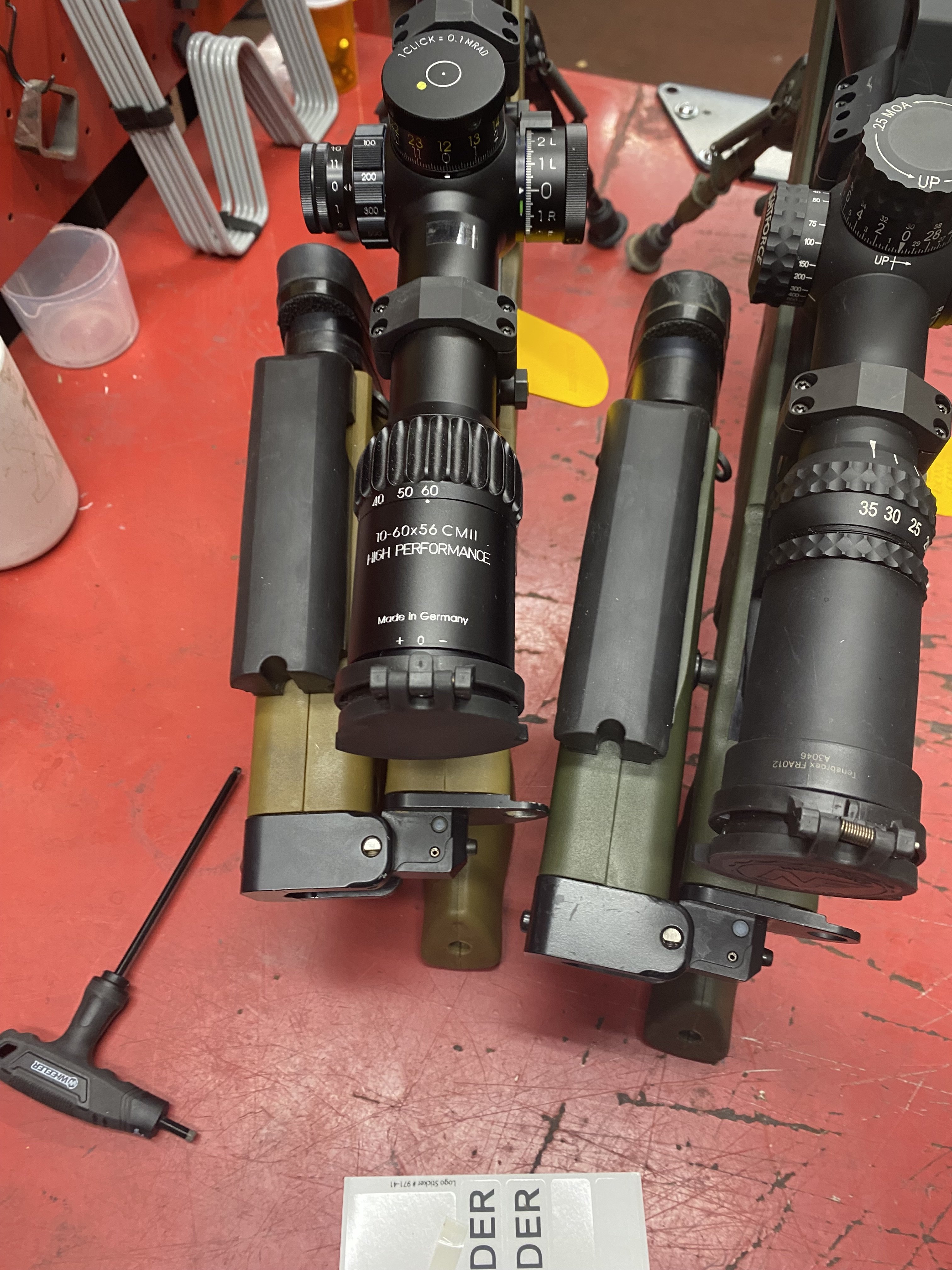

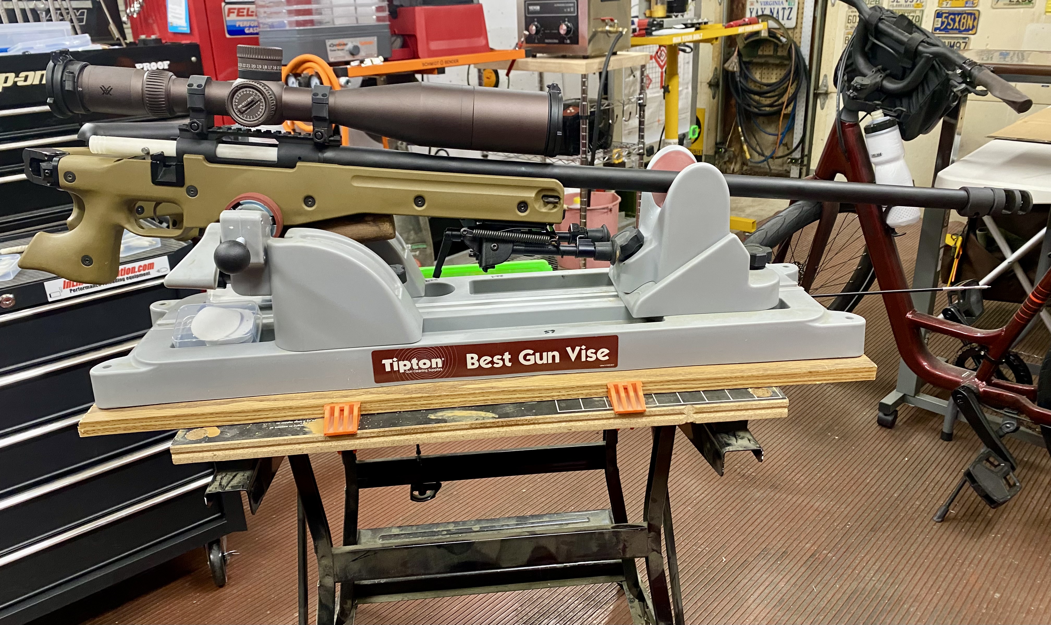

I recently got a complete AT folding butt assembly that had suffered a broken bolt for the butt pad spacer.
I knew ahead of time that if I showed up at my favorite machinists place with a complete butt skeleton he’d laugh me out of the shop so I had to disassemble it.
Make sure you remove the rubber anti rattle disc for the rear sling attachment before you get started, if you haven’t already lost it.
First step was to remove the hardware for the vertical portion. These screws are often installed while the epoxy is still wet so it’s necessary to heat them until the epoxy joint smells like burning hair- about 350F with MAPP gas. After that, the screws come right out.
Then it’s a matter of heating and driving out the vertical portion of the butt with a block of wood and a hammer. Don’t freak out when you discolor the black anodizing; just smear oil on it after it cools and it’ll be fine.
After a trip to my buddy’s shop:
I decided to go with green:
And add it to the collection for future conversions of 1.5s to 2.0s.
The black one is from a left handed AT.
It can be converted by flipping the hinge.
