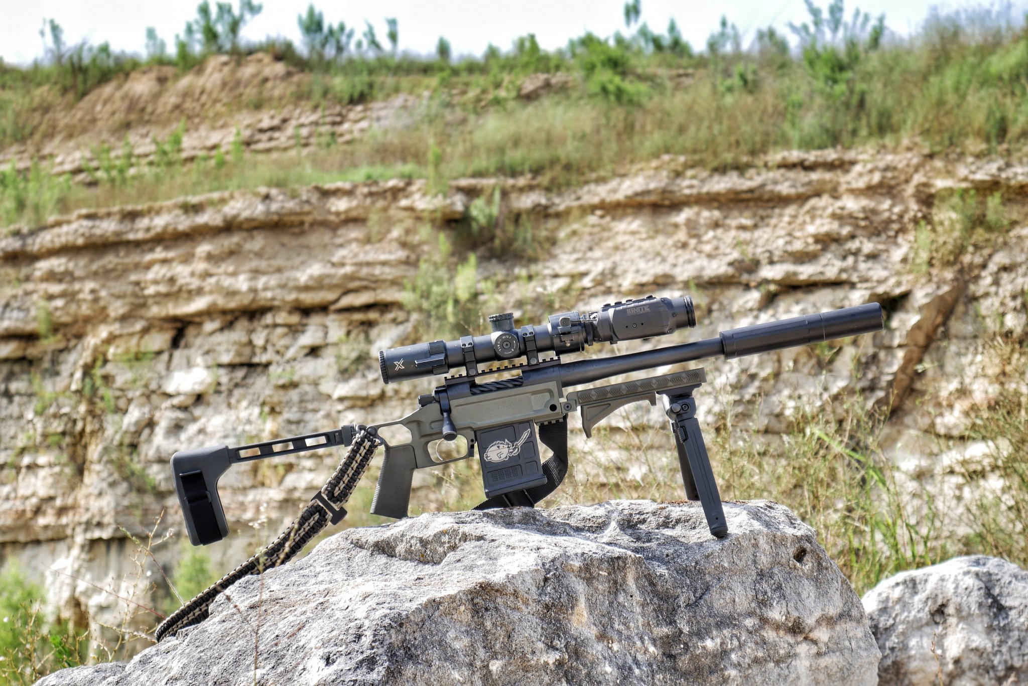

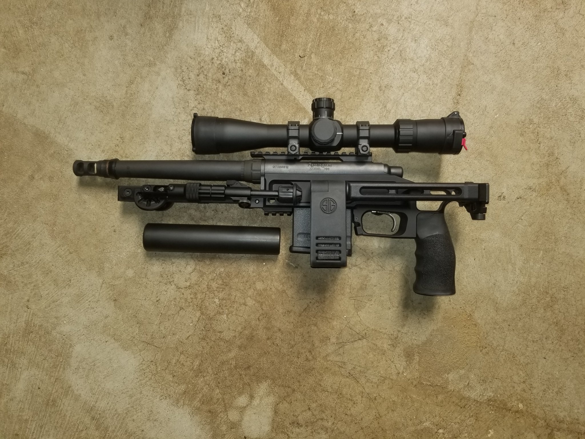

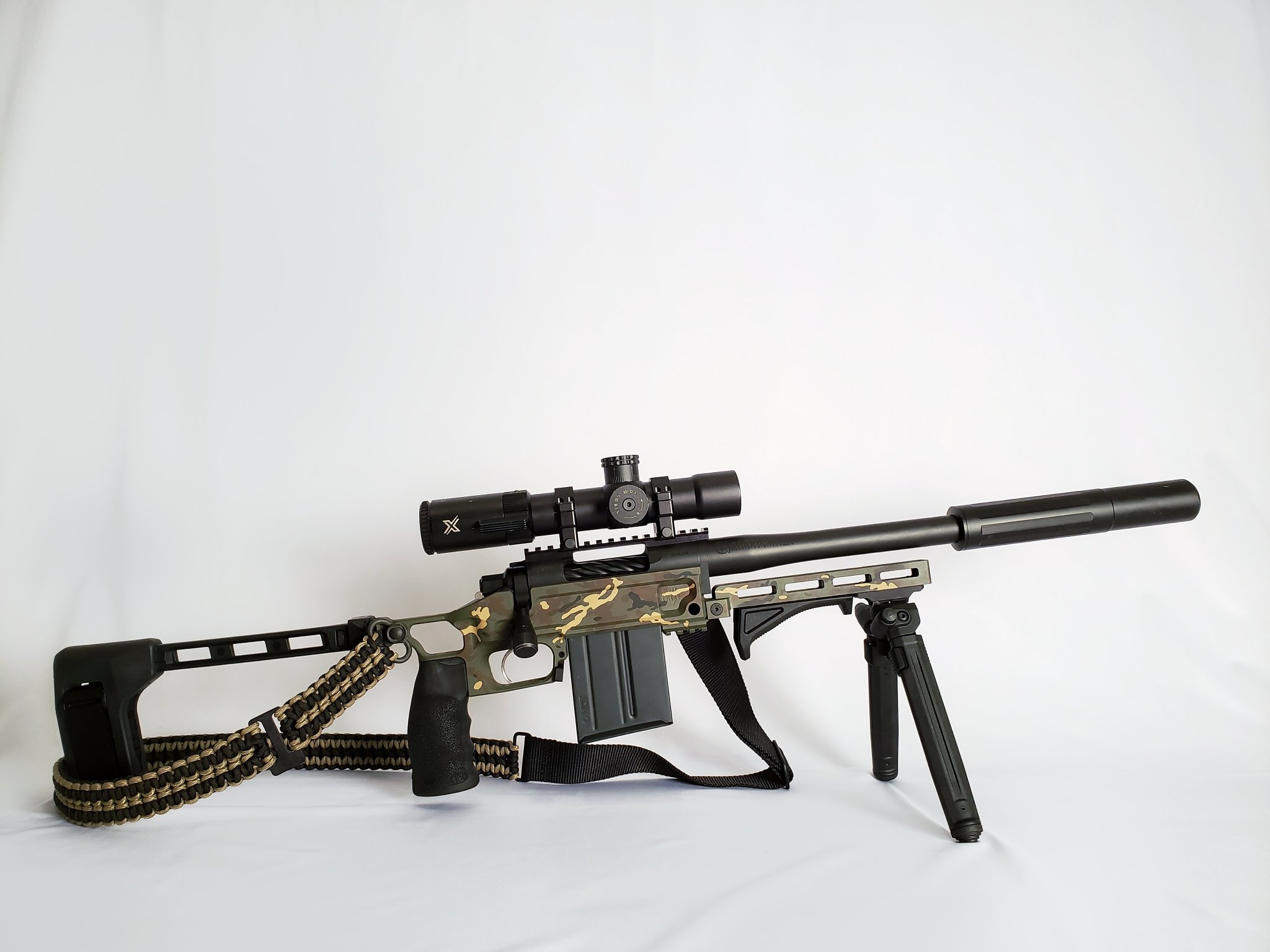

Here is a shorty 300 Blackout I built. It has a 3.5" barrel screwed into a Nucleus action that is sitting in an XLR Carbon chassis.
I called an asked and they did not have plans to make a version of their chassis that takes AR magazines. If they did I would buy one tomorrow.

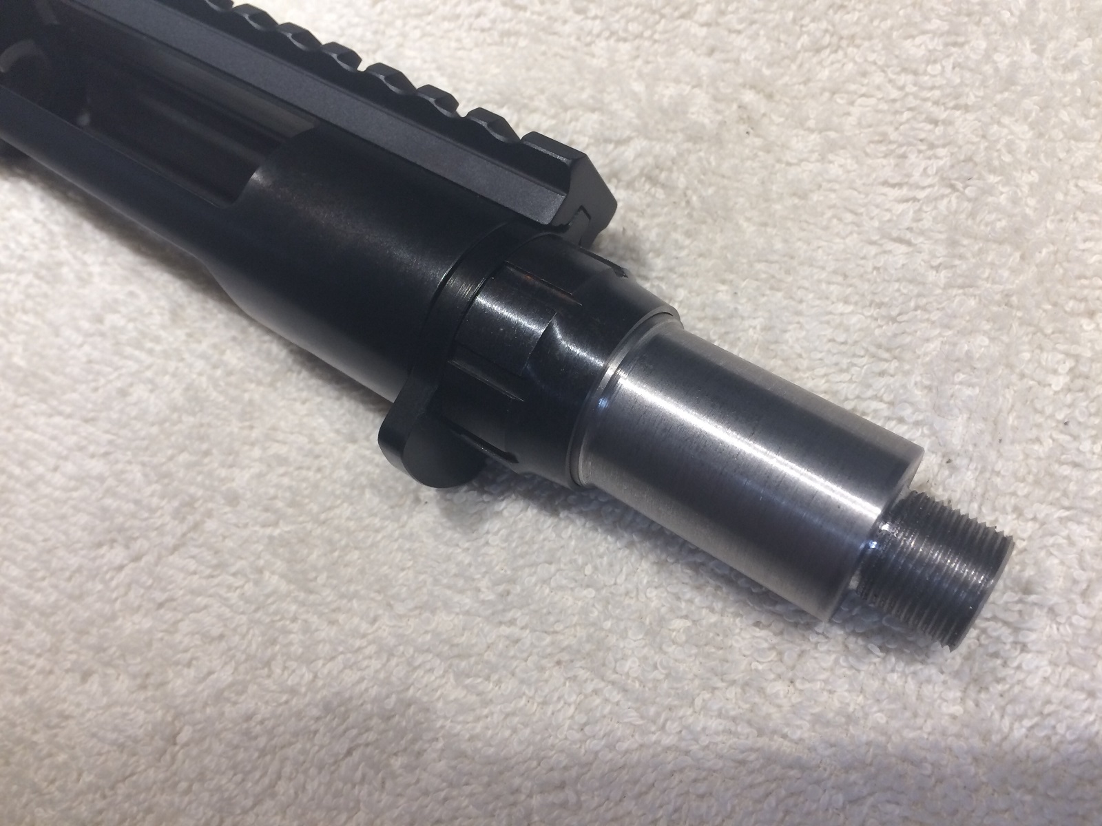

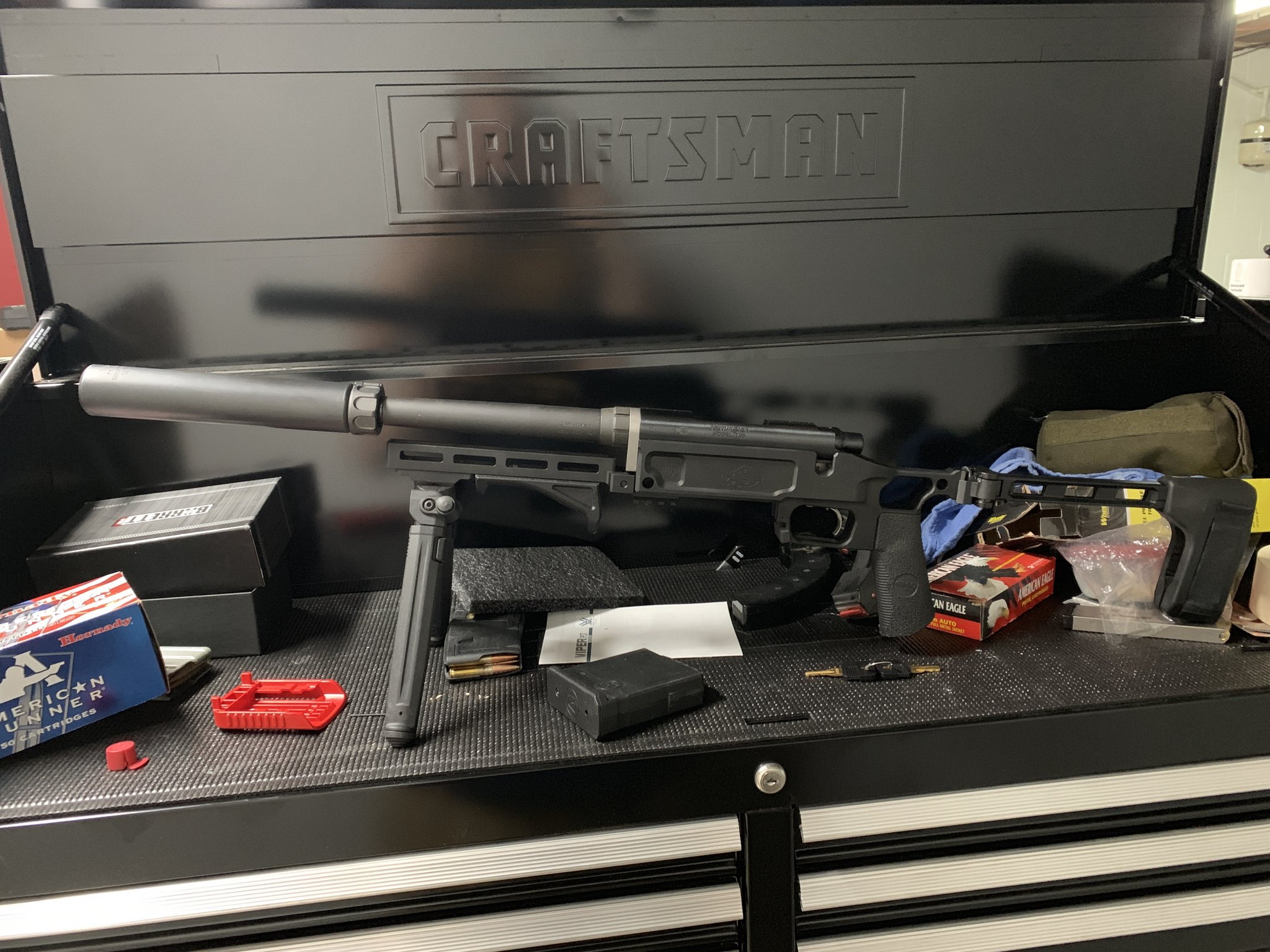

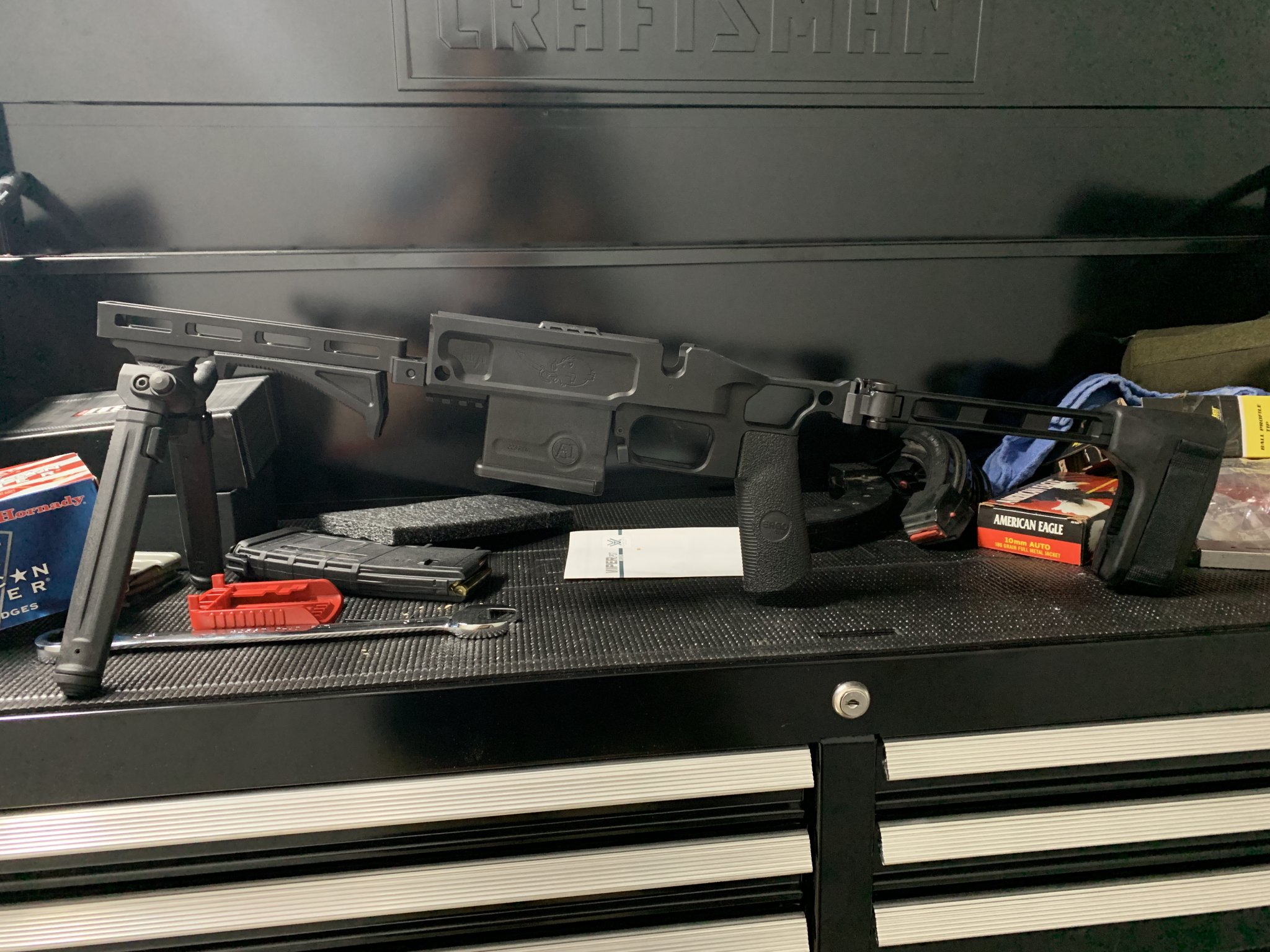

Learned a valuable lesson. Badger 0.313” recoil lug is too thick. Can’t get appropriate headspace. Headed to get a factory one from my Smith. Looks good tho lol

I'm assuming it's 300blk? What did the total weight come out to?
I already have a couple of blackouts, but the idea of a sub 8lb, 12.5" 6.5 Creedmoor with folding stock is really getting my gears turning.
Reactions: TheChief
Yessir, 9” 300blk. Headed to feed, will weigh it this evening and report back
Approximately 8.4 pounds without suppressor. 9.6 pounds with the surefire

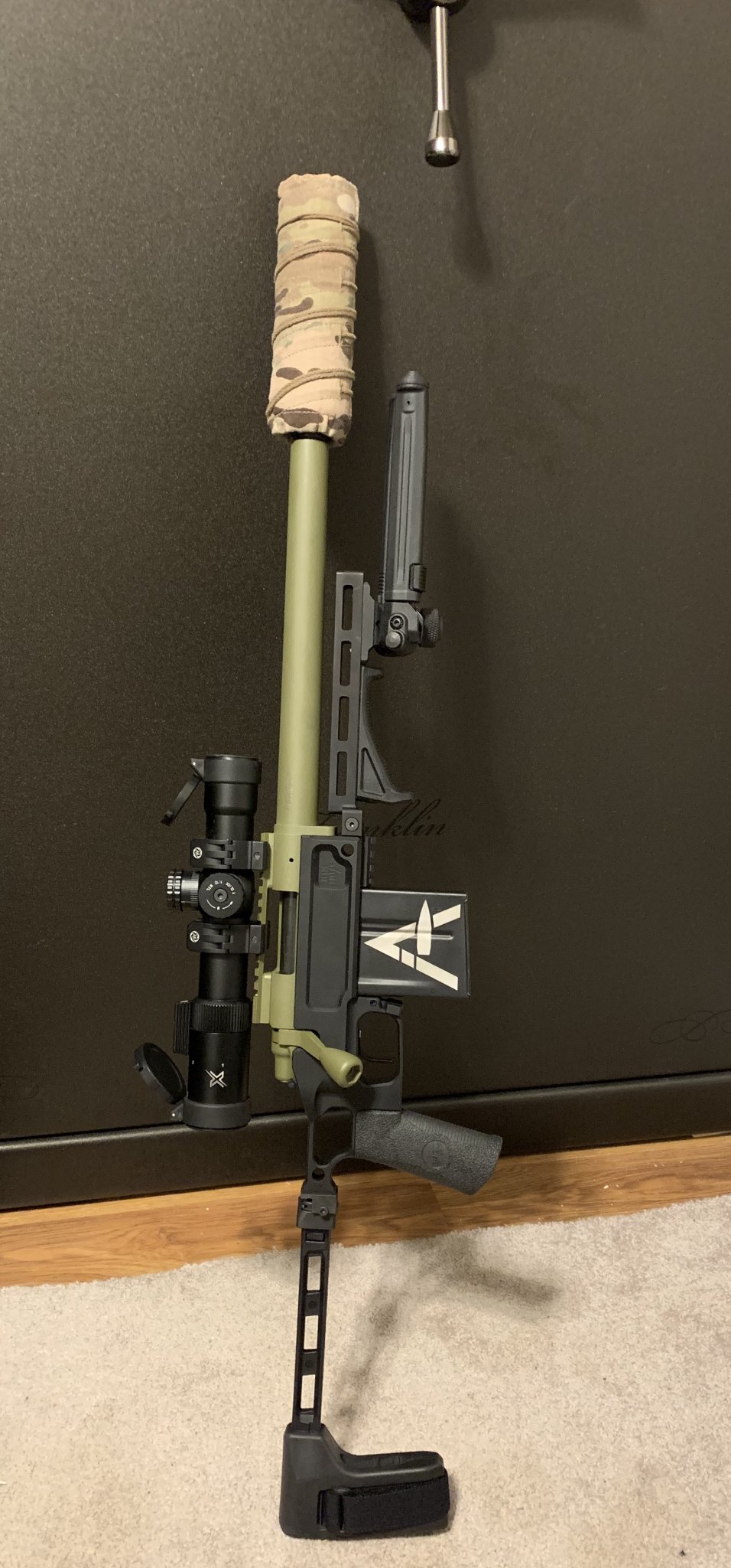

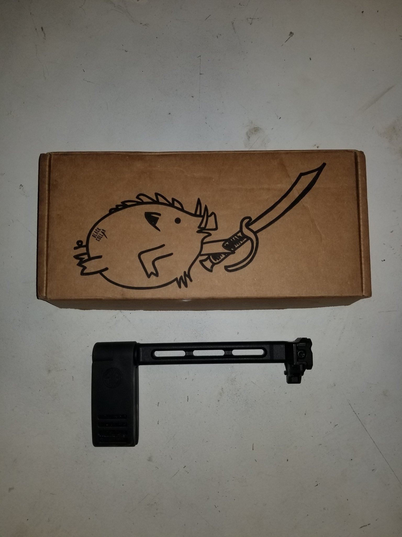

Finally got it together
Peace and love......
Can’t wait to hit’em with the Pork Sword!
Looks great!!! ?

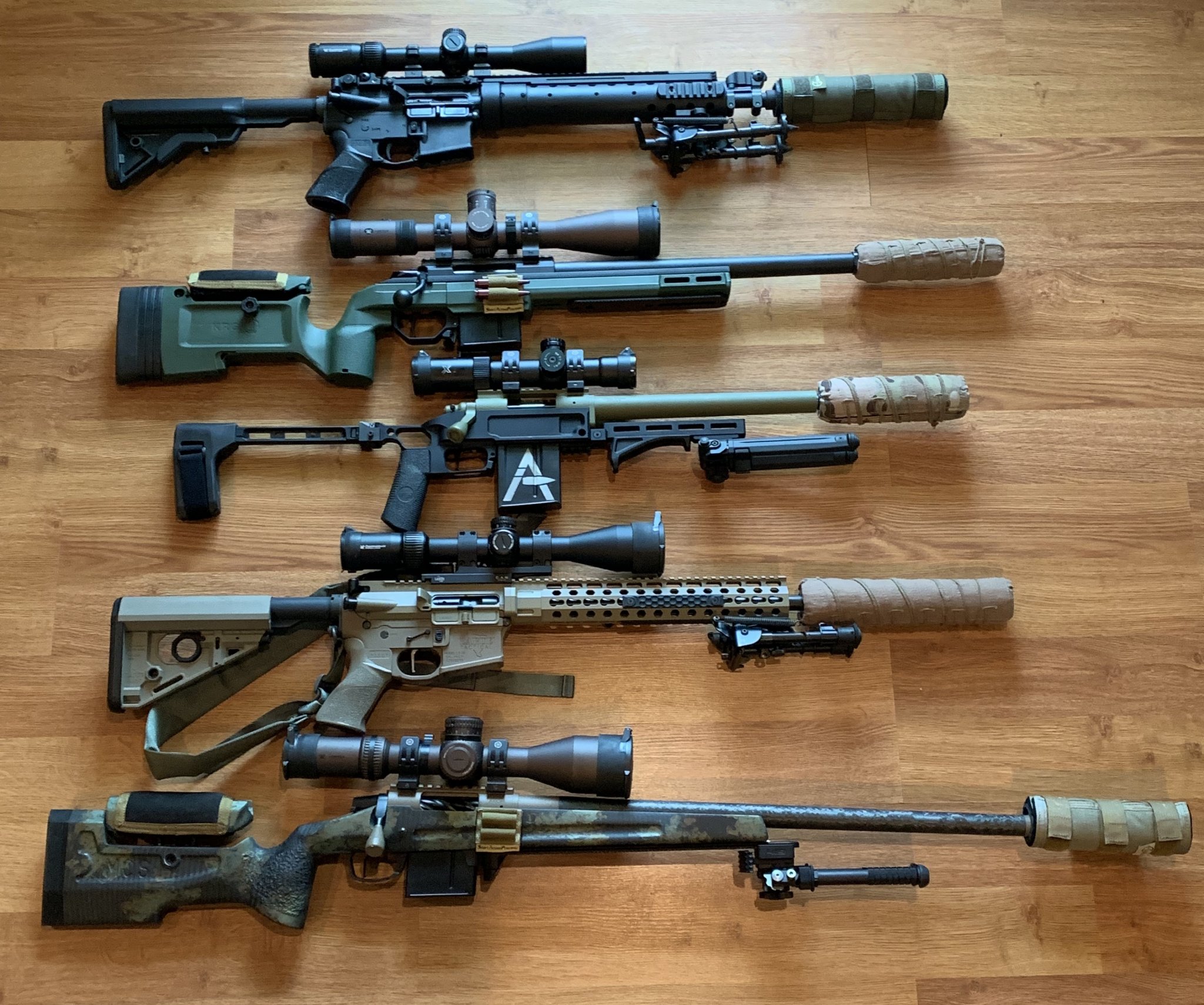

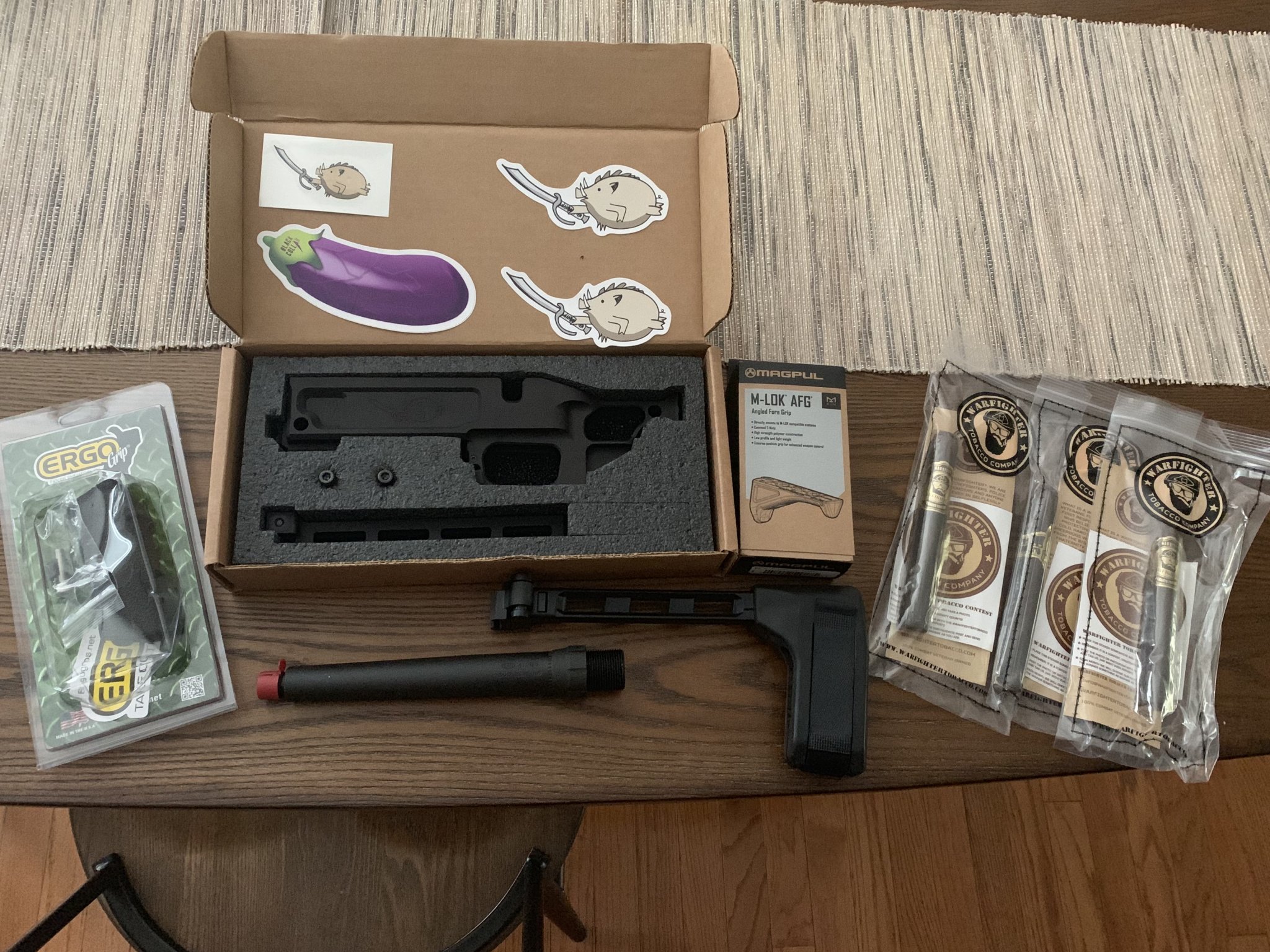

I got my chassis yesterday... hopefully, build pics will follow soon.

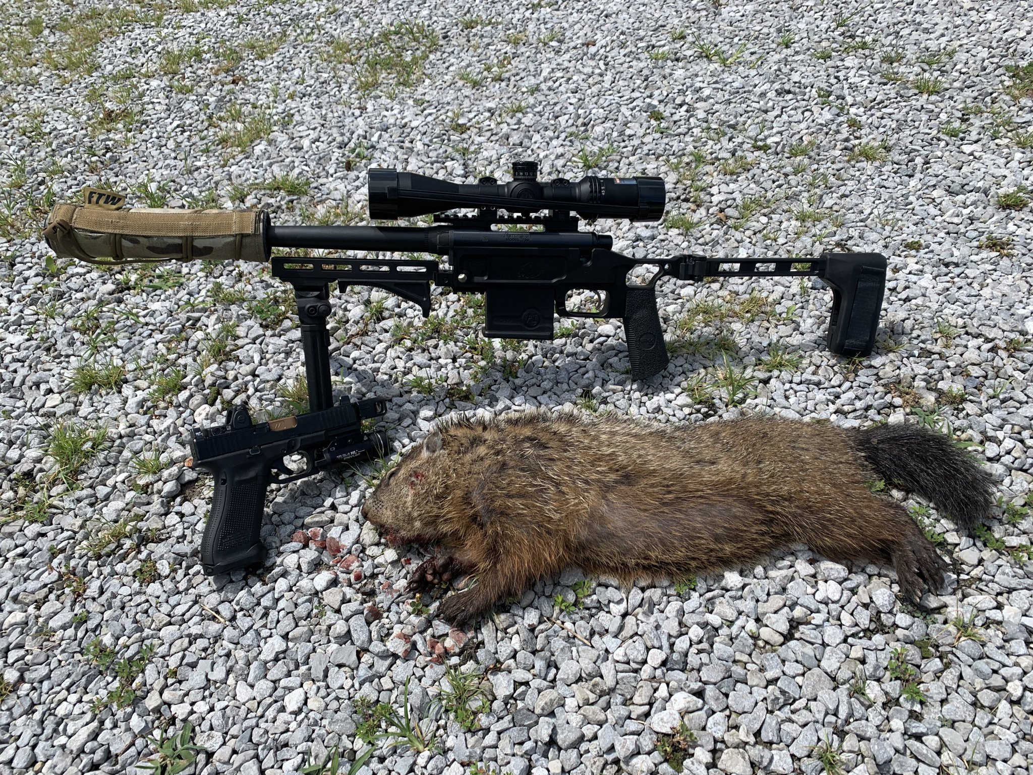

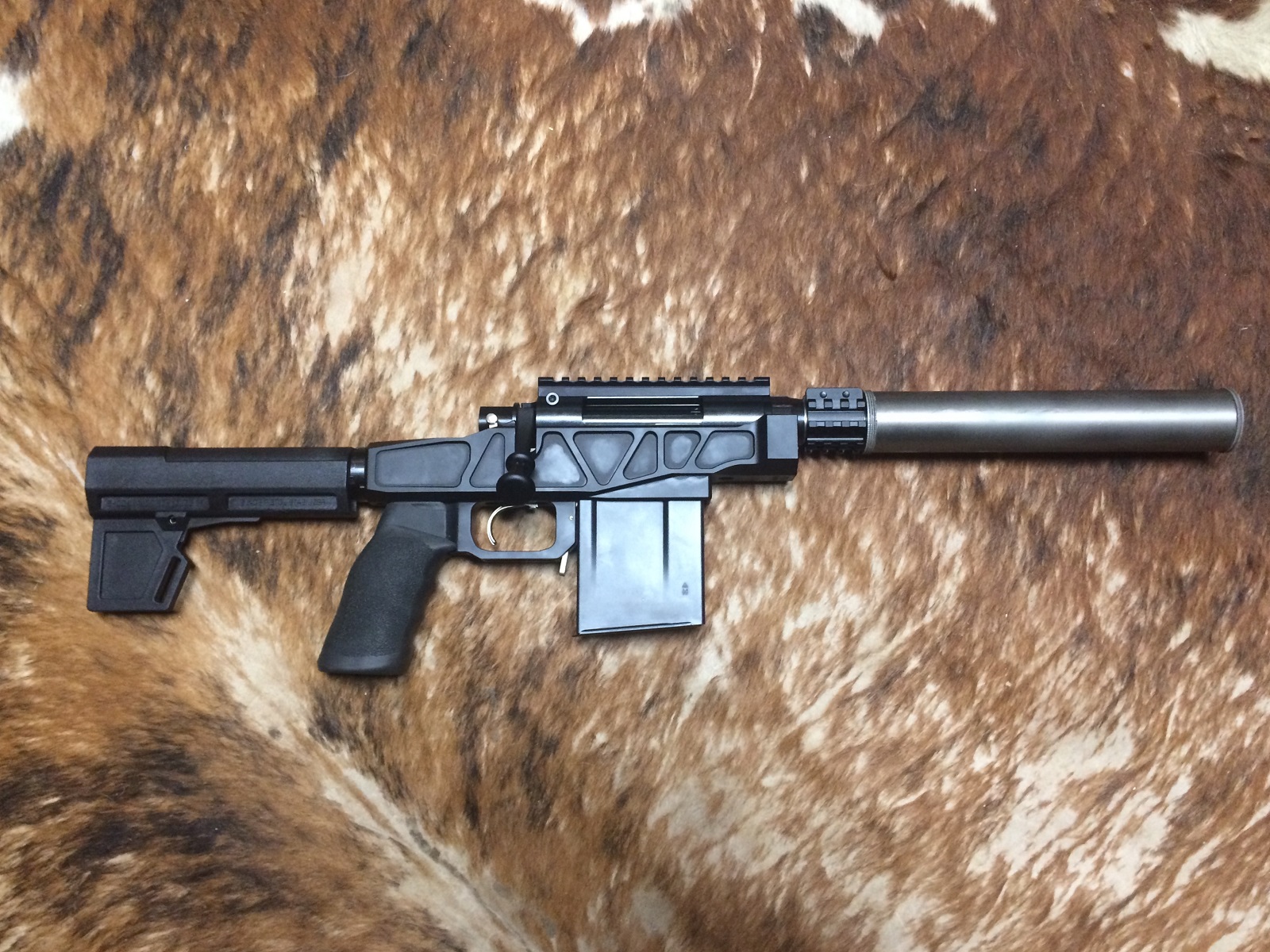

Just wanted to give you guys an update on accuracy. Took the 9” 300blk Pork Sword out last Monday at my local range. Zero’d the subs on the Nikon P-300BLK 2-7x at 100 then at 200 yards kept a full mag in the center of a full IPSC silhouette using the holdover reticle. 300yd array only had a large 6’ square plate, but grouped well at approx 8”. My spotter was watching the rounds lob in at 300 yards like artillery ?. I hope everyone else is enjoying results like these. Love this little gun.

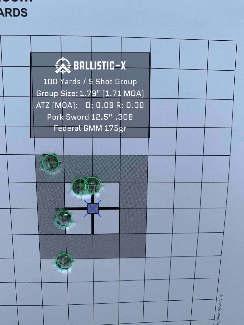

Anyone have any input on the 12.5 inch 308 accuracy?
Customers have reported (and we have seen ourselves) anywhere from .75 to 3 MOA with the KAK barrels we sell, regardless of length, depending on ammo, action, etc.
There appears to be enough variability in the factory actions that moving a barrel from one to the other will affect accuracy. Going with a higher quality action (to include a blueprinted factory one) is far more likely to guarantee you fall into the 1 MOA camp or better. The KAK barrels seem fully capable of this. Also how you set headspace may favor one ammo load at the expense of another.
If you go high-end there's no accuracy ceiling or anything and a short barrel can be every bit as accurate (potentially even more so due to increased stiffness) as a long barrel. For example we had Alamo Precision Rifles build us a few 10-inch .308 barreled actions and those are sub-half-minute guns all day long and likely sub-quarter-minute with the right ammo and shooter.

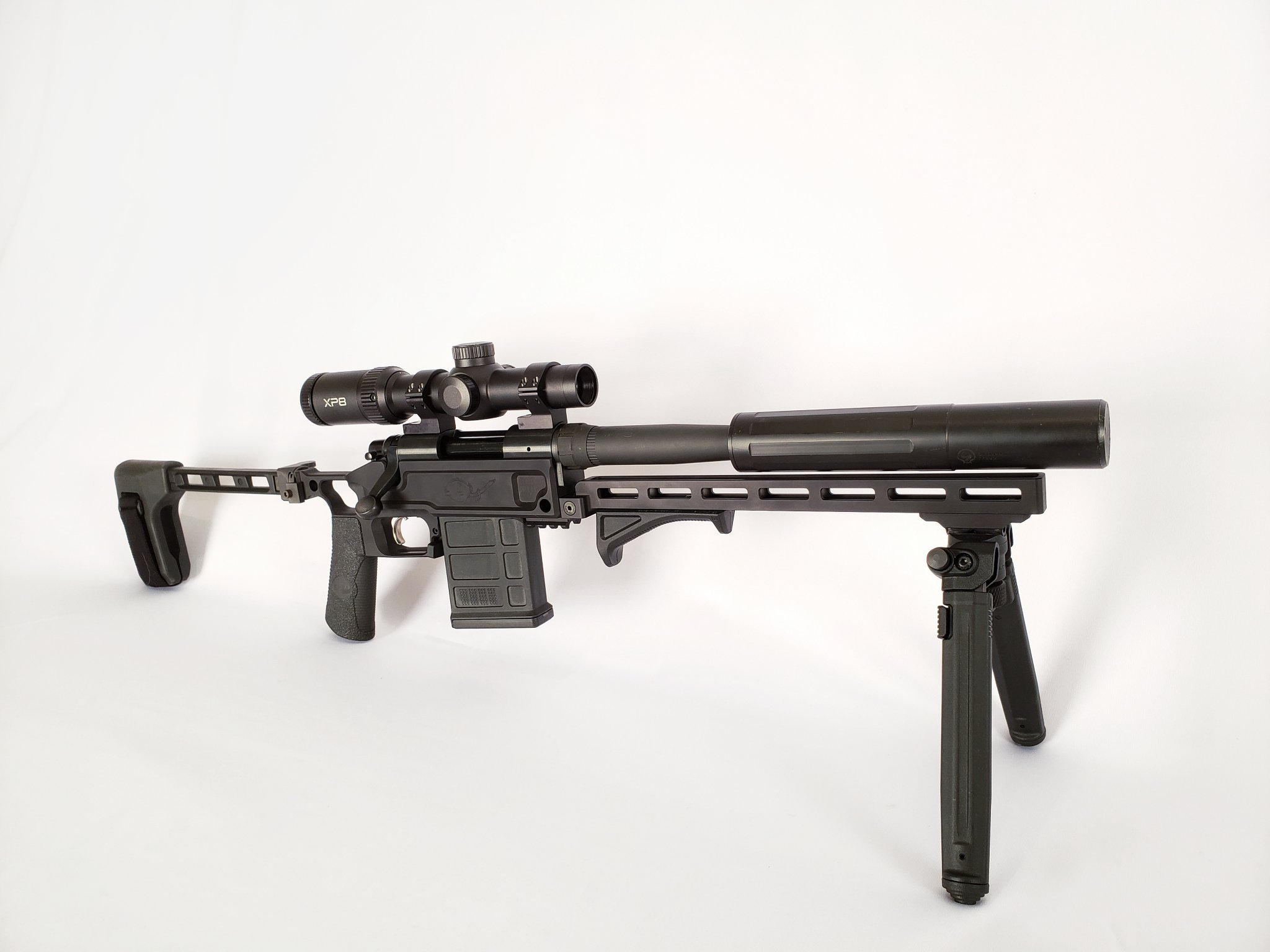

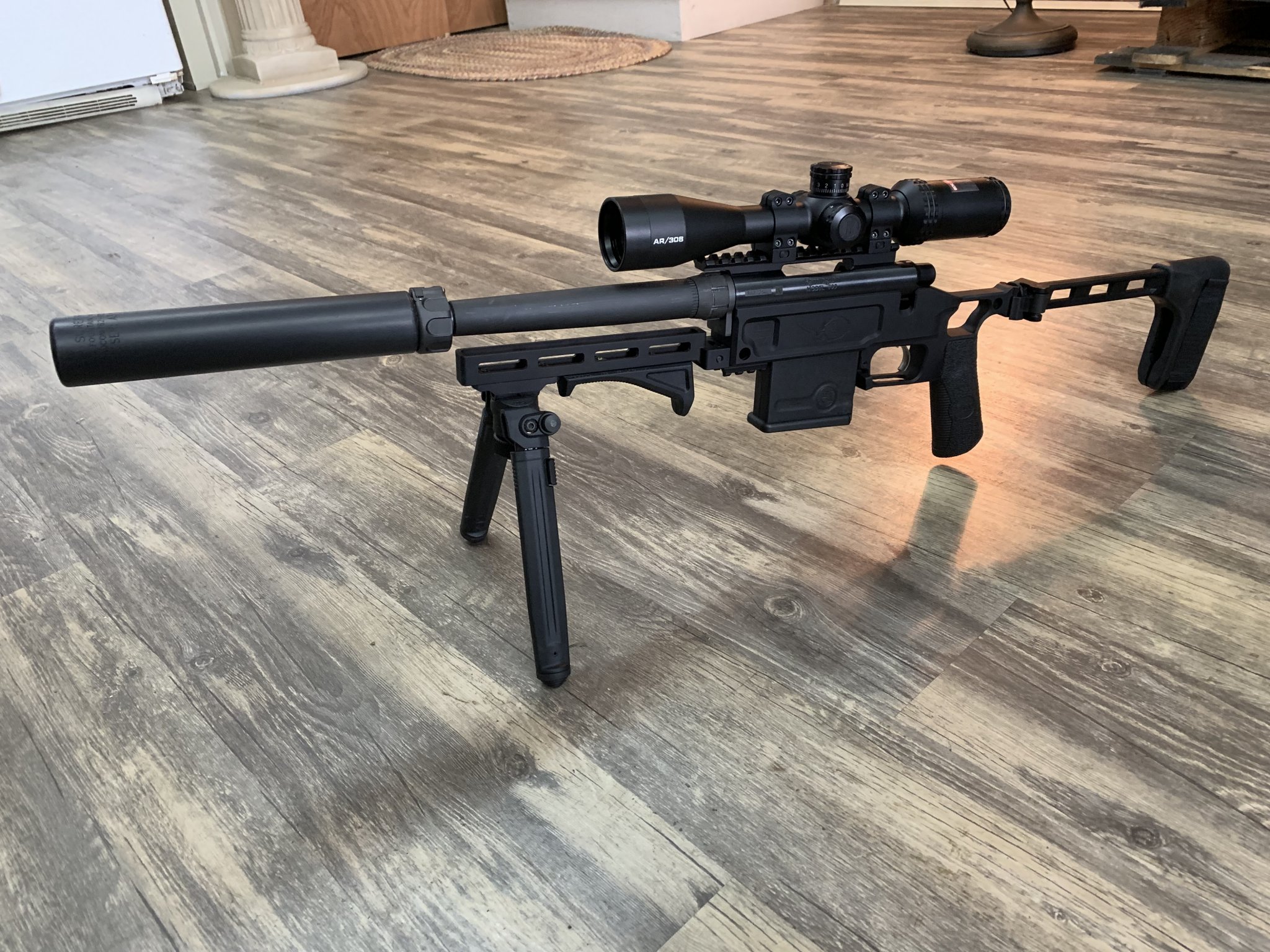

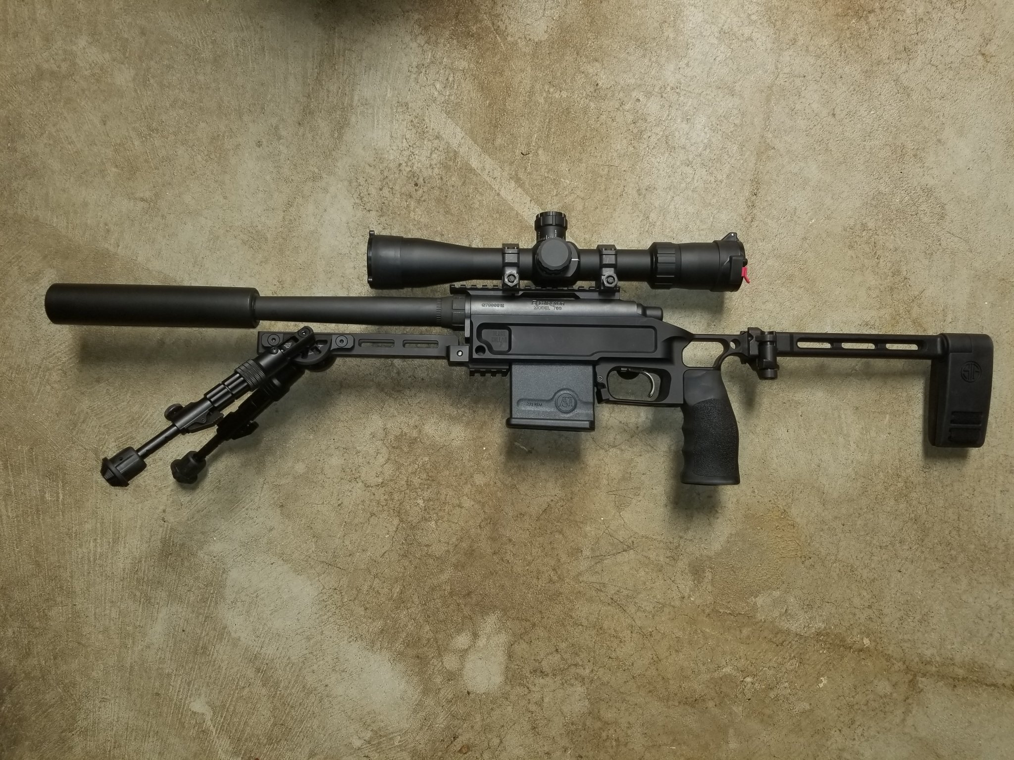

I got my 300blackout barreled action put in the Pork Sword. I haven't shot it in this configuration yet. I'm assuming it will work fine. I had an sba3 with a folder on my last setup that worked out really well. The chassis feels well made and all the accessories bolted on without issue. I'm not sure about the weaver tactical 2-10x36 though.
And please, don't be too harsh about the bipod. I wanted one that would could double as a wide forend. The utg bipod does feel pretty sturdy though. Atlas CAL is my "go-to" bipod for everything else.
