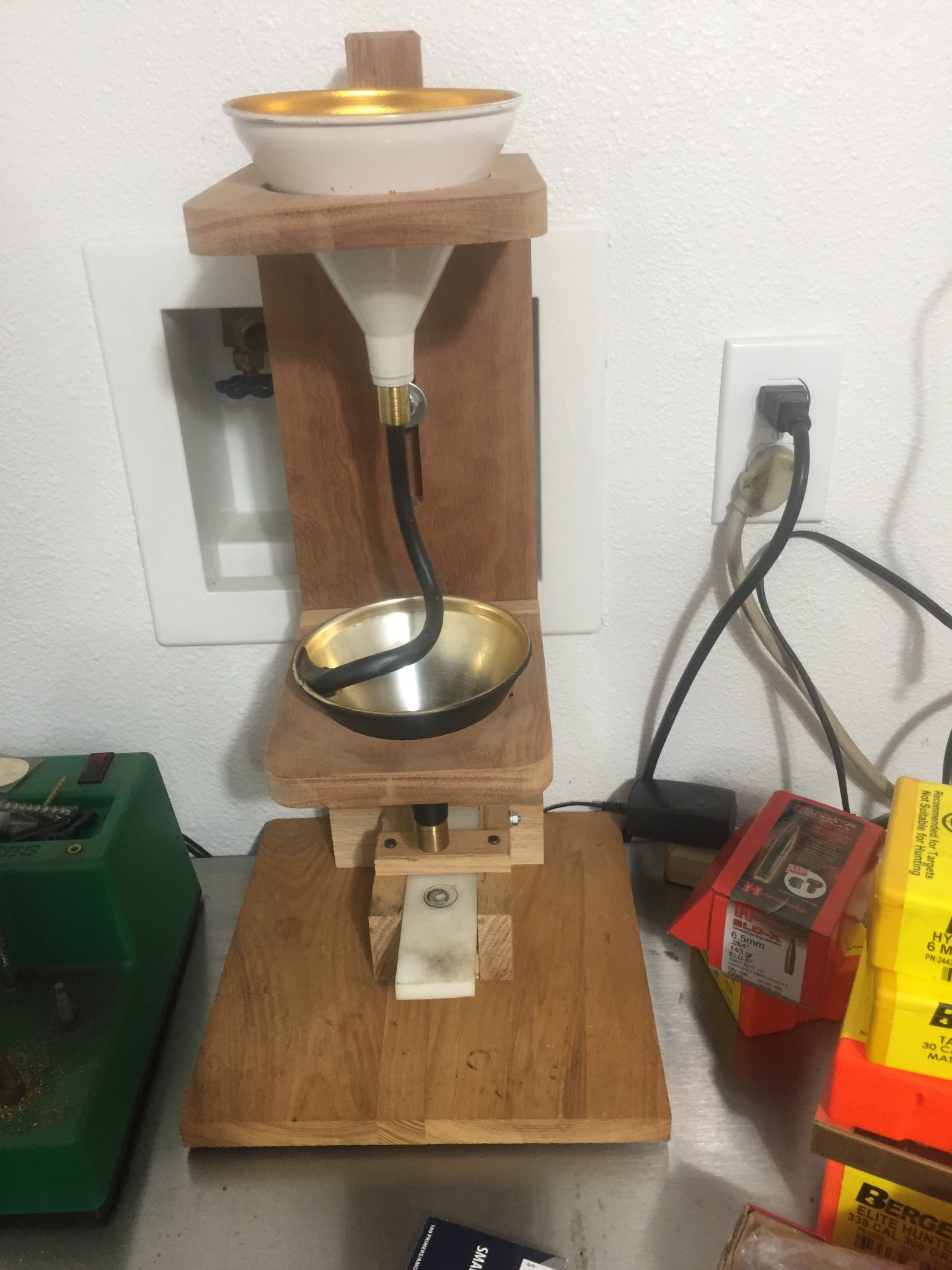

Long drop tube, SLOW pour.
This is what I use to get powder to settle in a little better. Call it my double funnel mother fucker.
Reactions: JustBC
I'd have to agree with the name. Does it double as a still?
It might but hadn't thought about that. I am now though. Great, my drinkin problem is already good enough.
