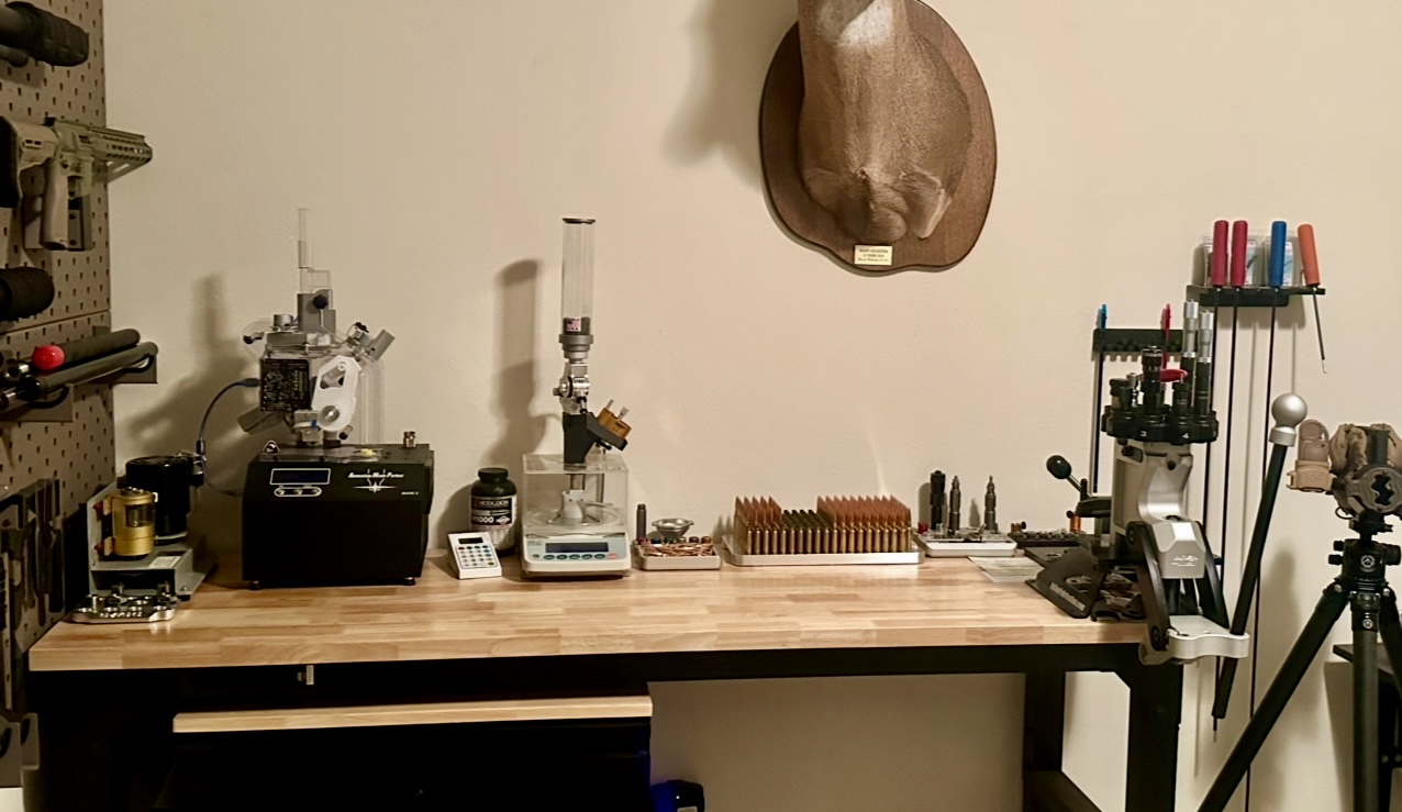

And for powder charging I use an RCBS Competition Powder measure, and a Frankford Arsenal Powder Trickler. I can drop, weigh and trickle as fast as most of the RCBS Chargemasters, and I don't need a soda straw to make mine work properly
