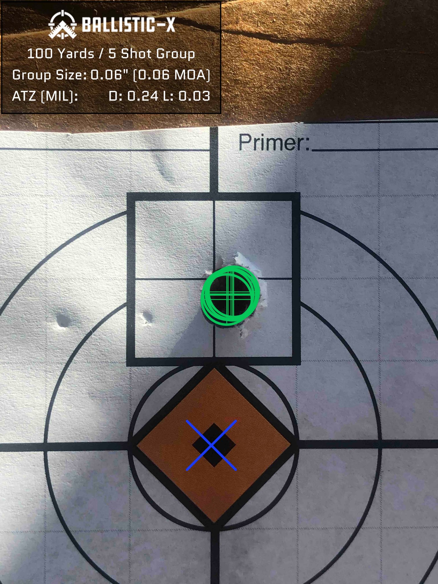

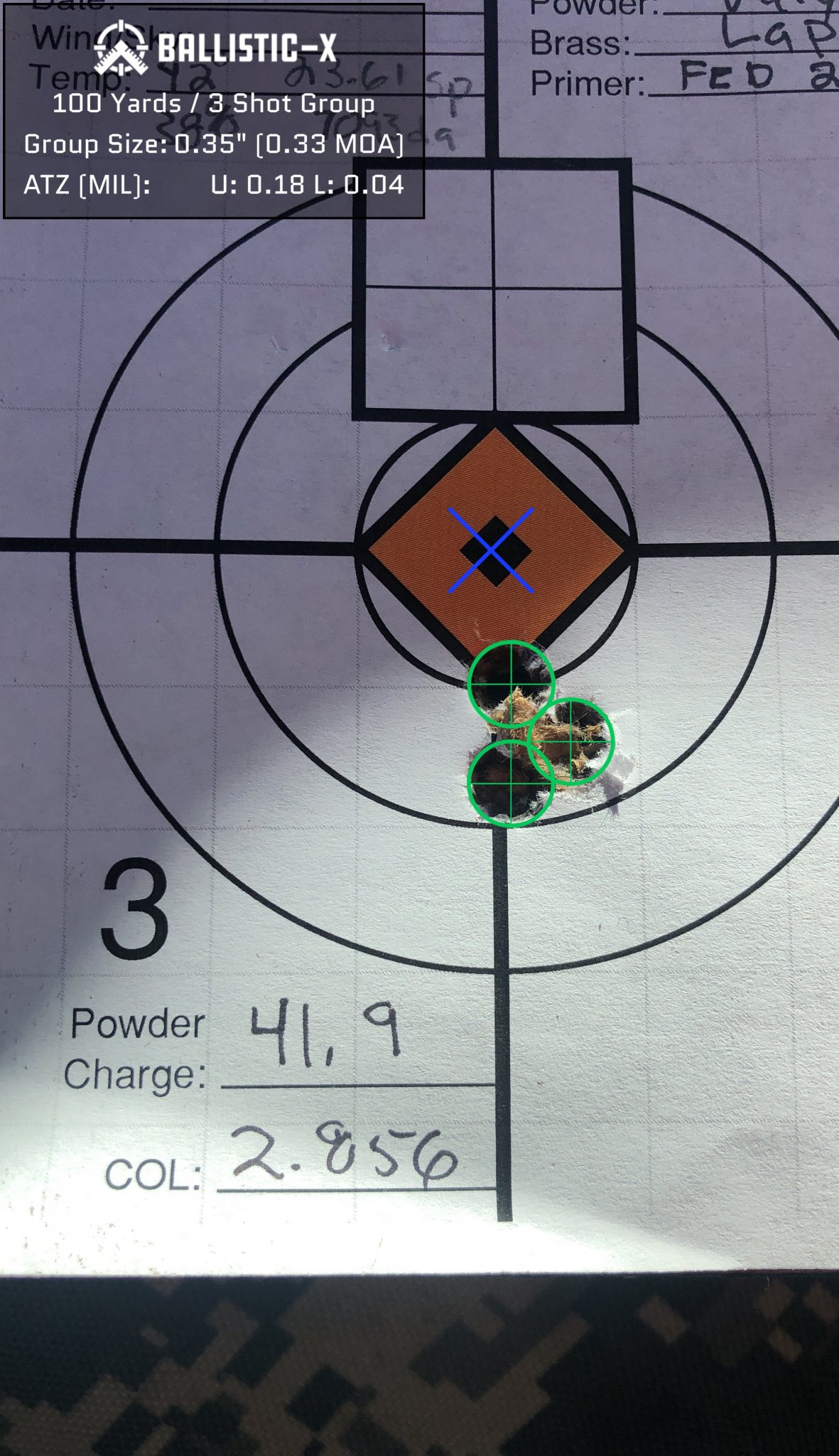

some other groups from same session at different charge weights, and First group from this barrel with FGMM

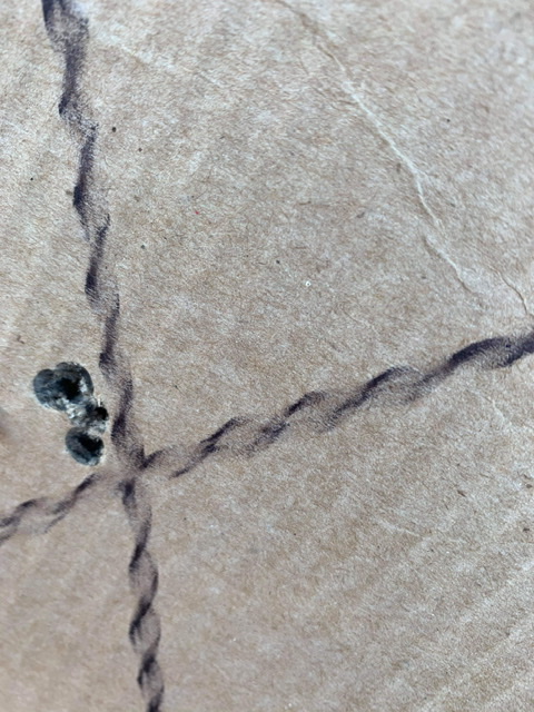

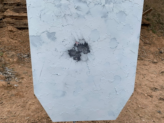

I dont Typically shoot under .3 MOA groups I’ve had a handful near/under .25 from this barrel/load combo.
....... And an above average (for me) number of first round hits on 1moa target to 798 yards.

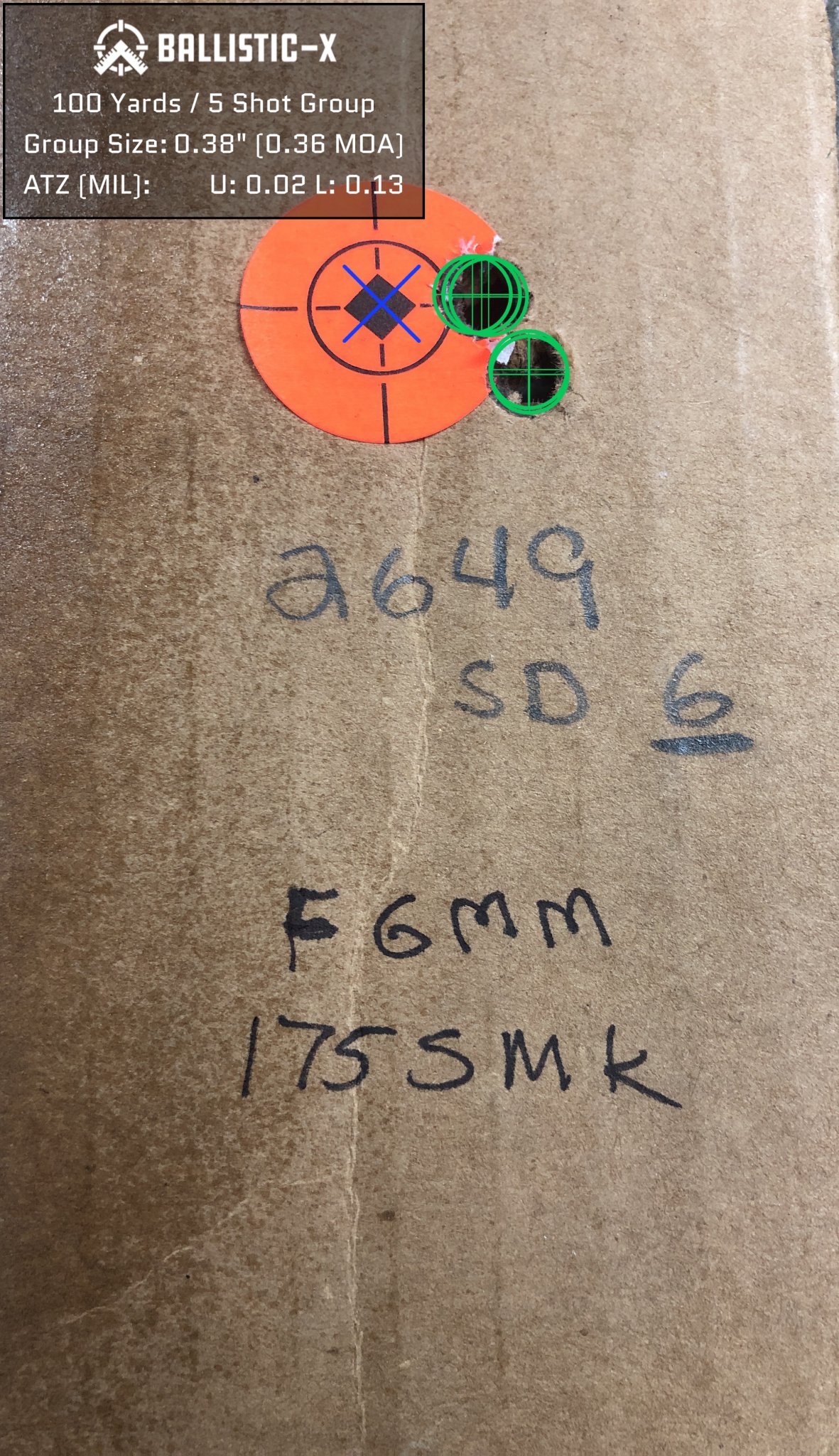

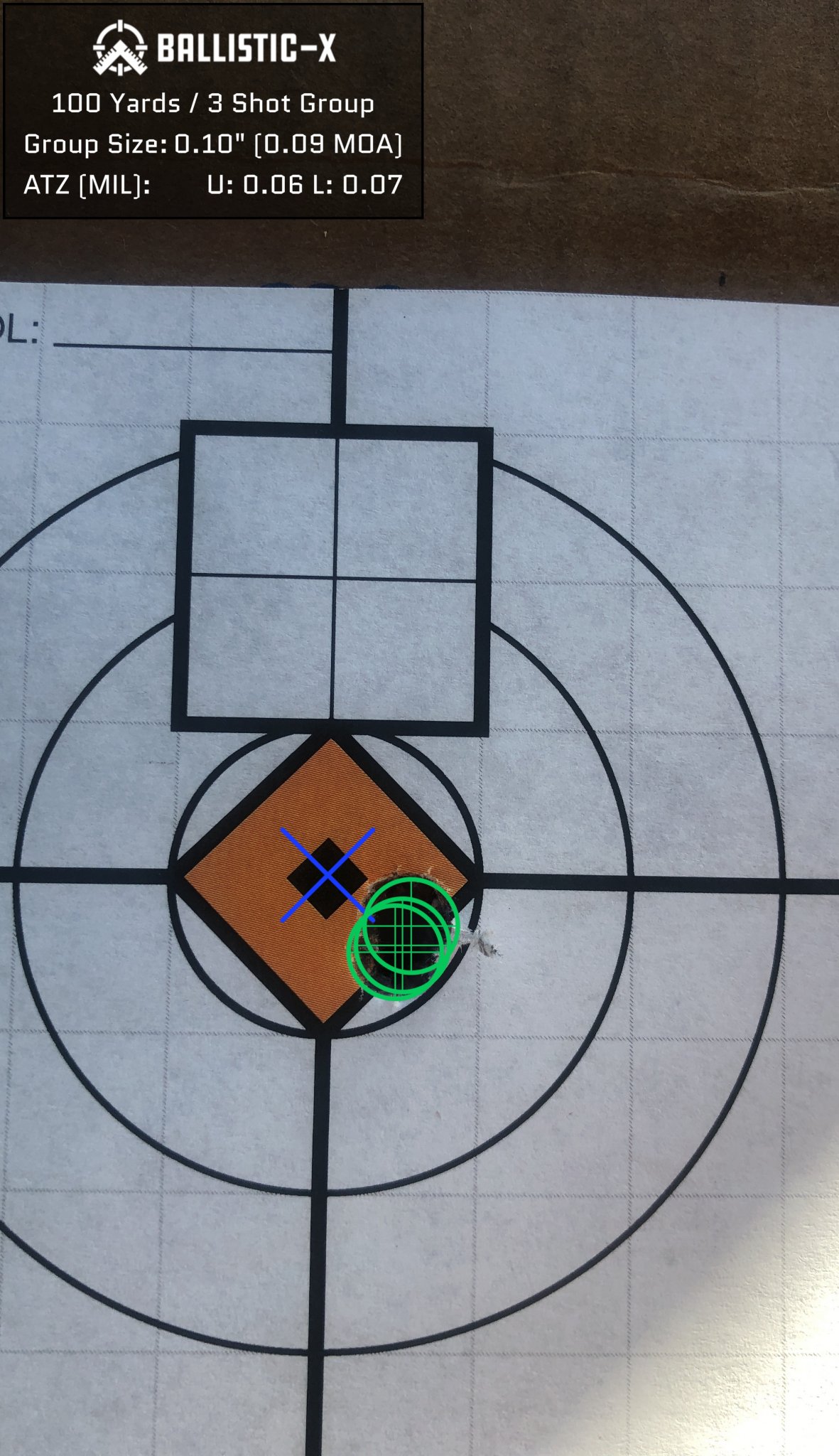

Well, I only have two (2) screw-on barrel nut barrels " REMAGE" style, one chambered in.308 a shilen blank done by
a local gunsmith for a Remington s/a for hunting it will shoot 1/2- 5/8 groups " 5 shot " all-day long.
The second barrel is from NSS Criterion 6.5CM 26" full bull on Defiance Tenacity action, basically, I use this as a bench
gun and It's not disappointing this rifle will shoot .2- .3 five-shot groups all day long with my old tired eyes.
Don't be afraid to give a screw-on barrel a try, you'll be surprised and save some cash !!
