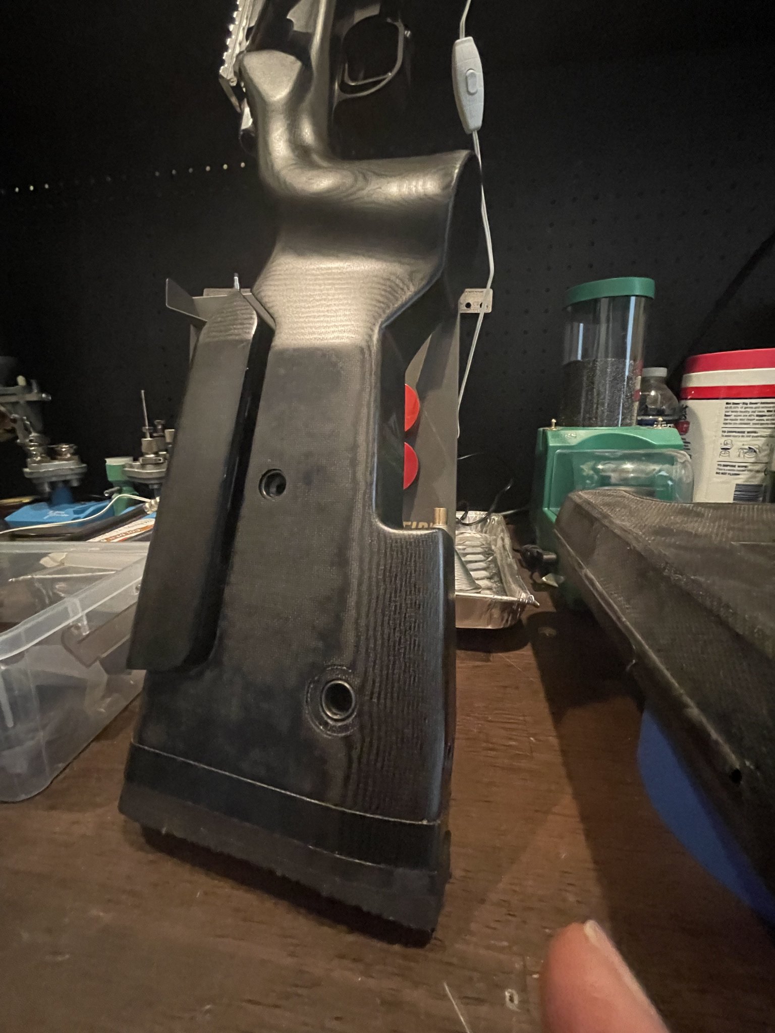

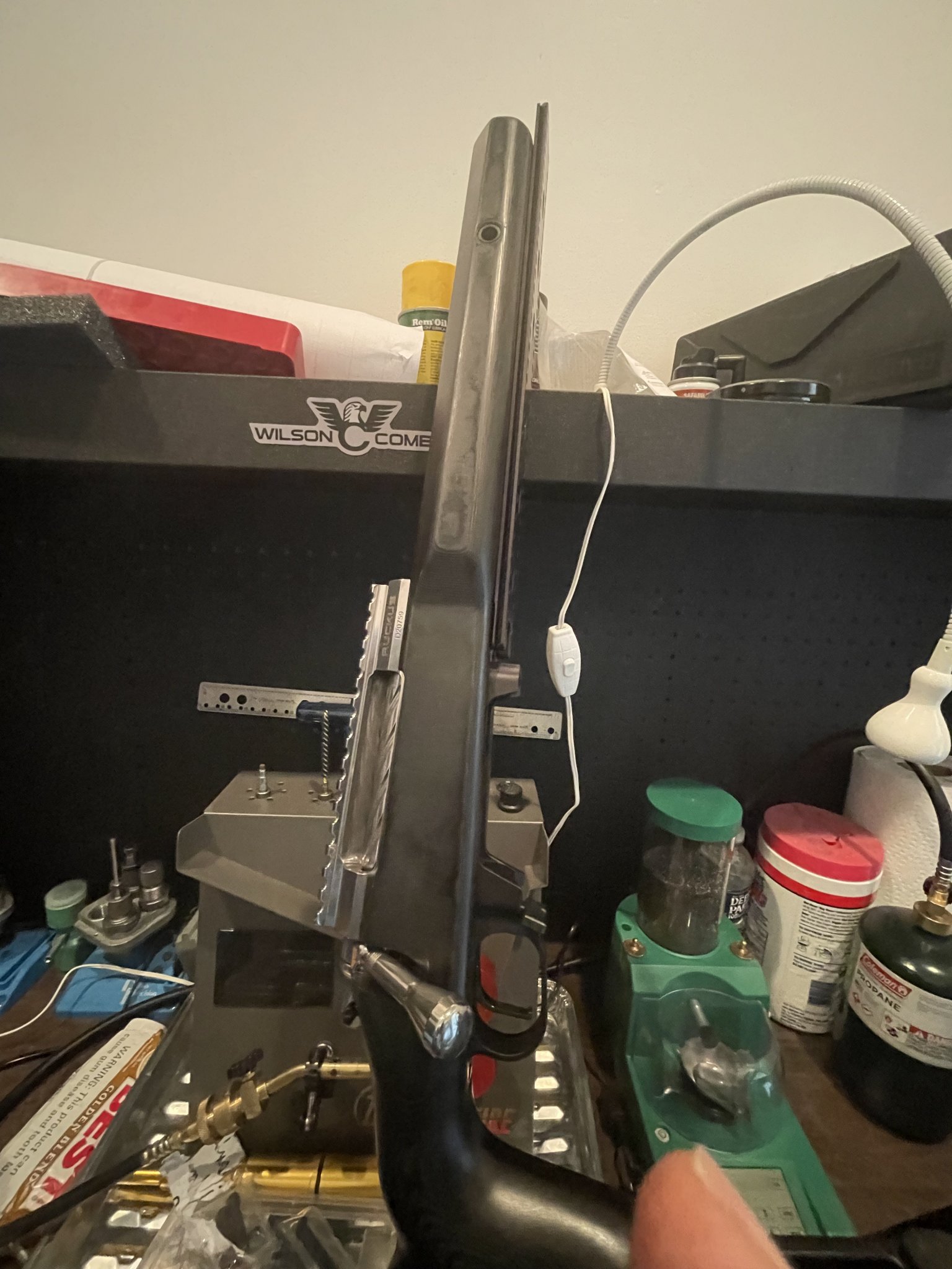

Foundation also has a black that is just gorgeous. I bought one for my 300 PRC build. I can send a pic of that as well if you like. It is the stock, with Defiance Machine RUKUS LA. Just waiting on the barrel.

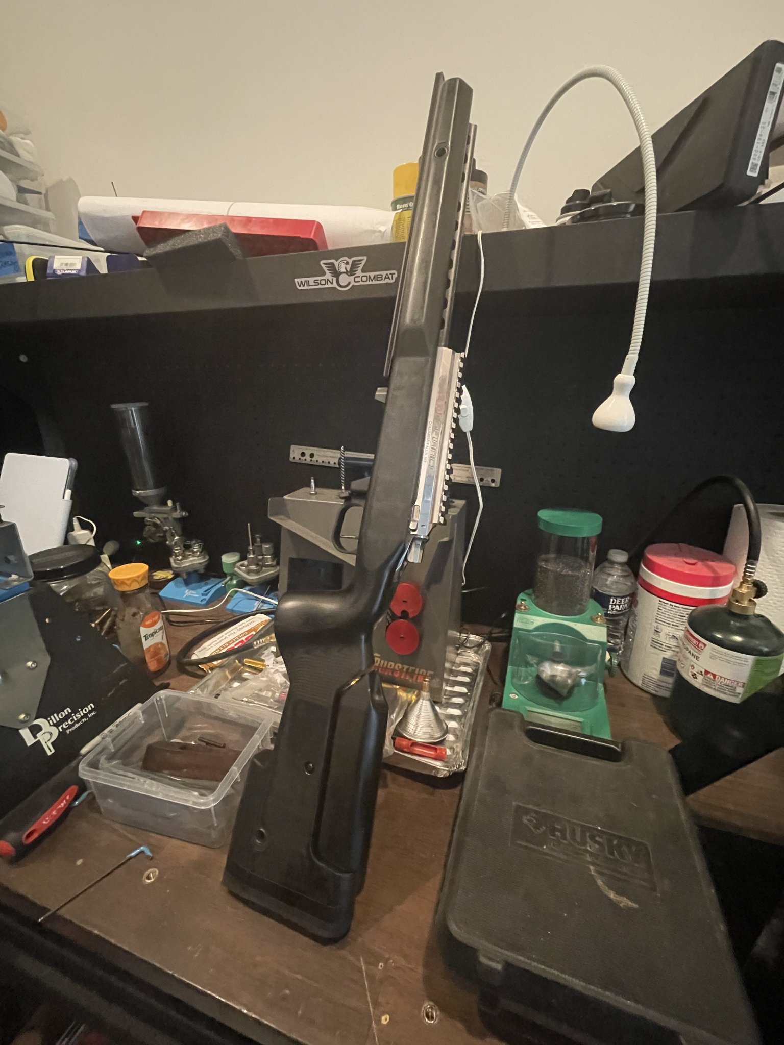

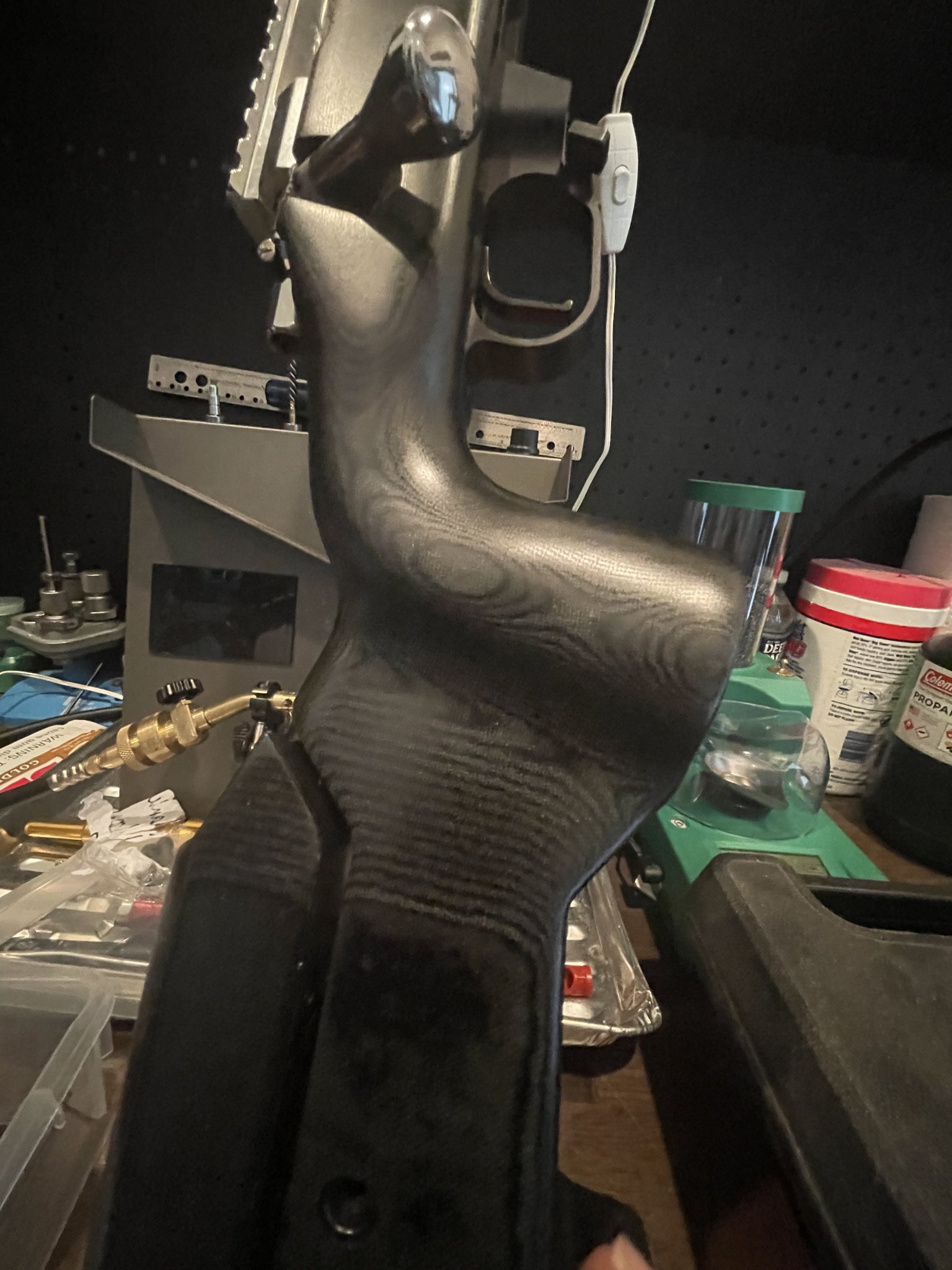

Here is my build that is underway:
will be a 300 PRC
Foundation Genesis II ... just like my other one above except in black

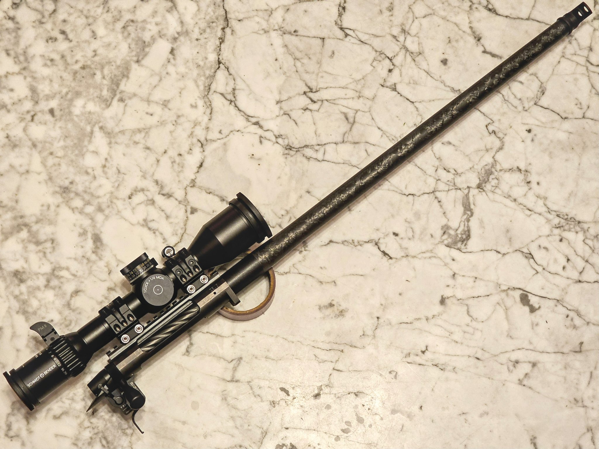

Picked up my Terminus Zeus today and god damn am I impressed. Exceptionally well machined, super slick, and flawless finish. Money well spent imo. Tossed together the barreled action, proof 300 prc 1:9t.
WOW... just gorgeous. what made you go with a 1:9 twist?

1-9t in actuality covers everything you'll realistically be able to and want to shoot in the cartridge; 180-230 grain. Quite frankly anything north of 230 is better served in a Norma Magnum. Additionally, in the big 30's a fast twist may possibly limit you to the heavy stuff, 230+, as there are plenty of guys who have their 1-8's turn the lighter stuff into dust mid flight as jackets separate. I have 230 A Tips, they are plenty for out to a mile. My understanding there as well is that you should take the speed of < 230 grain projectiles since at most distances you will not really even be able to take advantage of the added BC from the 250. Norma makes sense for the 250 since you can get it moving faster. Hornady made there OTC Match load based around a 225 grain for a reason. It's a balance of speed and BC at a given distance. I would actually go as for to say that inside of, say, 1000 yards you are actually hindering yourself from a technical / performance standpoint taking the 250 over the 230. There are a couple 300 PRC threads on here that are really good reads on all this, here is one:
You made a good choice with your twist rate and won't regret it. Punch your info in here as well, I think you'll be surprised what the 9t can actually stabilize:

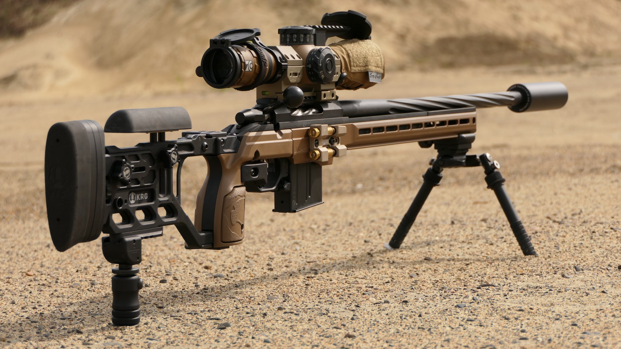

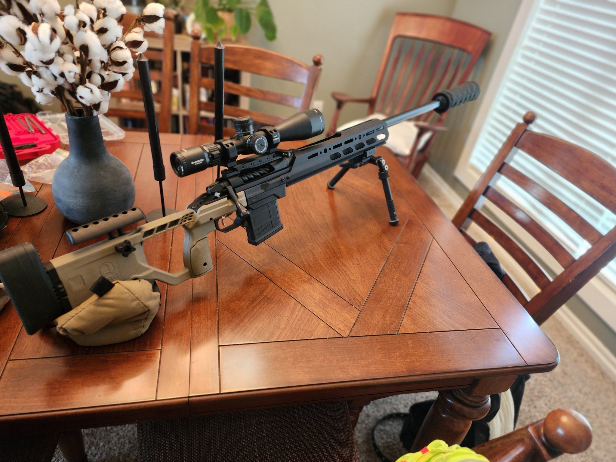

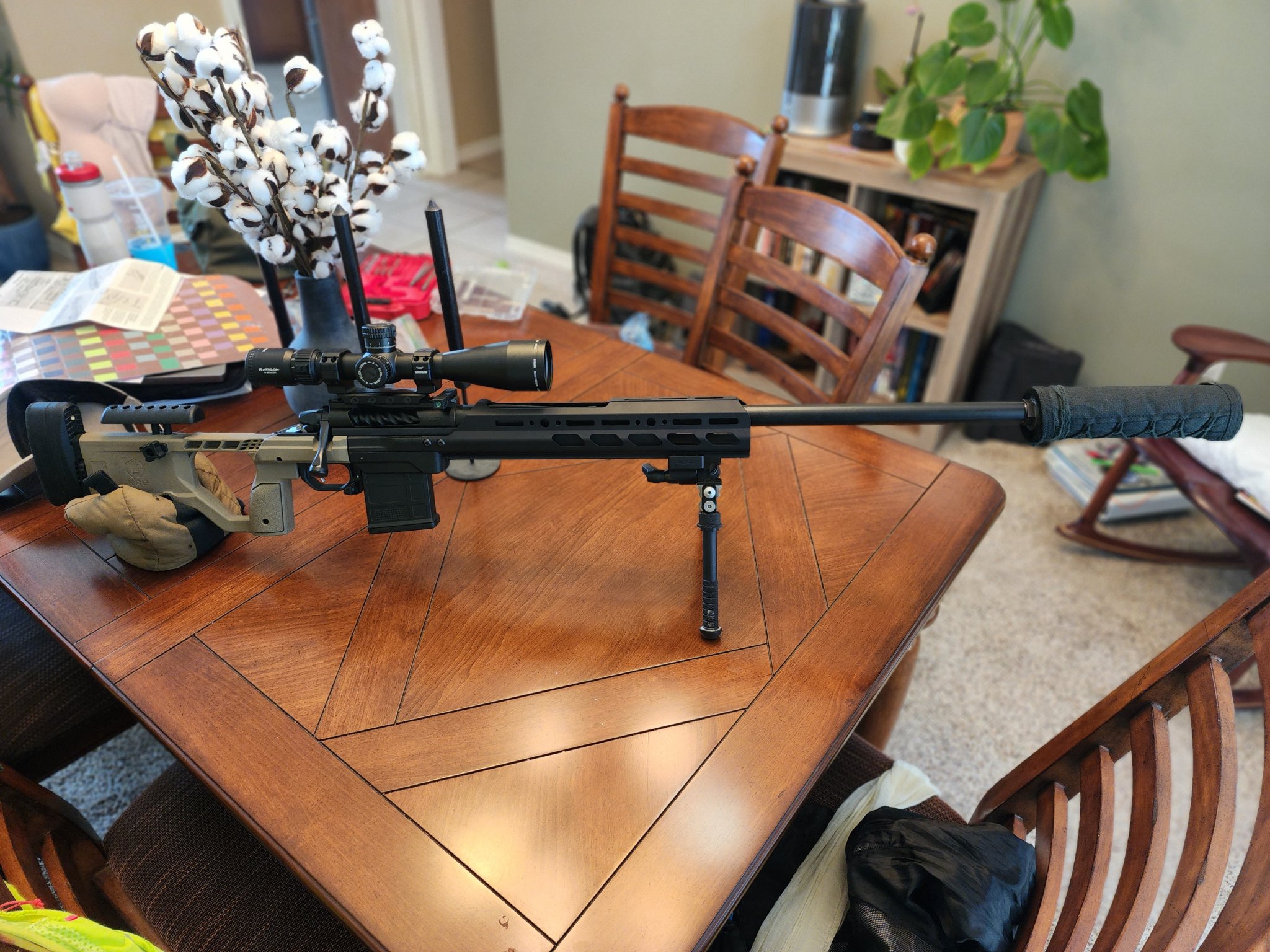

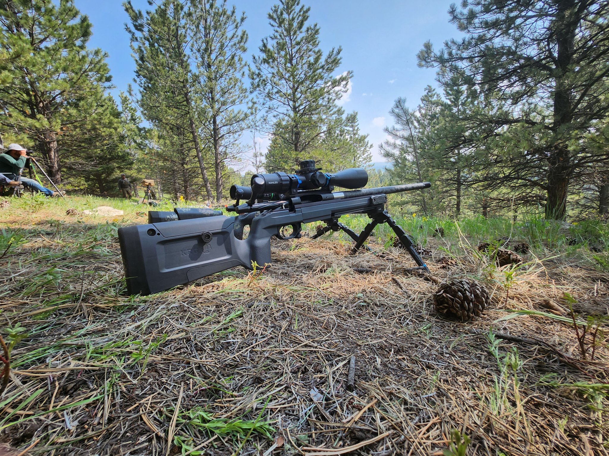

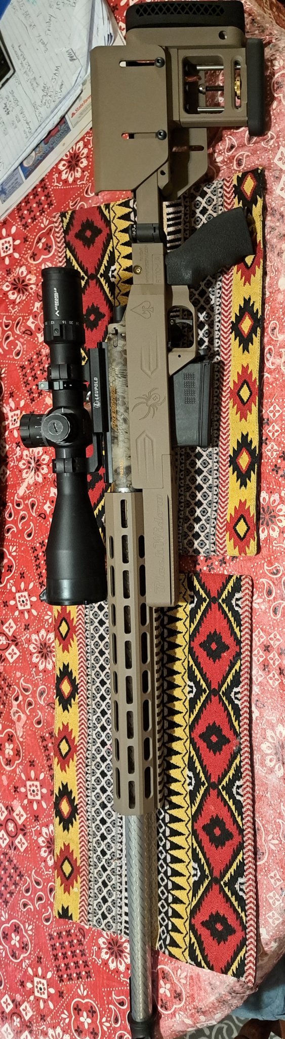

Tried to convert my prs rig into a coyote rig. She's a tad long and a tad heavy but with limited funds this is the best I could do. Ultimate plan is to sell this barreled action and get an origin with a lighter and shorter 6.5 prc barrel to shoot nrl hunter matches and then build an entirely different prs rig.
Tuebor raider action
Bartlein 23in 1/8 6 creed
Krg xray with the arca enclosed forend and heavy lop spacer
Thunder chicken with a coletac suppressor cover
Atlas cal w/area 419 adapter
Athlon helos 4-20 in a warne 1.39 mount

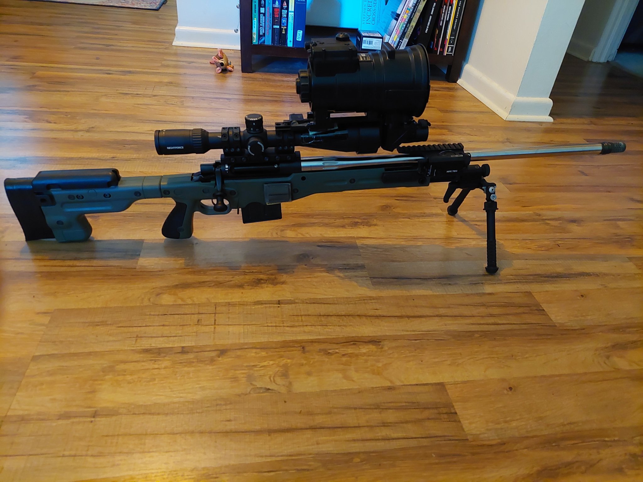

Just put this together today. ARC Nucleus with 25" criterion .308 barrel, TT diamond 2 stage, and an AICS 2.0 chassis. Nomad L has been in jail for 9 months, so hopefully that shows up soon. I like the KN203/PVS9, so I'll probably bin the IMUNS mount until I have the money for a thermal clip on that'll support higher magnification. I like the LS117 IR laser but I will probably get a FP PEQ or D2. I also wouldn't mind a SiCo Radius. I do have an arca spigot and an arca rail- just need a lower profile rail for the LS117 and an arca bipod adapter.
I'd say it's half done. Biggest thing I want is a better optic, probably a 5.5-30 XTR3. I can't use a longer optic like a Mk5 5-25 or ATACR because of the PVS9. XTR3 seems to have the best combo of price, dimensions, features, and quality for my needs. However I'm open to suggestions, and I might start a thread in the optics/sighting equipment forum.

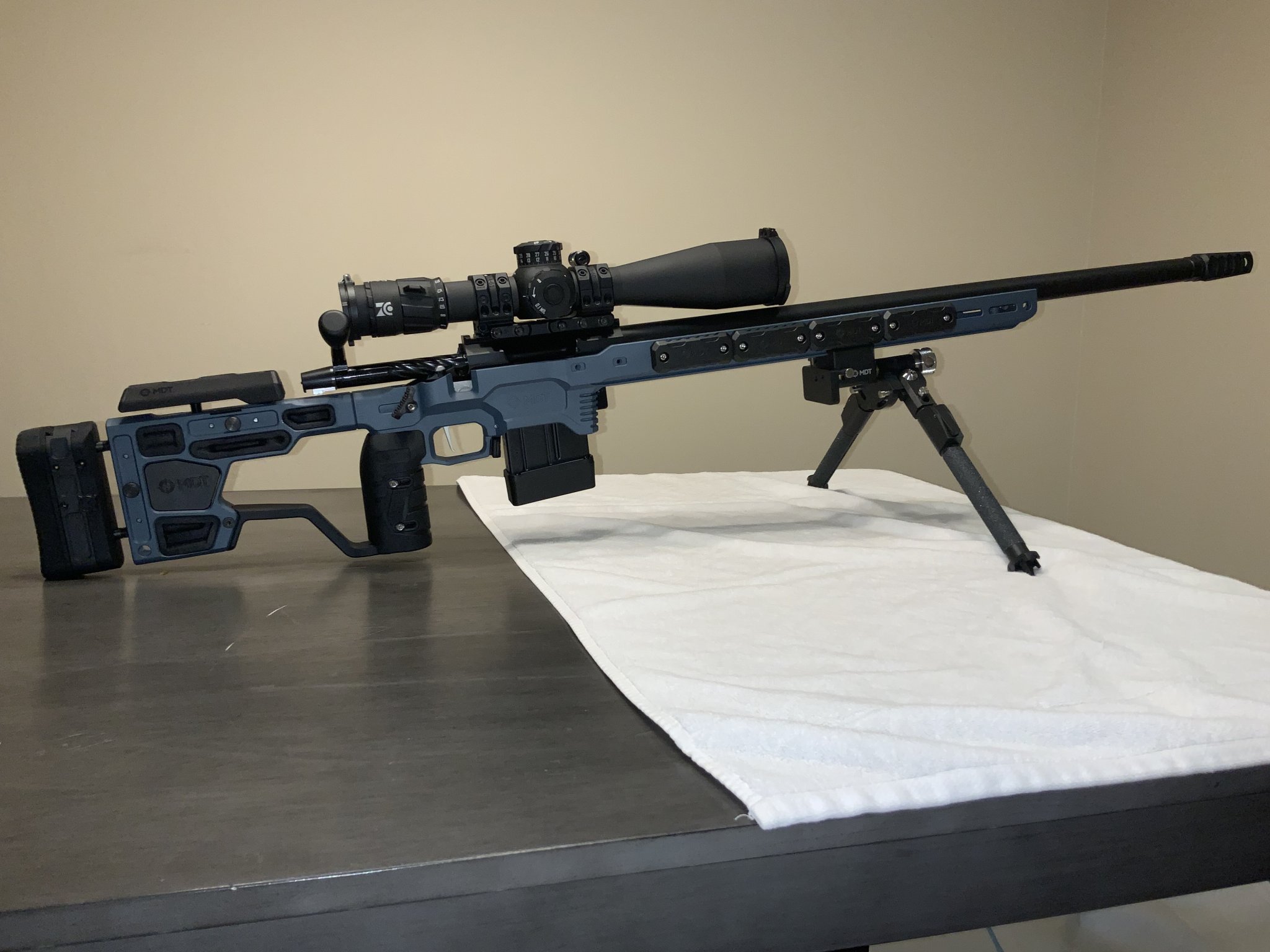

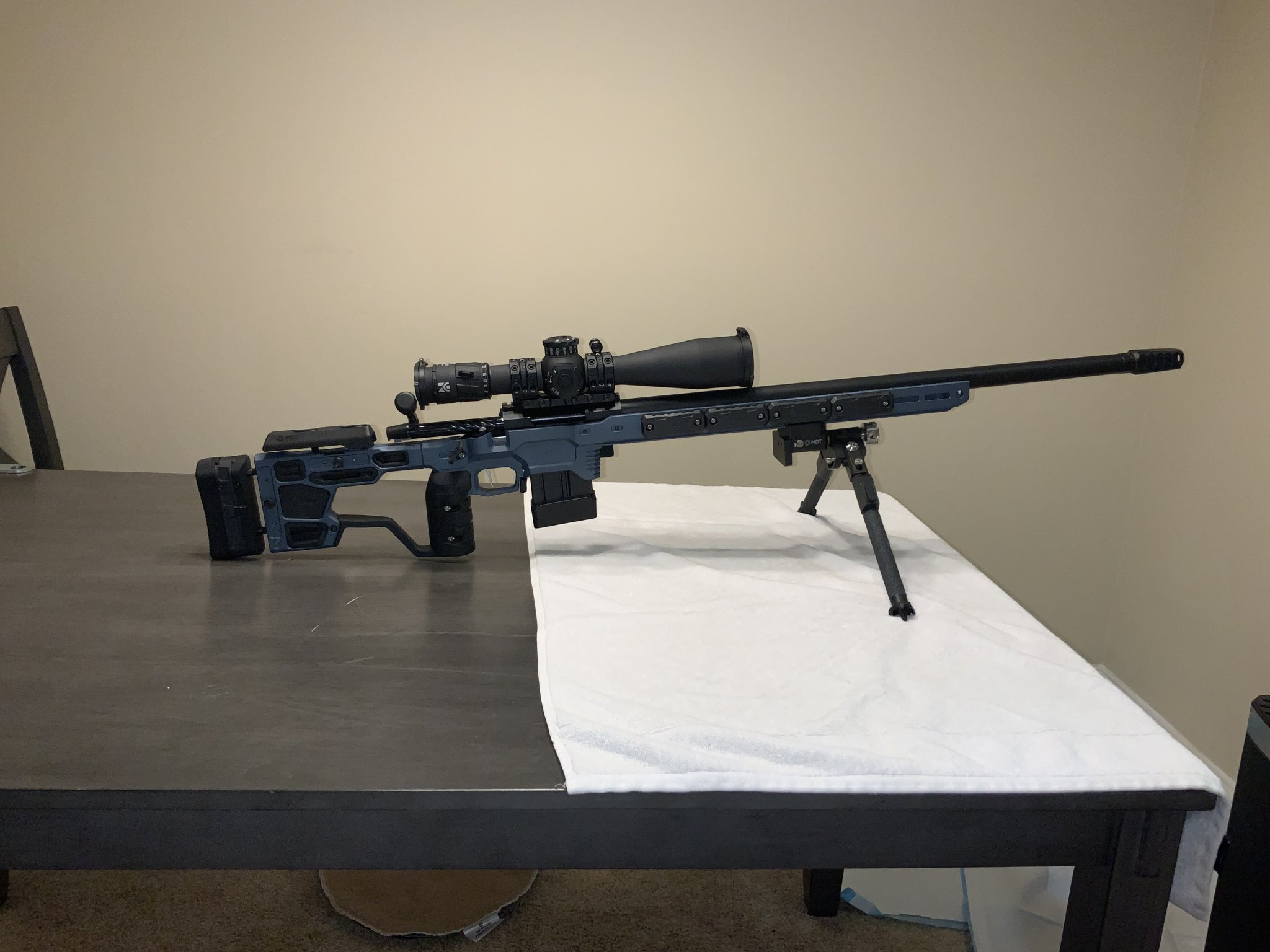

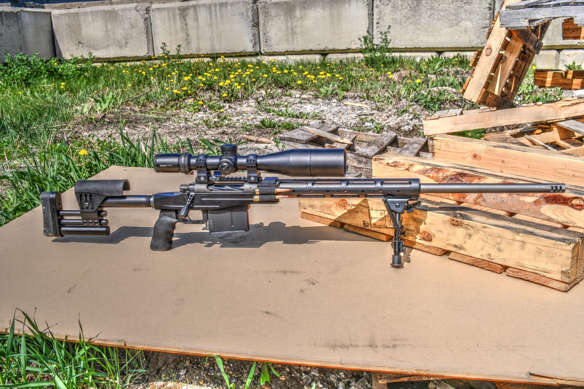

New MDT ACC ELITE in Titanium Blue. I just switched over from the ACC Premier to the New ACC ELITE, so far I love the ELITE. I added the dampners to the butt stock and external weights to the chassis to bring up the weight on my 6CM. I’m running BAT TR Action, Bench Mark Custom MTU Barrel and Bix n Andy Trigger. Running Berger 105‘s at 3100 fps with H4350 and 205 GM Match Primers.

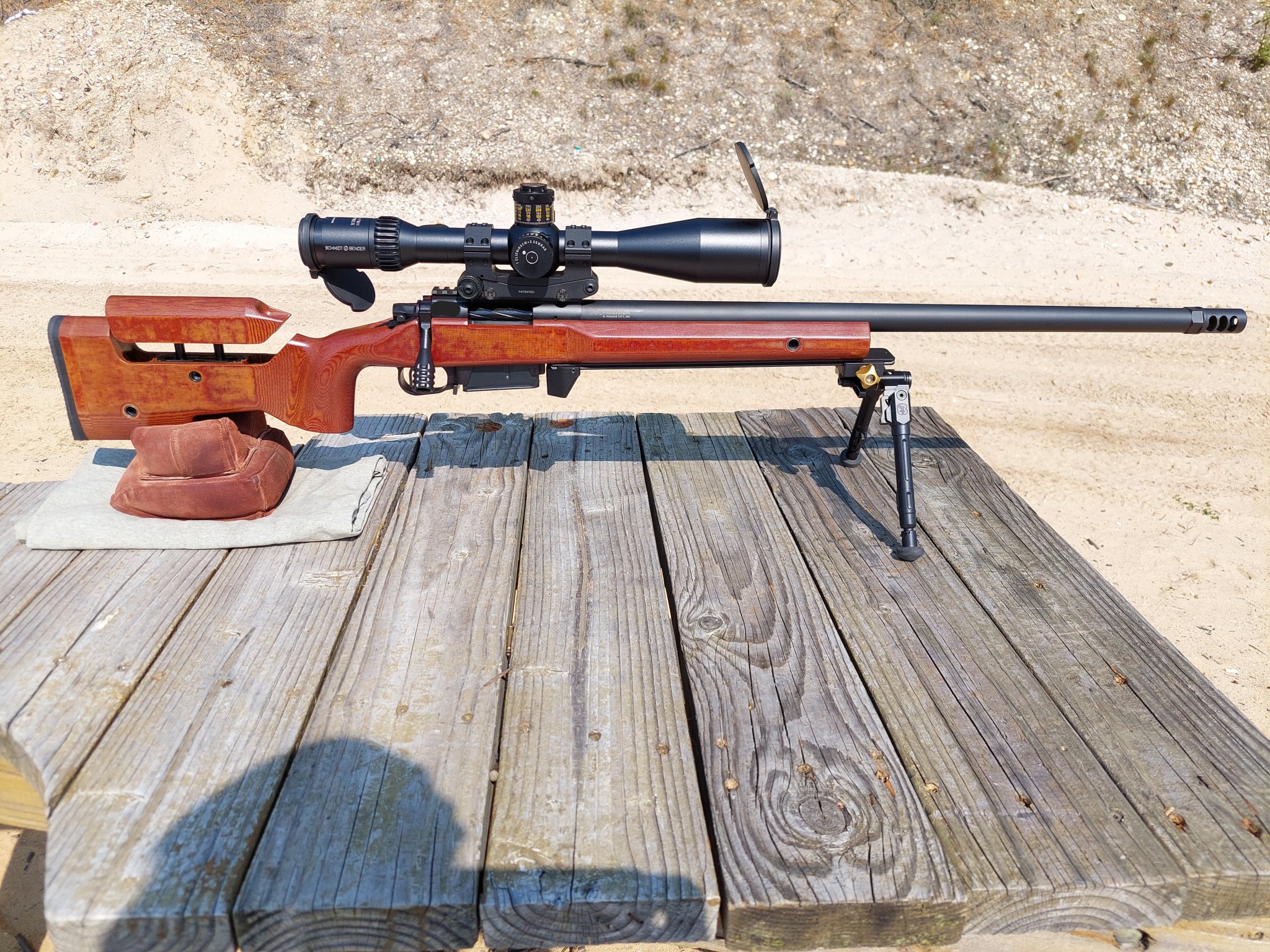

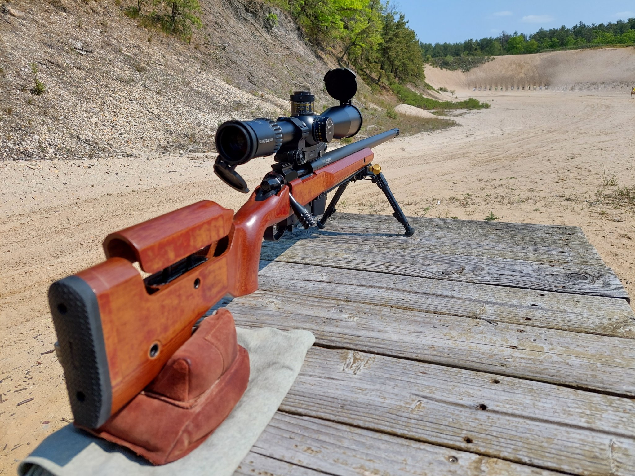

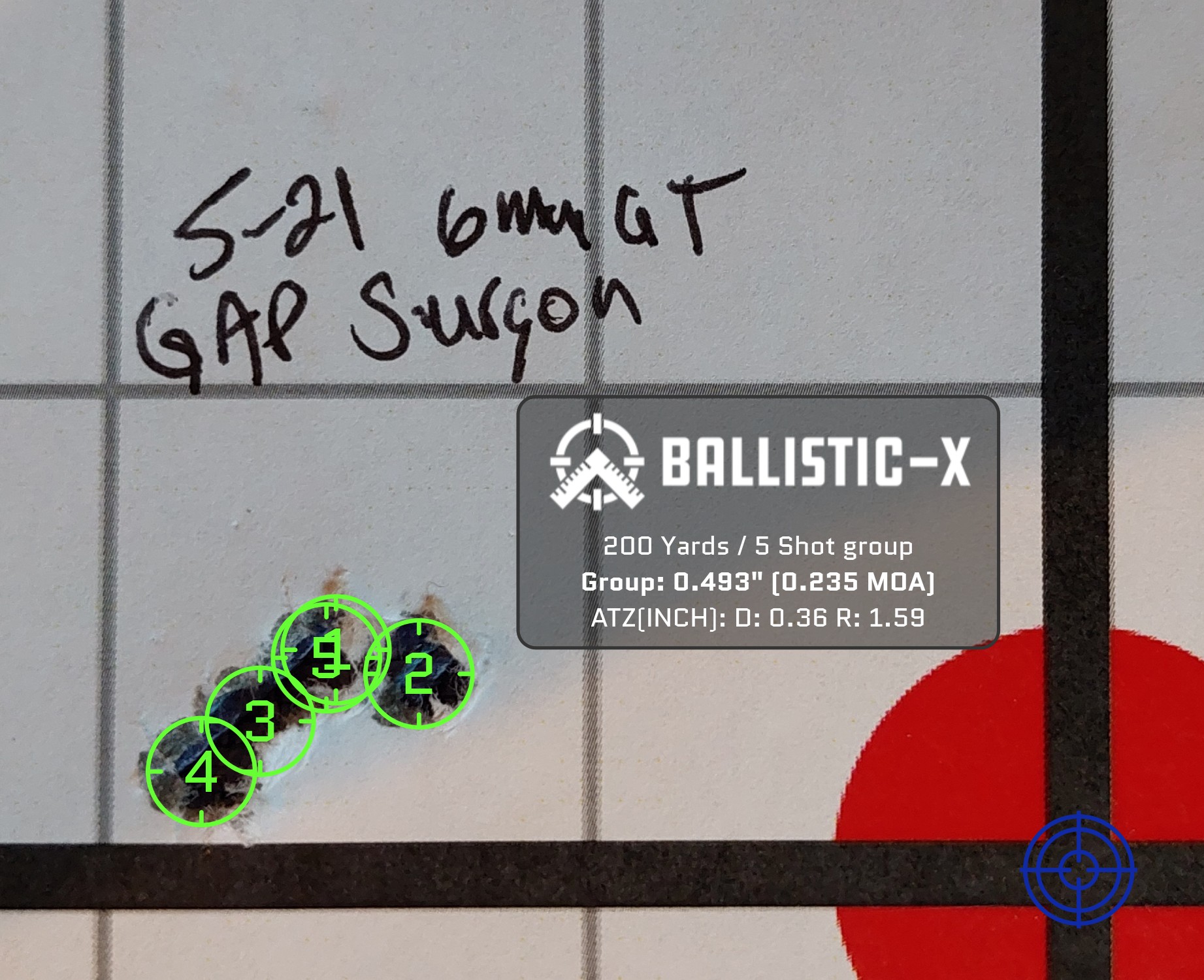

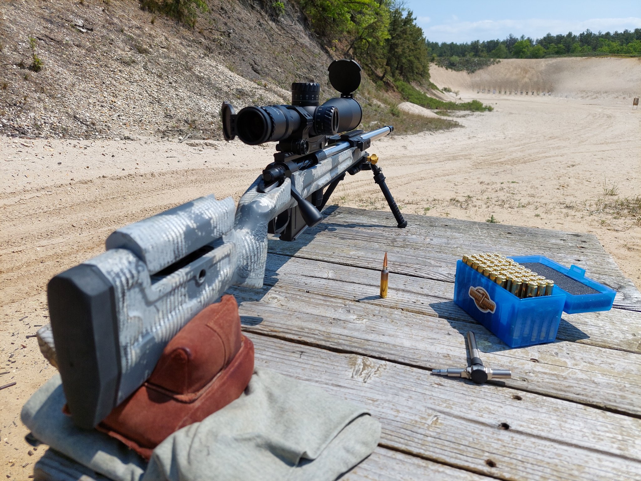

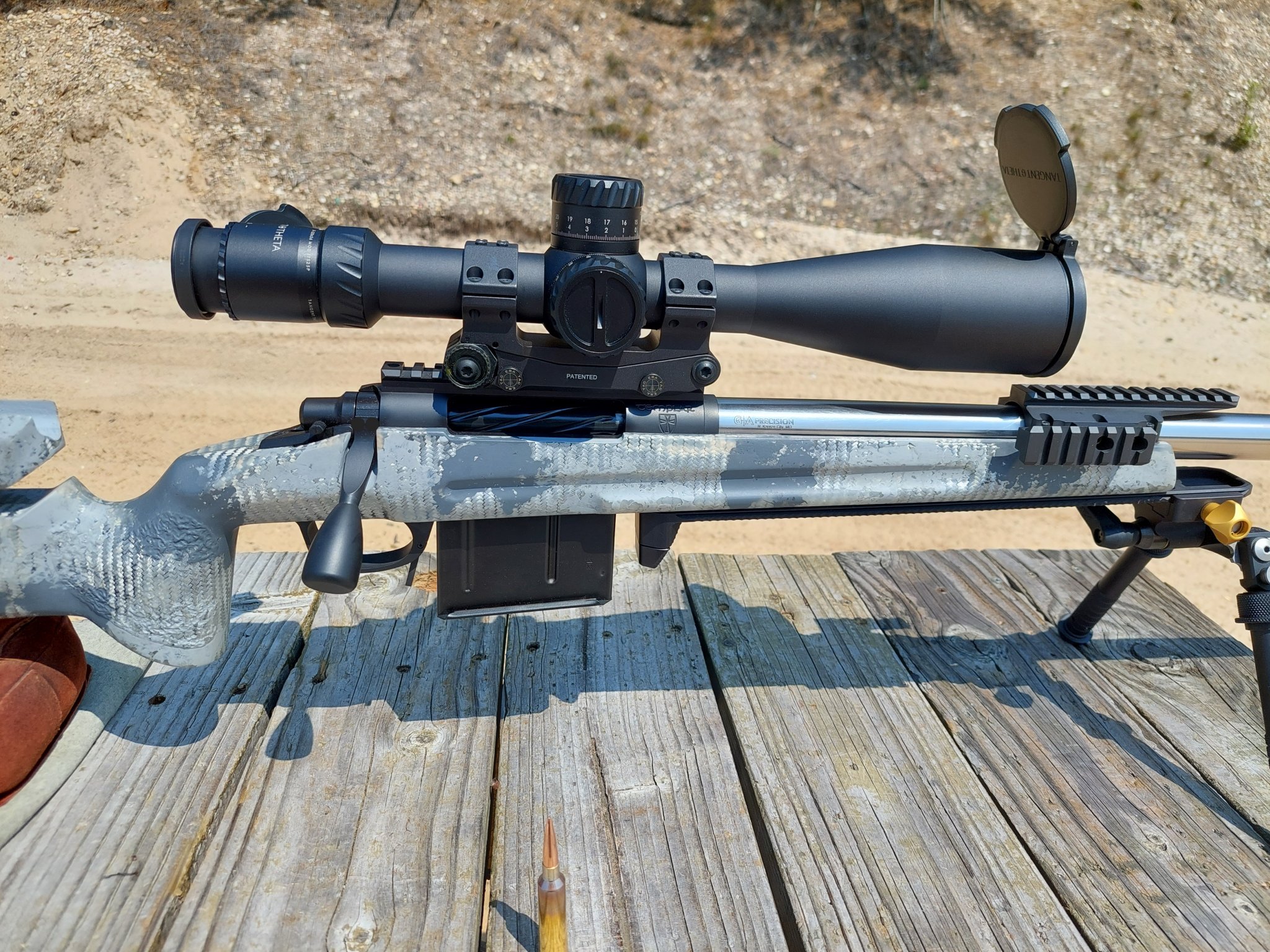

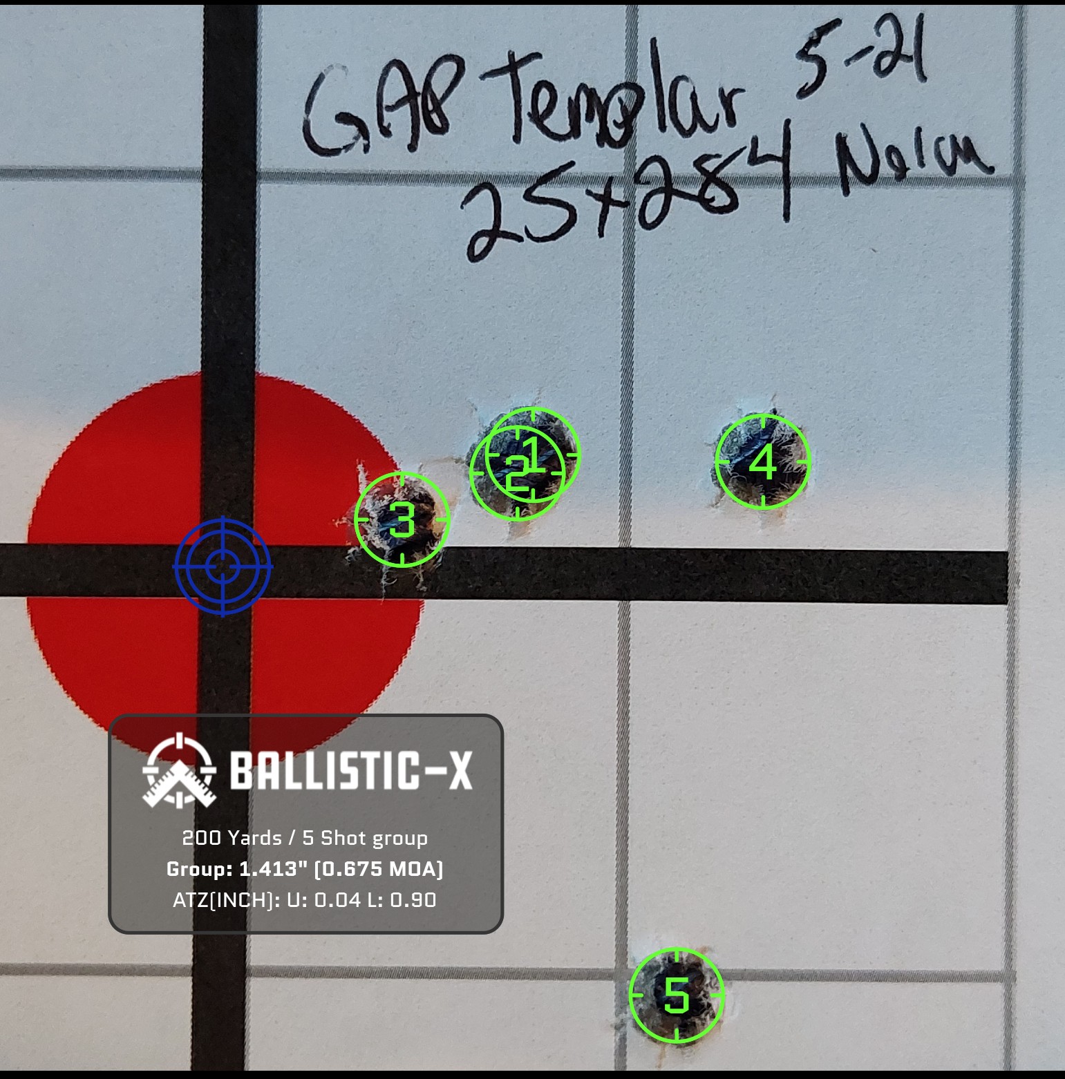

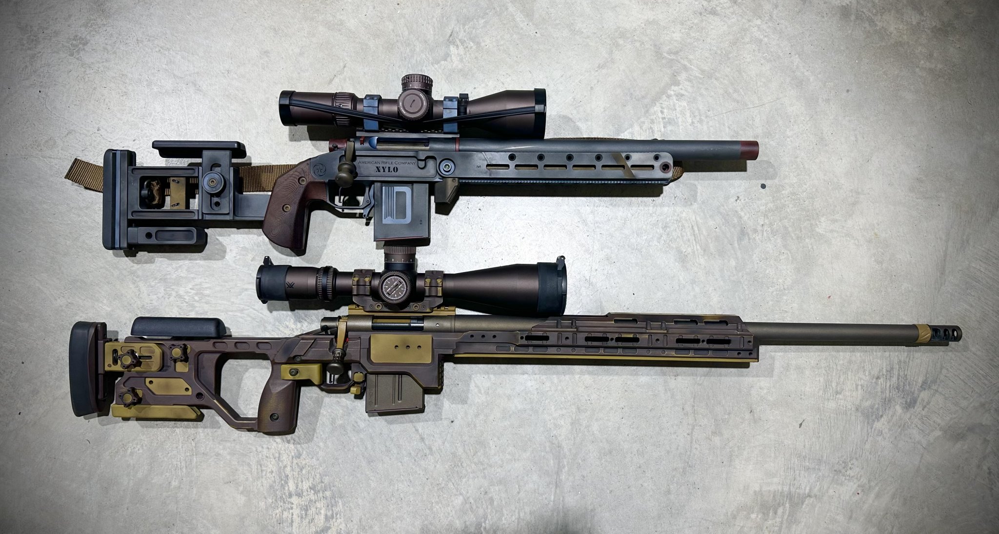

Two new to me GAP builds. First one is a Templar LA in 25x284 Norma, Manners PRS1 with Arca Rail, TT Diamond. Came with a spare barrel in 6.5x284 Norma and 1500 rounds of Copper Creek Ammo.
Second one is a 591 Surgon, Foundation with Arca Rail, Tim Hit. Originally 25 Creedmoor, but had a Bartlien 6mm GT spun up and installed.
Took both out to the sand pit, a few into backstop to zero and the first 5 of each on paper @ 200 yds.
Sweet rifles. I had a 6.5-284 that i loved. That "wood" stock is awesome!
Had a friend meet me there today, he's like "I gotta get me one of those wood stocks, looks fantastic". Wants to put it on his Rem 40x, I had to break it to him and tell him is mircata. :) He's all good with that.
The 2nd barrel (6.5x284) is being used in another Templar LA build, just waiting on the action returning from nitriding.

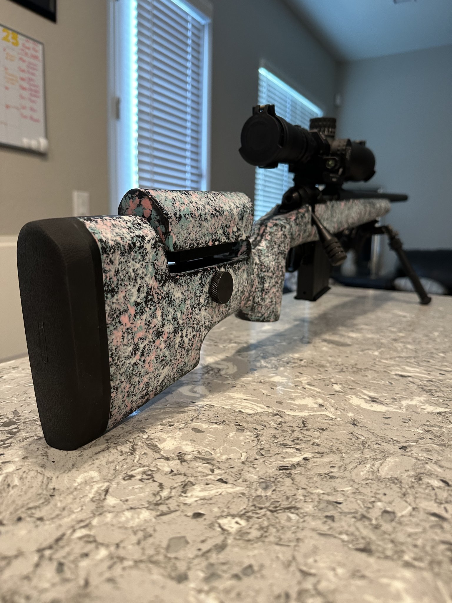

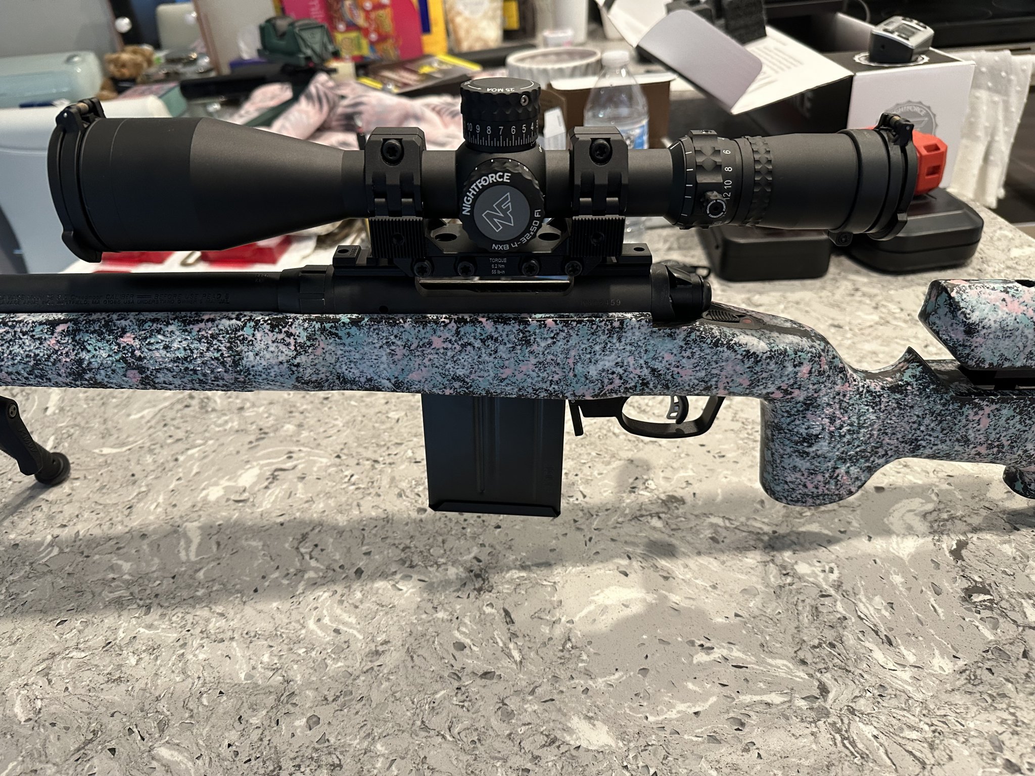

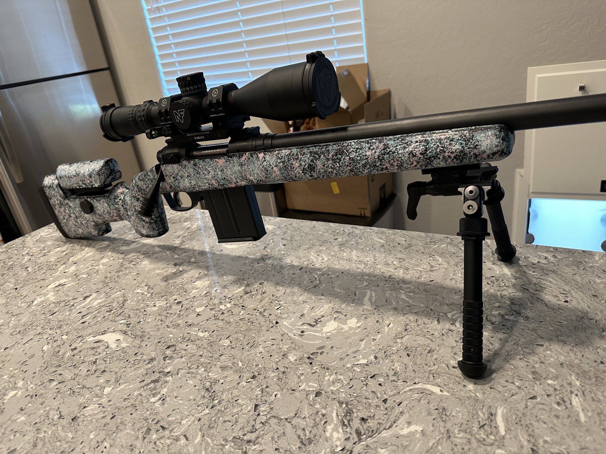

Just finished this custom savage for my significant other. Hand made the stock myself at McMillan. All of the color is the gel coat of the stock just like the marble patterns from them.
Savage model 12 6.5 Creedmoor
McMillan A5 Adjustable stock
Atlas Bipod
Nightforce Nx8 4-32
American Rifle Company Rings
Still working up a load and then going to shoot a few PRS matches with it.

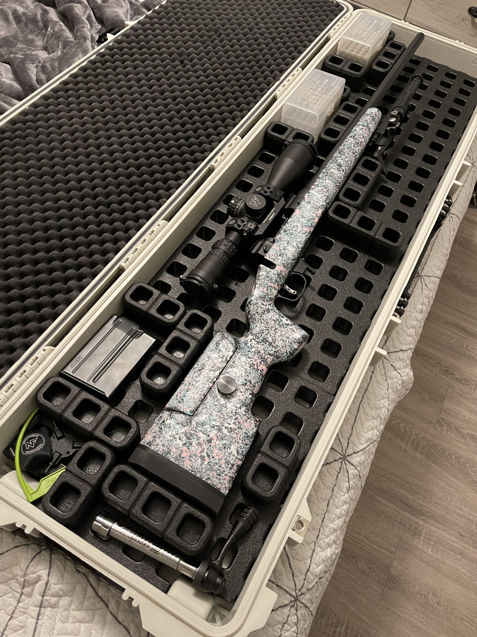

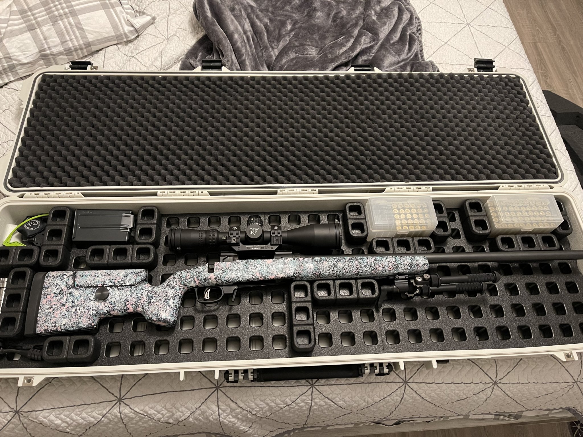

That gel coat looks awesome. What case/ case insert is that?
The case is a 53” Elyar case from Amazon in white.
The foam is the new magpul daka grid. I removed all of the base foam and trimmed the daka grid to fit. I didn’t use the other type of foam magpie gives with the daka grid. Didn’t fit.
I went with the grid system because the regular foam the case came with was not supporting the weight of the rifle. The magpie grid system is phenomenal, I absolutely love it and holds the rifle like solid. Also now I have built in provisions for the ammo cases and extra room for tool bags or magazines or whatever. It’s totally configurable and that’s the best part. Overall only have $375 into the case and I’d argue that’s an incredible value.
