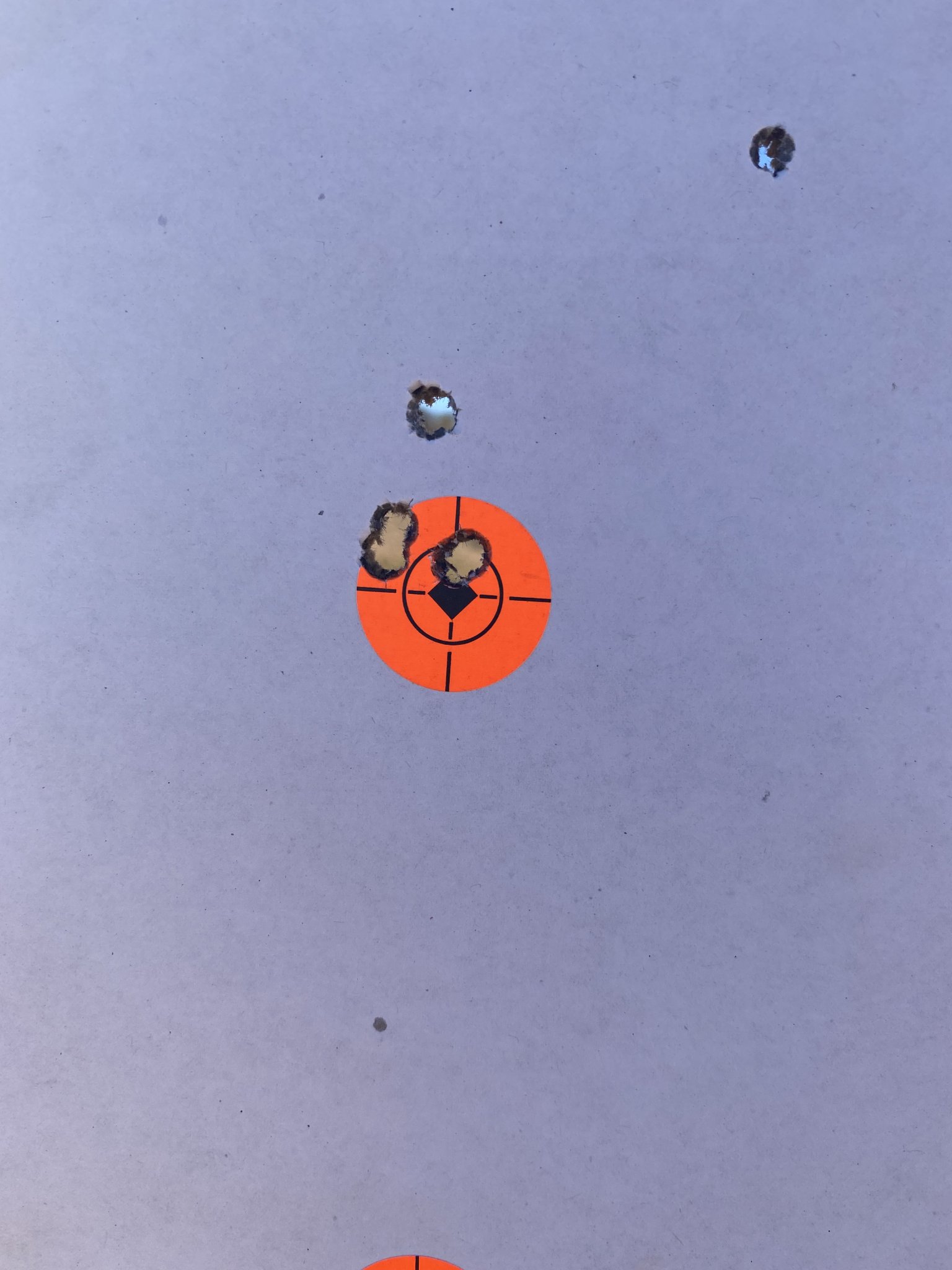

Just got my new 7mm Rem Mag barrel from them on Friday. Did the initial test firing and barrel break-in yesterday. Only fired 24 rounds but all went well. I'll be testing out to 558 yards at some point later this week after my taxes are done. I do have a spot where I can shoot out to a mile. That's my goal but no set timeline to achieve that.

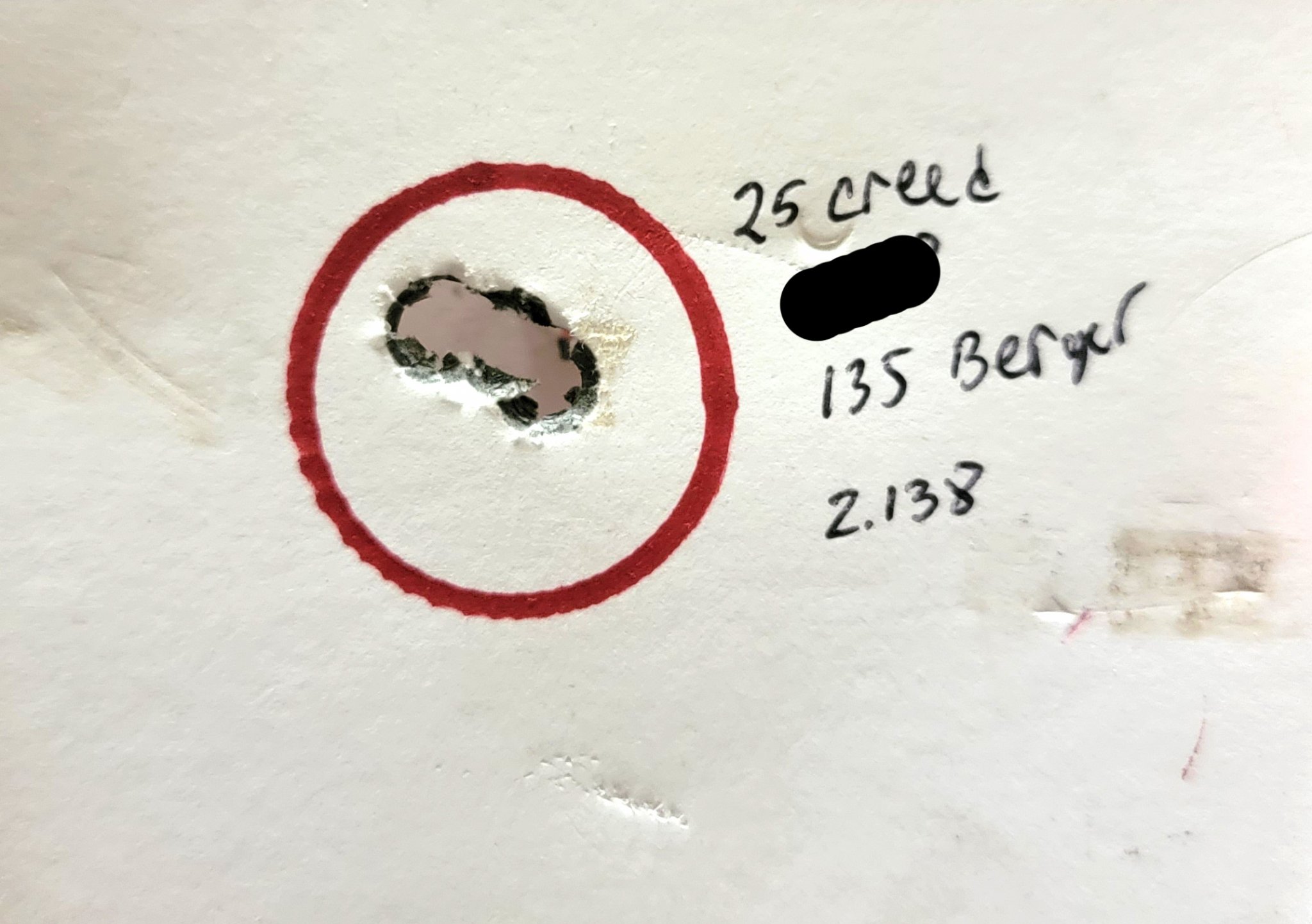

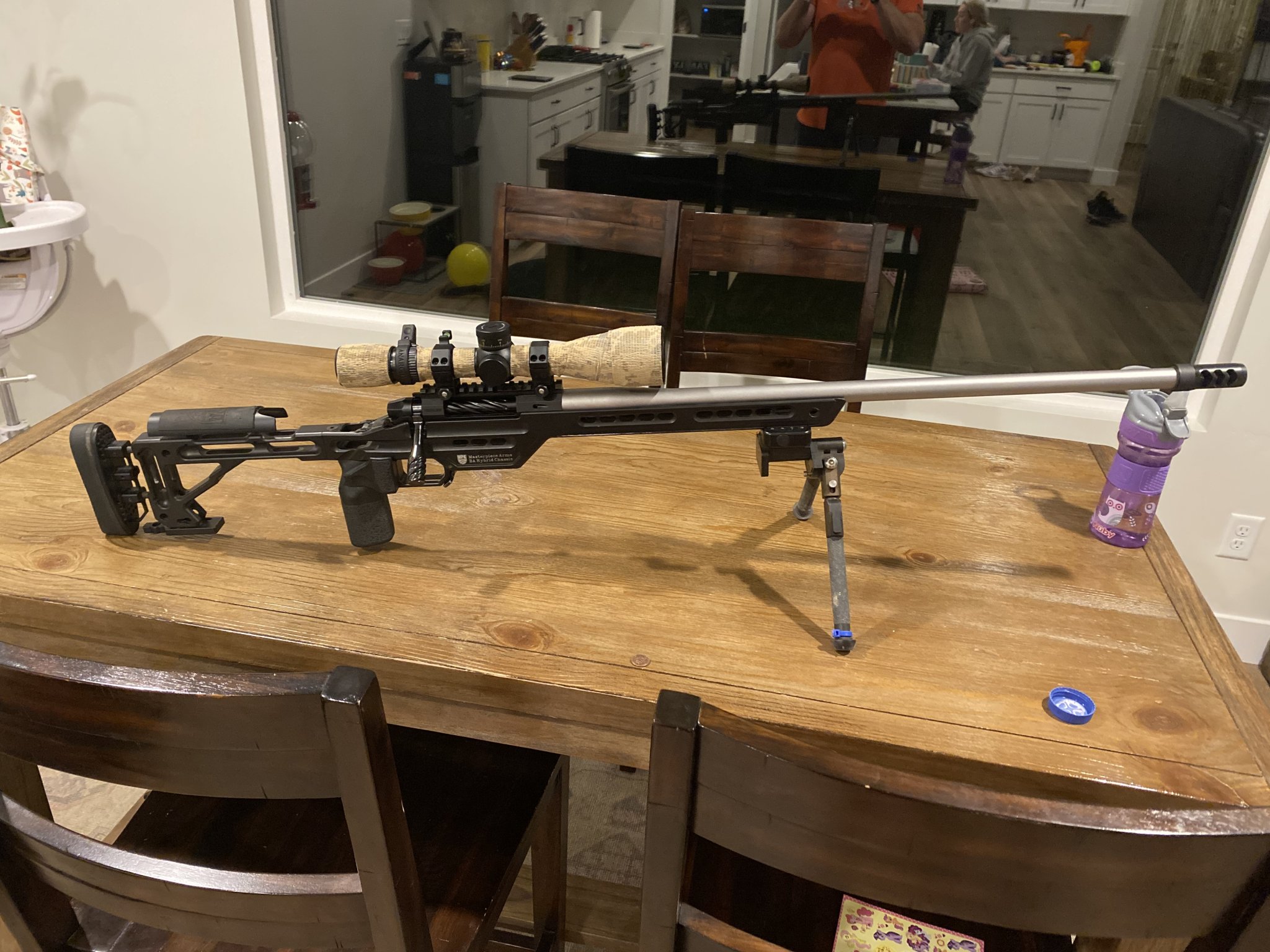

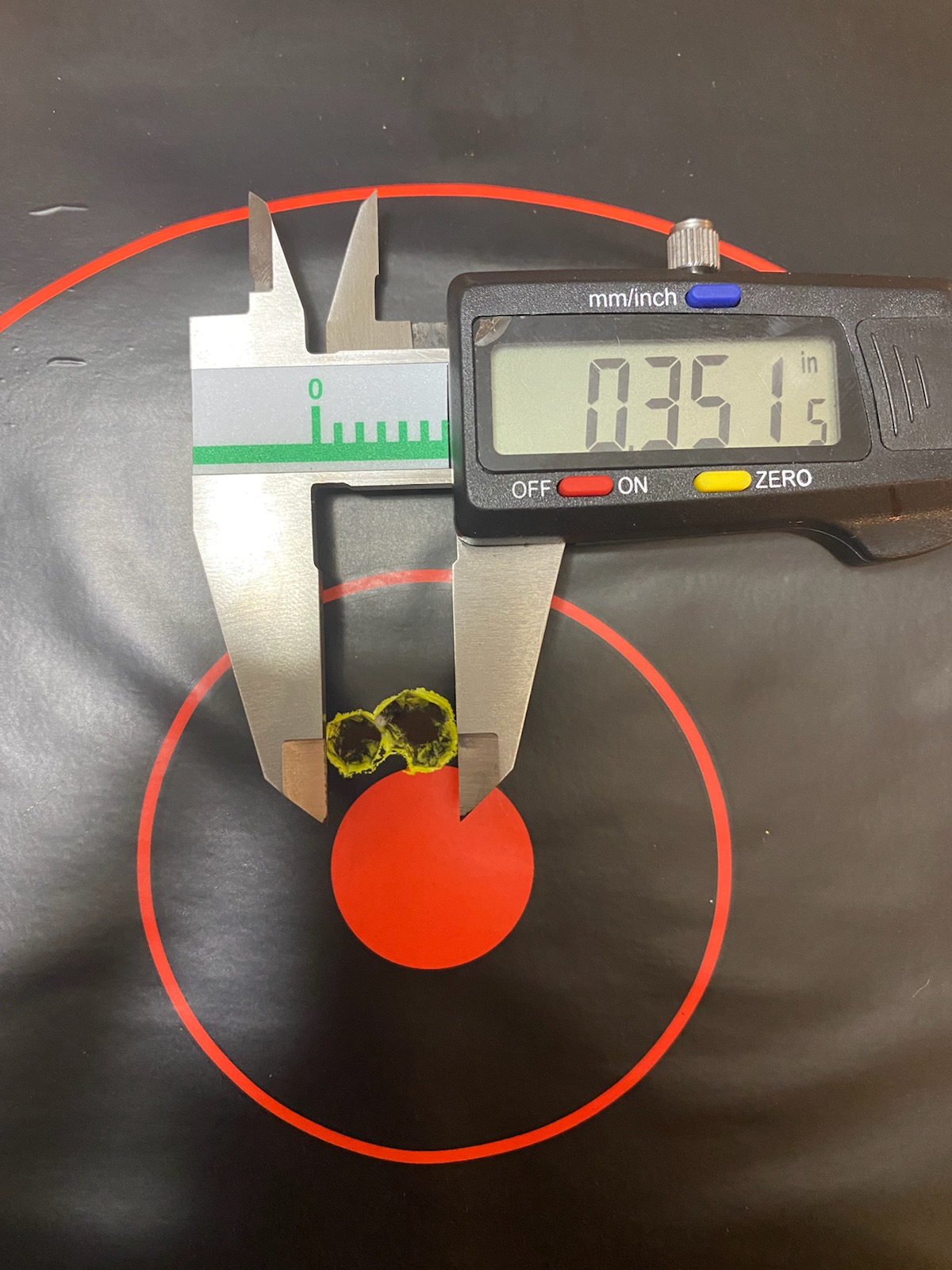

This is a 6.5 PRC I did with a Preferred Barrel on a Gunwerks GRB action. It's a Sendero 8 twist 5R pushing 147 ELDMs. 5 shot group.

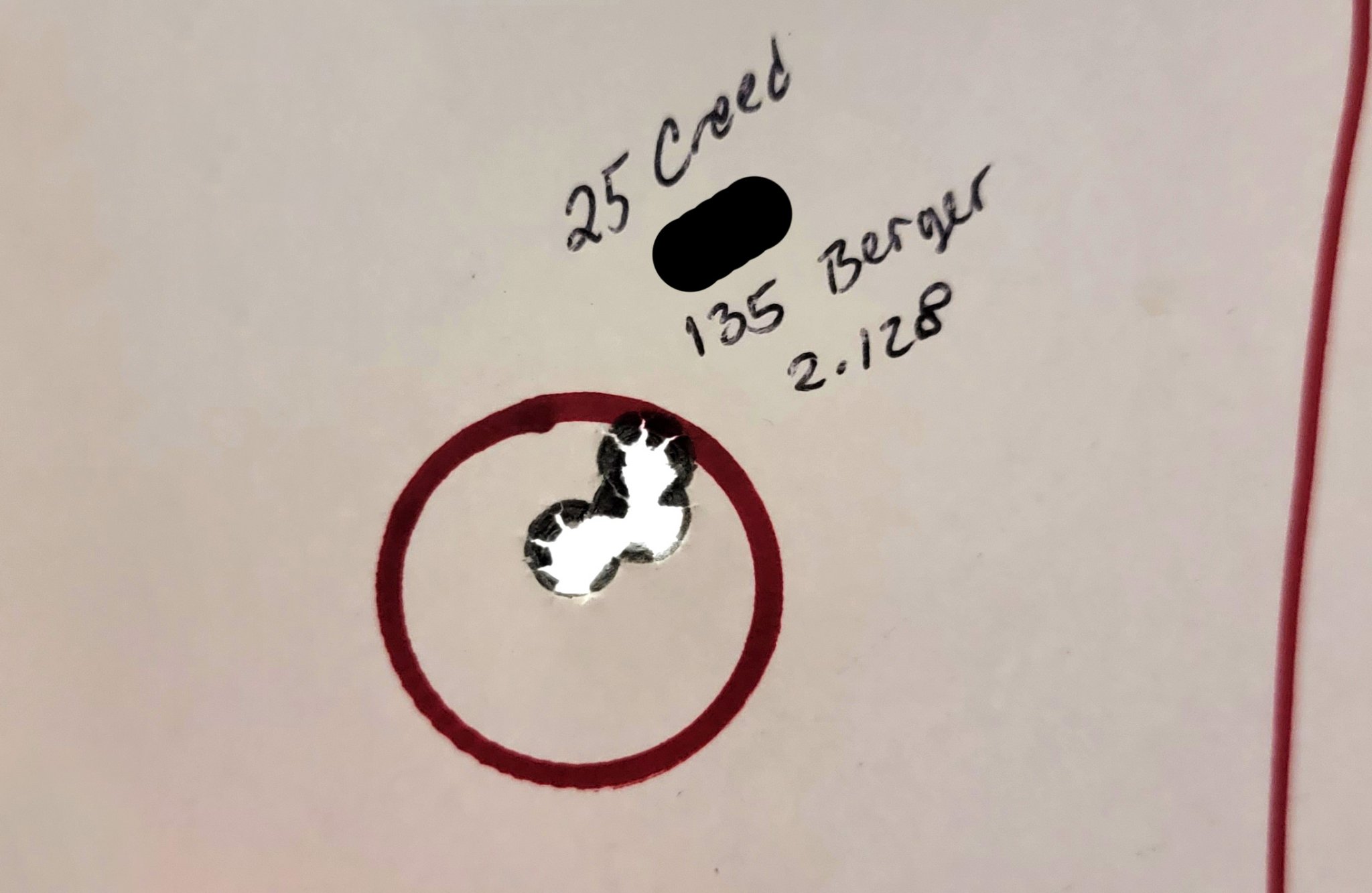

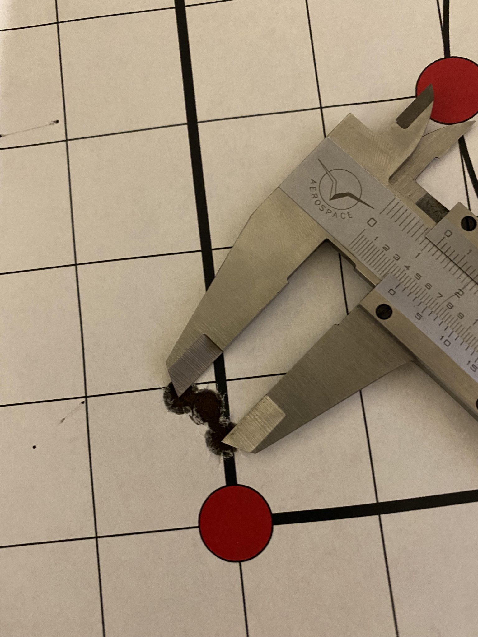

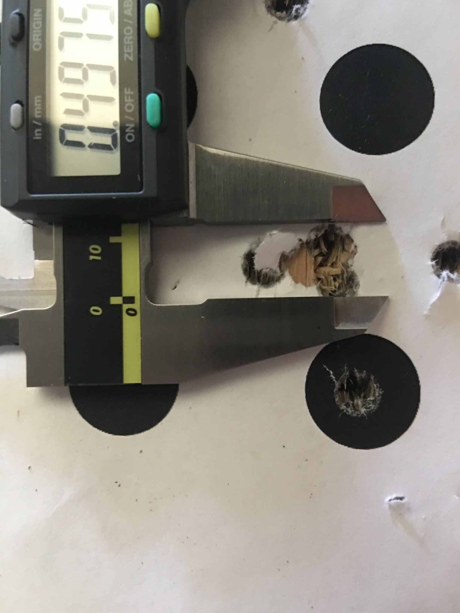

Got a .308 22" 1:10 Taperless .900 from them about a month ago.
These are at 225 yards.

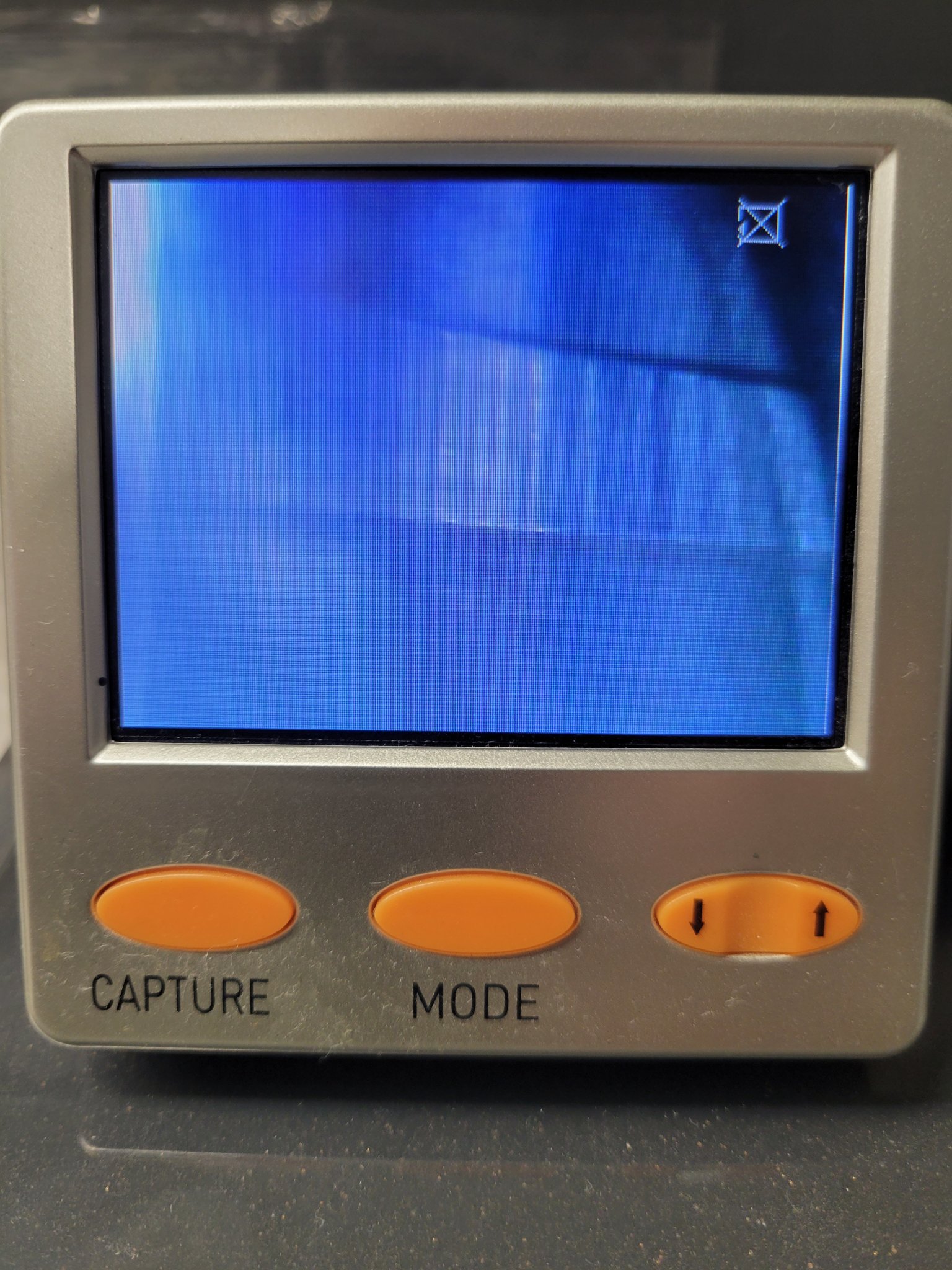

My first and Last experience with this company. Shitty reamer job, looked like it was done with a Dremel tool. Tooling marks galore. I like to run bullets seated with bearing surface just in front of the neck shoulder junction, usually around .075 jump and I run a barrel tuner. This barrel was a whopping .335 jump with 190 Berger at that seating point. (barrel was for 7/300 PRC)
Their listed phone number does not work, get the cannot be completed as dialed message. Went to send the barrel back and the listed address is not recognized by USPS. Post office put remarks on it, if not deliverable, return to sender. Got the call from preferred and they claim the barrel tube was empty on delivery.
Buyer beware!! What a bunch of ass clowns to deal with. The first email between us, they denied the barrel was from them as they just got the Manson reamer. But I was the one who shared the reamer specs from Manson and they bought one and said I would be first in line, I guess they forgot that set of emails. I will never use or recommend this outfit.
Only picture I have, I do have video but do not know how to load it.

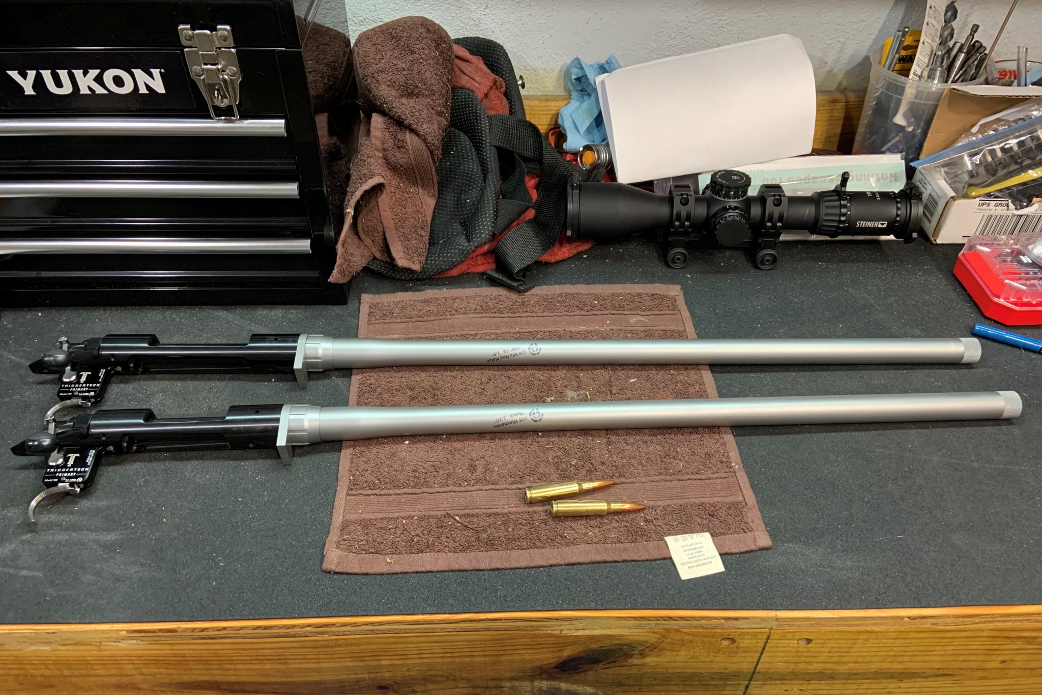

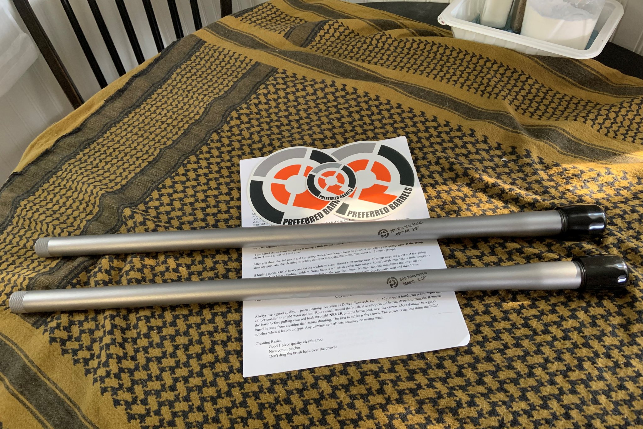

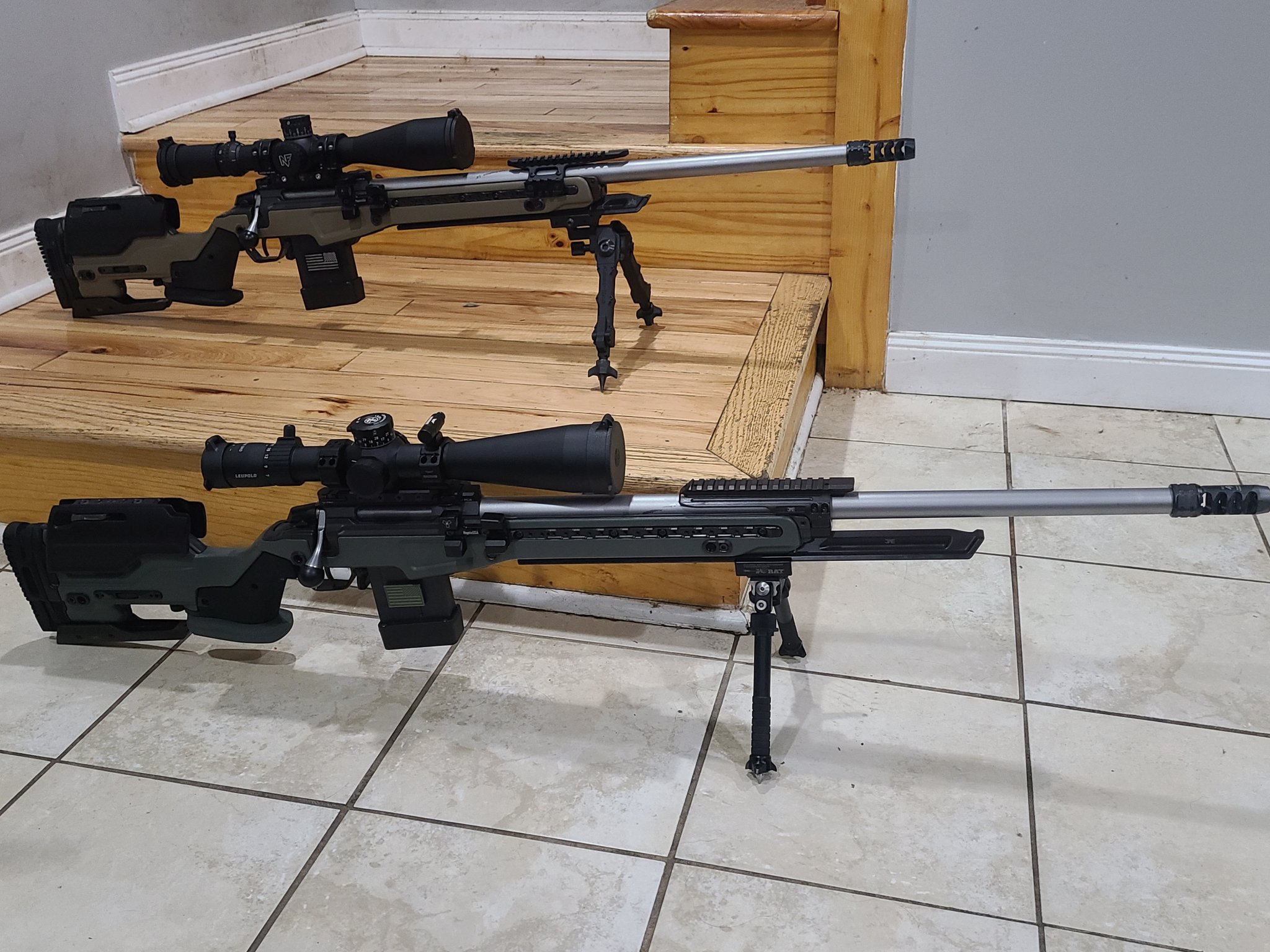

Well I received my two barrels and just mounted them. They look good, but I will not know how they shoot until I get the chassis in for them, and that wont be for another 10 weeks. :(
And yes, they are dummy cartridge's.;)

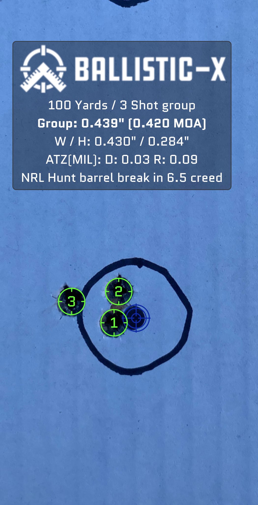

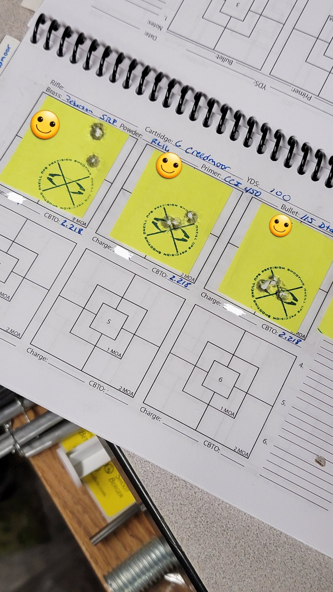

Got my new 6.5 creedmoor medium Palma barrel for my NRL hunter rifle broken in. First group is the initial break in, second group is the next time i took it out while still getting the barrel to break in. (First high shot was a sight in, next 4 are on the pasty) Very pleased with the results. Both are right around .4 moa

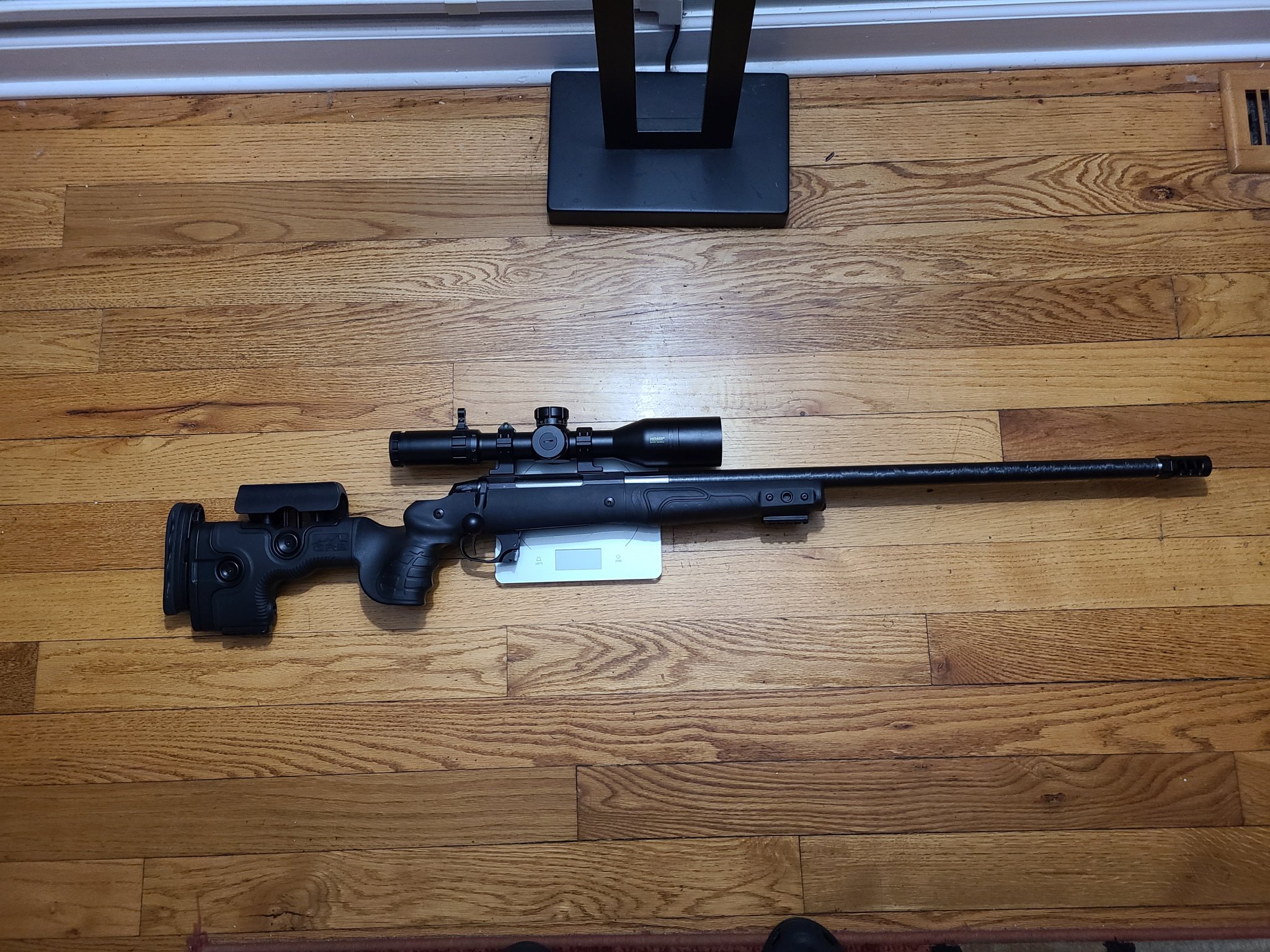

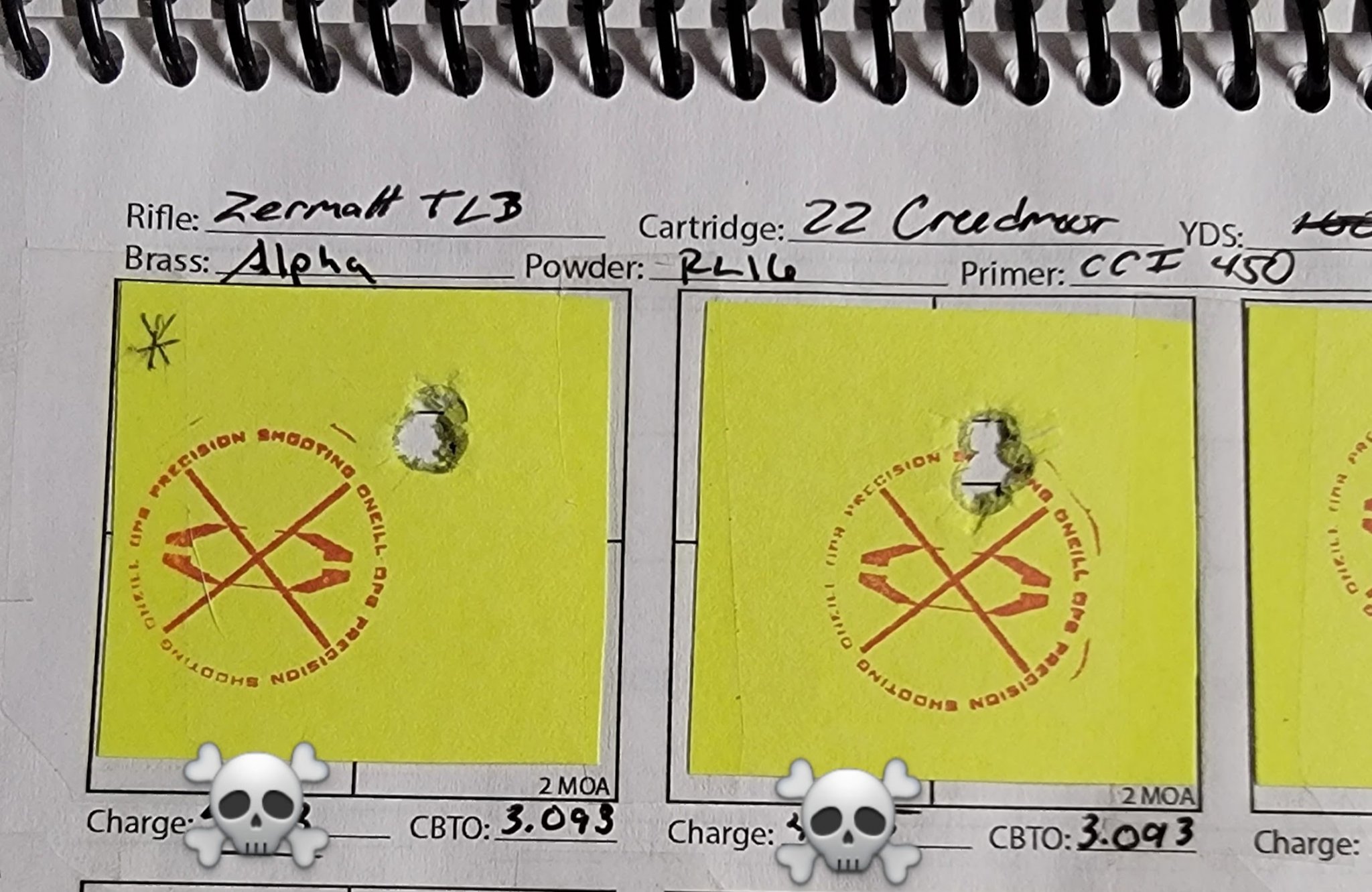

This is my 18" 6Creed barrel.

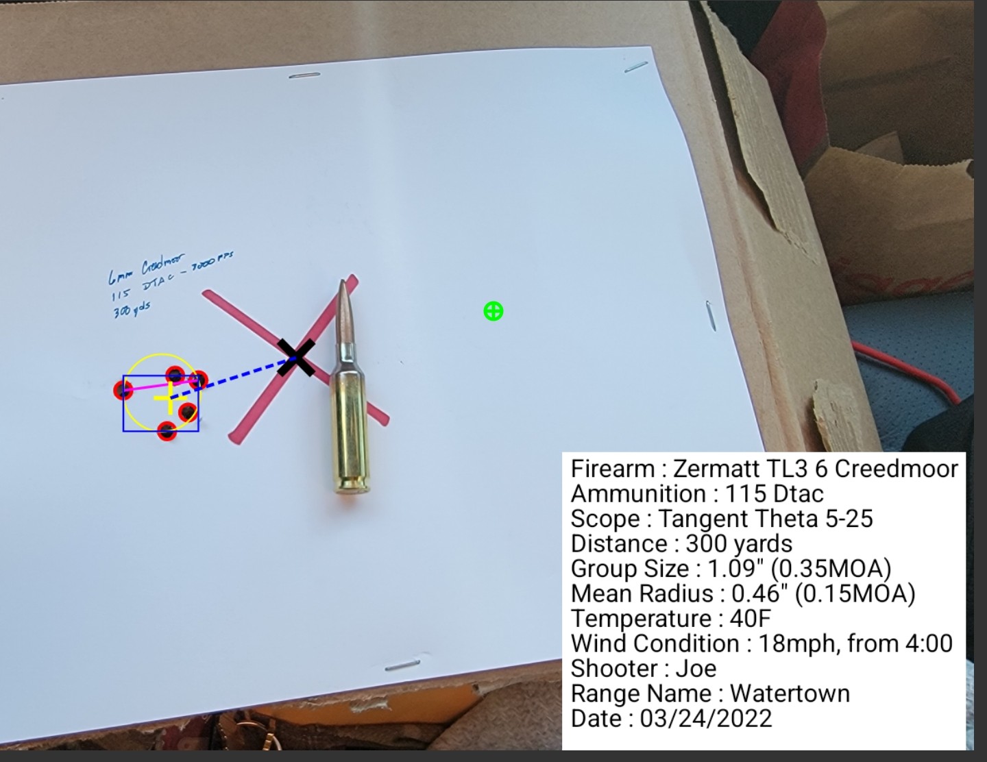

During load development

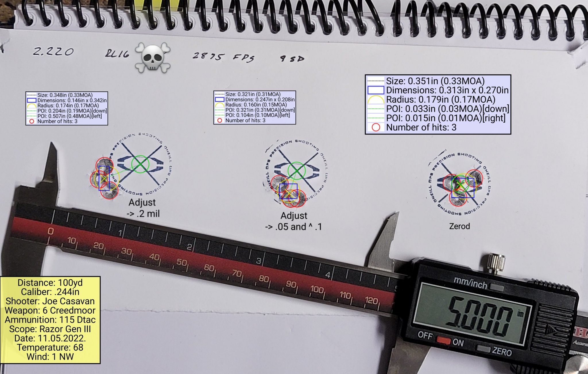

Checking and confirming drop at 300 yds.
And the load I settled on after the velocity leveled off.

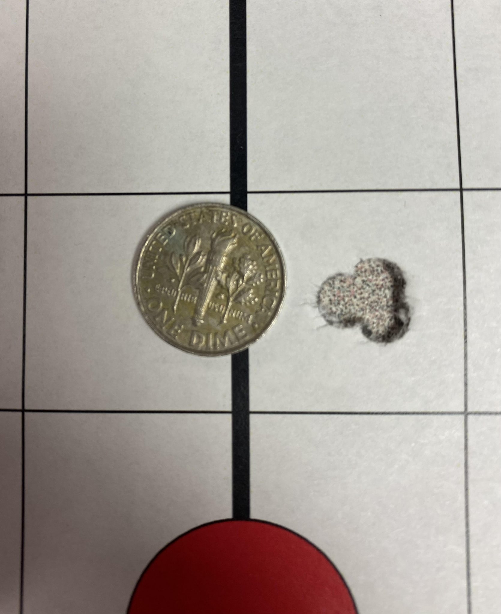

Load development with my #1 sporter 25-06 1:7.5 twist was almost nonexistant. It shoots 121gr Hammer Hunters over RL26 at around 3200 fps with 1/2" MOA accuracy, but it devours hornady superformance 117 SSTs.
This is a five shot group:

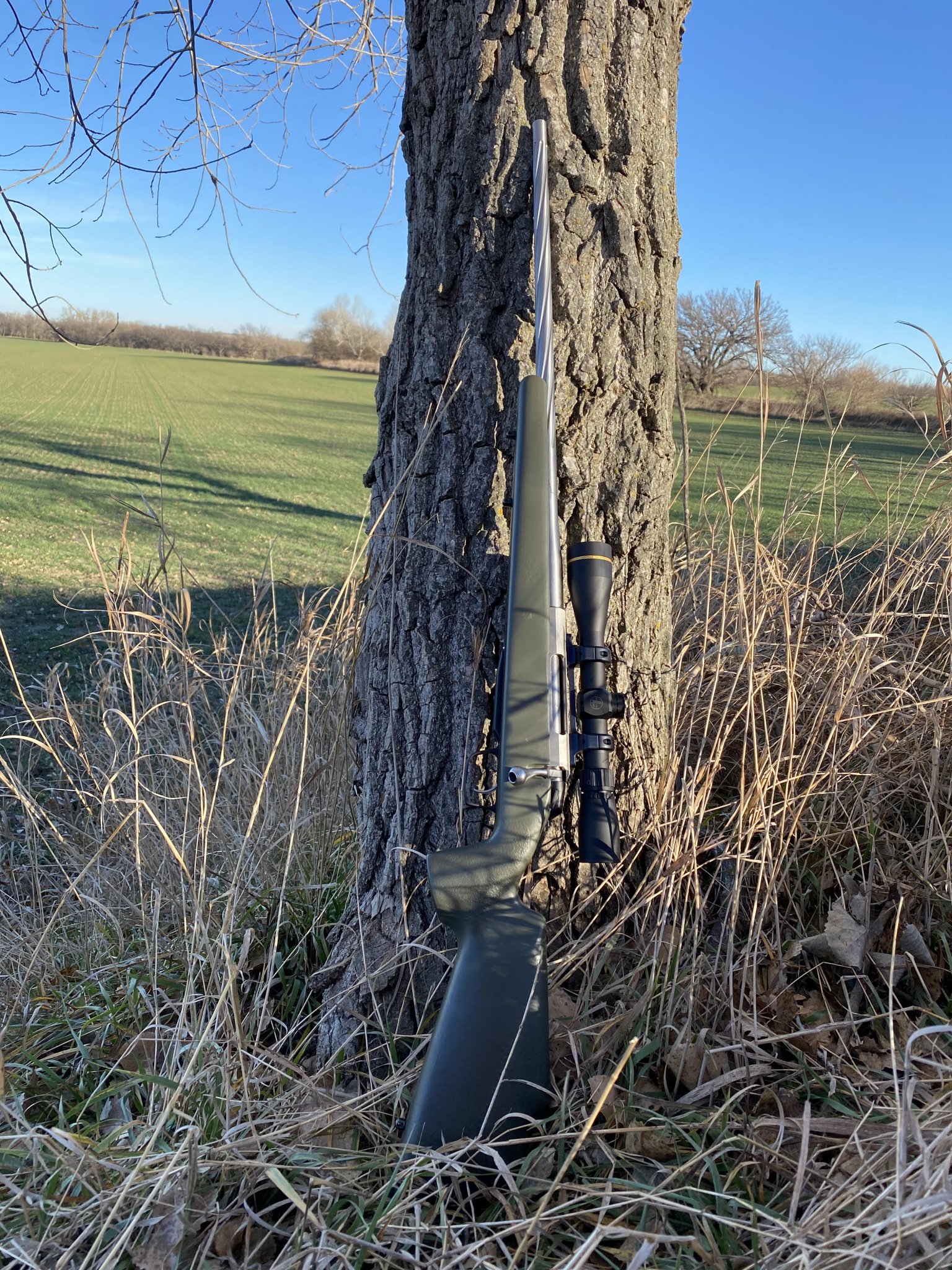

The gun:
