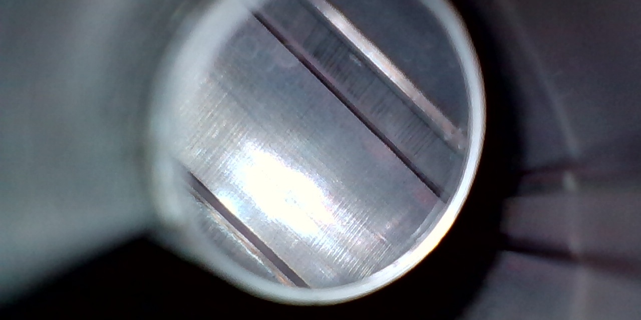

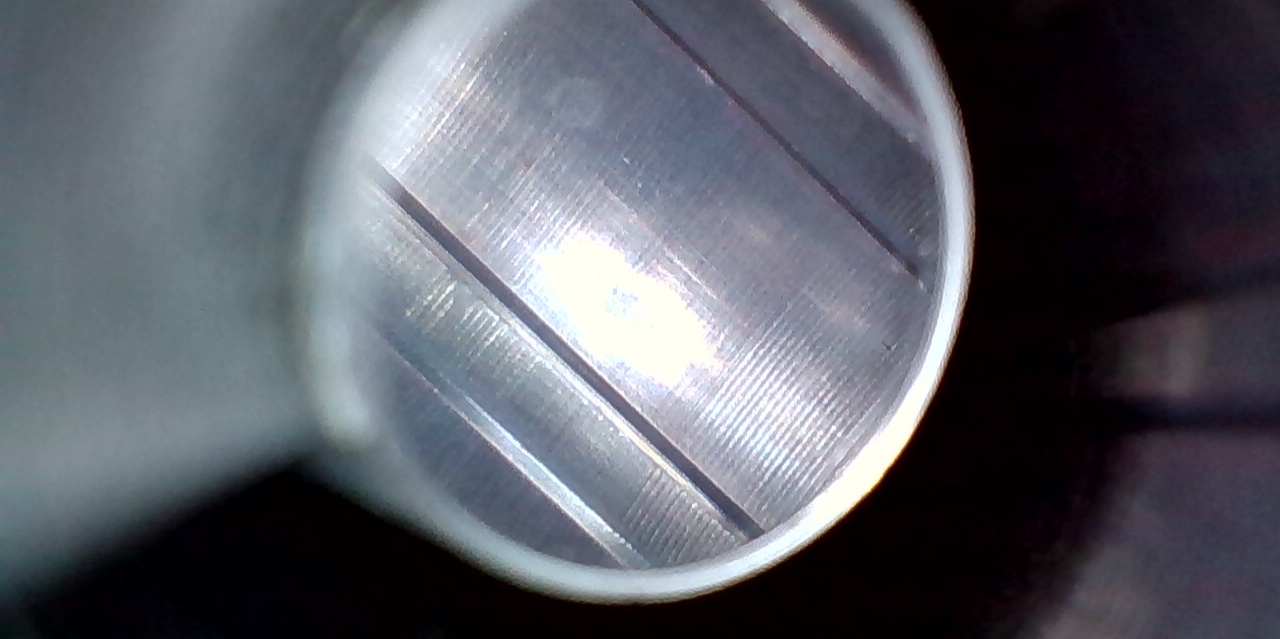

Where did you get the information that they don't hand lap? When you go to the barrel material options on their website the first sentence reads "All McGowen barrels are precision button rifled, stress relieved and hand lapped to ensure consistency and ease of cleaning." FYI for all, my McGowen was $330, threaded, chambered, contoured and crowned, I didn't do muzzle threads. I've paid $330 for a blank before. Shipping is about 30 bucks. Very affordable barrels.
I’m referring to preferred barrel blanks

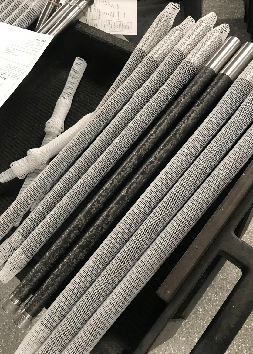

Looks like they are offering carbon barrels now for an additional $350. They also increased thread pricing from $65 to $80.

^Their carbon wrapped barrels. I am being quoted for a 6.5MM Blank 22" @44oz which is LIGHT
Do I go PBB Carbon for $790 or Bartlein Left Gain Twist CF MOD400BB for $450 more..?

I asked them they are not lapped

Make it heavier? I've not done carbon myself but pretty sure the primary, perhaps the sole reason people are willing to pay for carbon barrels is to make it lighter.
Make it heavier vs just using a super light profile steel barrel.
The reason people do it is stiffness. Some people like to run a light weight barrel without having their zero wander after 3 shots.

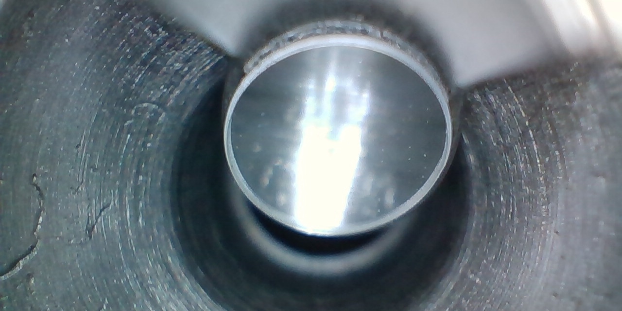

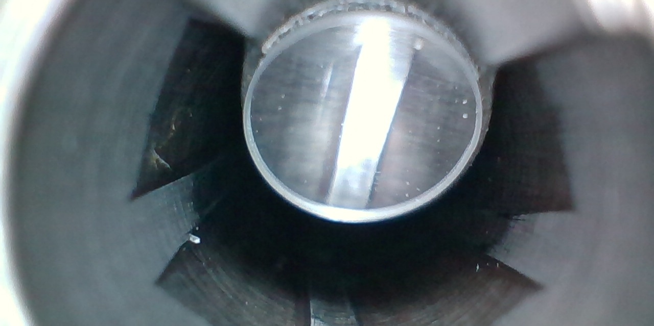

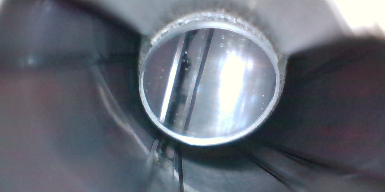

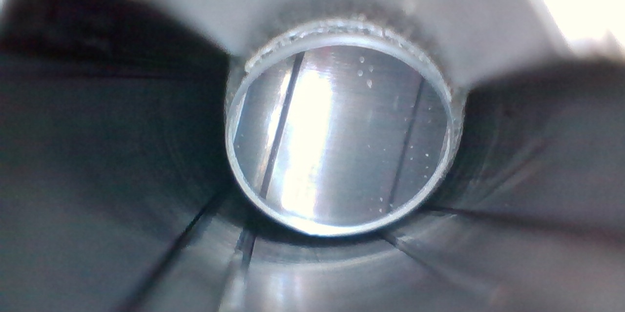

I had two barrels from PBB that shot all over the place.
They gave me a 16" 6.5 saum for free when I sent my last dud back to them.
It took 3 months for the replacement and then I found out the neck diameter was under sized. Turned out their reamer was out of spec, so I shipped it back and they re-chamberered it for me.
I got it back a few weeks ago and this barrel is showing promise, I have a little more testing to do but so far it looks like a winner

Because they turn down the diameter of a heavy barrel in the middle section and leave both ends. Then wrap with carbon fiber back to those diameters. Replacing the metal with carbon fiber. This makes it lighter for the same dimensions or contour.
