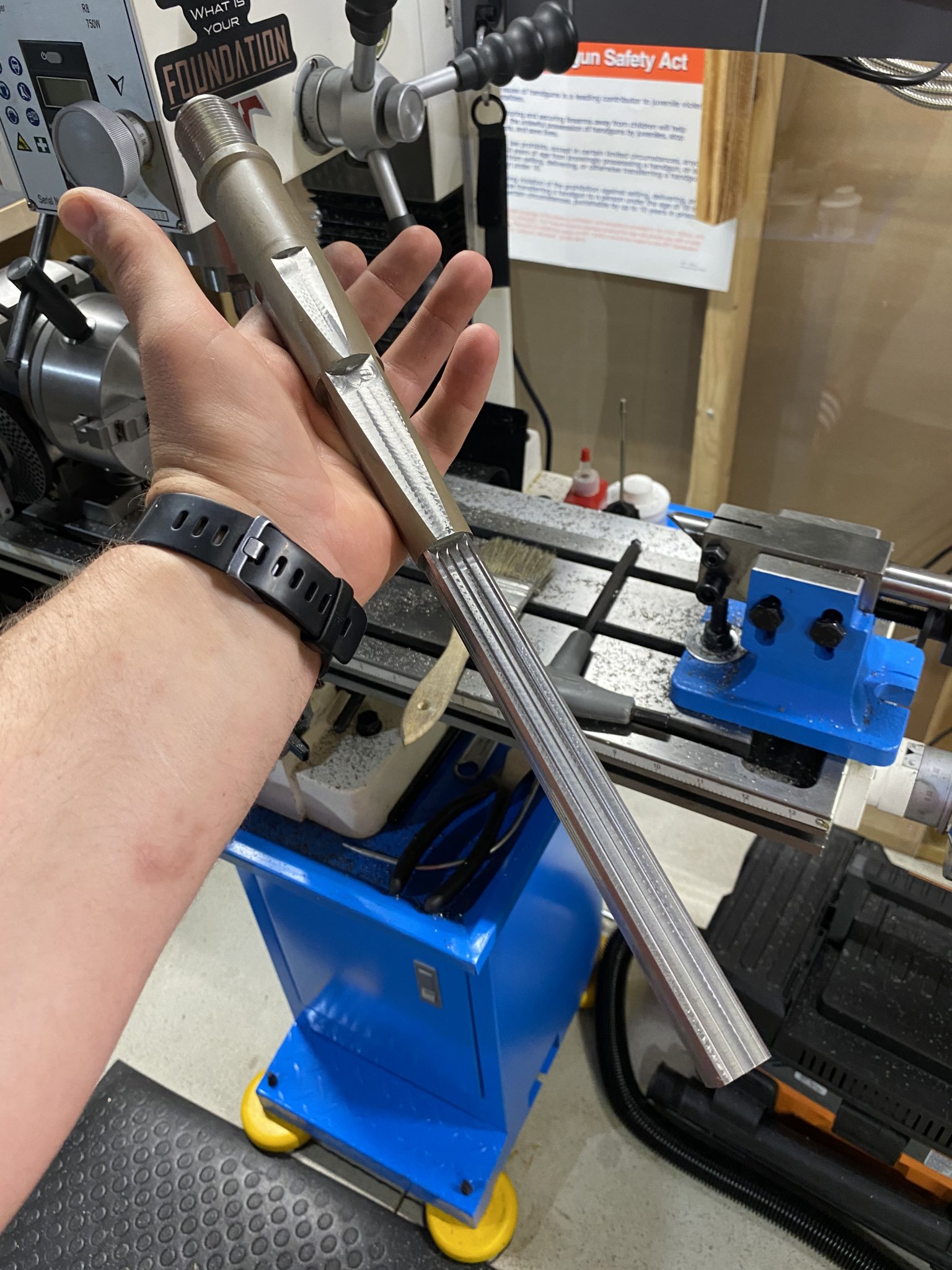

I’m just a hobbyist gents. I picked a Precision Matthews mill with DRO and put on a x axis power feed. Small little machine, but it’s handled every I’ve take upon myself to build. Mainly used for Jeep parts, or inlet rifle stocks. Nothing serious. I had a few burnt out barrels that I ripped into to figure out different feed and speed with the carbide end mills that I do have. Just tinkering.
