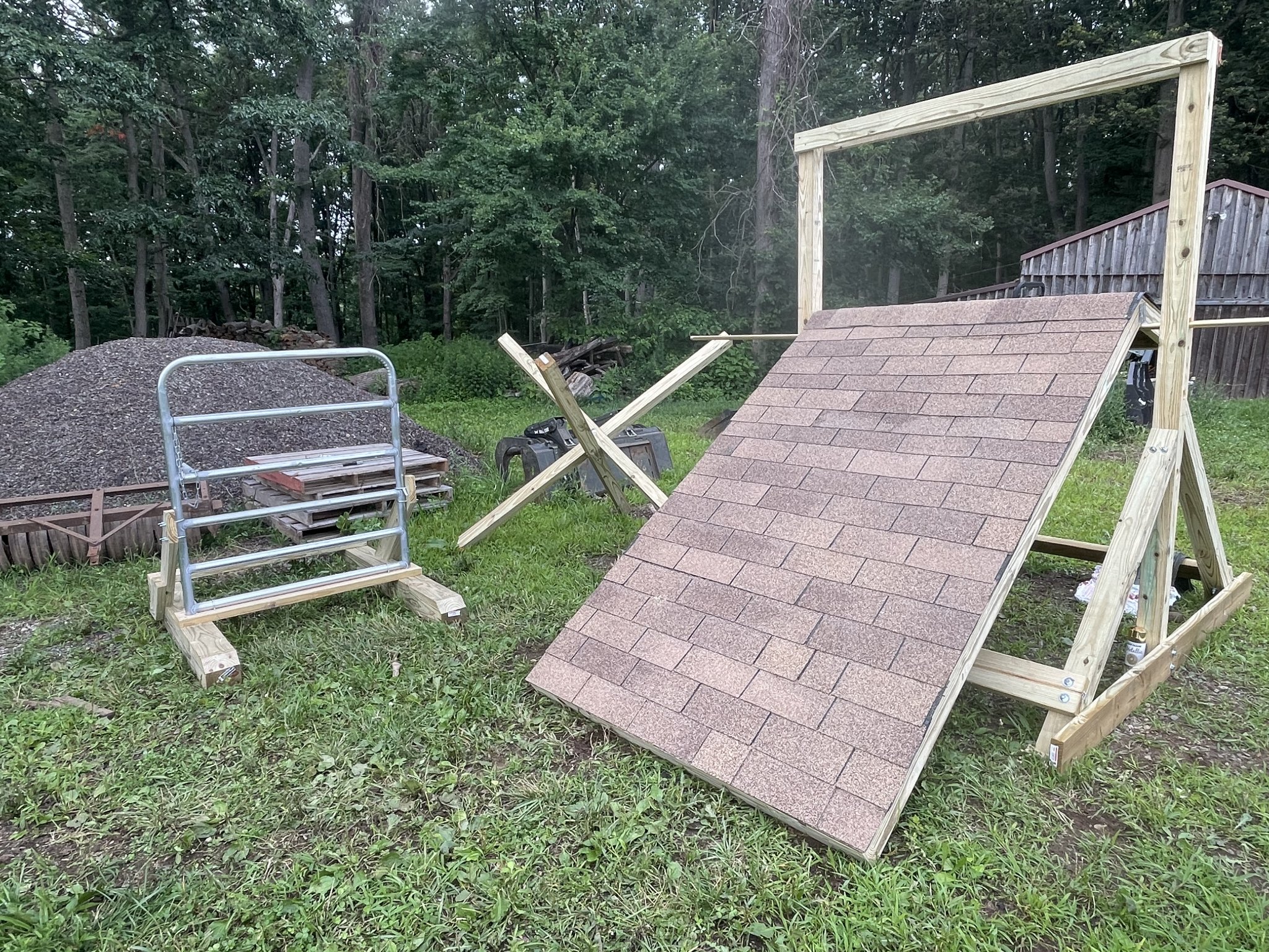

View attachment 8003892View attachment 8003891

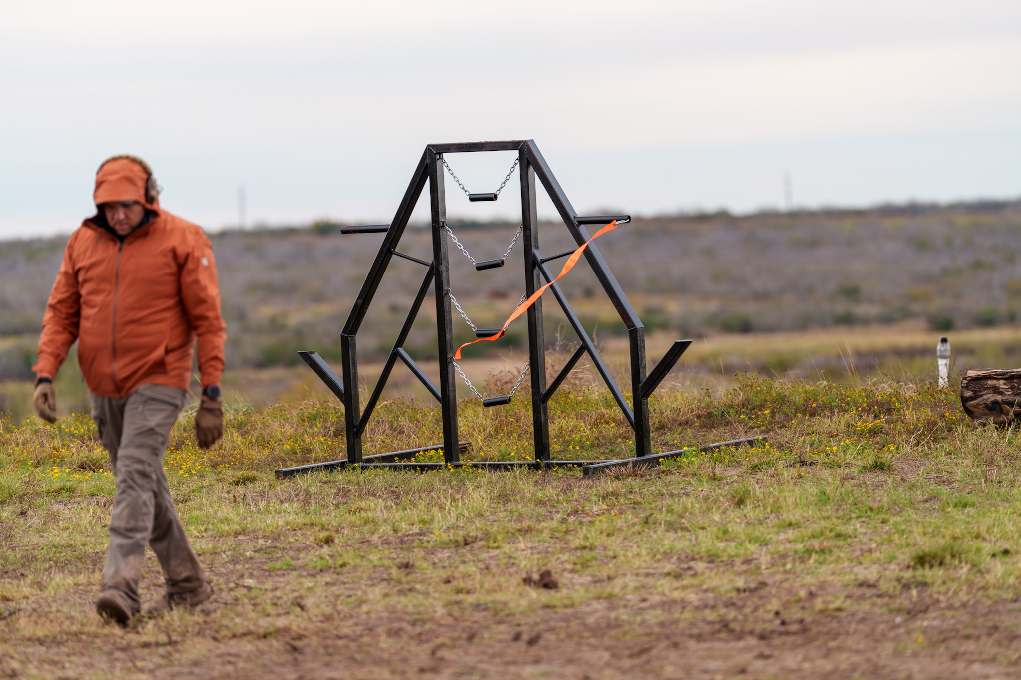

My buddies built these for me
Use the gate the most then the tank trap wish it wouldn’t have been a surprise I use the roof rarely only see a roof stage at maybe 1 in 3 matches
Edit. Don’t know why text is bold
The gate is too short, and needs to be mounted on a hinge so that it both swings and bounces. Then force yourself to only shoot from a loop created with the chain. NO TRIPODS. THAT is a PRS stage...

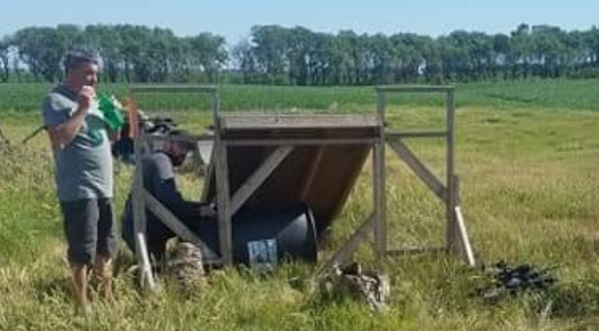

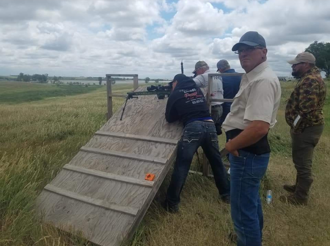

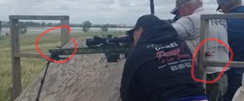

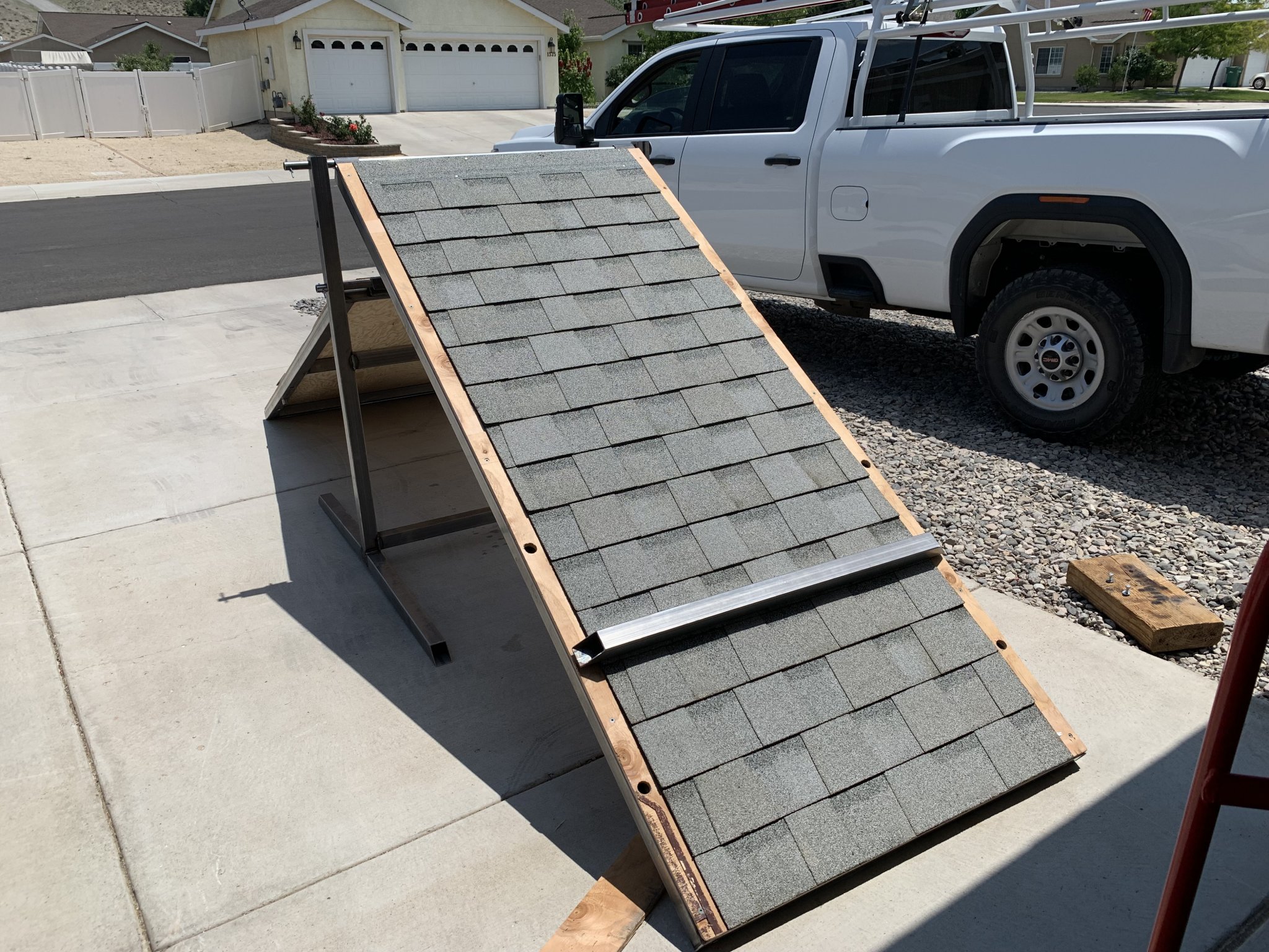

If you shot NRL22....you would get plenty of use out of the rooftop. The one thing about the rooftop is there is nothing nicer to train off of when they place the thing ramp towards targets or perpendicular. Cuz you just don't know how much room you'll have or if your bipod cants enough. Or its just smarter to run no bipod and a bag given your rifle's setup.
Your buddies did you a solid and shingled it to. Worse thing about the rooftop is some places have roofs so slick is a safety concern. We had a kid who (with immediate adult supervision) ended loosing grip and slide face down the length of the roof. Beat his knees on the cross slats to boot. The adult immediately grabbed the rifle to keep it from falling forward or worse back with the kid. Looked funny as hell at the moment but it was a serious issue.

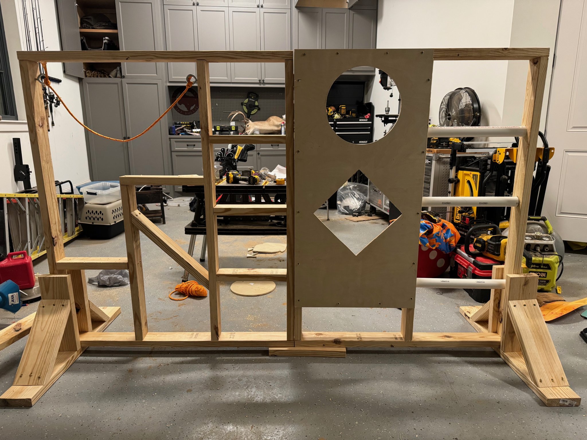

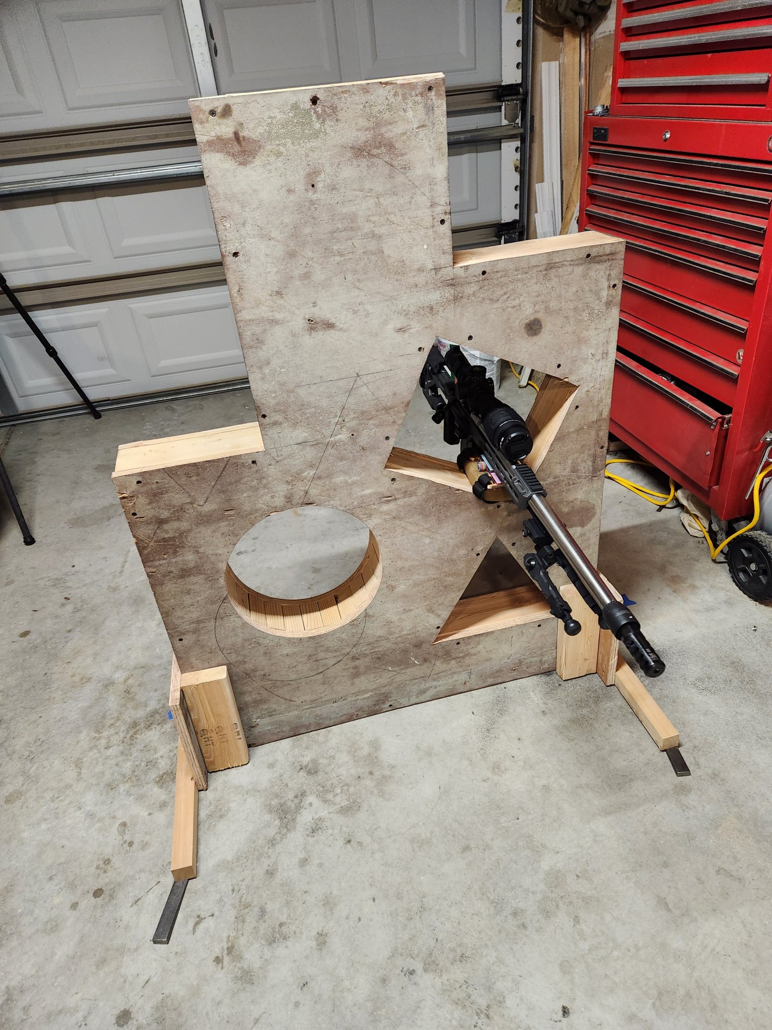

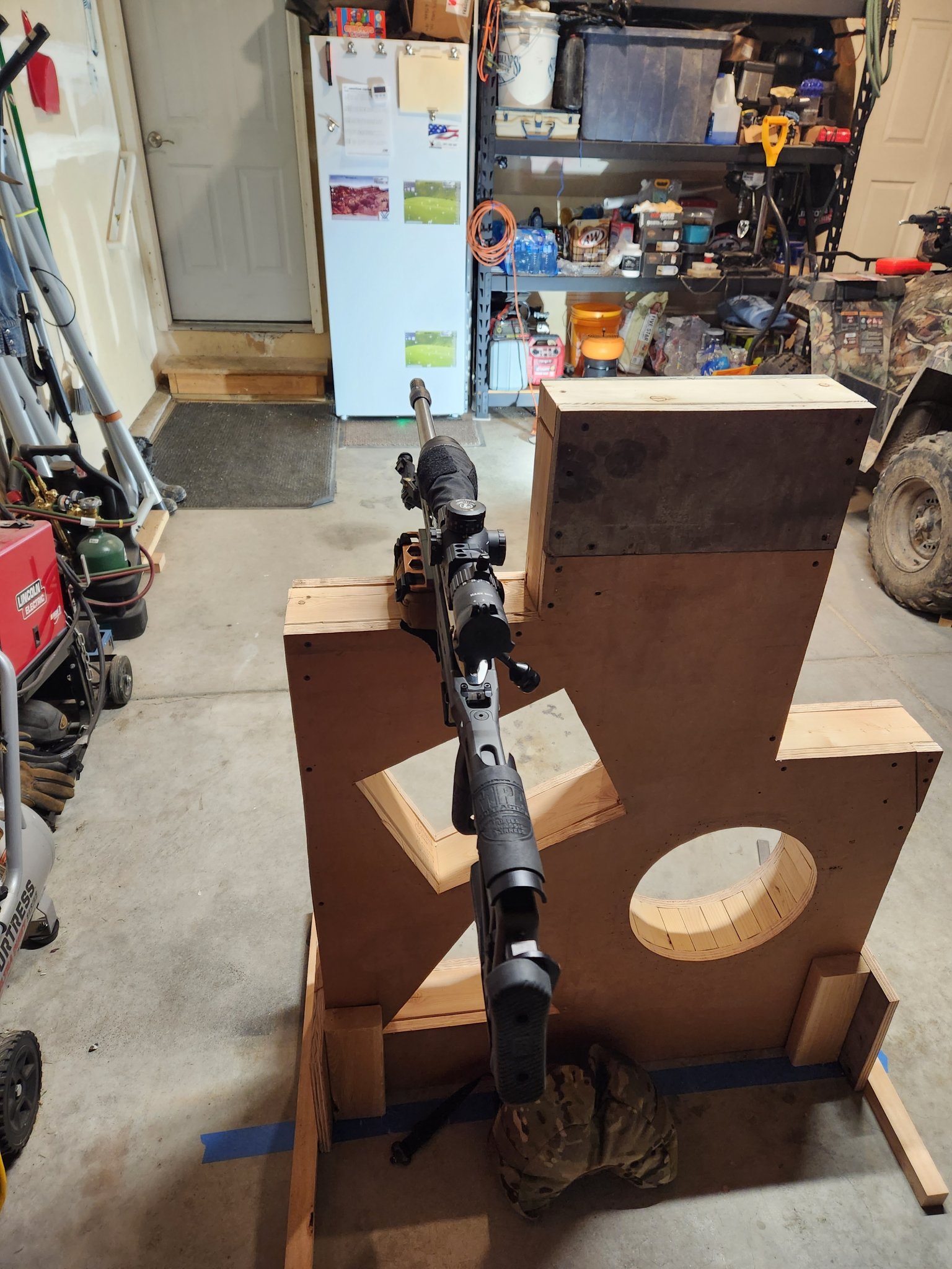

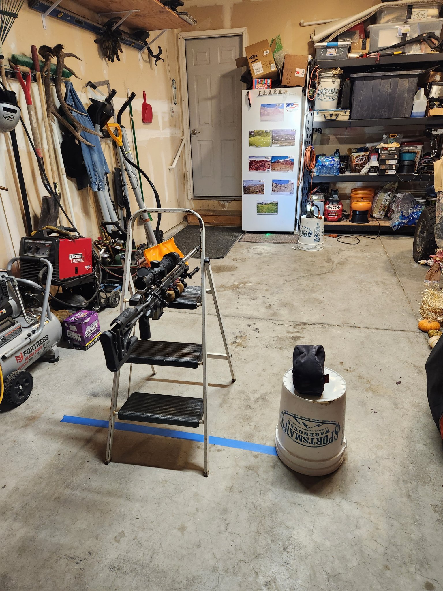

Picked up a DFAT system and built this to run dry fire exercises in the garage. So far the barricade and DFAT are working well. I also use a step ladder and a bucket to practice with.
I've even been able to take my barricades out where I have steel targets set up to 1k. Been cold so the garage is a nice training option.

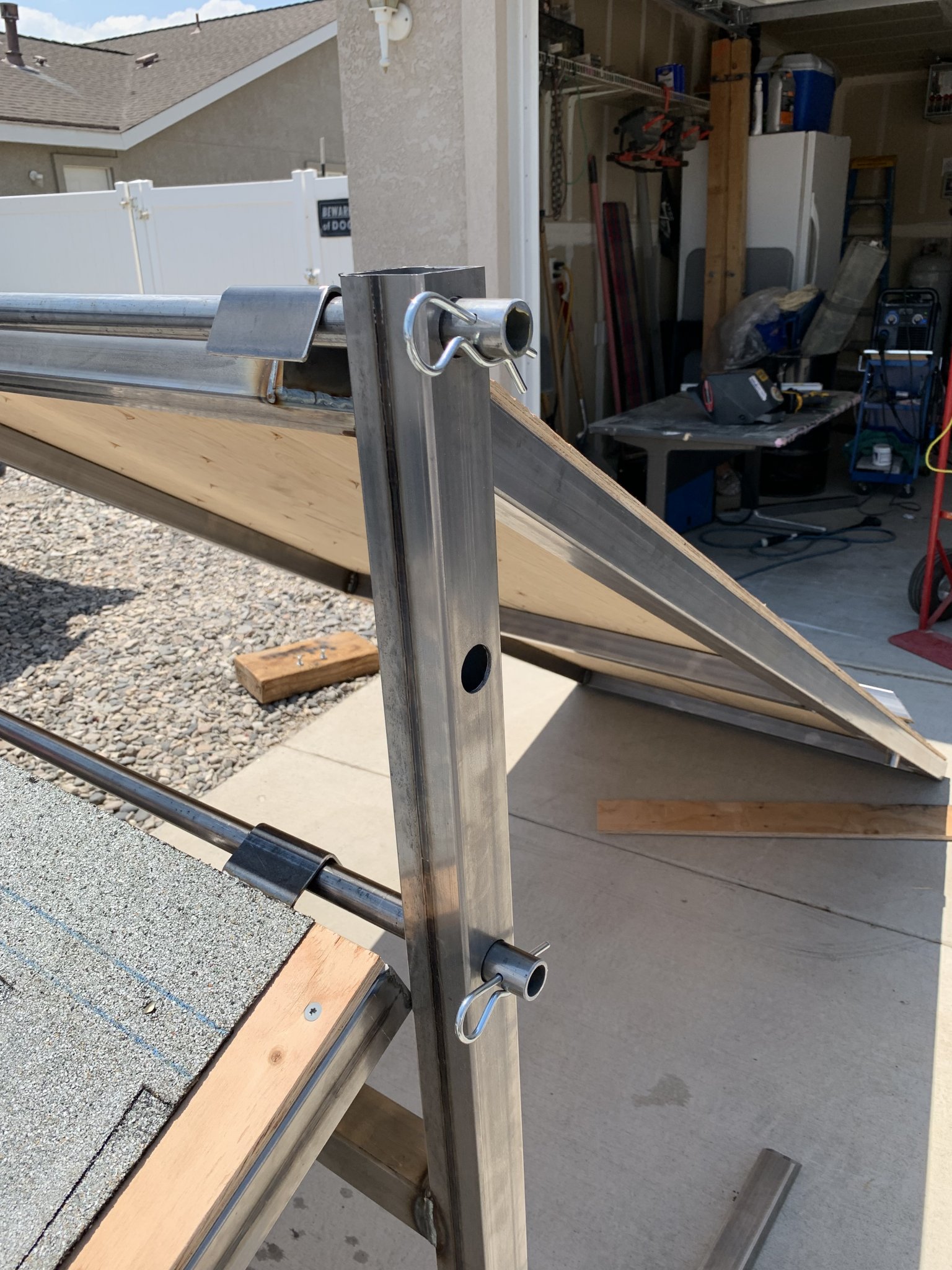

What does everyone think the minimum size for a rooftop should be
Just use 4x8 sheet of plywood. Build a frame for the sheet. Box it in. Add a couple thin traction slats or use some actual shingles.
I would make it flexible in terms of angle/pitch. We built one that used thick steel pins to act like hinges. It also made it collapsible to load up in back of truck.
You can also place cinder blocks under the bottom of the roof the make the angle less severe and still rock stable.
We made the roof mount onto a skills wall basically. So you get multiple uses out of one object.
Having watched a young teen kid skid face down a rooftop made it abundantly clear you need to be adaptable and lean towards safety in terms of supplying traction.
Reactions: BurtG
What is the width and length of the top of the rooftop? I'm planning one that I want to transport in my SUV and the max size I can fit is 4'x6'. Wondering if that's big enough
The one I built is 4’x8’ but I think you’d be fine with a 4’x6’ or you could make the roof part out of tube that could slip together and hold with pins…kinda like your trailer hitch.

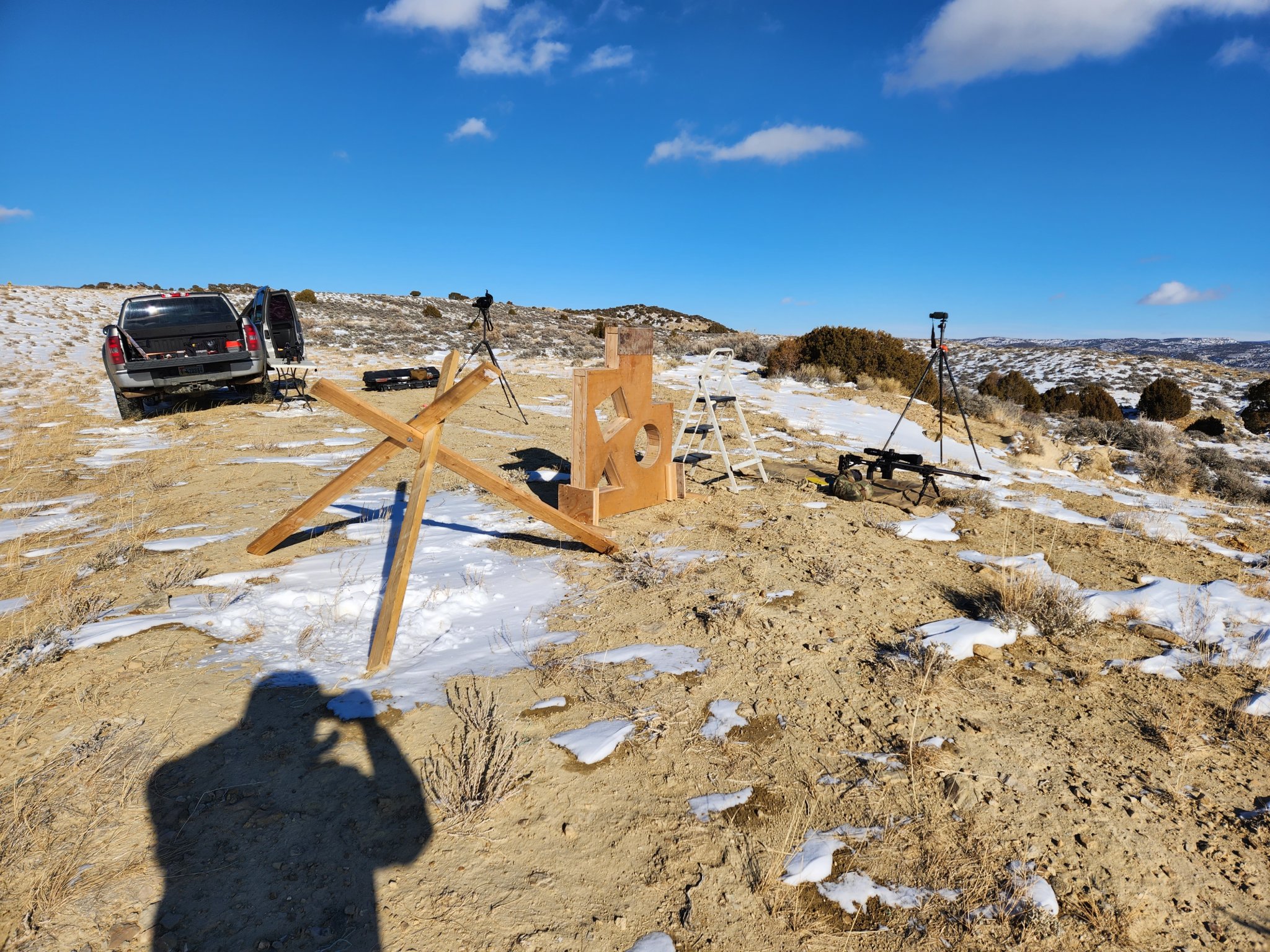

Anyone else have some shooting prop ideas? Club we shoot at we are using a range where we can not leave props out. So we need ideas that are easy to move and store if at all possible?
The intent of this thread is creative barricades. Which is antithetical to your question sorta....
If you want portable/cheap/easy props....get everything on the NRL22 barricade list.
All of them (even if you build your own rooftop or tank trap or triangle ladder) are all easy to assemble and move.
It's actually kinda one of the complaints with those obstacles. They can be kinda rickety feeling in some cases.
The really cool creative obstacles/barricades are big, stable, practical to lifelike shooting scenarios. Or offer a unique challenge over the vanilla NRL22 ones. But you can do a lot with them. Use them....combine them....think outside the box with them.

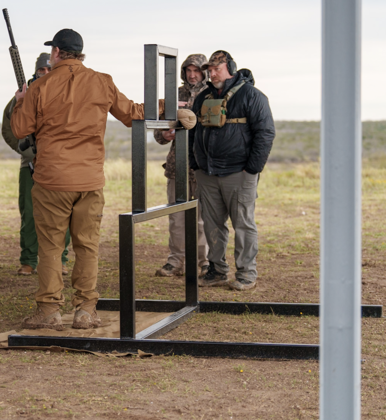

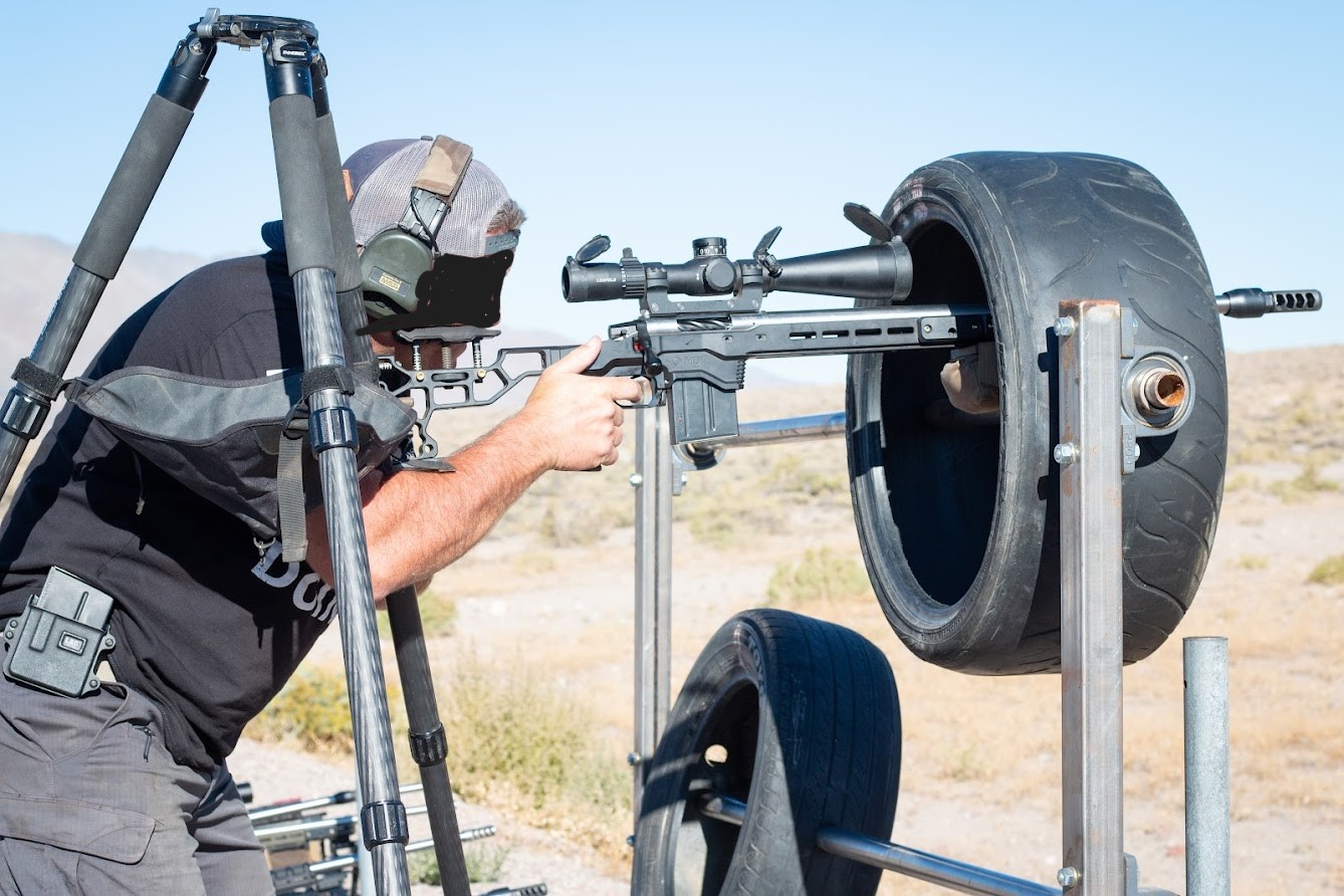

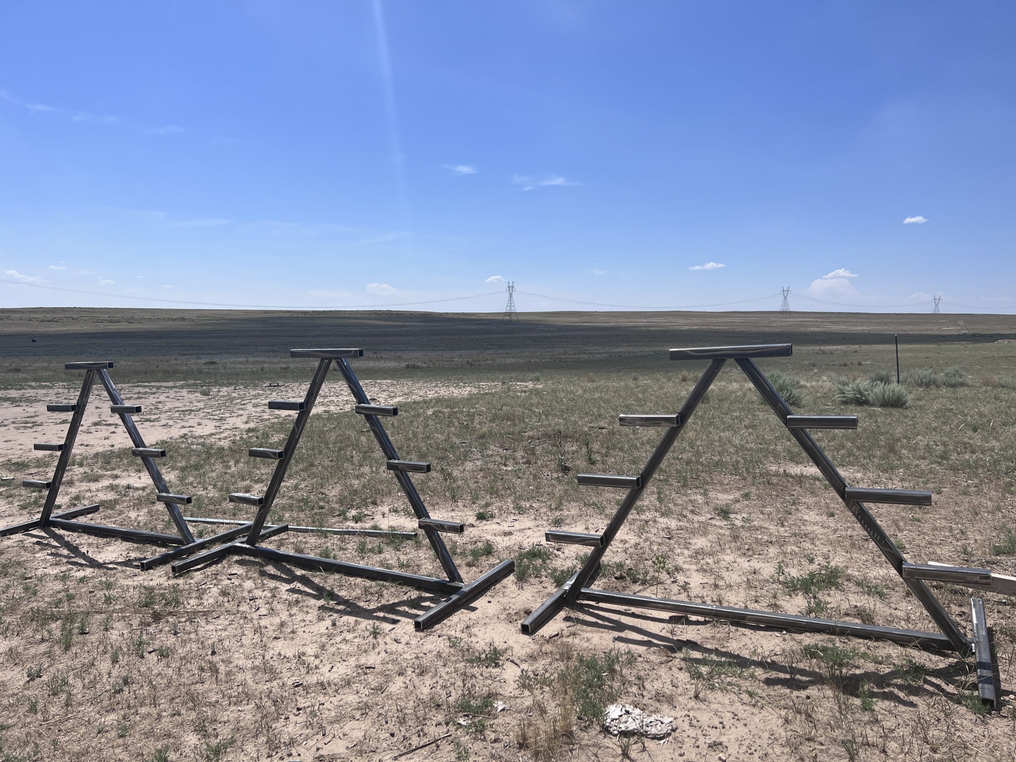

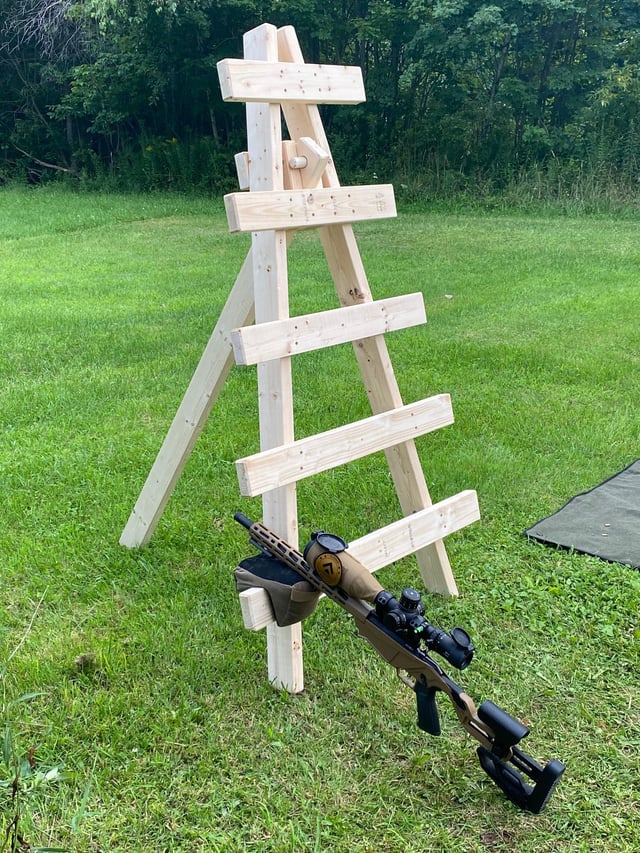

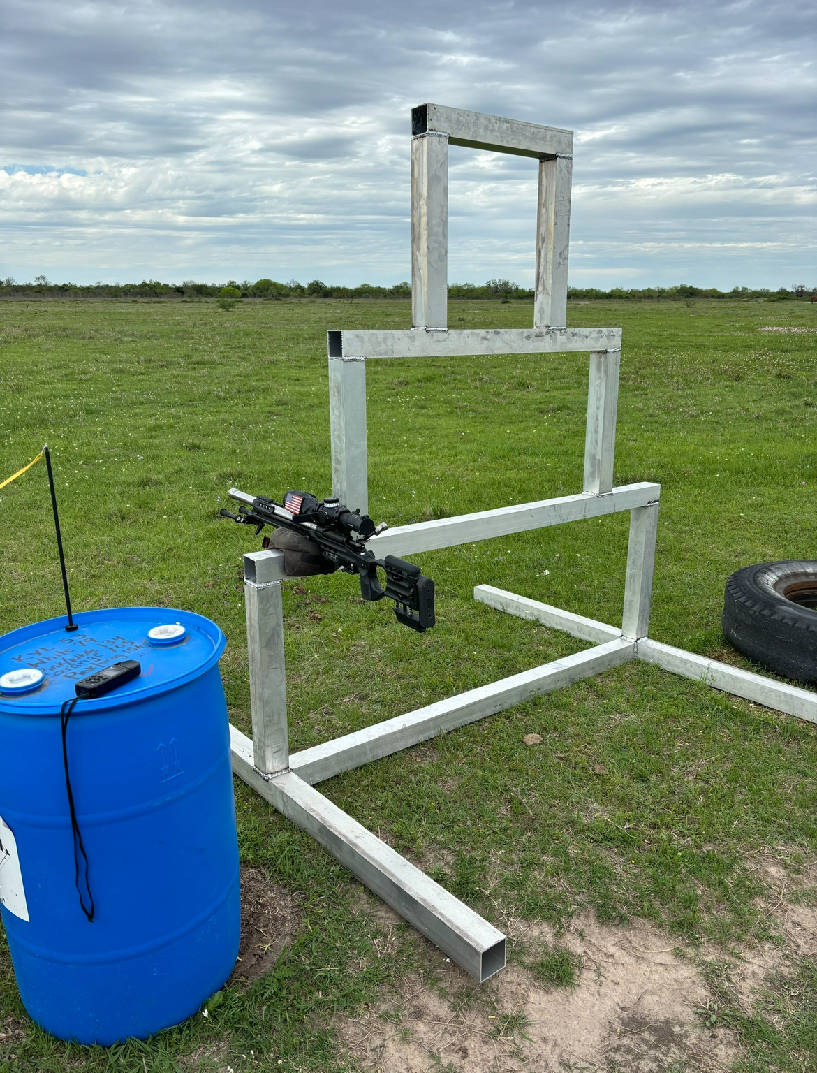

While these are not a collapsible, here are the ones we built for our classes.
The one with the ladder/cattle gate sim is the one I keep at our home range for practice. We modeled after the barricade in post #69 in this thread.
Unstable, non-welded, not concrete baracade. I approve.

LOL. These are welded and steel. So, pretty stable.
But, IMO, you don't teach or train on completely unstable shit unless specifically learning something. For the chains, I use that to teach people how to attack significantly unstable positions. As you don't attempt to balance the rifle like you do on most surfaces/obstacles. Completely different way of supporting the rifle.

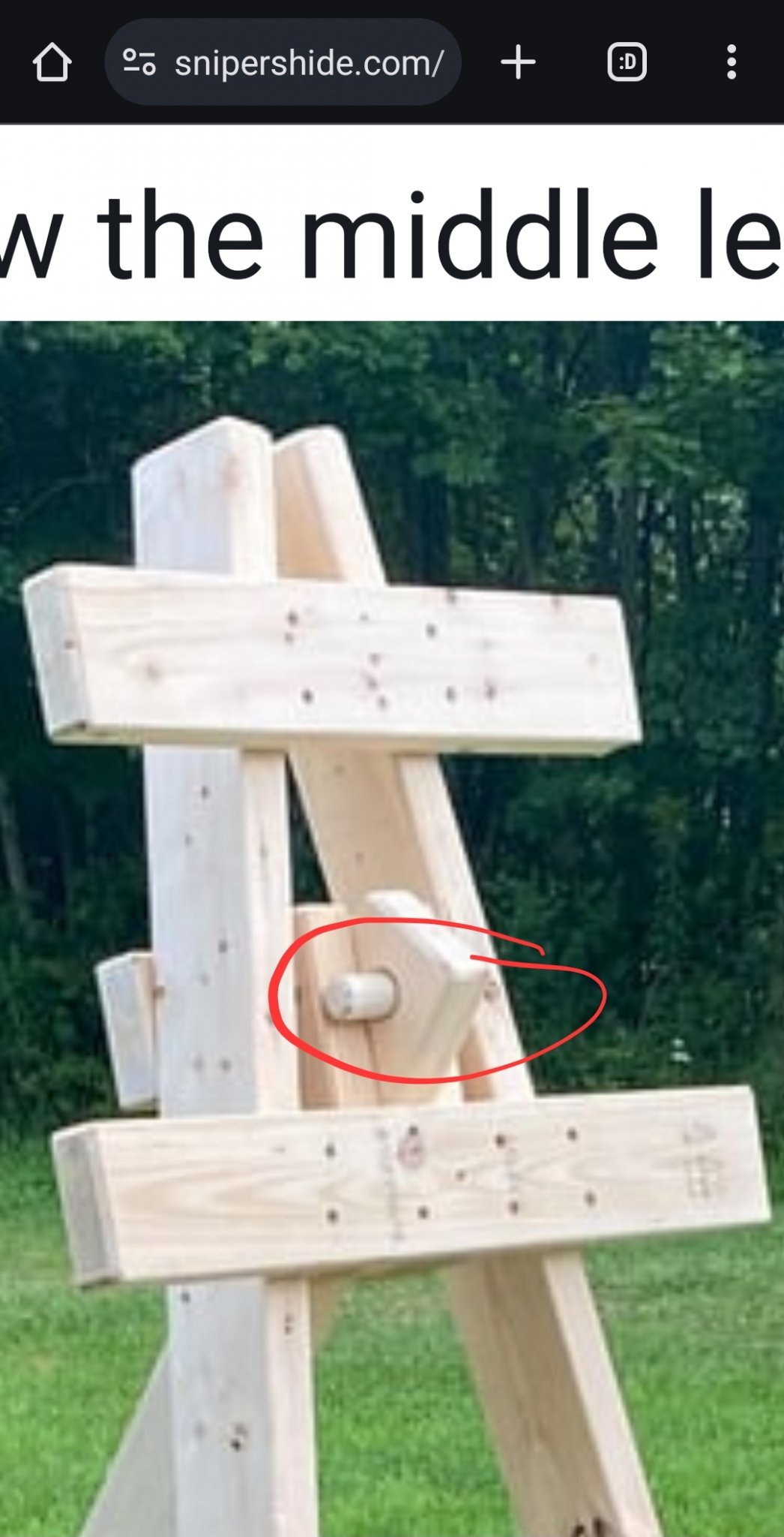

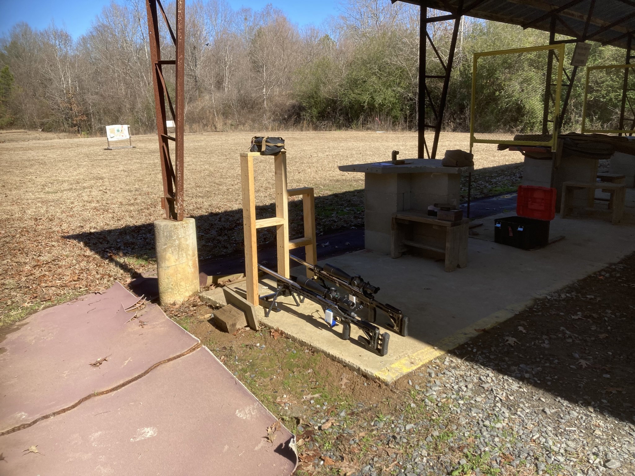

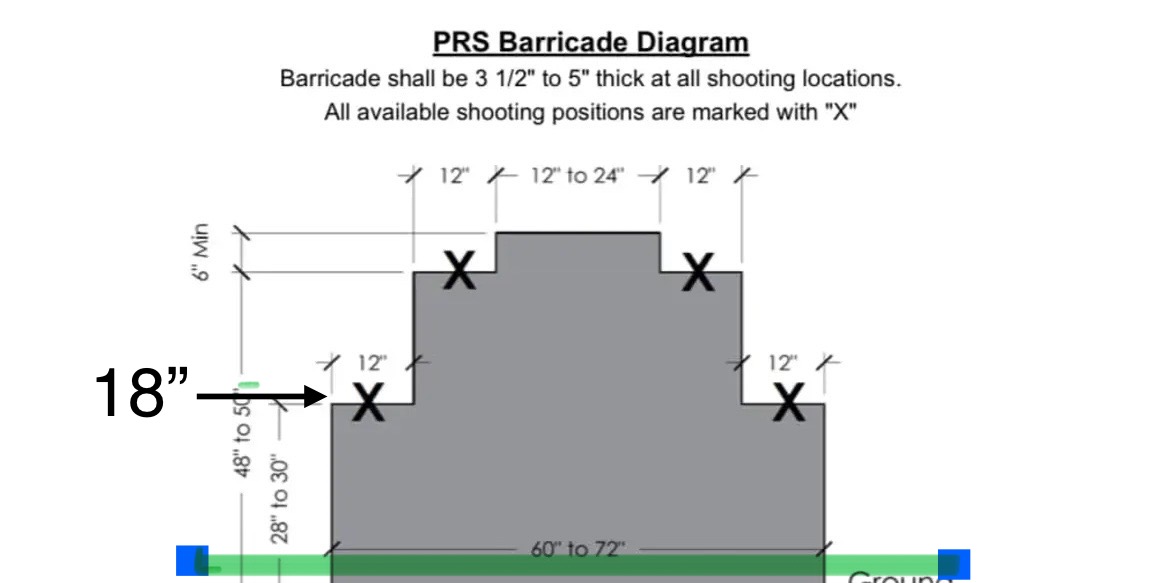

@DFOOSKING what does the back side look like? Trying to see how the middle leg is attached
I didn't make this. I just pulled images from Google.
This likely just uses this toggle to hold it in place as its slipped in through the back. That small board in the back is placed/screwed in to maintain the angle of the dangle.
Reactions: jetjock07

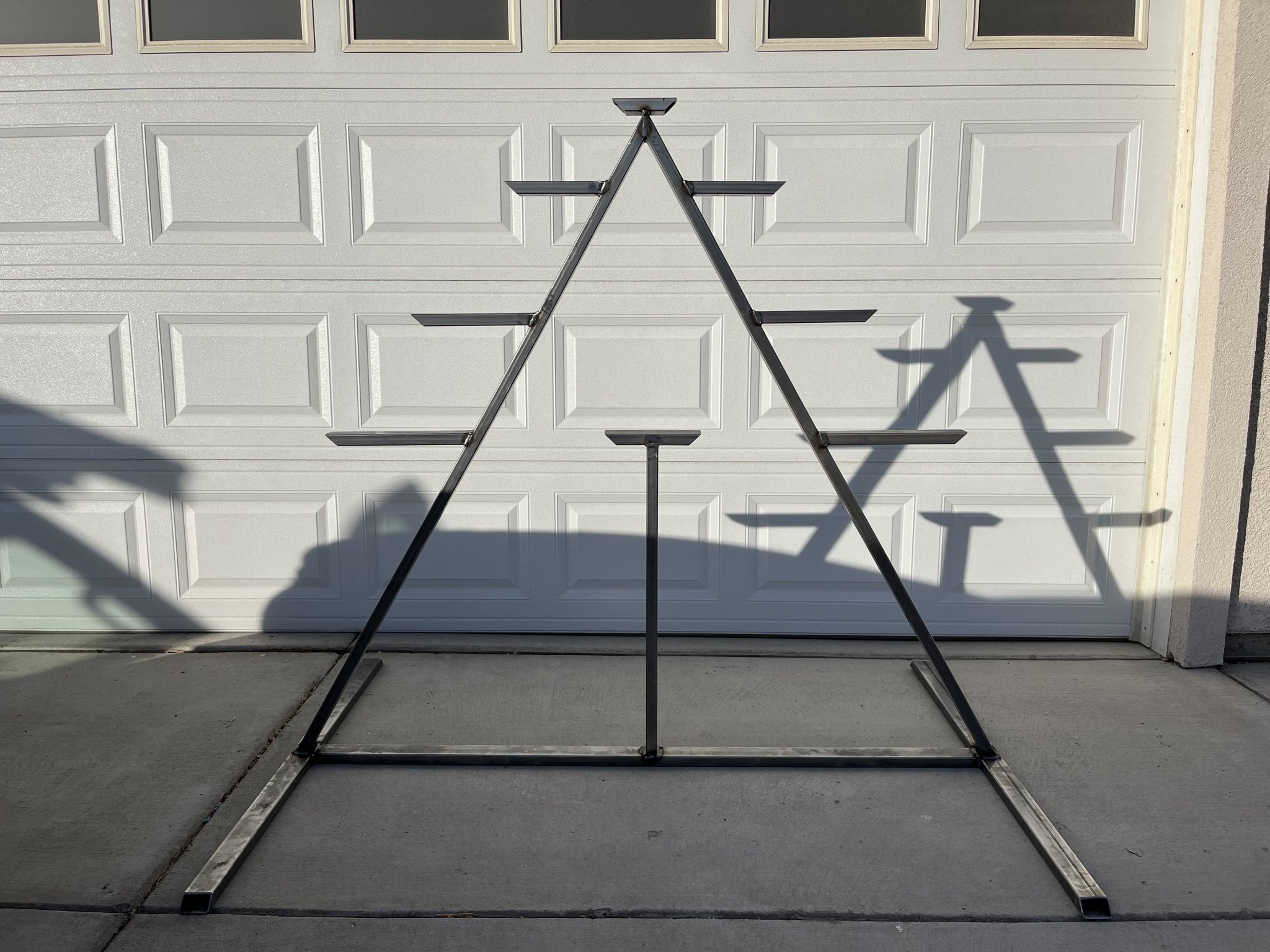

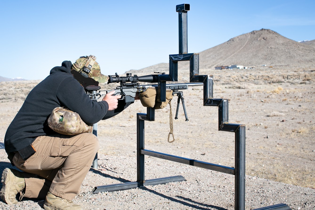

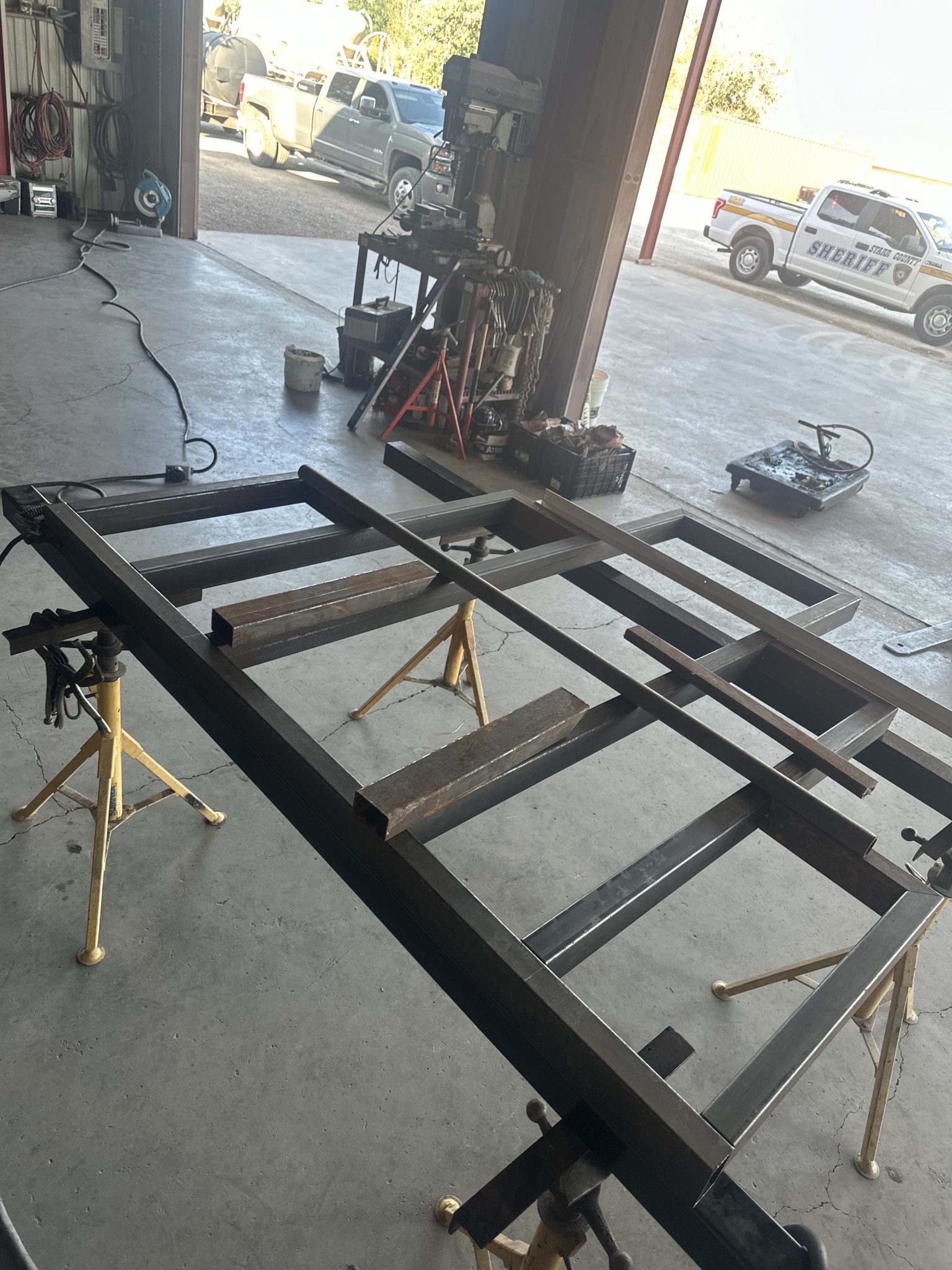

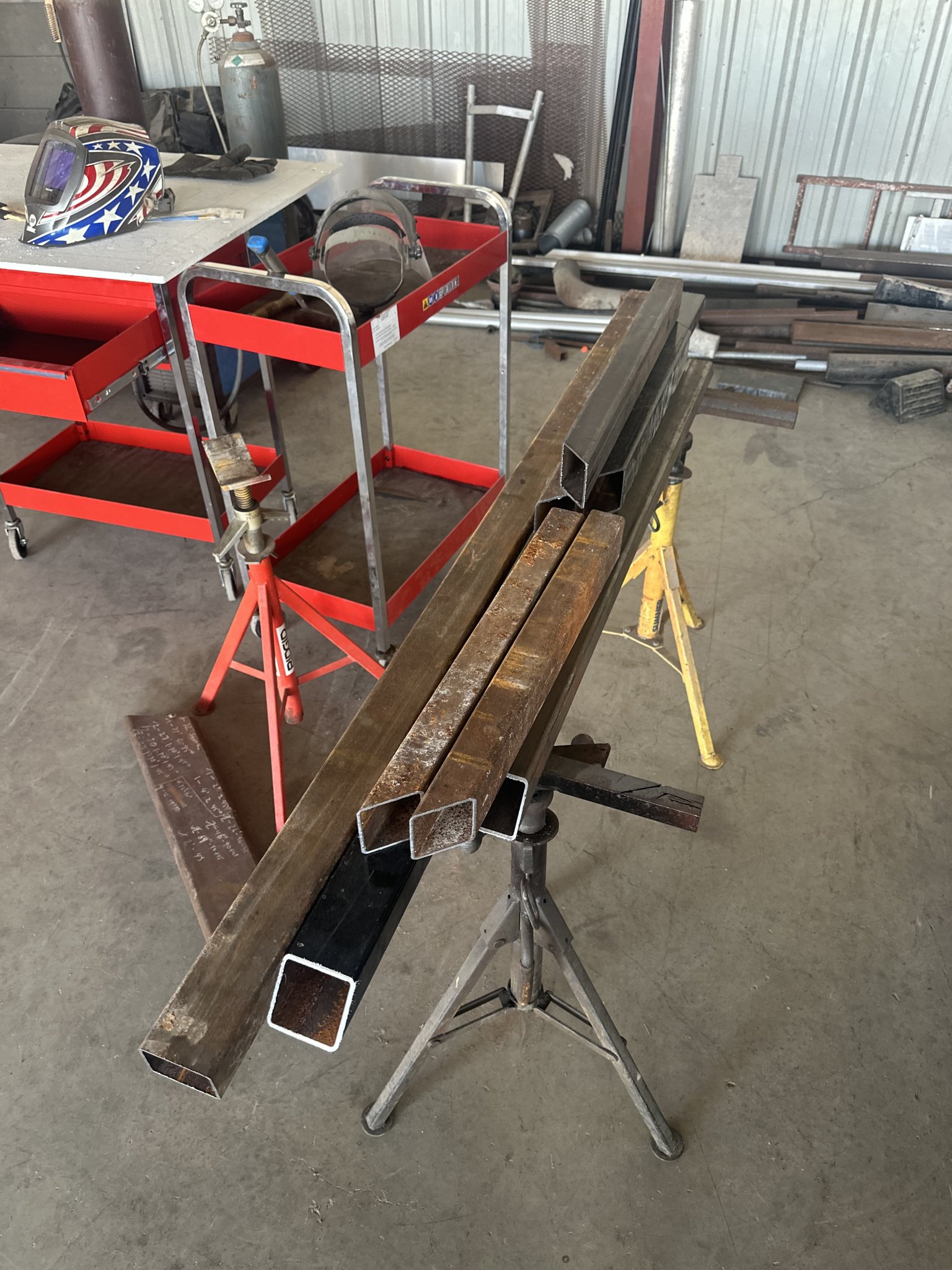

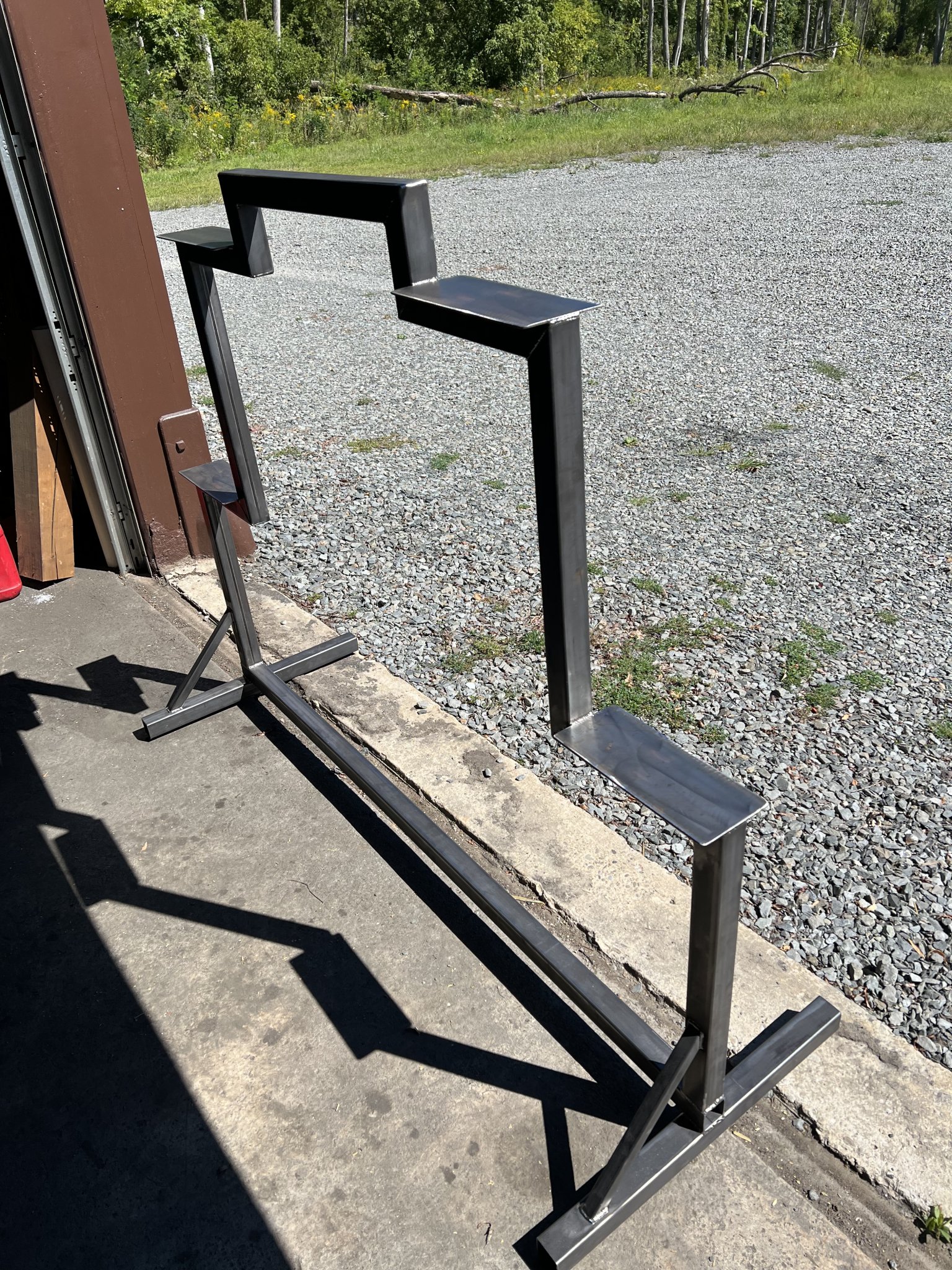

Just picked up some 4x4x.25 steel tube to start fabbing a barricade. What I can't decide is the base. I want this to be very solid and stable while also being outside on the ground. Ideally I don't want a piece of 4x4 where the shooter may kneel. Thinking of doing 2 steets of 24x36x1/8" on each end with 1ft on shooter side and 2 ft on target side and welding to bottoms. Could even drill holes and drive stakes through. Any other ideas? It's going to weigh about 400lbs all said and done.
I'd use the same 4x4 tube to run underneath as a removable base that unbolts. Extend said base 18" beyond each side of the barricade, then have 36" feet on each side. If you're worried about it rocking, drill holes in each of the feet, then stake 2 corners in opposition.
Almost like this, just with a full base & extended:
The 1/8" plate will probably be more prone to rocking on uneven surfaces since you'll get high contact points closer to the COG. I'd also expect it to bend if the barricade was ever bumped
How much clearance do you think is needed for the lower positions? 18" seems like enough to me, but I'll try and pay attention next weekend
Are you planning on putting hoist points on it
No I wasn't, we should be able to 2 man it into place. Thats actually not a bad idea though! I might weld a shackle to the top so we can move with an excavator if needed.
Reactions: R_A_W
Quick diagram of what I was trying to describe above… the blue squares are the 36” legs, with 18” offset from the side of the barricade

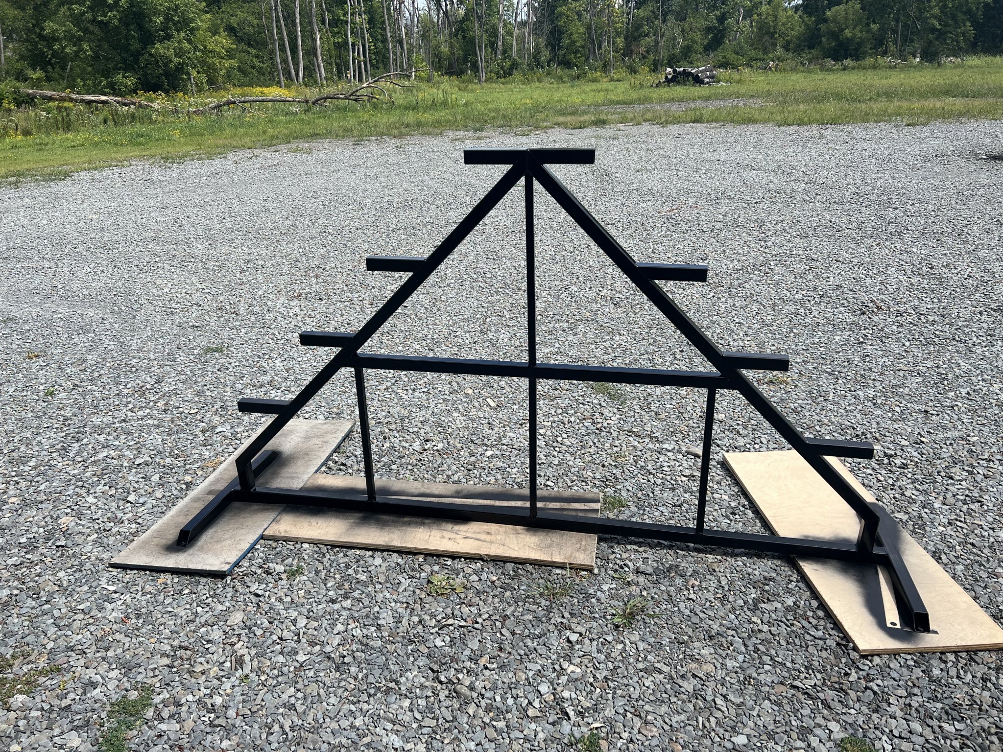

Gave the idea to my brother and he made it happen. We wanted something light that can be moved around easy but something that wouldn’t rust away or rot in salty coastal air. This is made from aluminum square tubing compliments of coastline trailers. It can be lifted by one person and put into the bed of pick up truck.
That looks great. I would get some 4 inch flat bar and cut 4x4 so you can cap the ends. Keep the animals and bugs from making the inside of your barricade a new home.

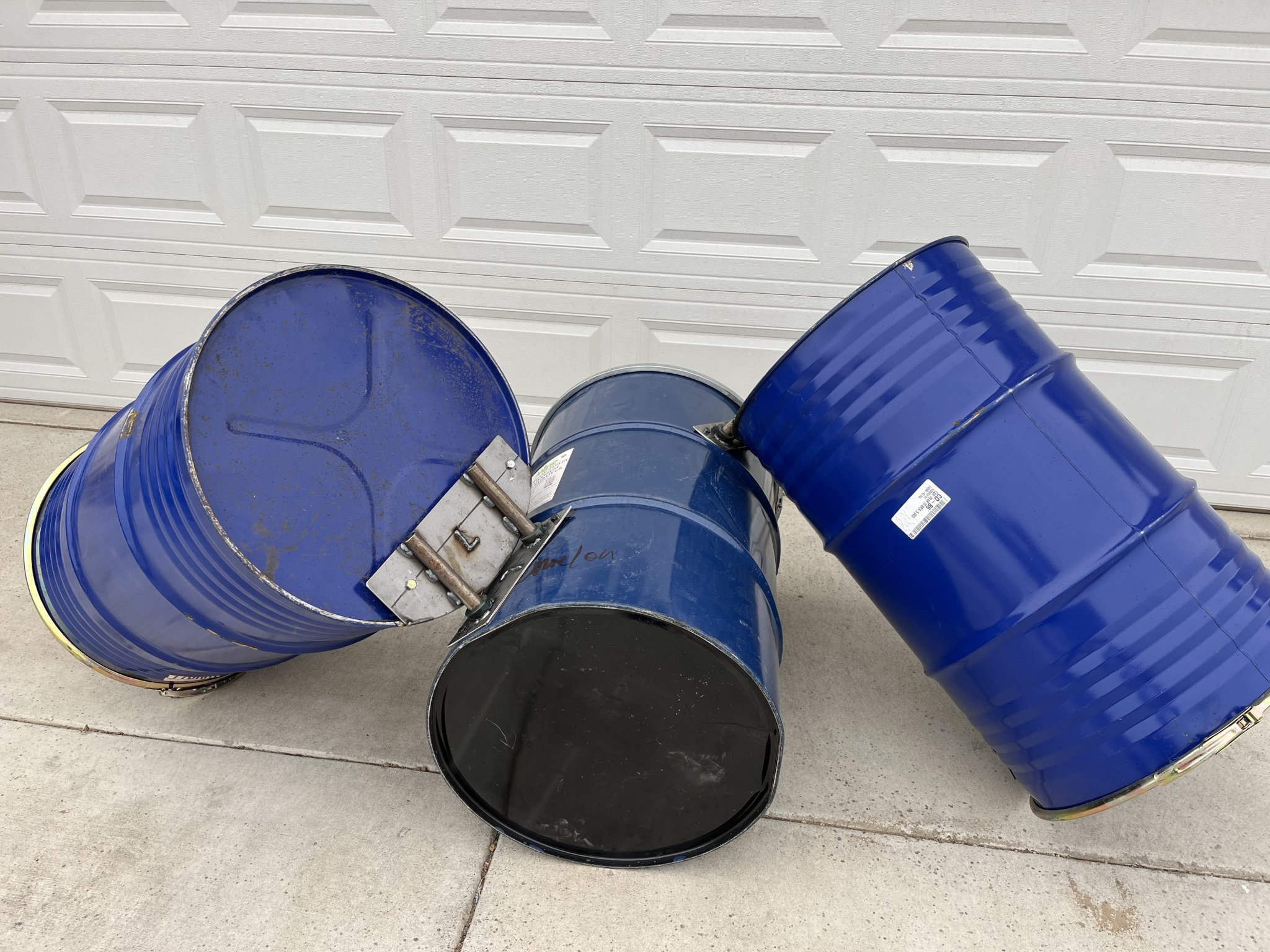

Started out with this. Using a metal target stand. Way too wobbly to be of any use
So, I rebuilt to this. Unfortunately the interior props are too small to fit a rifle with a scope. And the top is too tall for a standard sized bench. But at least it works
