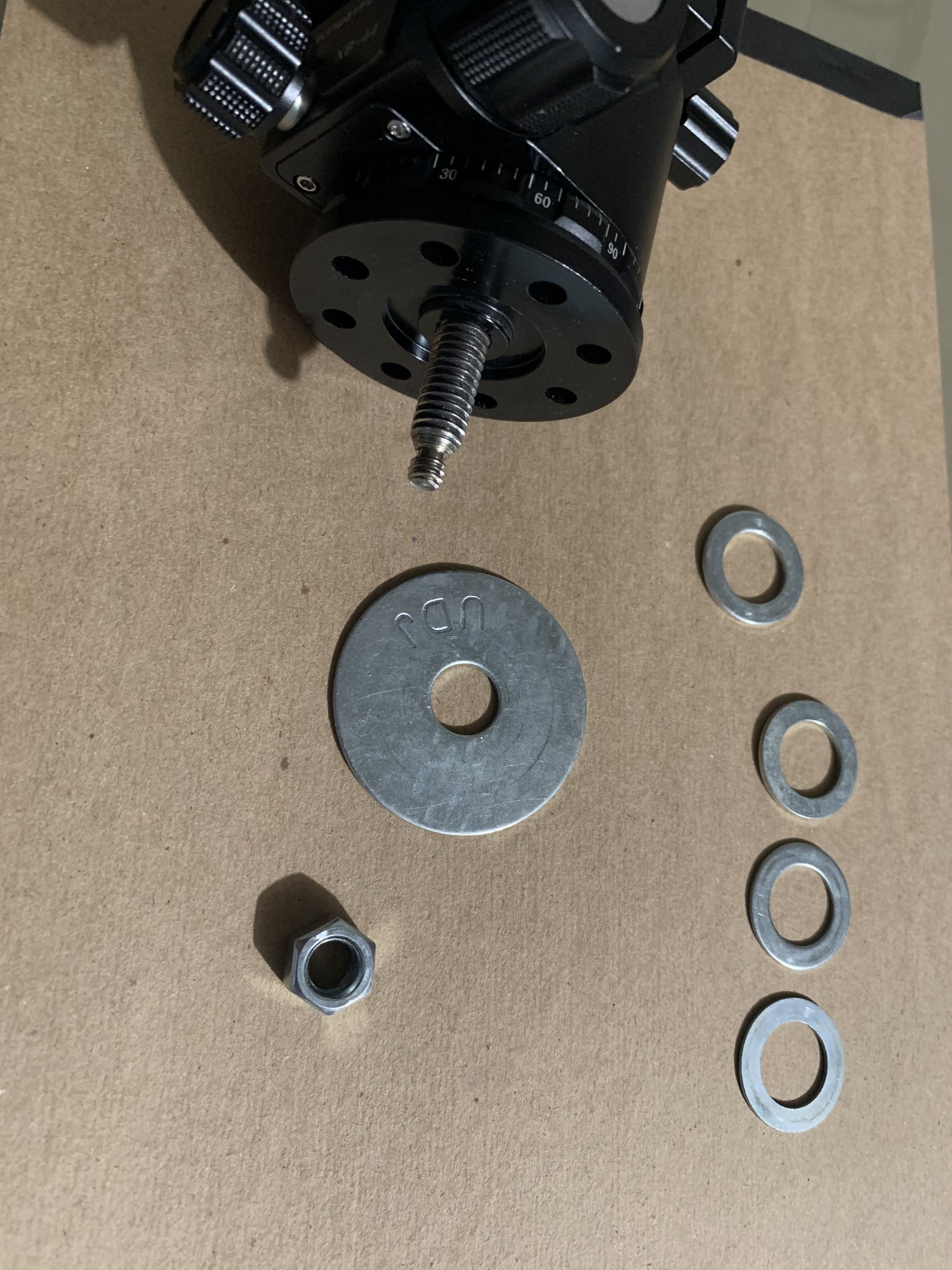

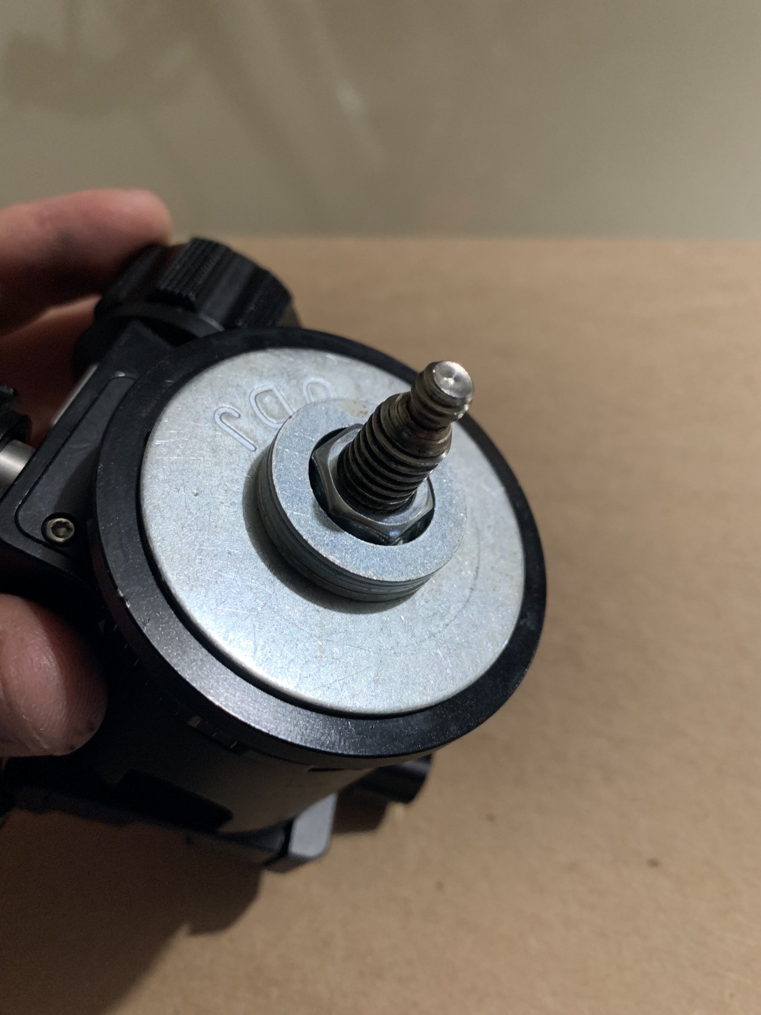

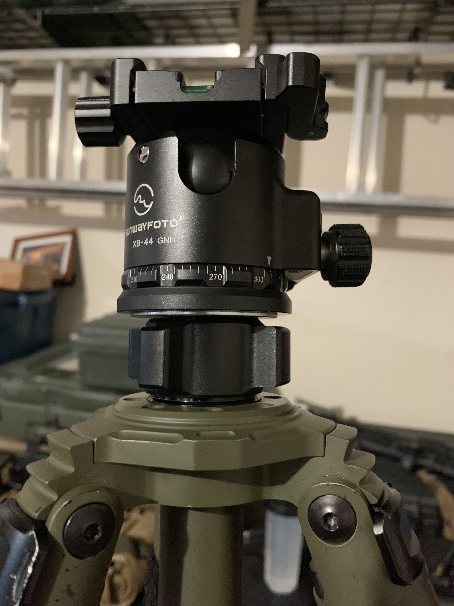

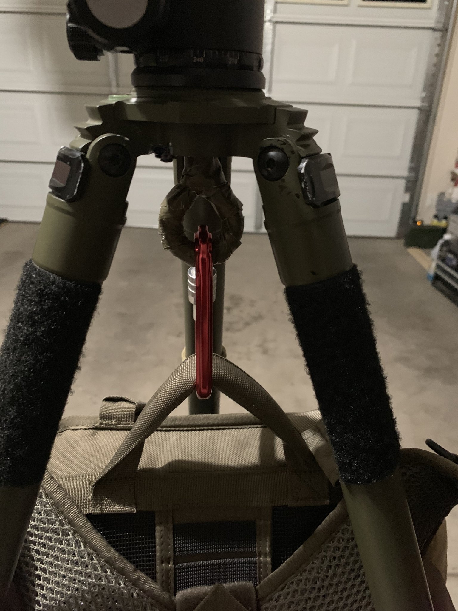

I’m running a Mission Critical Designs P.R.S.T and have always just dealt with the minor slop between the center column and the ball head base. No matter how tight everything was placed, there was some minor play.
So with one nut and 5 washers, I was able to take the slop out. Figured I’d share some pics for others who may have the same issue.
This may have been my OCD acting up, but I want as little play as possible in my setup. I suck enough and don’t need any extra help with missing the targets lol.
Update:

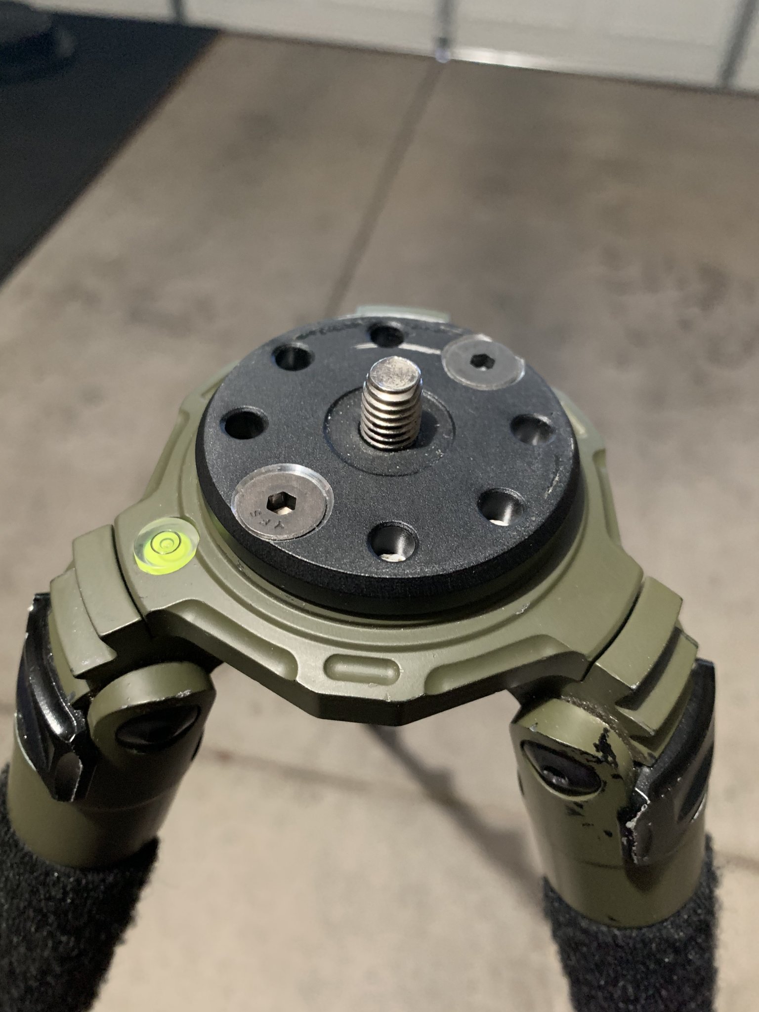

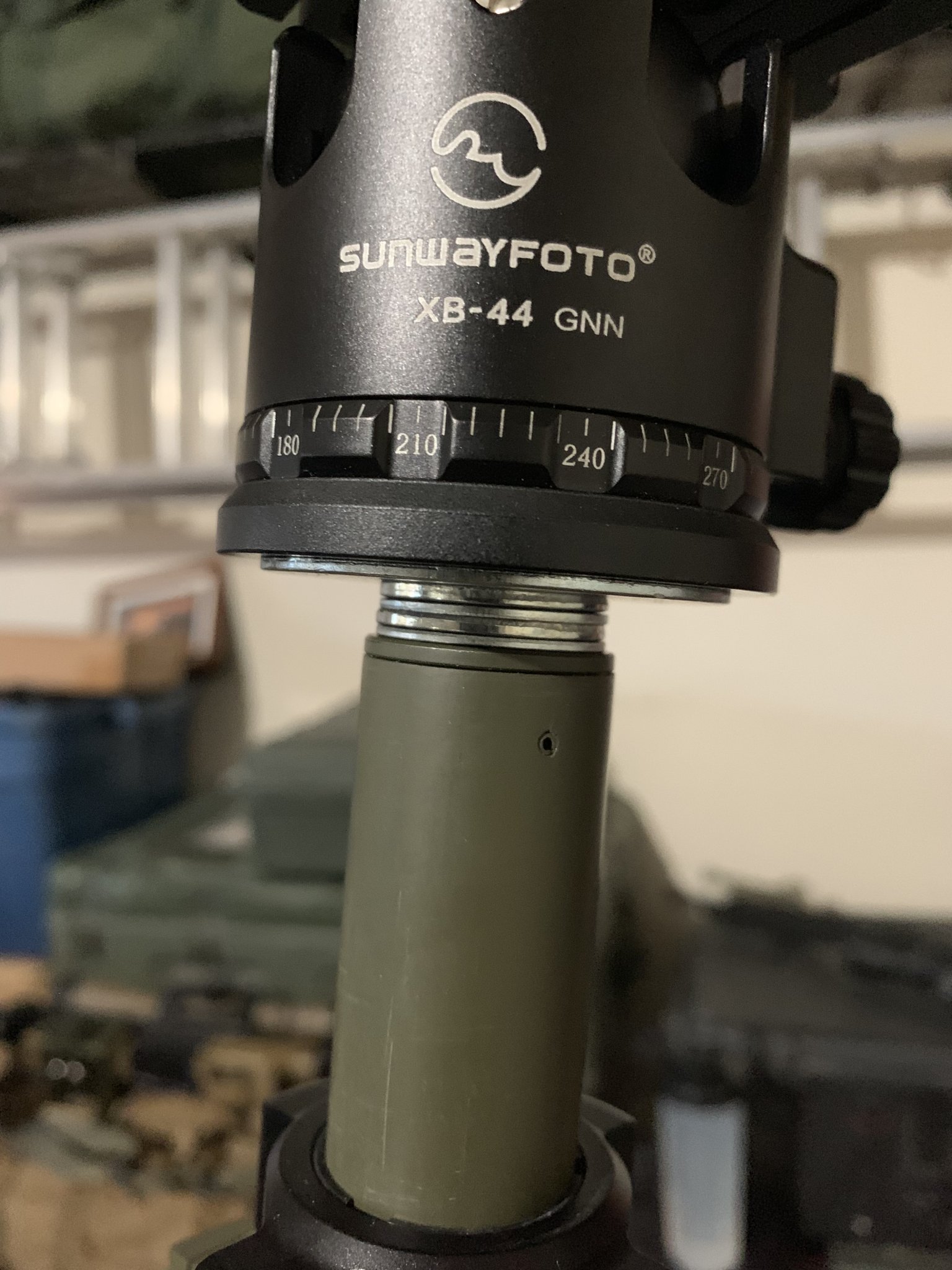

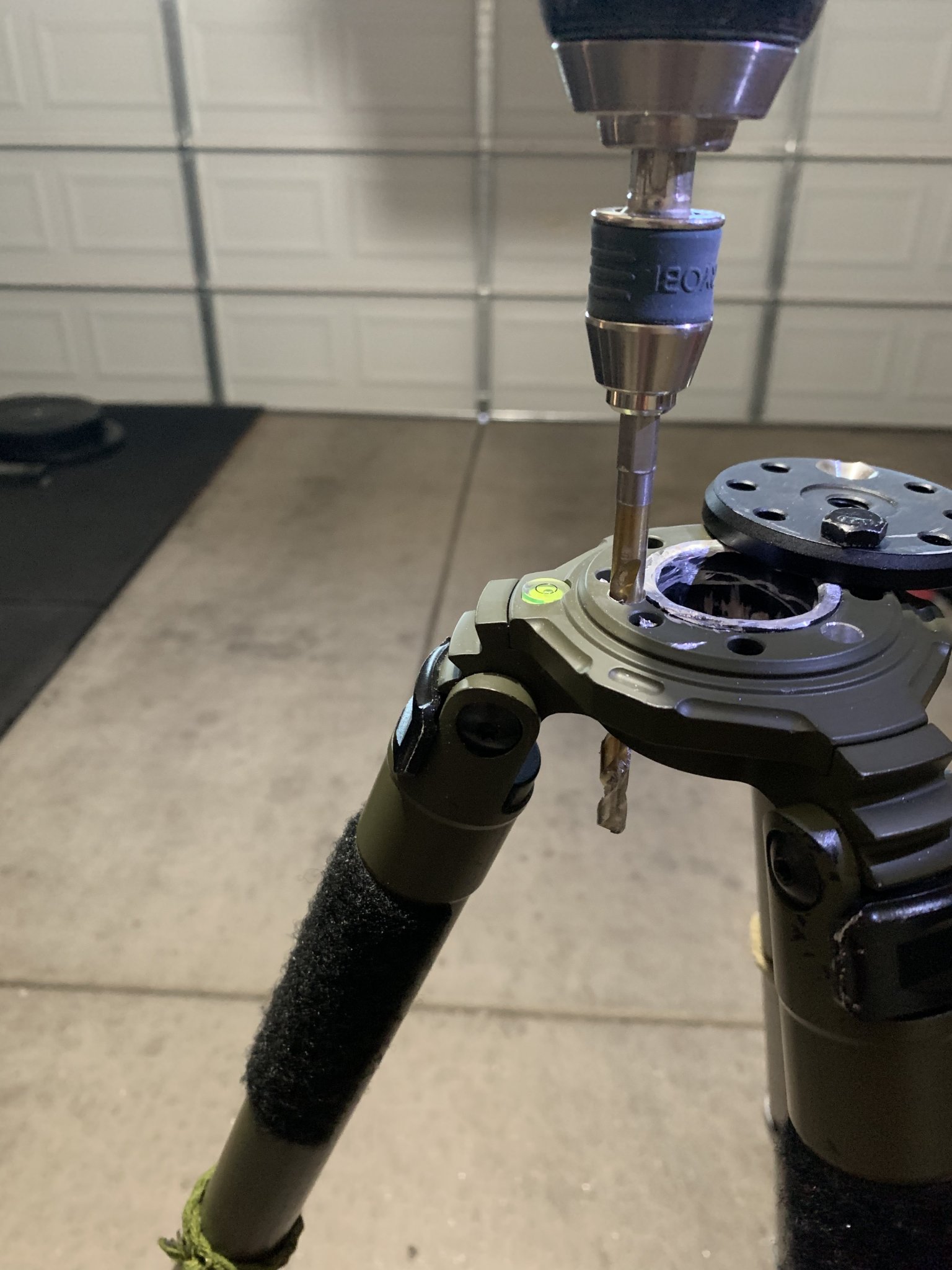

Ok so said fuck it and removed the center column completely and replaced it with an eye bolt. This allows for me to just pop a carabiner on there and snap the pack’s handle quickly, instead of that little low-pro hook. I didn’t take many pictures when doing it but if anyone is interested, I’ll go take it apart and send ya pictures.
