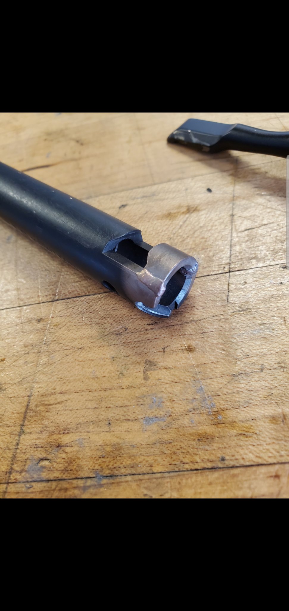

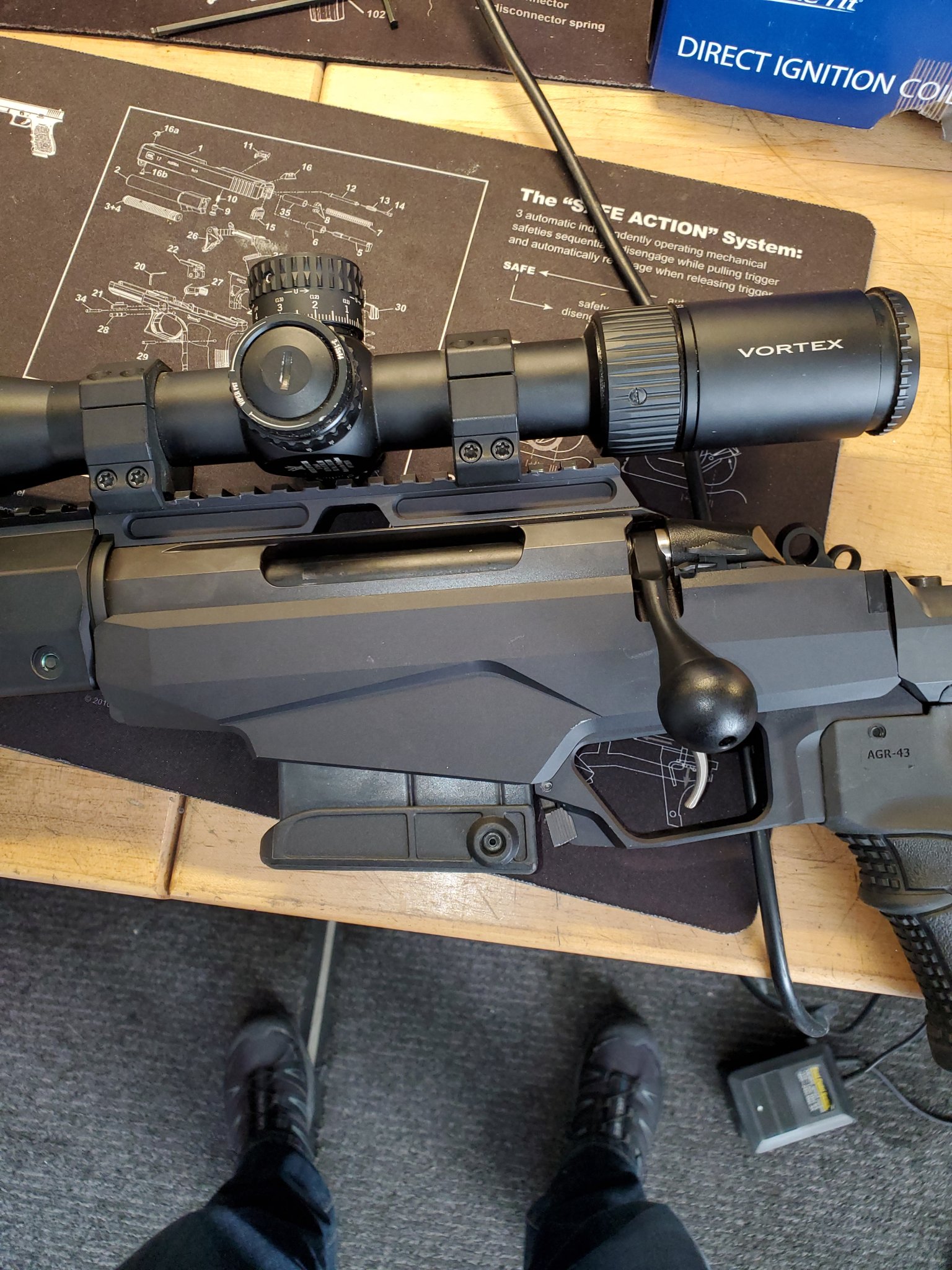

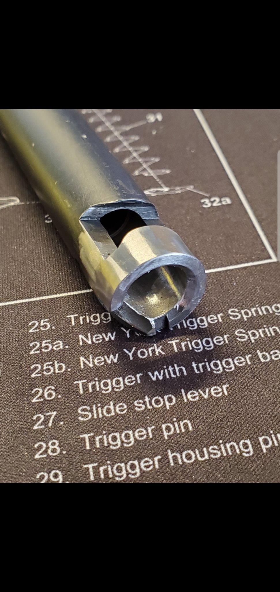

PSA: Don't let your bolt gun fall with the bolt open while cleaning it. **UPDATE: FIXED**

"tactical offering" is a reach at best. It's a $800 T3X in a chassis. These are isolated incidents, not anywhere close to the norm. Out of curiosity, what were you doing when you man handled it open?

The description is in the thread above, but basically stuck dummy cartridge touching lands
I meant what were you doing when it broke. Were you hitting it with your hand or using some encouragement?

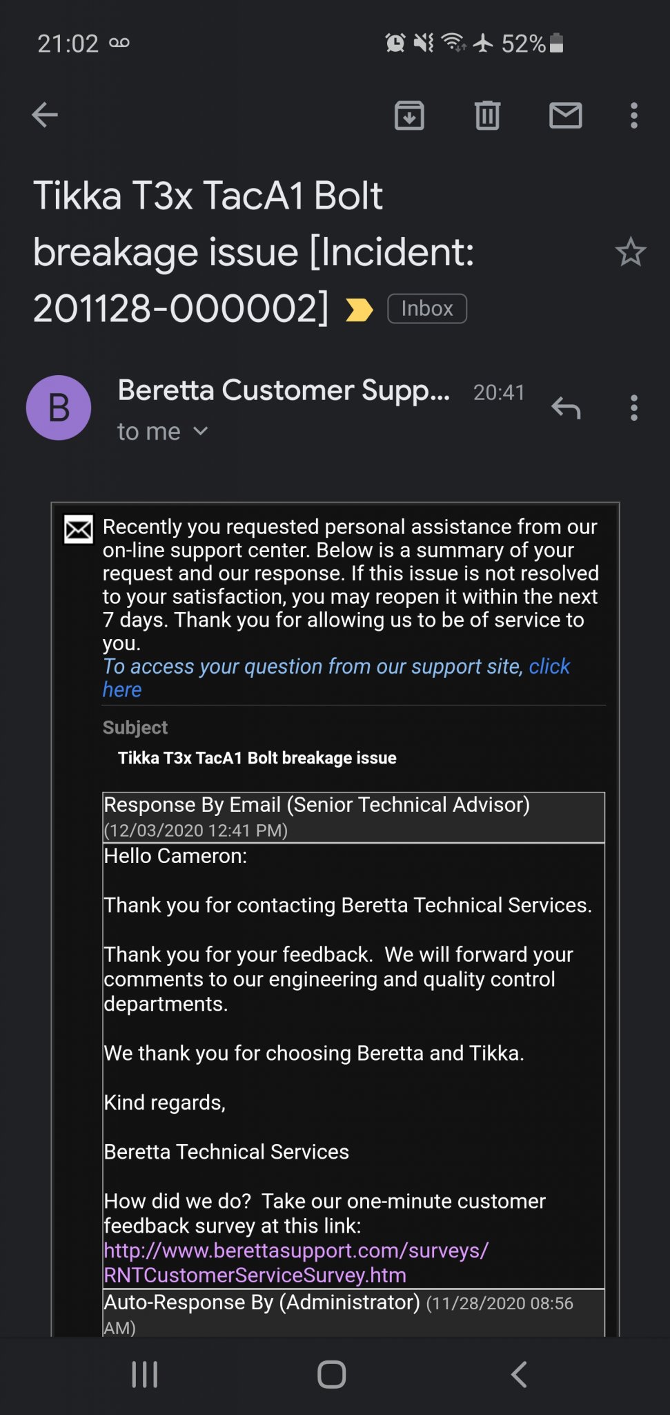

Update: Mitchell from Gunsmithing LTD (Beretta Authorized Service Center) got back to me this weekend, shipping the rifle to them tomorrow, will keep people updated on progress.

UPDATE: Gunsmithing LTD came back and stated that Tikka bolts are on national back order (hmm...... :unsure:) and will be about a month before they get a new bolt in.

Gents, I had no issue with accuracy, it was amazing (especially coming off from Rem 700), was getting 1/3 MOA consistently, but was certainly not expecting this shit.
As far as what is stuck (several people PMed me concerned...)

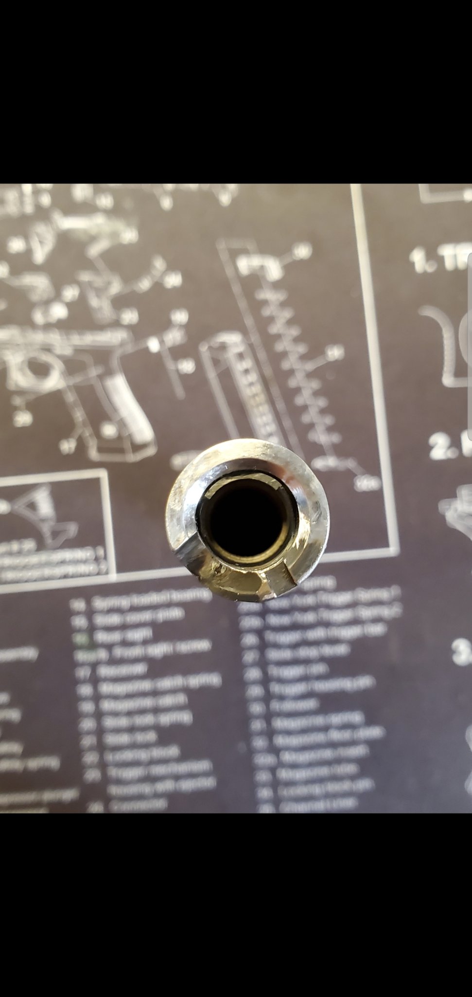

It's a sized, unprimed case, with a bullet just started in the case mouth, was trying to determine OAL to lands (and yes, I'm aware that hornady has a tool to do this, and I own it, but I don't have a special 6.5 cartridge for it)

That's an expensive mistake. You can order a new bolt. There is no fixing that without botching the dovetail. I think a new bolt is like 275.00 or something crazy like that. I have a T3x also, and love it. I wouldn't deal with Berretta for the warranty though. This is not a warranty repair, so just buy a new bolt.

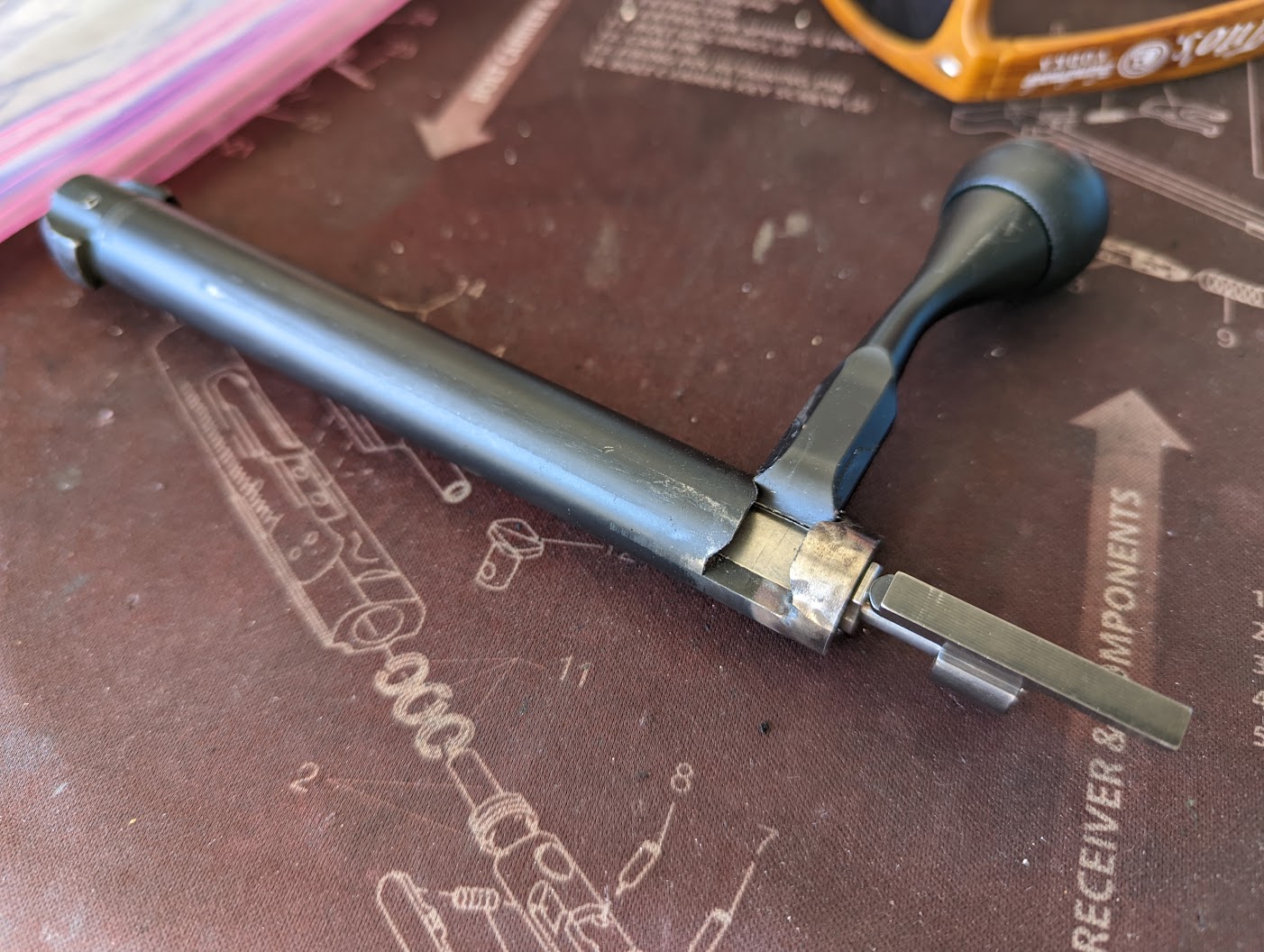

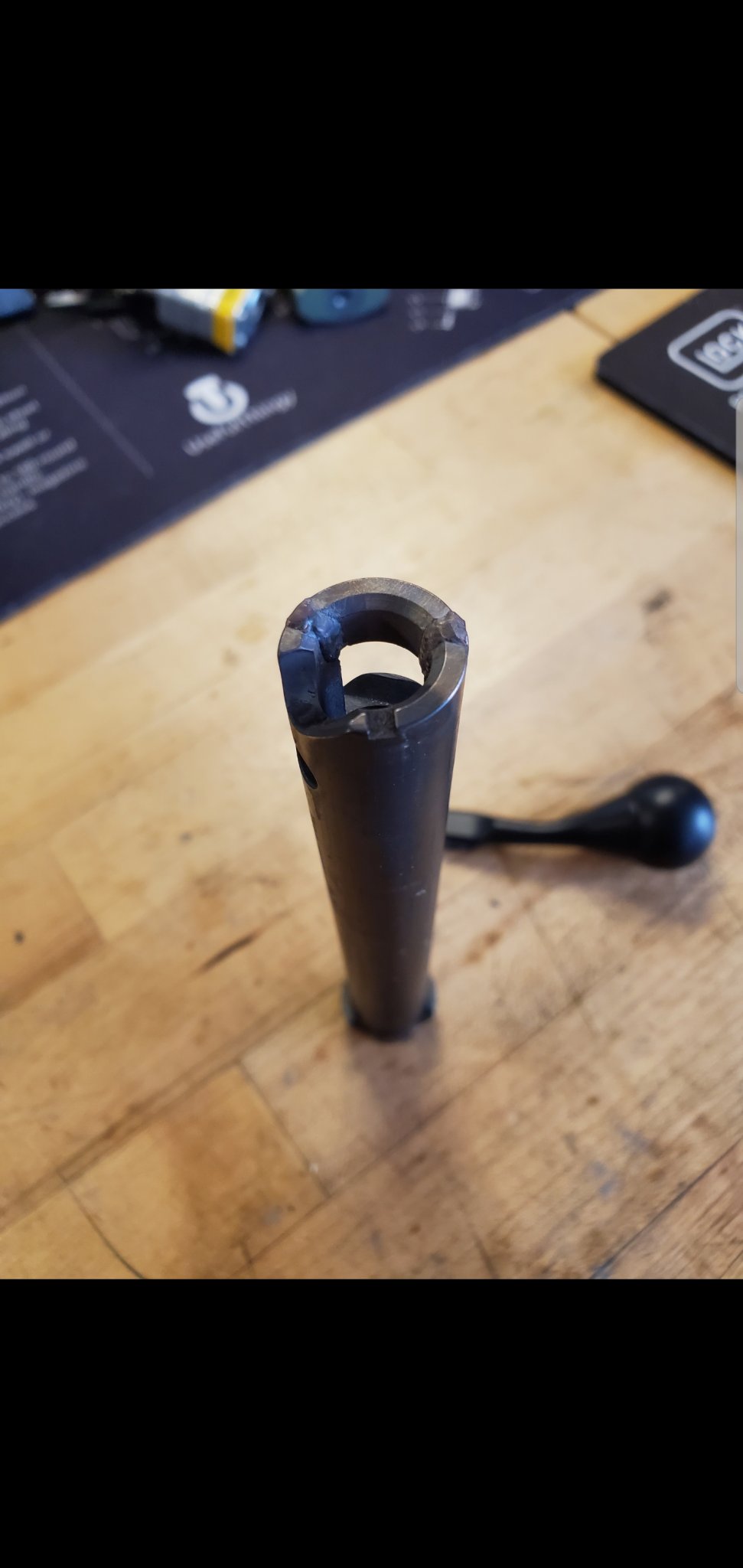

Well add me to the list of people who have had this happen. Not sure what happened...if someone knocked it over or the wind was heavy but the gun ended up the ground from the shooting bench. The range requires us to have the actions open so derp.
Curious how the tig welded bolt has worked for clcustom1911, Also what type of material did they tig weld it with? My local place quoted me $80-100 to tig weld it. Not sure if I should go that route or just buy the LRI replacement.

I had the weld done, however it held for only about 50 rounds. I bought LRI bolt after and sold the gun.

I researched what the bolt was made of and they used that metal. 416 stainless? I believe. It's worked perfectly since.
I'm a lefty. So I had no choice but to weld. Lefty replacement bolts aren't a thing from anywhere.

Thanks for the context. I put a magnet against mine and it ended up sticking so not sure it's stainless though LRI did tell me they were stainless.
Ok just looked up 416 stainless so it is probably that! For me it's mainly cost because the replacement bolts are like $400 now o_O
Welp, in case this happens to anyone else. Tig welding does not always seem to work, or maybe the guy I took it to messed up, or maybe it got damaged in the drop, but either way the bolt handle no longer slides into the dovetail. Looks like the geometry of everything to warped or slightly off angle.
Callin it a loss at this point and just buying a bolt from LRI

You can still get weld distortion tig welding. I would think it was more the welder and less the fact it was a tig welded.

You can just shape it with a small file, make sure to keep geometry correct (Use front edge as a guide), it is common with welds to be just a bit off (very common if you are doing exotic historical weapon work from parts kits).
My problem was that the weld did not hold, but some file work was still needed to get everything to fit 100%.

After the TIGing, I had to use a hand grinder to clear the center passage, and used different shaped needle files in the slot where the bolt slides into.

I did :) would not buy another Tikka, but the process of cleaning up the welds is the same. Below is the picture of my rewelded and cleaned up bolt.
