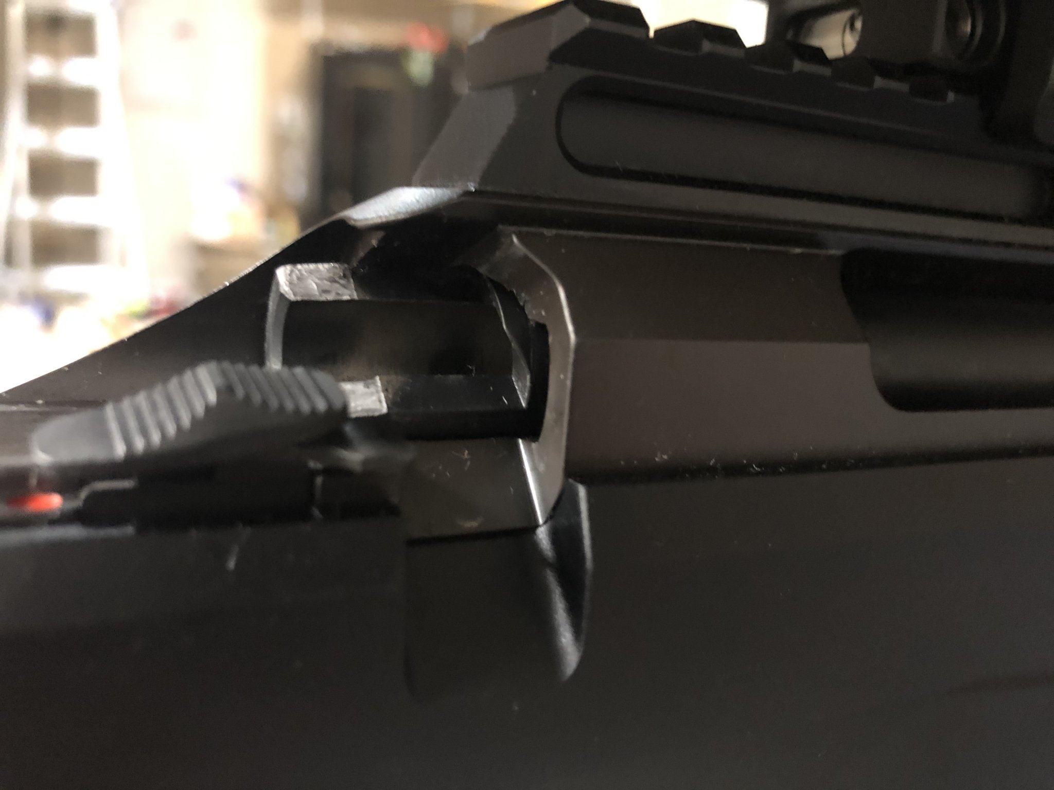

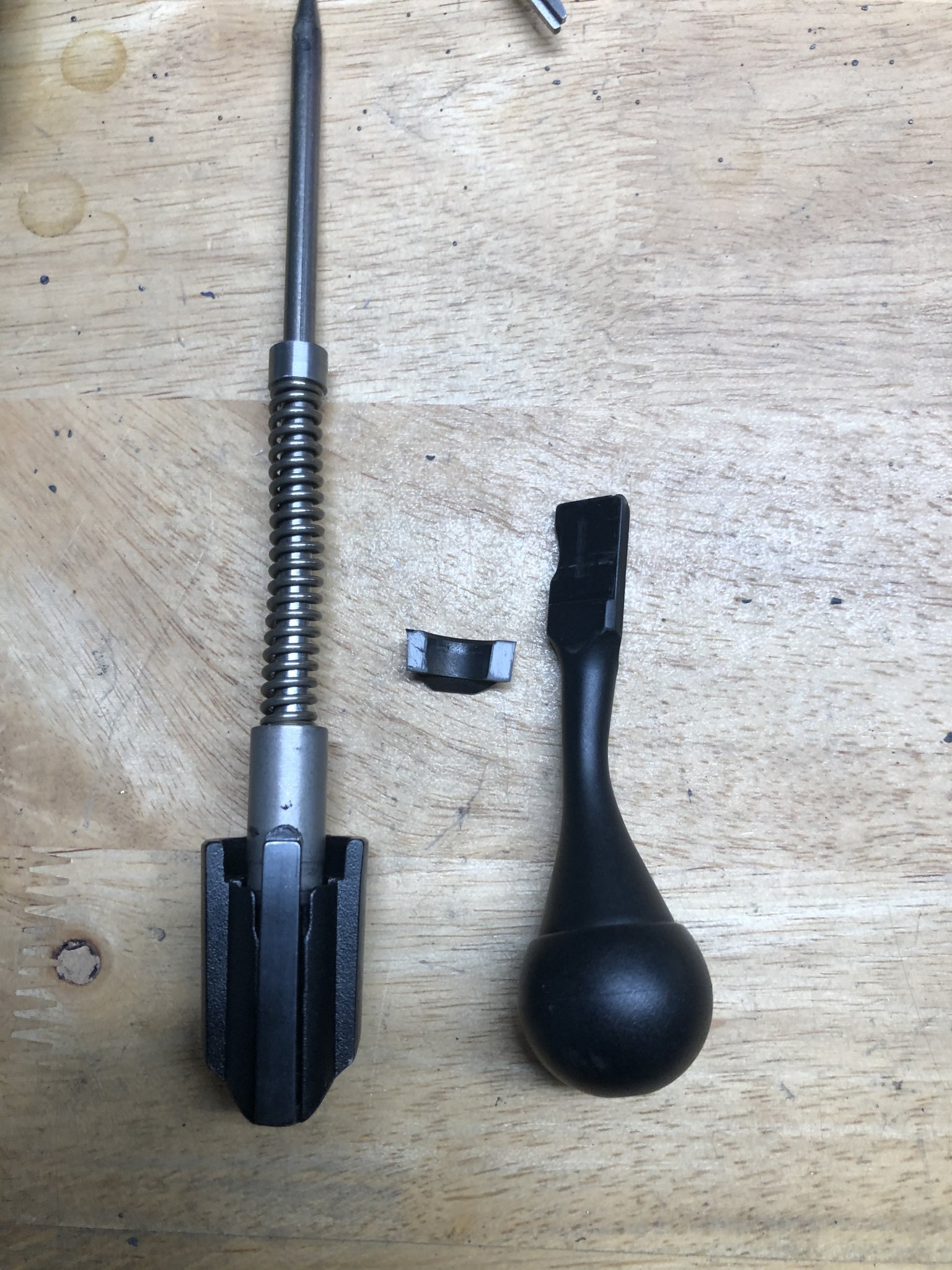

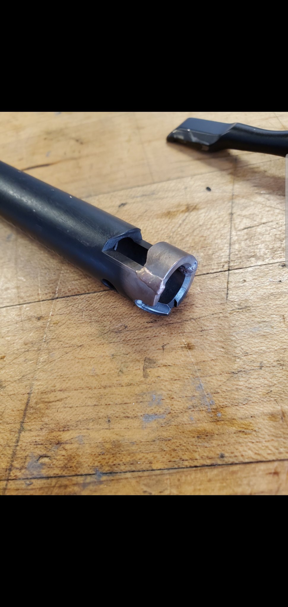

PSA: Don't let your bolt gun fall with the bolt open while cleaning it. **UPDATE: FIXED**

Wow. This appears to be a violation of one cardinal rule of user-friendly product design, which is "try really hard to ensure that the cheapest and/or easiest-to-replace part fails first".
Hopefully the manufacturer gets you back up and running ASAP.
That is an excellent point I am sad I didn't think of myself. The bolt handle should absolutely shear away (etc) before the bolt itself breaks.

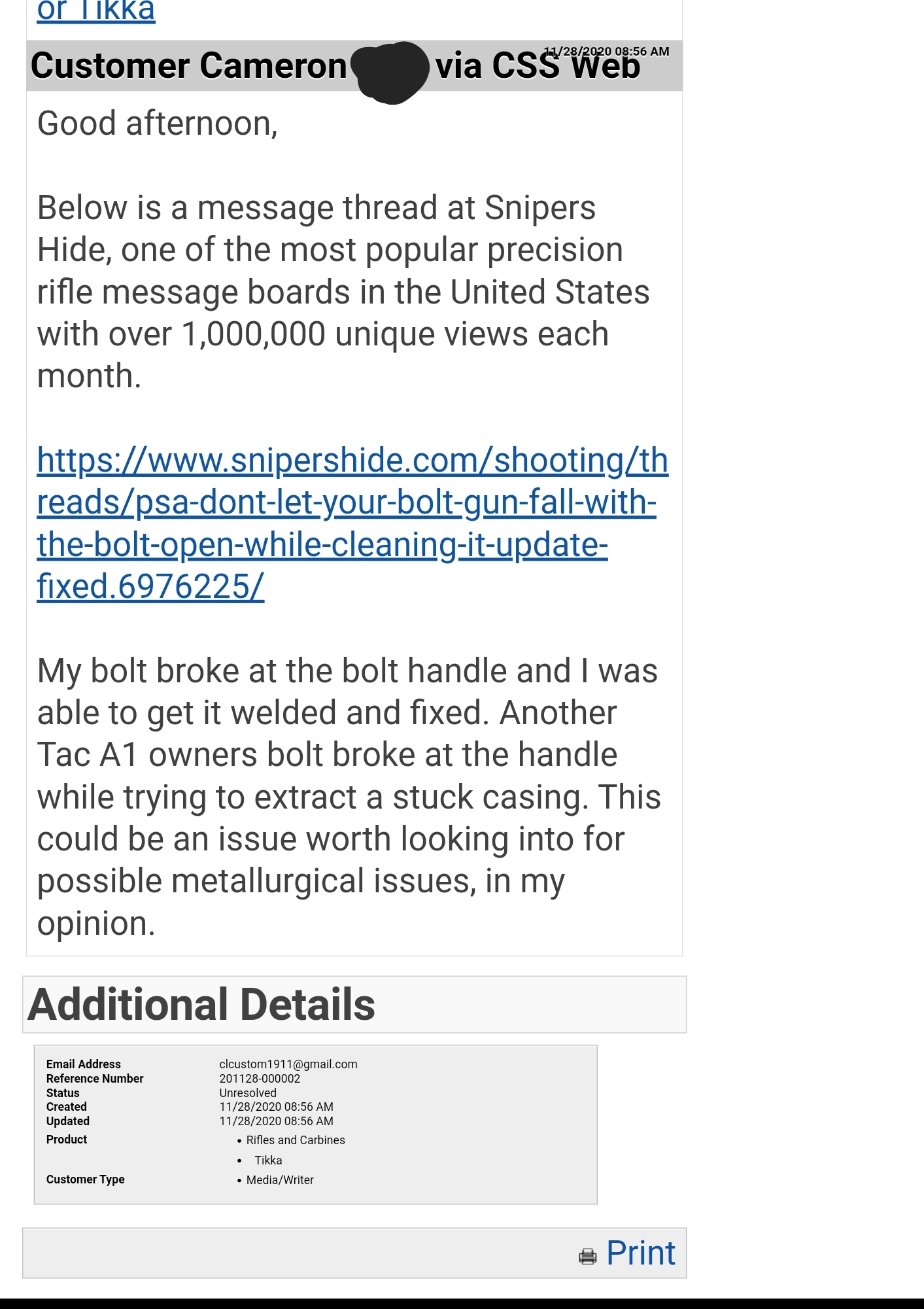

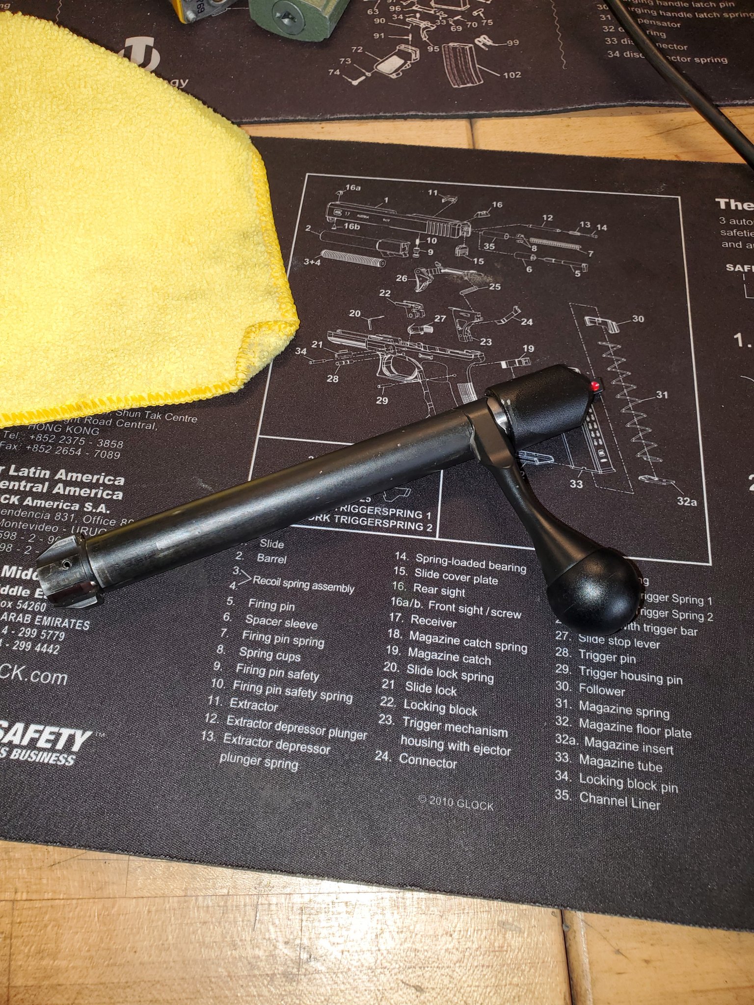

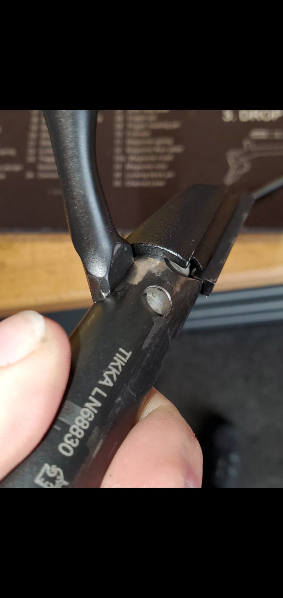

$60 for the micro TIG work. Dropped off yesterday at 3pm, ready this morning at 8am.
Scope functional as normal. Turrets, doodads, illumination works, etc. Haven't shot it to see if there was a zero shift.

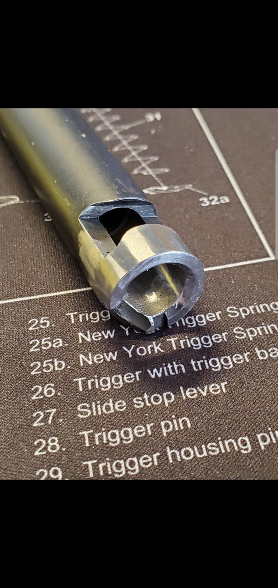

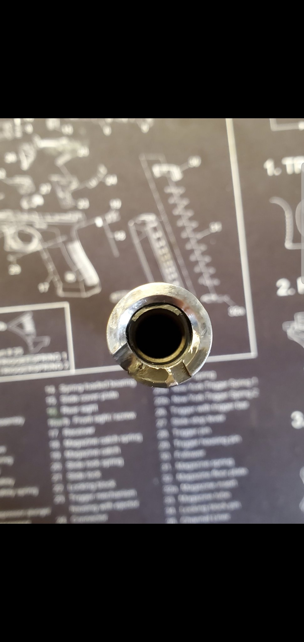

The bolt would be supported by the receiver if it were either in the locked position or at least in the forward position. In other words if the bolt were closed I doubt any serious damage would have been sustained.

looks like cheap Chinese pot metal breaking to me but I guess allowing your guns to fall isn't a good idea piking them up and dropping a gun is a terrible thing to do followed closely by picking up a newborn baby and dropping them while they may bounce its bound to cause problems They are not basketballs lol

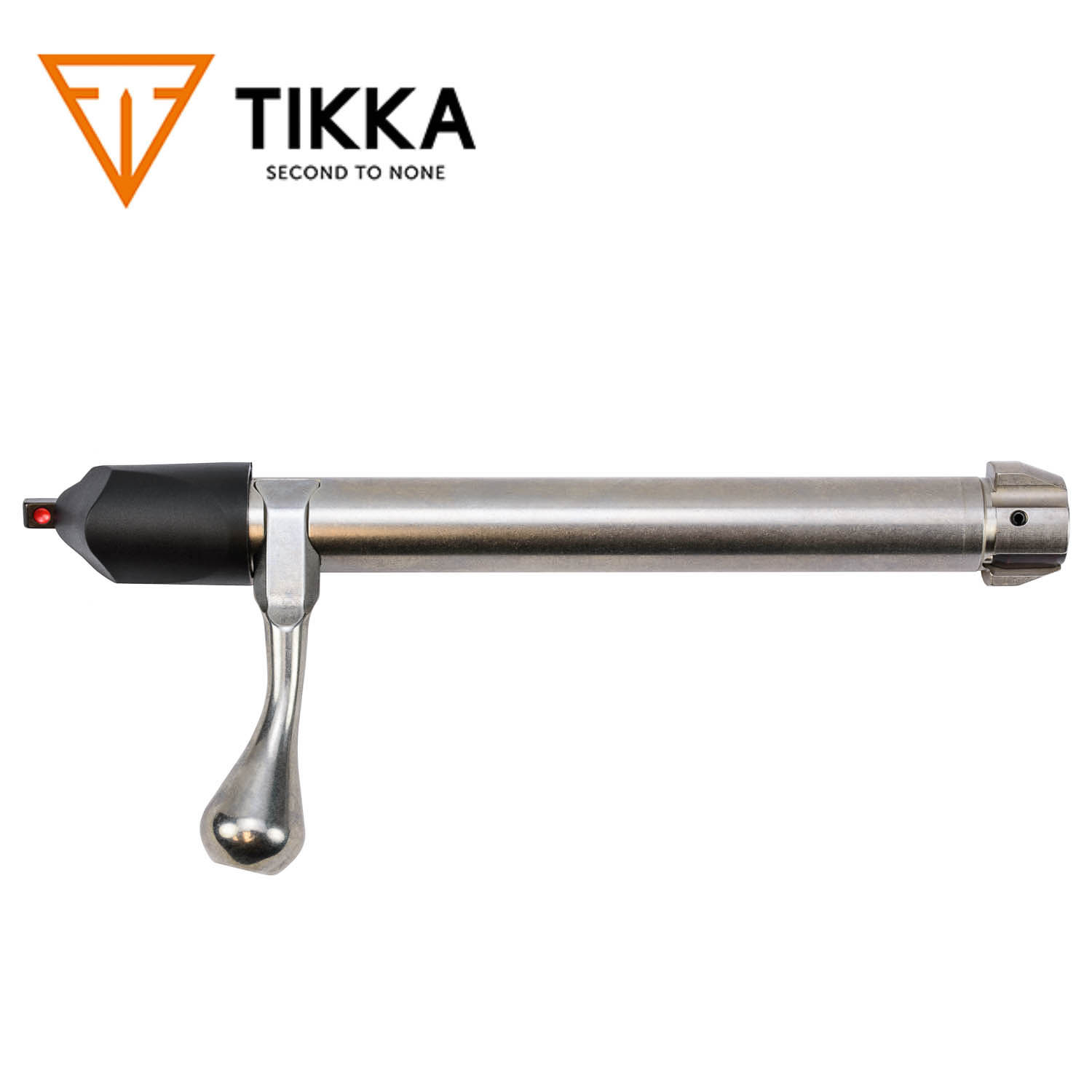

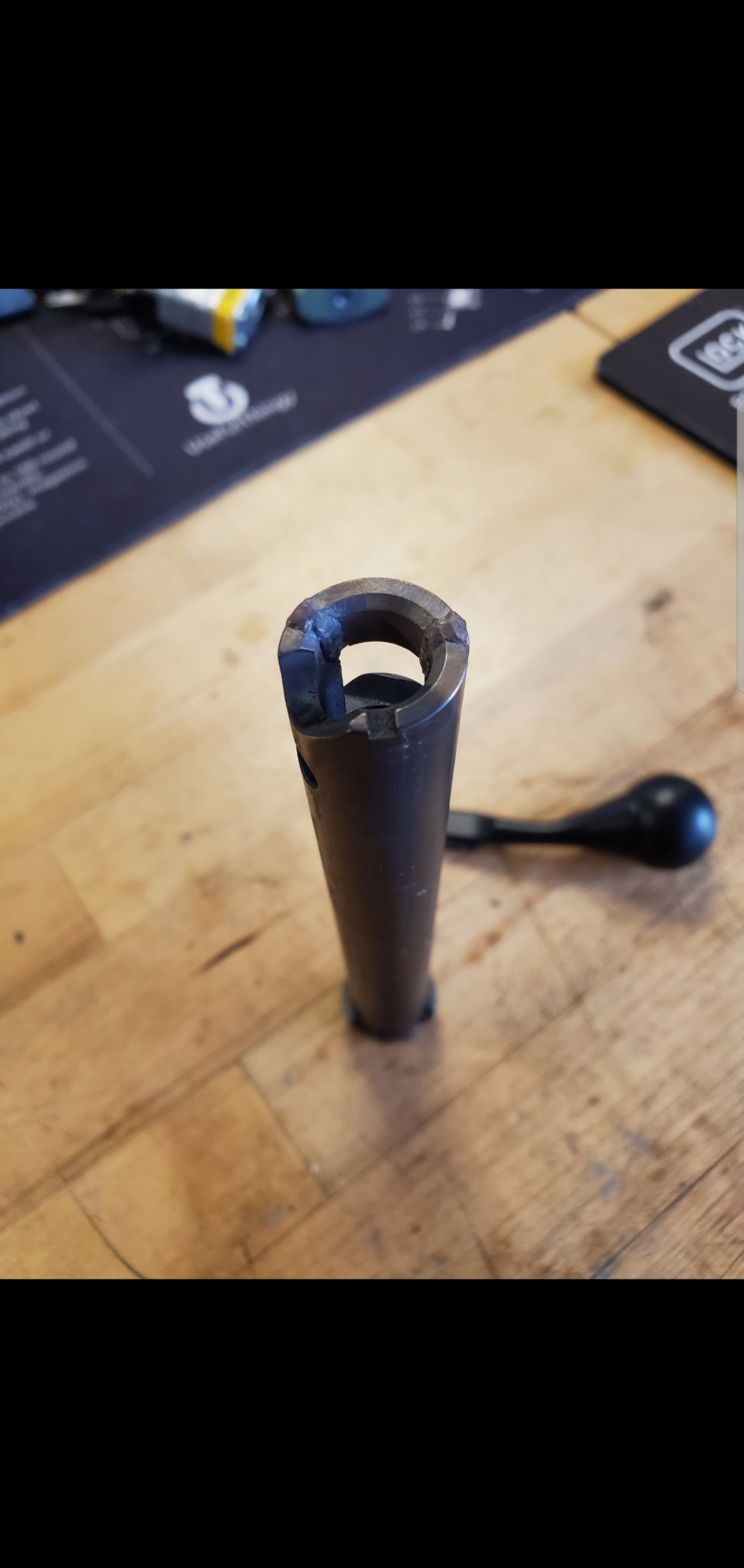

At first I thought there had to be something like a "one-time" drop at the factory or something. That someone in QC didn't catch. This is looking like a bad design, or the metal was improperly hardened. A combination of both?
FWIW, Tikka's were always known as good quality rifles (595, 695) pretty much on par with Sako's. It's when Beretta bought them, they started cheapening everything. This is clearly a design, with improper metal hardening, that isn't going to work. I won't trash them as I've seen them shoot outstanding. But, this kind of shit isn't outstanding, it's borderline dangerous. What if this thing had broken while you attempted to extract a live round? Now you have a live round in the chamber and that limits how you can get it out. Pretty fucked I think.
I understand there's going to be heavier, better built rifles from one company to another. But, I am sick of seeing companies cheapen rifles to the point they become throw away, just so Billie-Jo Bobby Dumbfuck can have a deer rifle. Rifles need to be made of a STRONG minimum standard quality from the start. Billie-Jo Bobby Dumbfuck don't need to shoot a deer if he won't buy a decent rifle. That design will carry up to our target competition and tactical rifles. The shit quality rifles coming out today needs to stop.

Make no mistake, both my Tikka's blow remmy's outta the water. Hell, they keep up with custom rigs in the accuracy department. After I welded my bolt handle I did a competition and had no issue whatsoever. Things happen and I would buy another one. Hell, you look at the main Tikka thread here and the fact there's a lack of issues reported is a great thing. People are more likely to report bad shit than good shit especially when you empty a good chunk of change from your wallet on a rifle.

3 of my current 4 R700s have handles brazed on in the 5 and 6 digit era. The 5th one, in production, also has one of those 6 digit high nickle steel bad boys that I expect to be in pace after nuclear Armageddon.
I expect even my sprightly young G receiver handle will be just fine.
I have been at class and saw a students puzzled look as he lay there with Remington bolt handle in right hand and bolt in rifle locked on a fired round.

This reminds me......I have a bolt at LRI that some genius destroyed the bolt body with a dremel.
I should ask @LongRifles Inc. if they can take that sweet 5 digit bolt handle off the fucked up bolt body and braze it on to a new bolt body to have as a spare.......
Willing to pay for that work Chad if you have a spare bolt body laying around or I could have a body shipped from PTG - prefer a Remington bolt though.

Gents, I had no issue with accuracy, it was amazing (especially coming off from Rem 700), was getting 1/3 MOA consistently, but was certainly not expecting this shit.
As far as what is stuck (several people PMed me concerned...)
It's a sized, unprimed case, with a bullet just started in the case mouth, was trying to determine OAL to lands (and yes, I'm aware that hornady has a tool to do this, and I own it, but I don't have a special 6.5 cartridge for it)

Tikka is a rifle made to a price point with resultant tradeoffs. It happens to be one of the best of that breed, but is still an inexpensive, and inexpensively made, rifle.
They are very smooth and accurate, but at $2500 you are getting into TRG territory. TRG looks similar, but is a different animal entirely.

This will be the last resort, I'll try to give Tikka/Beretta CS a try, after all this supposed to be warrantied. I have another rifle to shoot meanwhile...
If they come back with nothing or try to tell me that its not their issue, I'll go down the road of extraction and tig welding as you have.

agree with you 100%. It unthinkable that I can break a bolt in bolt action rifle with my hand...
I guess reliability was not high in Tikka’s mind, beyond an immediate trouble and disappointment, it has seriously shaken my opinion of tikka/sako rifles.
