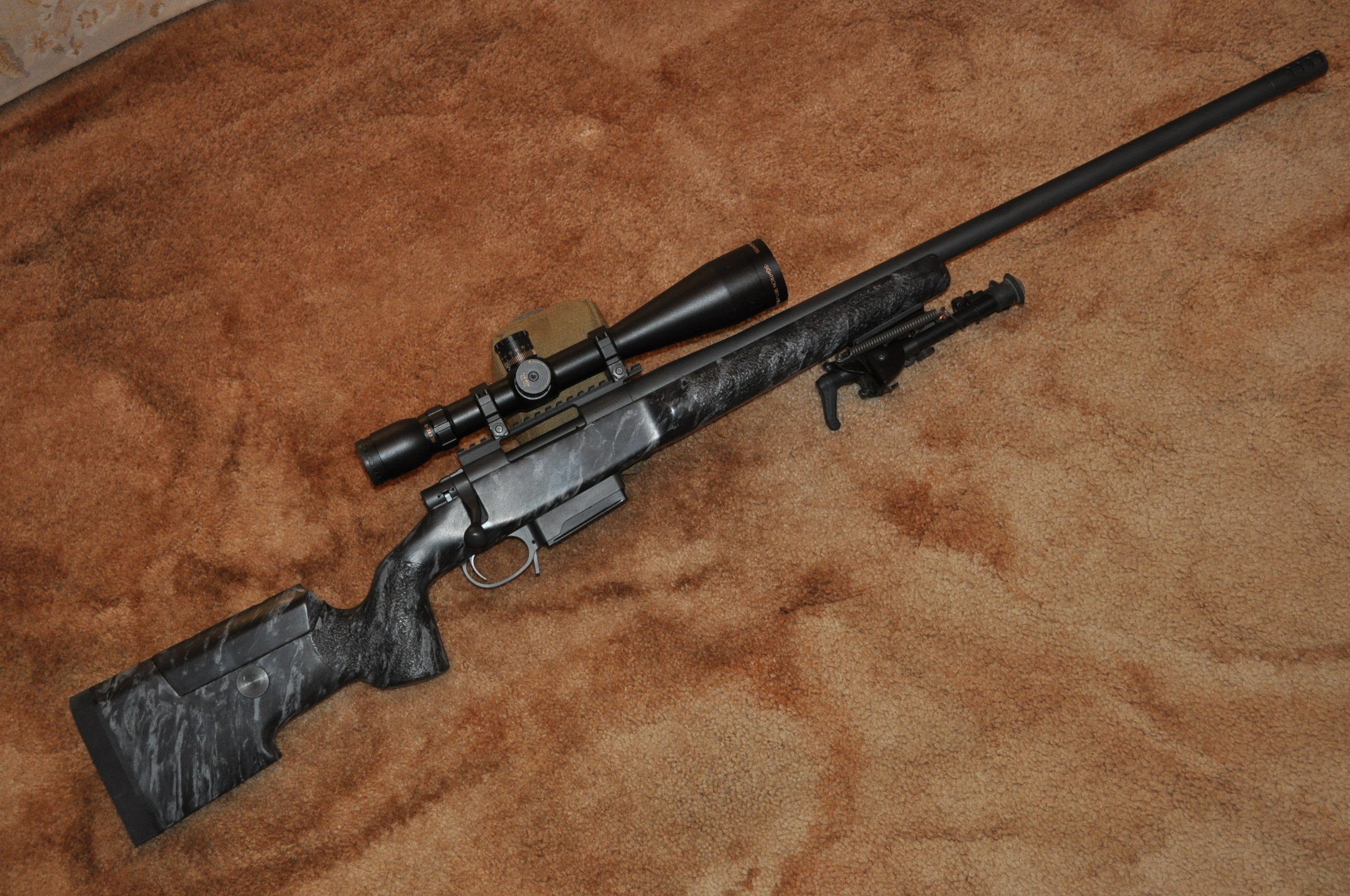

Used the PTG DBM on this Howa build in a McM A5, and have two more to do in B&C #2298 stocks. I should've left a mag stop shelf when I made the cut with the mill - didn't think about it to be honest. The inletting in both McM & B&C stocks was minimal - took only 15 minutes or so to get a good fit.
Only thing that bothers me is that the trigger shoe on the newer HACT triggers doesn't protrude down into the TG as far as I'd like. Not much I can do about it with either stock, as the magazine fit is basically perfect with the DBM flush with the bottoms of both McM & B&C stocks. Don't know whether you can see that in the photo or not, but it's even more noticeable in the B&C stocks.
Rifle is a 260 Imp 30*, 26" Krieger 1-8 in sendero contour, with Harrell's 4-port tactical brake, EGW 20 MOA sloped rail, Sightron SIII 6-24x50 in TPS TSR rings. Metal is sniper gray CeraKote.
