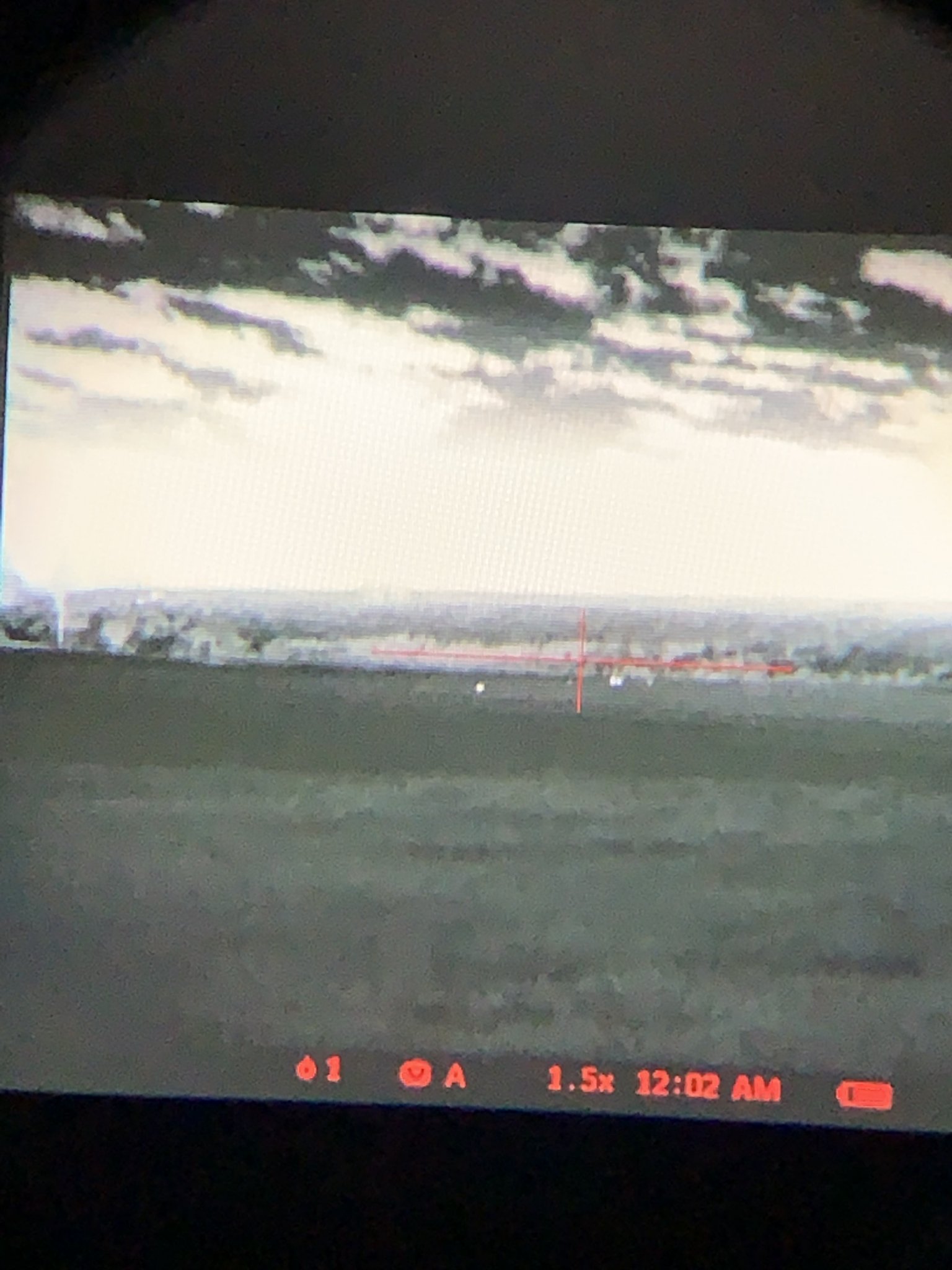

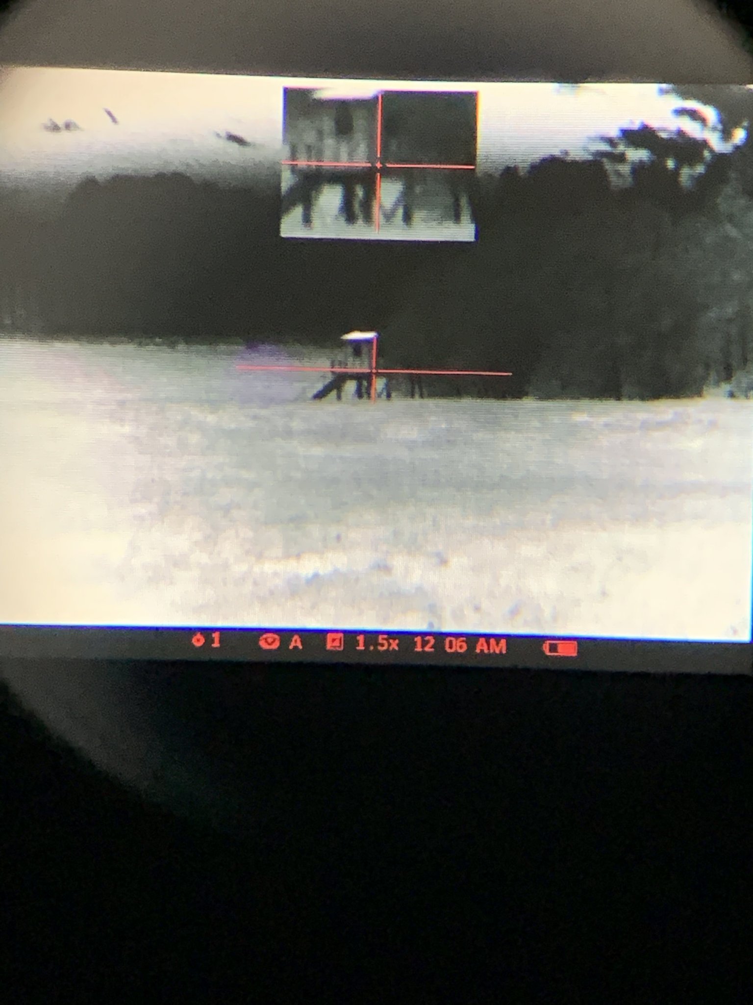

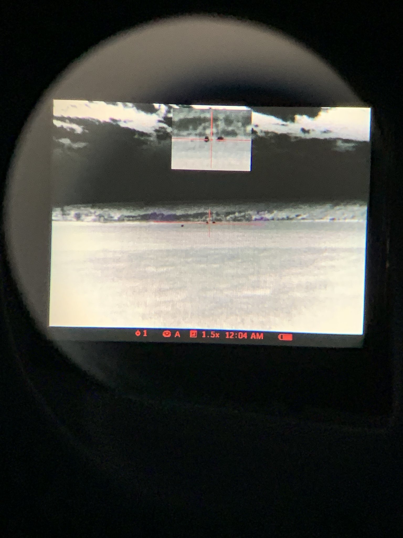

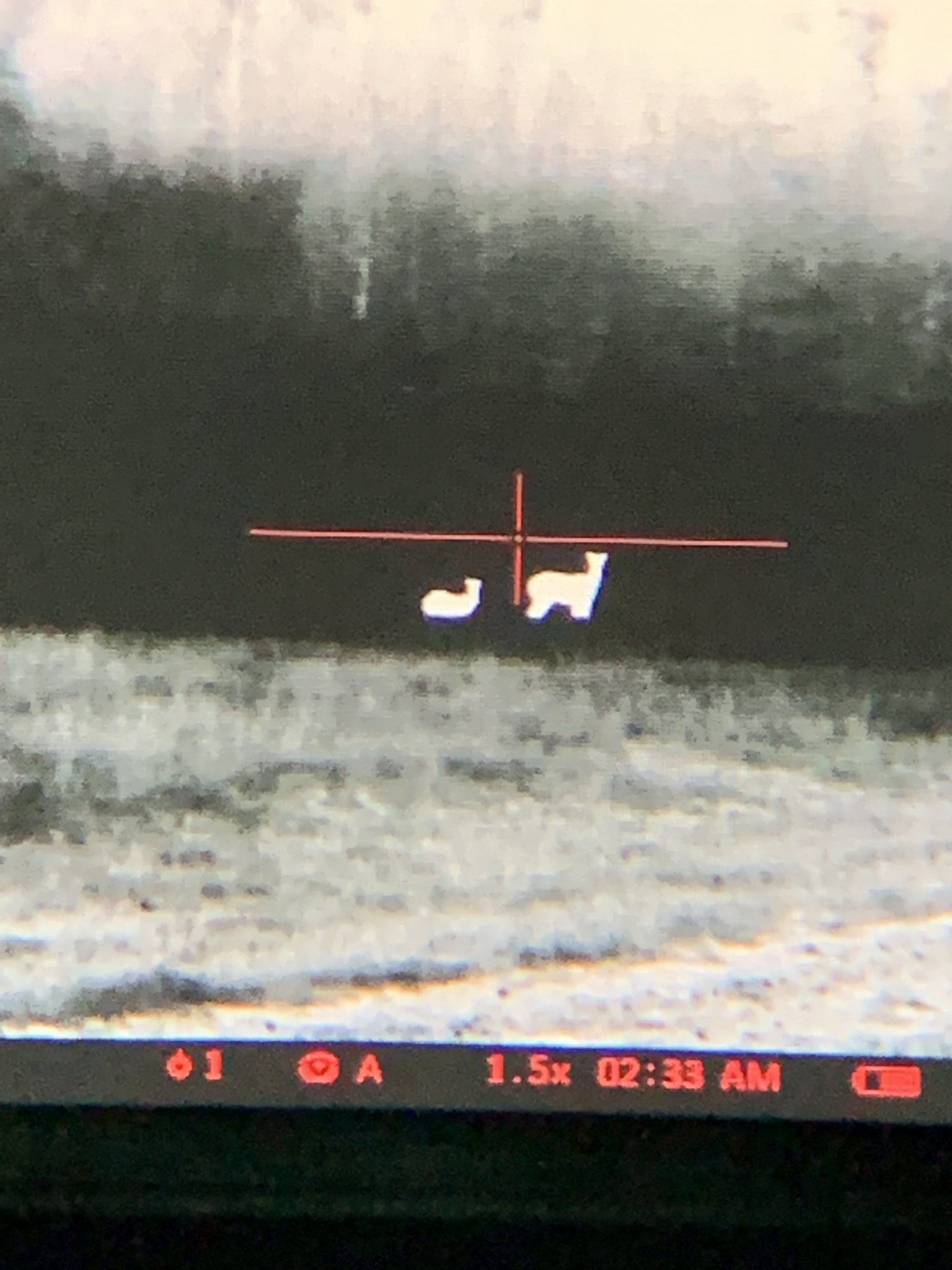

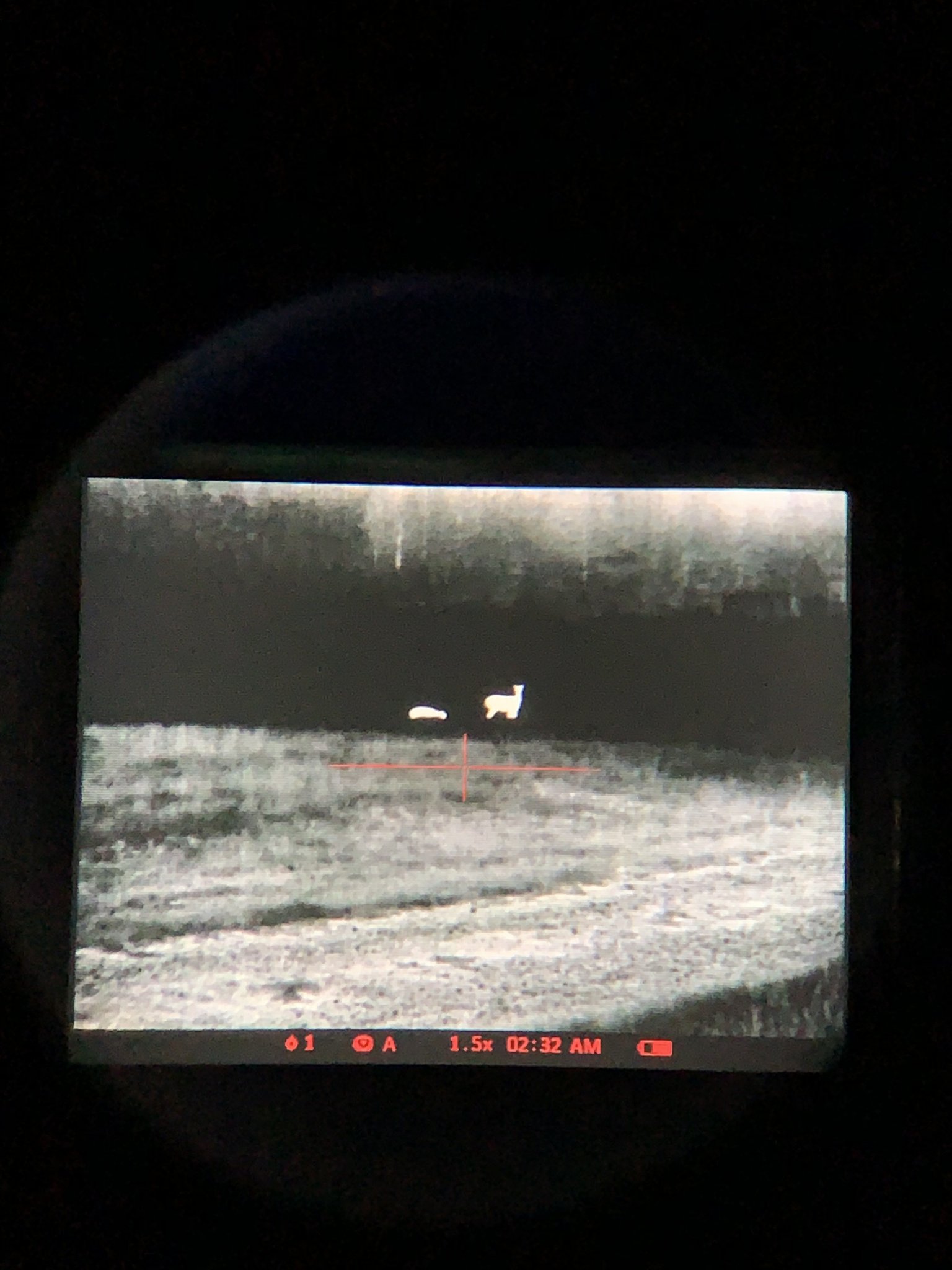

    Images below are from my Apex of deer at 100 and 600 yards. The blind is at 300 yards.
    I’m looking to see for those that have used possibly both or just the RXQ are these even close in image quality?
    I don’t need any video recording etc and really like the RXQ compact design vs the bigger Apex.
    I’d like to be able to see deer or people out to 1/2 mile ideally. I also like the RXQ being submersible. Not sure if the apex is but if I drop in a swamp etc while on search and rescue it nice to know it can take the water
    Any shooting with the unit is likely to not exceed 150-200 yards.
    Any help/opinion/pics would be appreciated. The images below are taken with my phone held behind my Apex XD38A for reference. I won’t be using as much as the hog shooting guys do so something similar to my Apex would be all I need as that worked great for my needs.

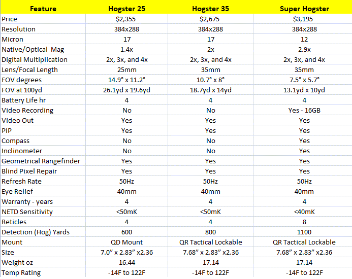

    The Hogster has the better warranty (4) years, the better image (especially in humidity), includes color reticles, color backgrounds, and adjustable focus. As far as longevity, last year I used Pulsar, Flir, and Bering Optics. The Hogster was the only model I used that after 500+ hours of use never glitched, locked up, or had anything odd happen even once that required it to be reset or restarted. Night Goggles has sold a lot of Hogsters, and customer feedback has confirmed their overall reliability. If you are trying to stay near 2K, you are probably looking at the Hogster-R 25, as it is the least expensive. However, the chart below shows the differences in the 3.
    You will be able to see vehicles at well over 1 mile and deer and people well past your desired 1/2 mile. They are relatively the same size, but the way to think about the models starts with the 25 is a good scanner and/or scope and provides comfortable shooting to around 150 yards. The Hogster 35 extends that range to around 225, and the Super Hogster to over 300. If using in real tight cover or want the widest FOV, go with the 25. The 35 is the most universal and the Super Hogster is the best option as a weapon's sight in very open terrain. Contact Tom Austin at Night Goggles, for special Hide pricing. 909-312-5424 X531

    I totally agree. I have used a lot of different thermals and in my opinion the Hogster series is the best value currently in the thermal industry. The 35 falls in the sweet spot of range and FOV for a lot of people. It is a solid choice. For a few hundred more than the used thermal, you are getting a better thermal that can be used as a scope and/or a scanner, and comes with a 4 year, transferrable warranty.
