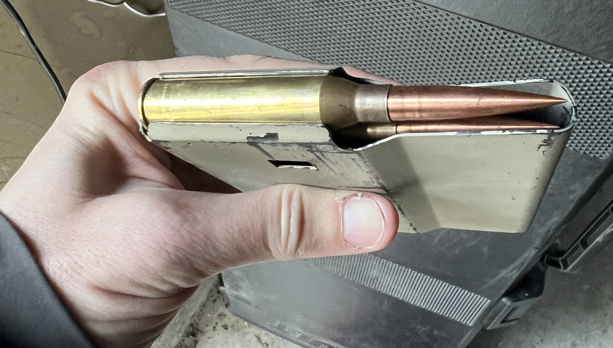

These are 3.91”

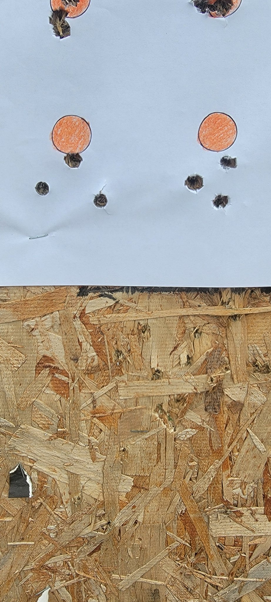

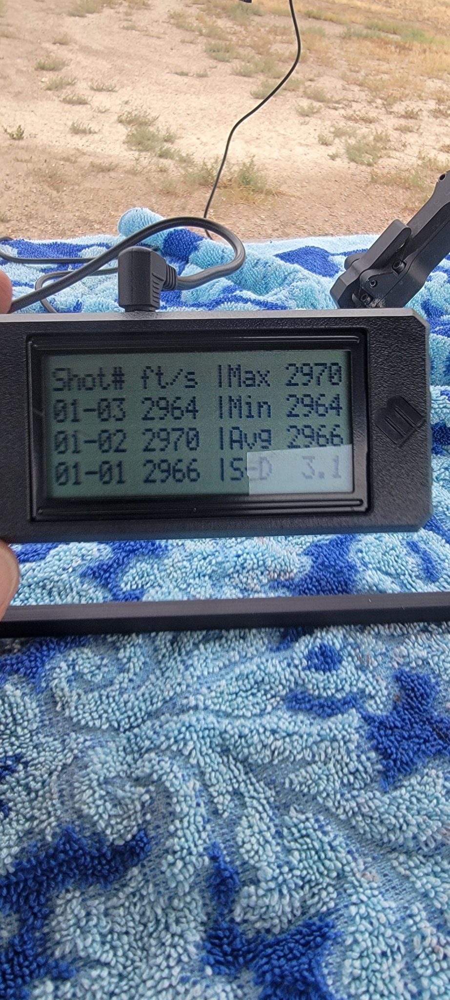

Shot some more pva 212. I had good numbers single digit SD and good speed had them over 3k but targets are not good
