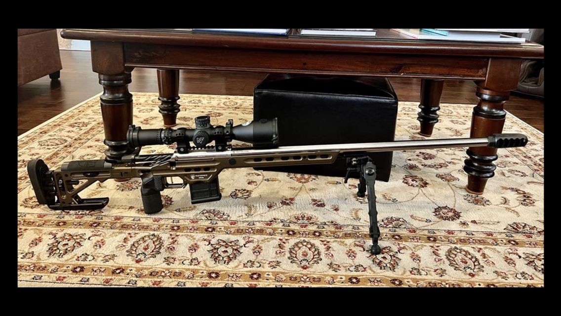

If i may ask for coaching:
1) What is typical case head expansion of a beltless magnum case on the first firing? What is max allowed?
2) What is max allowed expansion on subsequent firings if you want 8-12 reloads from your cases?
3) Best place/best method for measuring “case head expansion” (where on the case, and when: before or after FL sizing)?
MPA chassis, Curtis Axiom action, switch barrel setup via West Texas Ordnance “switchlug” system, 300 WSM match chamber, 7.0 twist, 28” Spencer/MPA barrel, APW 5 port brake, chamber cut for 0.160” freebore. ATACR 5-25 SFP scope in Nightforce rings. Currently have a 20 MOA rail (needs 50 at least, but probably 60 MOA would be best). Accu-tac bipod. Weight kit installed after photo was taken: 24.5 lbs total weight.
How is that Spencer mpa barrel? Long wait times?
Too early to be truly sure, but: Very pretty and shiny inside (Teslong borescope), seems like they did a good lapping job.
It shot multiple 208 ELDMs into the same hole during fireforming of the new Norma brass, using a random starting load near minimum. Have not started load development yet, so will have to wait and see.
The 28” 7 twist is meant for 241 and 212 Seneca copper bullets as well as Warner Tool bullets like the 198 Flatline.
Have a second 8 twist (30”) for heavy lead core bullets (200 to 230 gn range). Takes 90 seconds to switch barrels at the range. Zero seems to hold within 2-3 clicks, if the threads are kept clean, usually well less than 1.0 MOA. I do not re-zero the rifle after a barrel swap, rely on the ballistic calculator to remember the scope offset. Then recheck zero at distance.

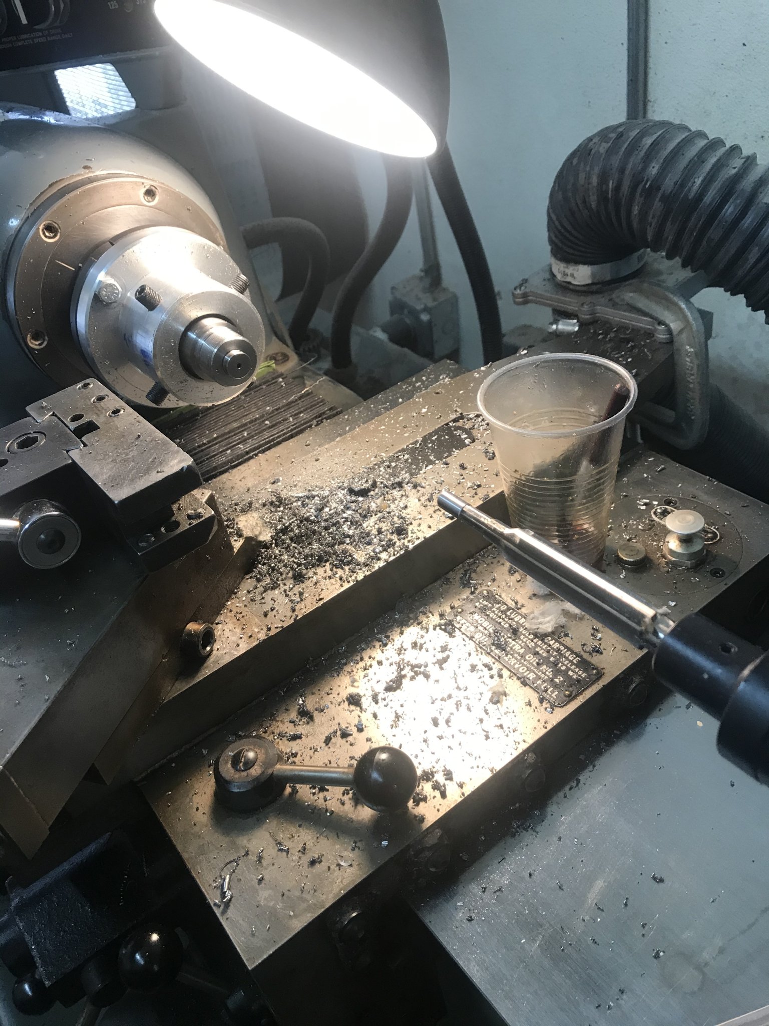

Awesome man. That sure would be nice cut out time and a ton of money.
Yea
I’m far from what you’d call a machinist but I do have a fair amount of time on a lathe and mill.
We have a few lathes at work so I made spiders for one of them and bought some of the necessary tooling.
Basically my first barrel paid for the tooling.
