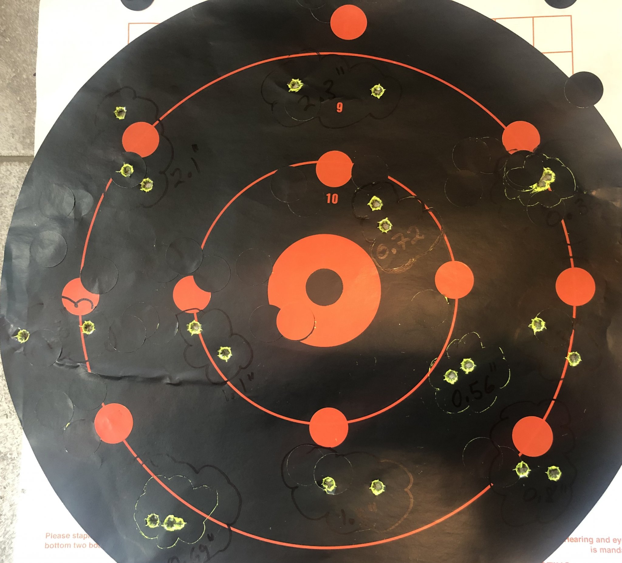

Started shooting some 212’s in 28” 1-8 bartlein. 300nm, 89.0 n570, 3095fps. Accuracy looks good so far. Just getting a few rds down the barrel then I will play with seating depth possibly but not sure it’s worth it as this current load looks good at distance.
Well today I did a little testing with the 212’s and h1000. Went with the seating depth that I had thought were the best last go around. First 3 groups had me ready to call it a day. Then 4th was not half bad. Five shot confirmation group was bout 3/4” maybe a hair smaller. Didn’t remember to take a pic of that one
This barrel seams to like 3050 FPS
This barrel seams to like 3050 FPS View attachment 7869252

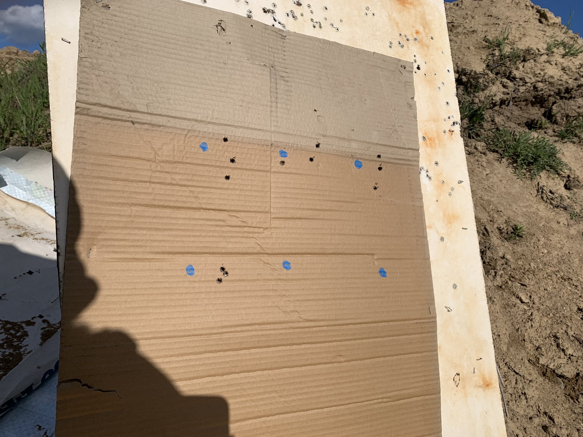

Yep, i also got best results with higher neck tension with the 212 Seneca. Calipers say about 3 thou +- 0.5, but the micrometer is likely more accurate and reports a 3.6 thou difference between a sized and loaded round. Bullet is clearly resizing the neck. Seating force is around 42 lbs, which is medium (Neolube nr 2 on bullet and neck, but no HBN coating).
The high neck tension might be a bullet specific or a powder specific thing, not sure. I am running H4831 in the mid 60’s in a 300 WSM getting 2940 fps, and the load is well away from pressure signs. It is a 28” MPA/Spencer barrel with a twist rate of 7.0. Groups are pretty good, usually below 0.35”, with an occasional errand shot that opens up the group to 0.6”. Probably just shooter form issues, recoil is quite a bit more than the 6.5CM i am used to.

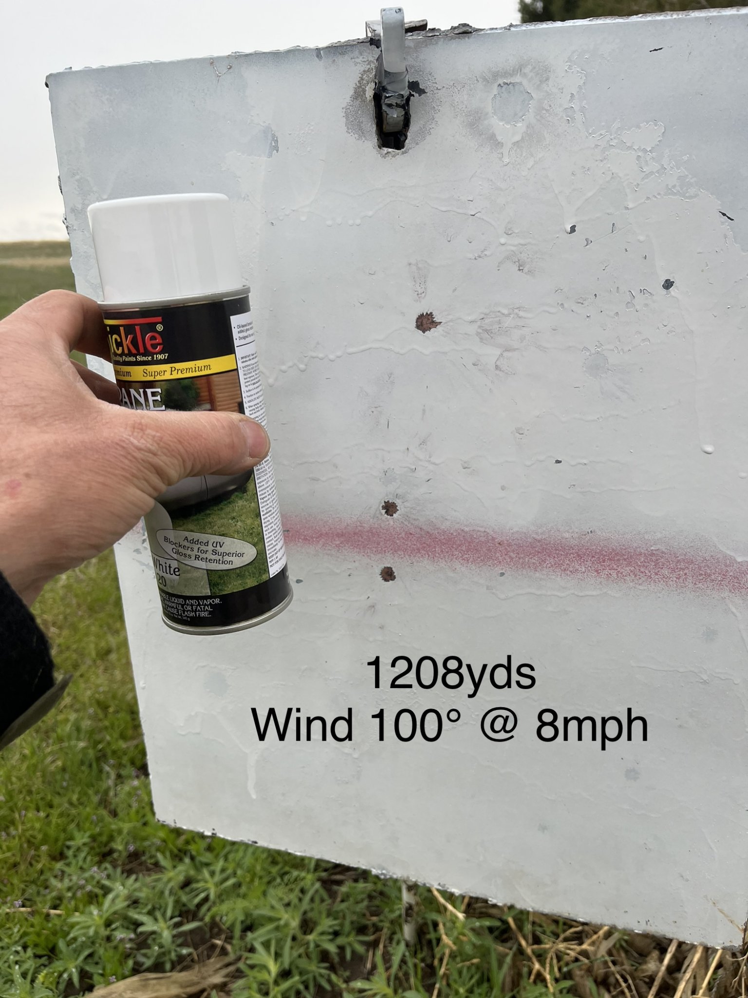

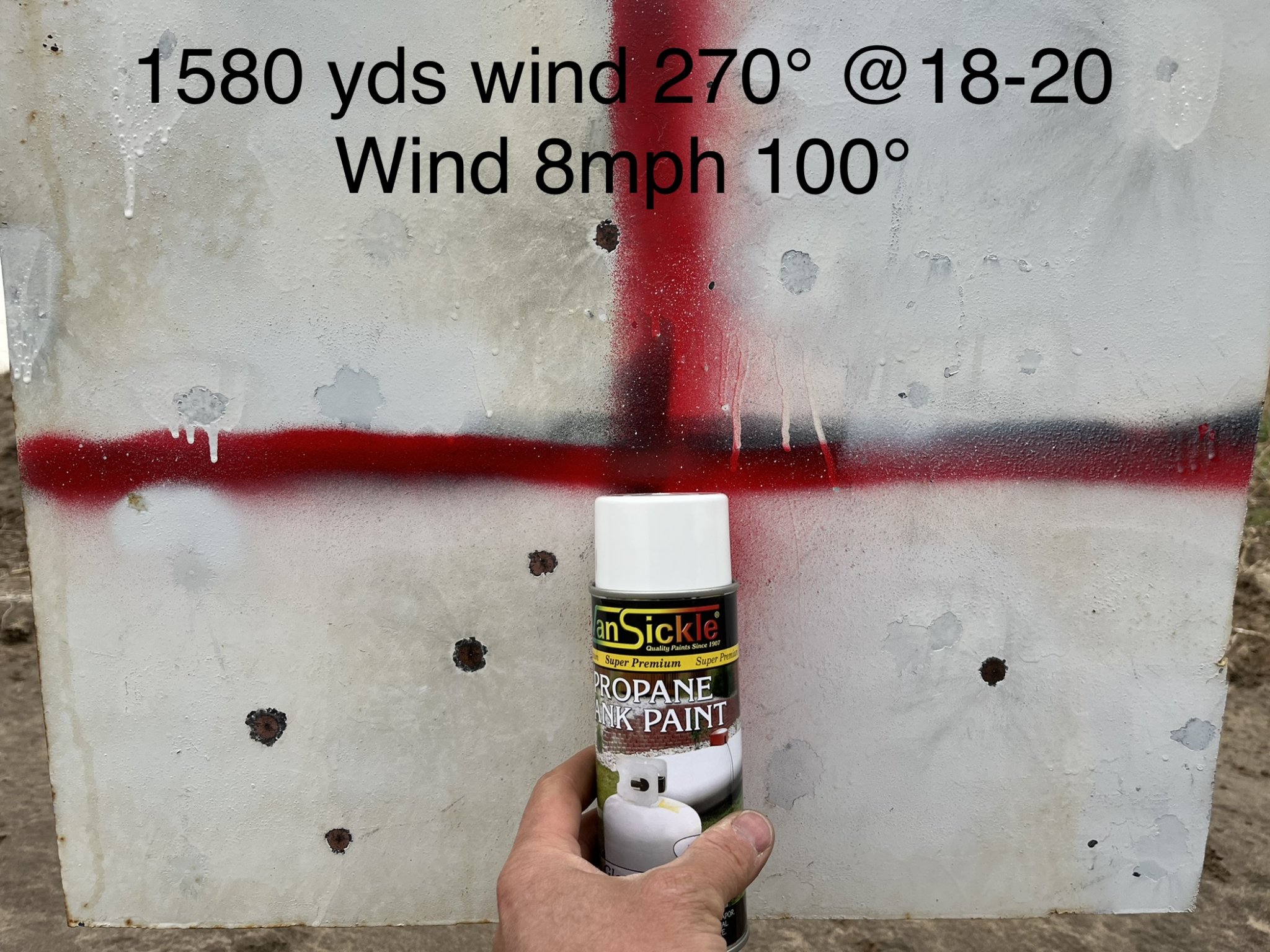

1208 was all but covered from the wheat so I held .2 low off the top and sent it.

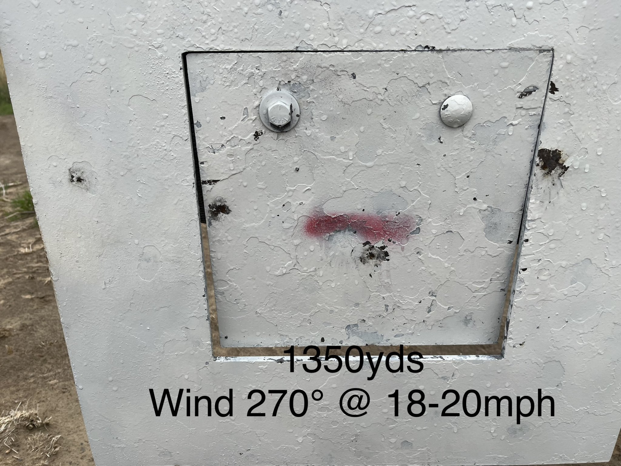

1580 had 3 shots from todays 8mph wind and 3 shots from the other day when the wind was variable 18-20, sometimes dipping lower.
212 seneca
300nm
28” 1-8
3100fps
212 seneca
300nm
28” 1-8
3100fps
That is a good result. That 1580 yard target has a waterline of maybe 6 or 7”, except for one high shot, that is very impressive for the distance. And shot over two days, likely with at least some change in ambient conditions?

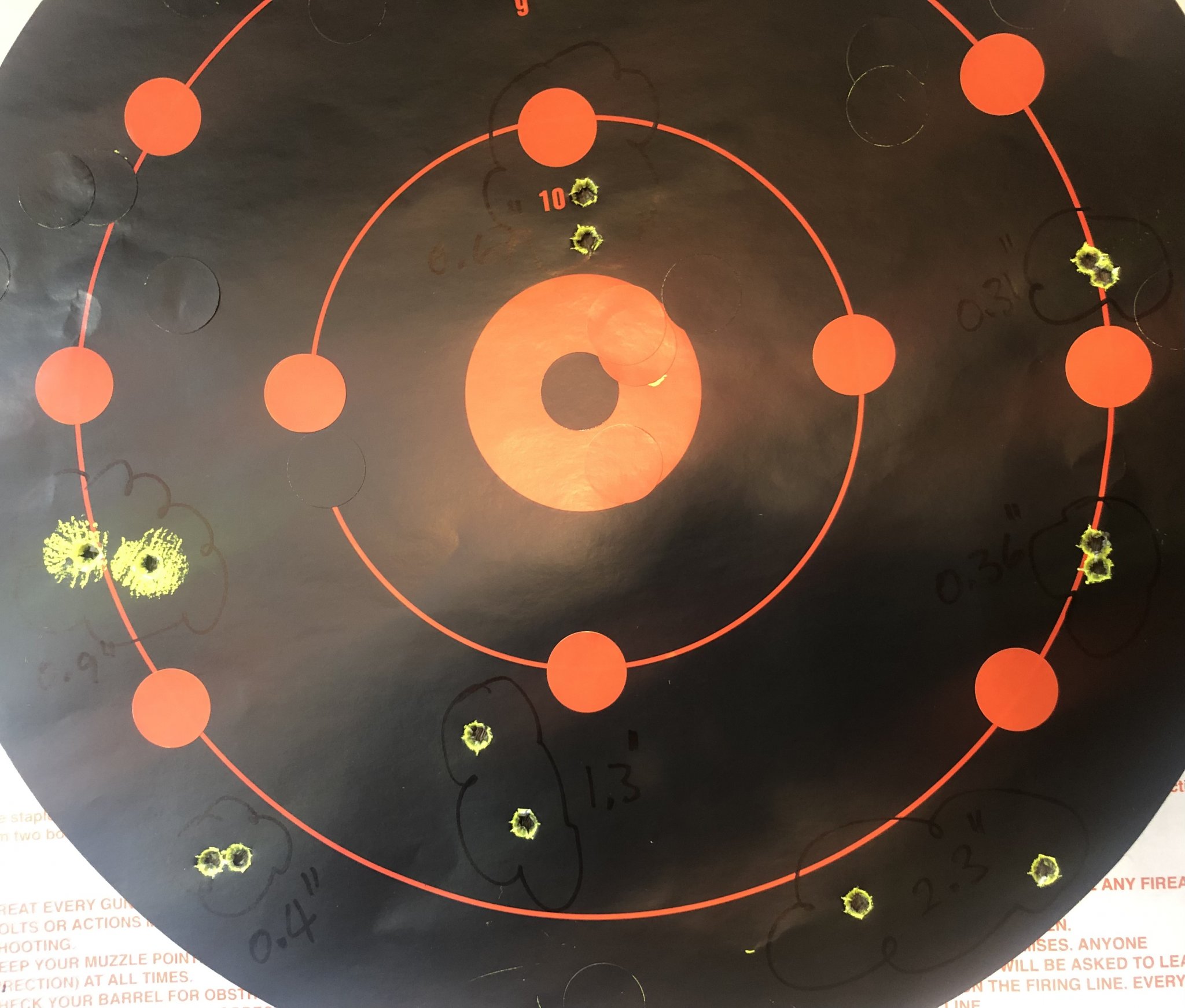

Tuning the 212 gn Seneca load for the 300 WSM:
OK, so i gave up on 4000 MR as it was too temp sensitive, and tried H4831 long grain, H4831SC short grain, and IMR 4350:
H4831 long grain worked, but required a fairly compressed load, not really enough case capacity in the 300 WSM case, and got to 2960 fps without major pressure problems, but did produce “clickers” at the top end (ADG brass). But want to keep my limited supplies of this powder for the 225 ELDM in the 30” 8 twist barrel.
H4831SC (short grain) ran into pressure at 2923 fps, also a compressed load, and had a 1.0 wide flat spot at almost exactly the same speed as IMR4350 and H4831 long grain. Probably not a coincidence.
Next tried IMR 4350, which worked well enough to get me to 2935 fps from a 7 twist 28” MPA barrel, without pressure, and with casecapacity to spare. SD was a respectable 5.5 fps on a hot Texas summer’s day that started at 84 and ended at 95 deg F. [Even though IMR 4350 is not officially a temp stabilized powder, it does quite well in this regard, in my experience.] But clickers appeared at 2955 fps so took 2940 fps as the max.
Found a flat spot between 2930 and 2940 fps that was 1.0 grain wide. So loaded to the bottom end of that flat spot (2930), and tested seating depth from 20 thou to 60 thou in steps of 3 thou, using up way too many components! Found two candidates that produced groups below 0.5”, one at a 45 thou jump, and the second at 55 thou. The very short jumps (20-35 thou) all gave 2 shot “groups” between 0.9 and 2.3”, kinda ugly. Also, it looks like very narrow seating depth ranges where the bullet/powder combo groups well. Not sure that would make for a reliable load. [Might need to try 5-20 thou range some day when i have new bullets in hand.]
But surprisingly, i found that very long jump (135 thou and 145 thou) both gave 0.3” groups, with bullet holes touching. Same group size as 4000MR. This looks more promising, will see if it repeats. I am hopeful.
Disclaimer: It is difficult to determine exactly where the bullet’s front pressure/alignment ring (not at full diameter yet) touched the lands, easy to push that through into the lands, so my jump numbers might be way off. [COAL is perhaps more reliable than boat-tail-to-ogive for this bullet.]
Short jump: 20 thou to 60 thou:
Four seating depths that gave a 2 shot “group” below 0.7” (not great), and two below 0.5” (OK).
But very narrow, would have liked to see the neighboring groups also fairly tight.
Long jump (65 to 150 thou): Three workable bullet jumps with group size below 0.5”. Best group was 0.31”, with bullet holes touching.
Looks like the rifle prefers a very long jump, and then a wide range of jumps work out fine…. Should be less finicky.
Will need to order another batch of bullets to confirm this load holds together under different ambient conditions…. Then it is time to try it at a mile.
