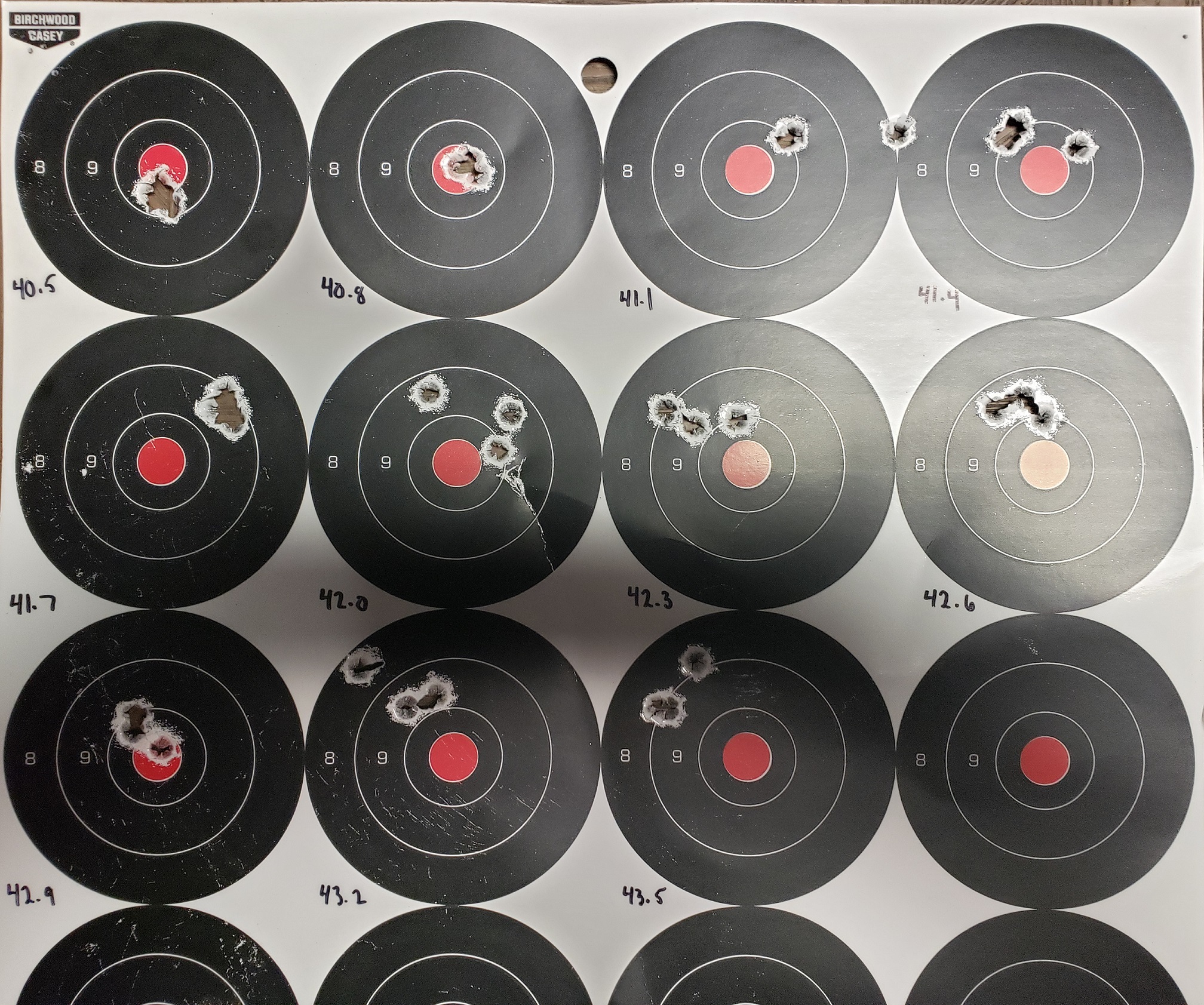

Started load development with my PVA nucleus 26" 6.5 creedmoor.
Components used are:
Virgin Lapua 6.5 SRP brass
CCI #450
Hodgdon H4350 40.5-43.5 in .3gr increments
Hornady 147 ELD Match
Seated to 2.80"
Velocity from Labradar.
Factory Hornady 147 ELD M
2696
2679
2681
2705
2710
2720
2694
2698
2688
ES: 41.61 SD: 13.53 AVG: 2696.72
40.5
2631
2635
2615
ES: 19.05 SD: 10.18 AVG: 2627.08
40.8
2635
2631
2622
ES: 13.27 SD: 6.71 AVG: 2629.33
41.1
2677
2646
2654
ES: 30.93 SD: 16.03 AVG: 2659.34
41.4
2664
2655
2661
ES: 8.74 SD: 4.45 AVG: 2660.12
41.7
2685
2695
2667
ES: 27.65 SD: 14.07 AVG: 2682.18
42.0
2707
2689
ES: 18.03 SD: 12.75 AVG: 2698.39
42.3
2725
2720
2719
ES: 6.62 SD: 3.45 AVG: 2721.46
42.6
2742
2724
ES: 18.57 SD: 13.13 AVG: 2733
42.9
2742
2745
2733
ES: 12.19 SD: 6.27 AVG: 2739.84
43.2
2764
2753
2746
ES: 18.54 SD 9.32 AVG: 2754.2
43.5
2767
2772
2773
ES: 6.07 SD: 3.19 AVG: 2770.83

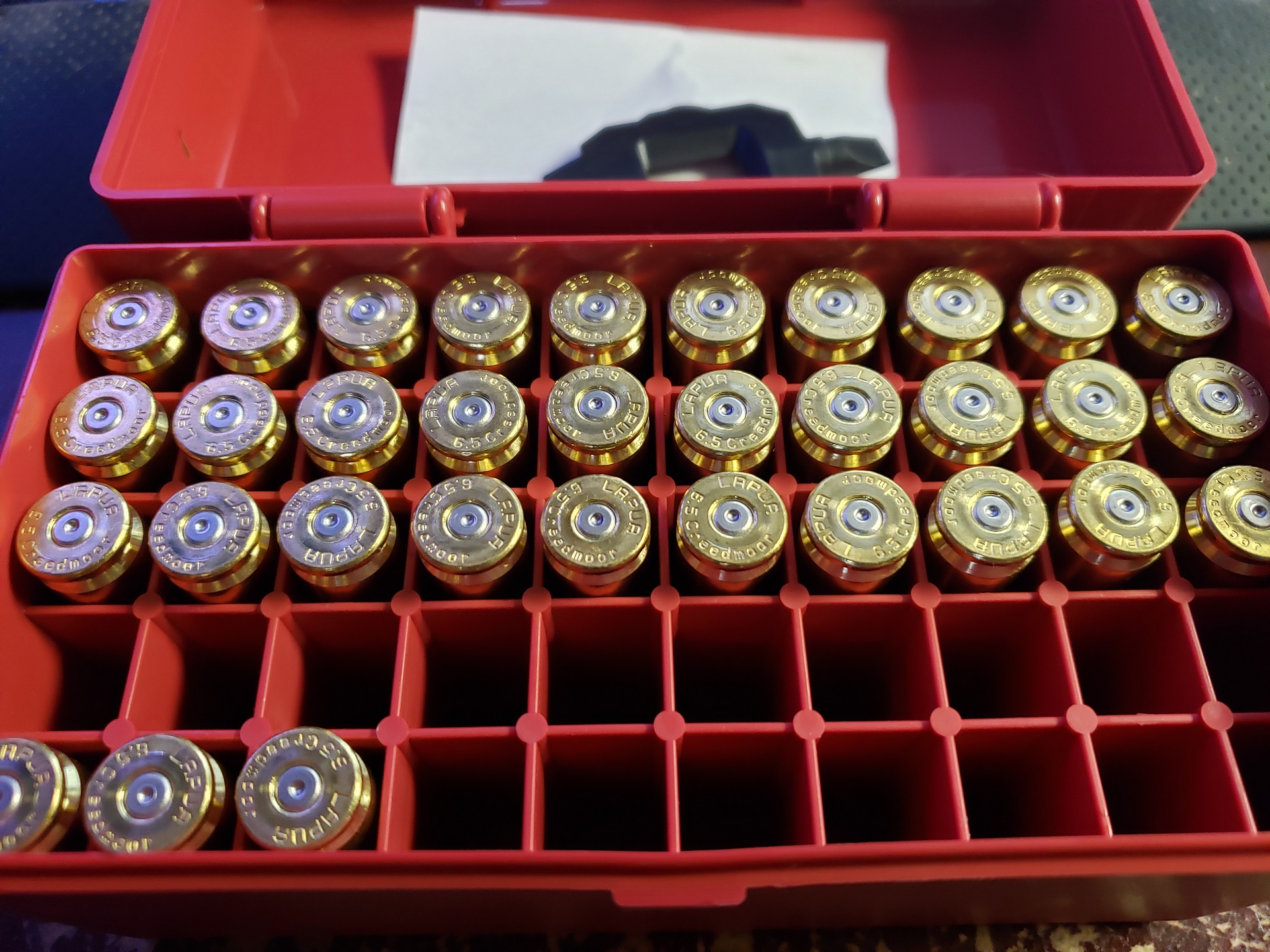

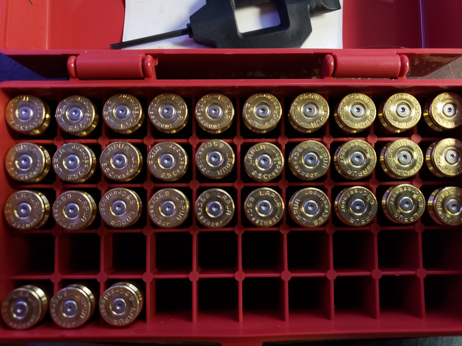

All brass looks excellent, and groups are pretty good also. Shot in order NOT round robin. Thinking 42.3-42.9 is a node based on nearly identical POI. Also looks like 43.2-43.5+ could be another node. Was hoping to see 2800+, will it get faster now that the brass is fired? Do I dare go higher than 43.5?
Never really done an OCW, always just loaded 5 of each and shot them, best group i loaded more and if they still grouped good, that was my load. Not sure how to proceed without wasting barrel life.
