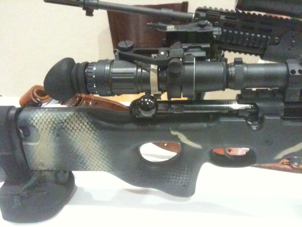

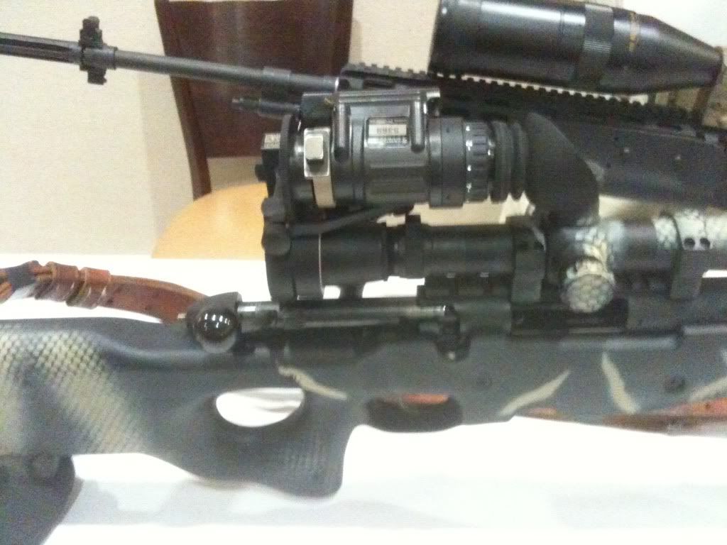

I am attempting to locate a mount that I saw at Sniperweek. It was used to secure a AN/PVS-14 to the ocular bell of a day scope. When not needed a latch could be pressed to swing the PVS-14 out of the way. The PVS-14 could be dropped back into place in a second if needed.
I can't for the life of me remember who the vendor was who had it on display and a google search has not turned up anything.
<span style="font-weight: bold">I an NOT posting this to debate the limitations of mounting a PVS-14 to the back of a day optic.</span> I am well aware of the issues. At this time it's not up to me to dictate what device will be used. It's just a matter of making it work, and this piece of hardware will do what I need.
Thanks in advance.

I just found a crappy cell phone pic I took:

<div class="ubbcode-block"><div class="ubbcode-header">Originally Posted By: 03bulletstopper</div><div class="ubbcode-body">http://www.nightvisionstore.com/Night%20...20Monocular.htm
There it is.I have the solid mount that works really good only problem is having to move to move your scope forward for eye relief. So i use the ARMS quick release then reconfirm zero after move. </div></div>
Lone Wolf,is this the one you were looking for?
Re: PVS-14 mount help
<div class="ubbcode-block"><div class="ubbcode-header">Originally Posted By: Pappy42</div><div class="ubbcode-body"><div class="ubbcode-block"><div class="ubbcode-header">Originally Posted By: 03bulletstopper</div><div class="ubbcode-body">http://www.nightvisionstore.com/Night%20...20Monocular.htm
</div></div>
Lone Wolf,is this the one you were looking for? </div></div>
Yep, that's it. Now I need to find a price.
