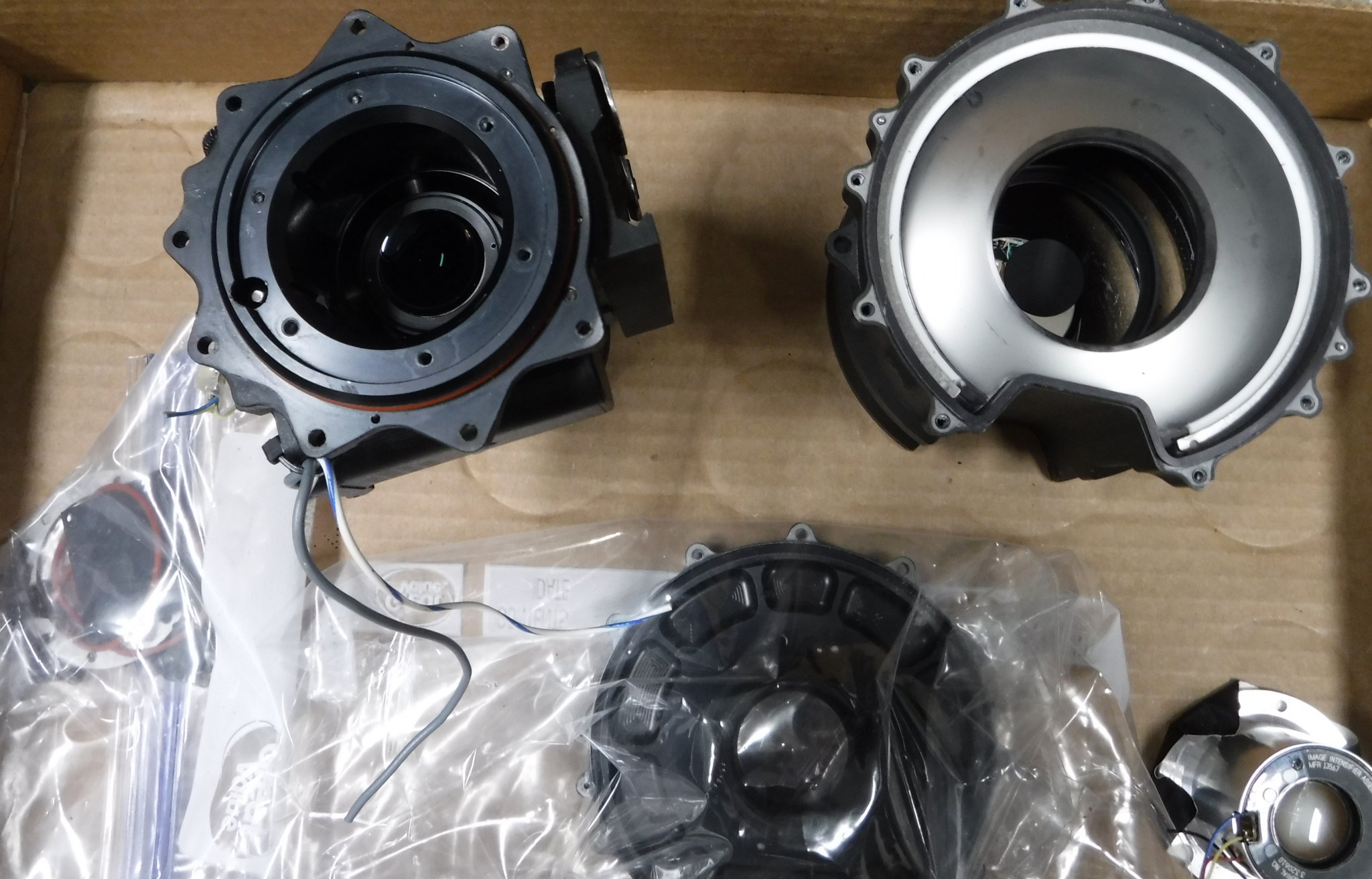

I have an OSTI PVS-27 with quit a bit of vertical boresight error-About 10 MOA.
Does anyone have experience with FLIR servicing these scopes or have any insight?

We have had about 12 come through recently. IN testing them ive seen a 6 moa shift with 2-3 moa the norm. FLIR has not been much help in parts or service, but you can give them a try. I was told they where phasing out the civi NV stuff ? weather thats true or not youll need to get to the North Ballerica division as thats where the MUMS are done. Is your shift consistent from on and off ? I have found that even the 6moa shift was repeatable so worst case youll know your offset and should be ok even though we would like to see alot better. Pm me and ill send you the contact info for the lady ive spoke with if you want.

I have contacted Ed Wilcox and this is beyond his abilities/experience.
There is a lot more to repairing night vision than replacing the battery housing on a PVS-14.

It may require factory fixtures to assemble/boresight.
The main reason I’m bitching about FLiR is their quote to boresight the unit is most likely untruthful. They just don’t want your business but feel they have to provide SOMETHING as the manufacturer.
Just like Safari Vectronix does.
I have corresponded with the inventor and the designer and t does require special fixtures. Yes it will come back clean/ purged/ aligned and 100%. I have had nothing but good experiences with FLIR repair in Boston. I understand theat when they were in San Fransisco there were problems but my recent experience has been positive.

I have been to the FLIR factory a few times several years ago. At that time I walked the entire PVS-22 and 27 production line that was a VERY complex and techical process to say the least including ALL glass getting grinded on site to their specifications and not in Japan or anywhere else. In fact the very last stage was their shoot booth were EACH of these hand made devices where placed on a SCAR Heavy and tested for shift.
I know what goes into building these optical devices. It's expensive and it's not a simple process along with proprietary and legacy build techniques that made these OSTI/FLIR units what they are today.
What does concern me is these "certain" units getting peddled out there that are 8-10 MOA outta collimation and so called new? Sorry but these units come from the factory 1MOA or better boresight so what on earth happened they are now way outta spec??? They don't get this way sitting on a shelf untouched.
Bottom line, let the manufacturer fix this period.

1: All of the work grade clip-on units leave the factory after getting signed off on a battery of inspections. This includes PVS-22,24,26,27 and 30.
One of those inspections that must meet a set criteria is the POI shift.
It may or may not be called that in their manuals but that is what it amounts to.
Almost all of them have an acceptable max of 1 M.O.A. shift when they leave the factory.
If you are lucky, have a sturdy unit and manage to keep the banging around to a minimum most of those units will retain their collimation and still stay inside 1 MOA max shift years after they ship.
If your unit currently has a 2MOA shift or an 8MOA shift, that means something moved internally with the prisms or some other alien tech at some point between receipt of the new unit and now. That something was not supposed to move but it did.
Did the shift occur in single event that accounts for the total POI shift you are currently experiencing or is it the cumulative error from 2 or 3 events that caused the total POI shift you now have?
It could be from recoil during use even if the unit is supposed to be rated up to 50BMG. If something is loose that shouldn't be, then recoil rating is a moot point.
The "event" could also be from banging the gun around with the unit mounted or even transporting the unit when it is not even mounted.
If it moved at least once. . . . , something is already loose or out of alignment internally and could very likely move again. So are you going to take a unit with a known POI issue to a potential use of deadly force with the last known POI shift "dialed out"? That is very unprofessional and actually negligent in my opinion.
"It does hold that 7.8 off so it can be dialed out ". How long can you guarantee that unit will "hold" 7.8?
It sure as heck didn't get from =/< 1 MOA to 7.8 by design. How can you in good faith ask your team and/or a non-hostile to count on a round tracking straight when it is pointed by an optical tool that is out of spec?
So my point is that it moved at least once when it was not supposed to. To assume that it will not move/shift again would be foolish. It is only going to "hold" the current offset until it decides on its on that it didn't like the way it was handled or bumped.

I have seen 7 moa or more. But it was repeatable so you just dial it out.
We teach all of our shooters to baseline their optic and dial out the night shooting variance.
Usually it’s 1.5-3.5 moa. So what’s the difference in dialing 6? Not much.
I'm lucky as shit on my last PVS30 with it being only a .1mil upwards adjustment.
It was so close I thought something was wrong. lol
