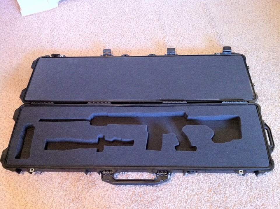

This was done with a disposable utility knife and took all of about twenty minutes.

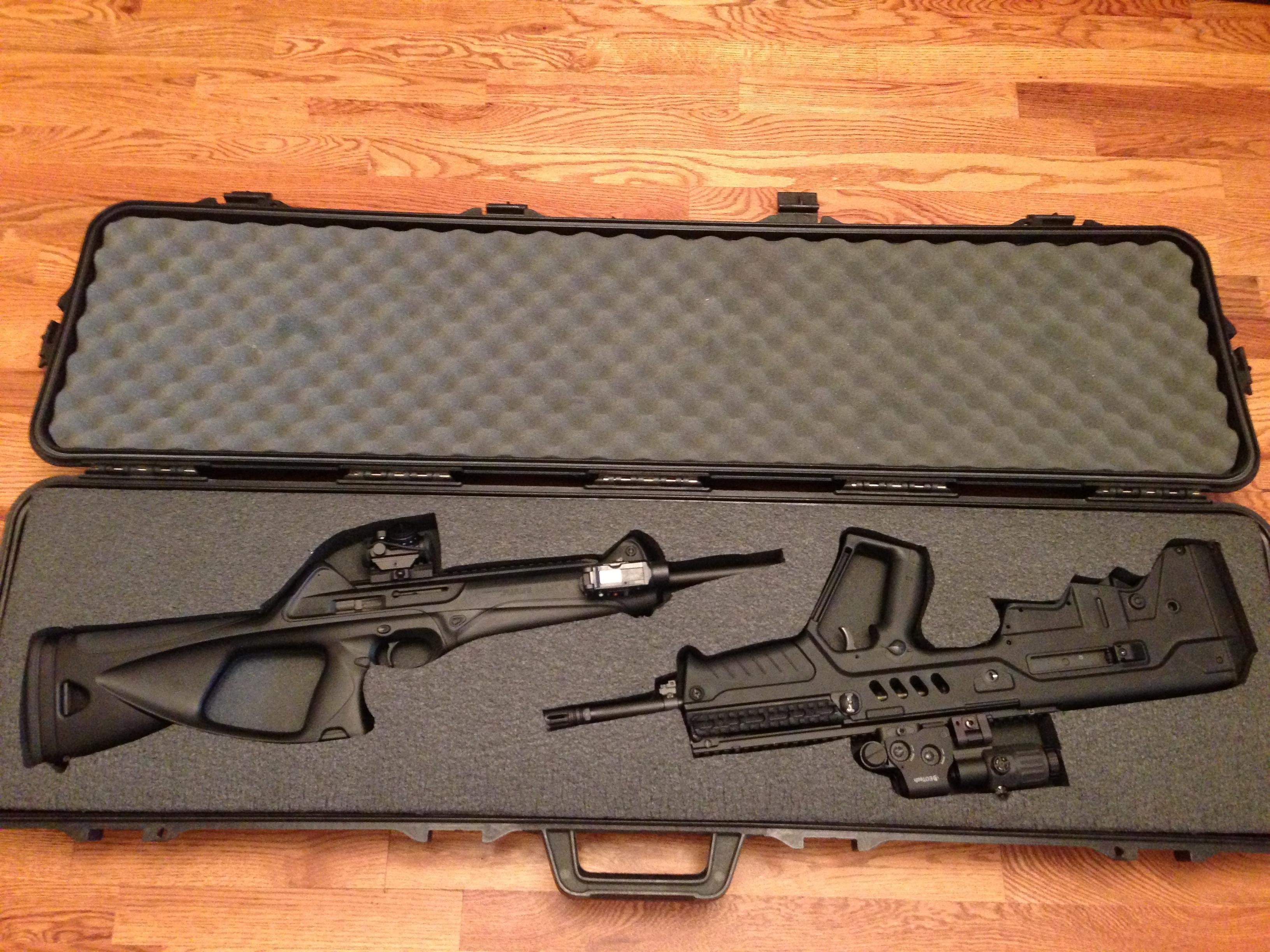

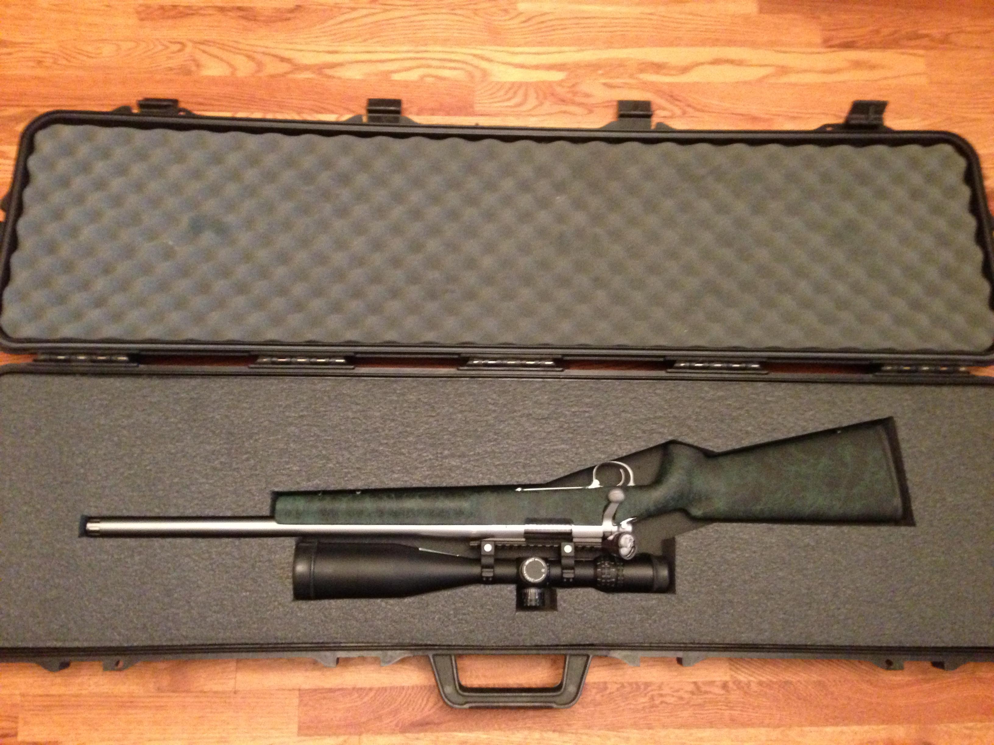

I went to a local case distributor and paid him for a custom closed cell insert. The closed cell is MUCH better than the crap that comes with Pelican. I watched him "cut" the foam and he used a jig saw with a blade without teeth, he called it a razor blade for jig saw. Well I just so happened to have 1 in a kit of blades I bought so when I got home I cut my own for a Tavor and a CX4 Storm. They are both perfect, his and mine, you can't tell the pro job fro mine. You also need a piece of donor foam UNDER the foam you are cutting. It works WAY better than an electric knife, believe me, been there, done that.

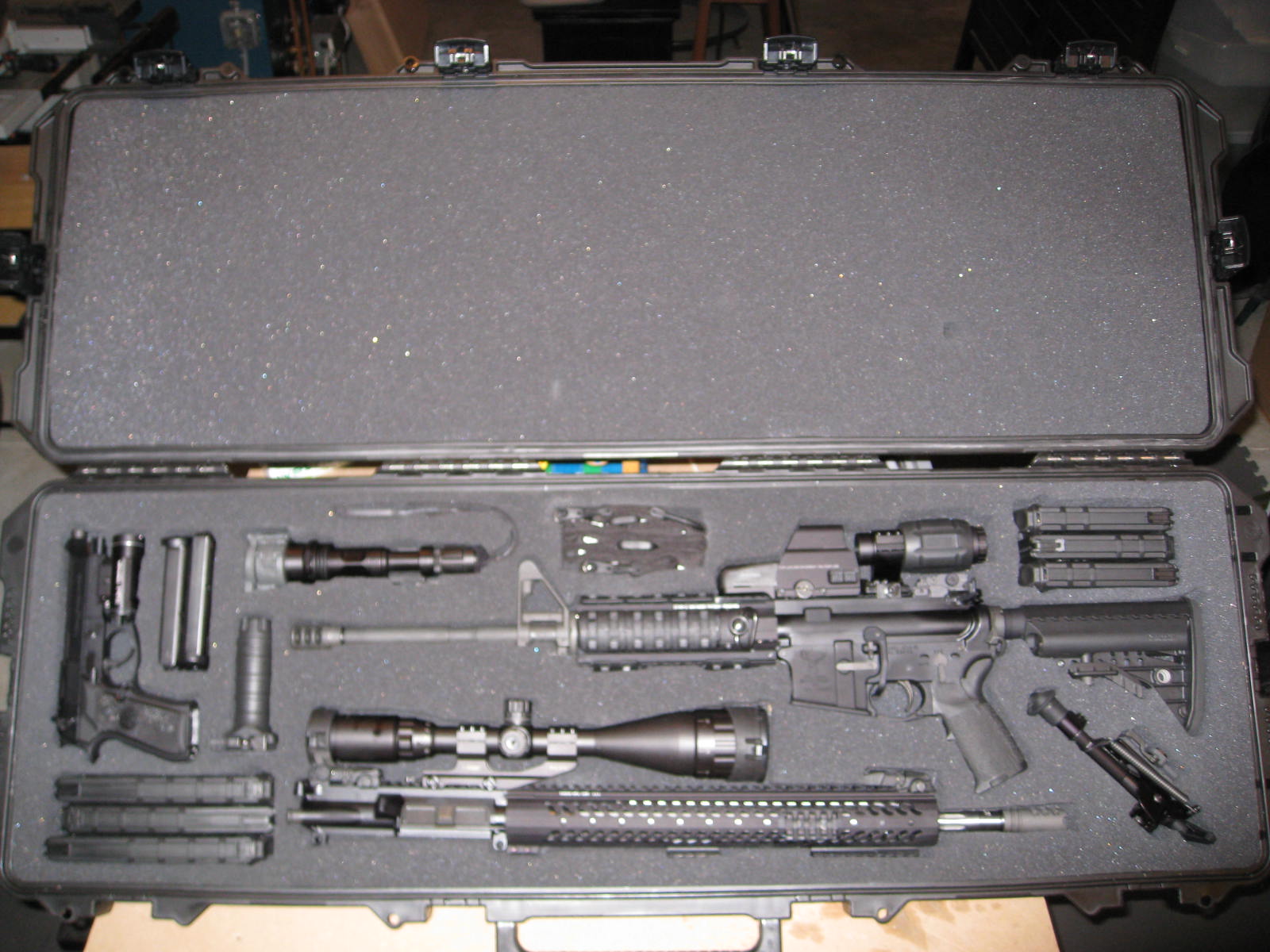

I've since sold this being in the people's republic of Connecticut. But did this with a utility knife from Lowes, tracing the outlines onto cardboard, using the cardboard shapes to do layout and then pinning the cardboard to the foam and cutting around them...just takes a little time and patience.
