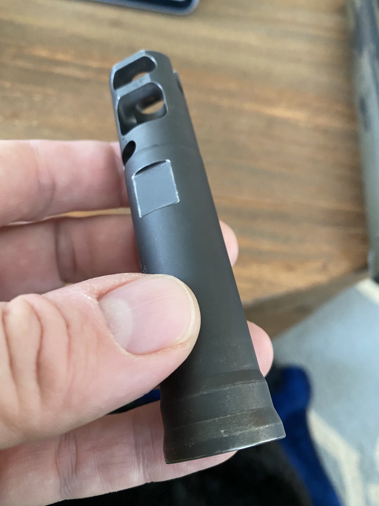

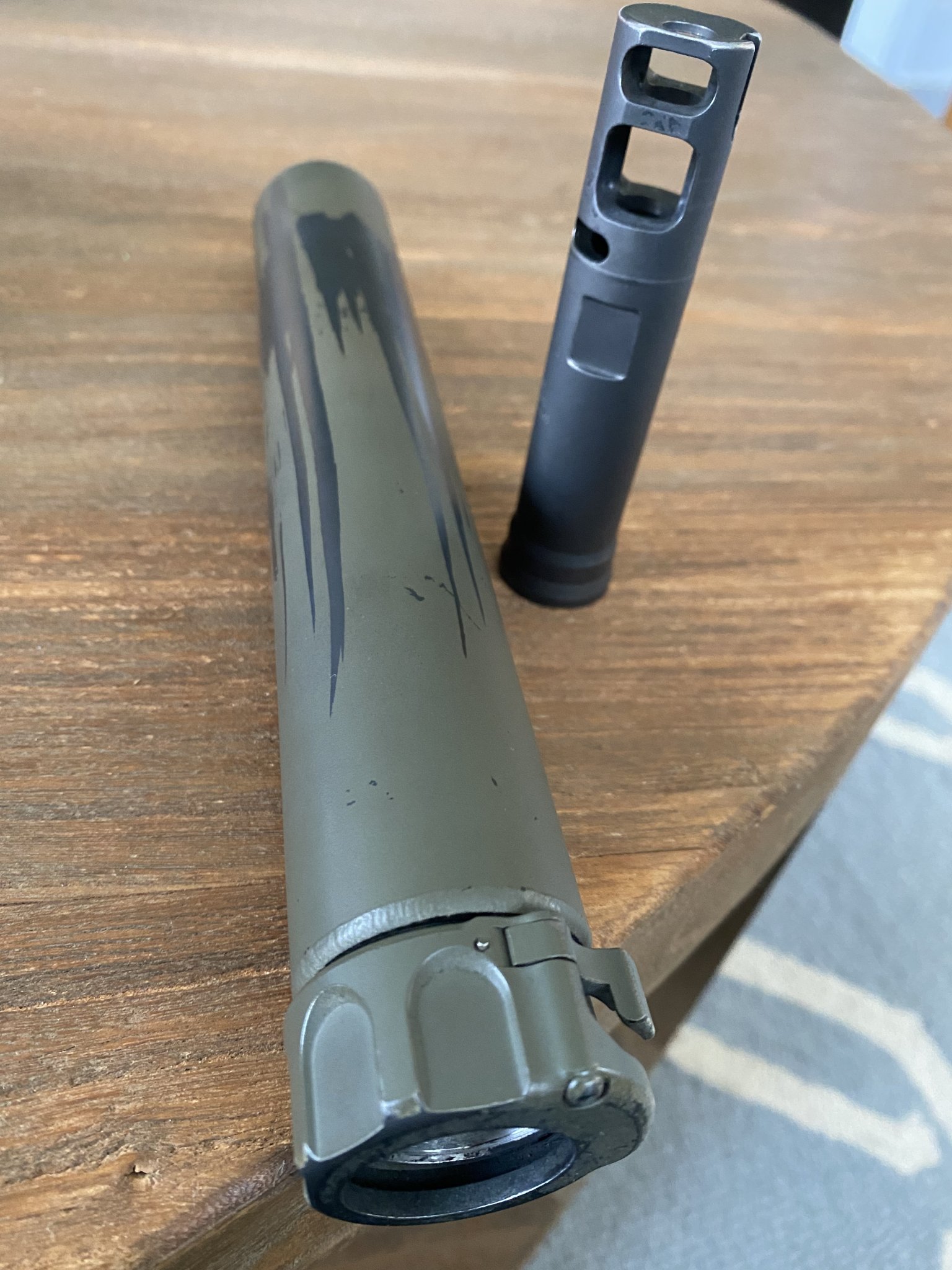

Hello everyone! I’m new to the gas precision rifle game and I’m looking for good AR10 precision barrel recommendations in 6.5 creed. I want to be able to have it machined so I can throw on this legacy Surefire break and can. Price point is not an object. Thank you in advance for all everyone’s help!

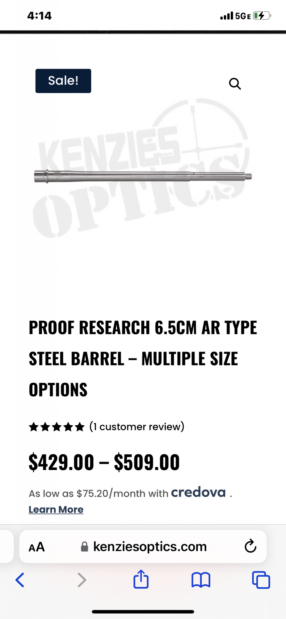

This looks like a good deal . Dont to know how to post links but I’ll post a screenshot.
20” is $429 free shippingView attachment 7977905

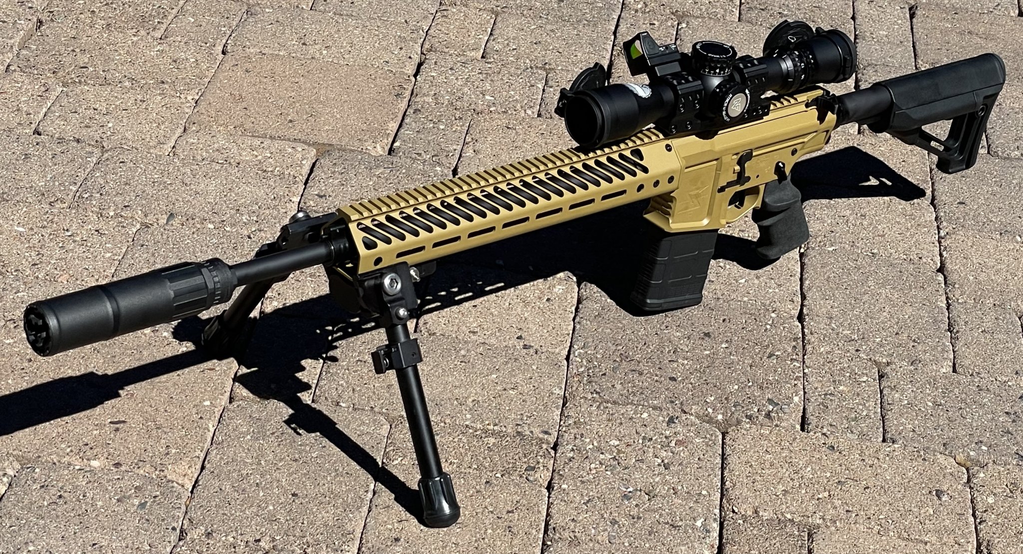

I almost forgot to get back with you on this. It takes 3.0 mils to 500 yards. I haven’t shot this one past that just yet to figure out the true velocity and it may change as I get more rounds through it. I just recently got this one together. Some of it would look familiar to you.
That's one I wish I'd kept. I just picked up a SP10 with a Proof 24" barrel. Just curious about the velocity difference from 20" to 24".
JBM calculation puts it around 2700. Not too bad for a 20" barrel.
That should be just over 2600 fps with a 140gr eldm in a new barrel. If I’m not working this weekend I will take it out and dope it out to 900 and post back here. I’m loading about a grain less than what I usually do for my bolt gun. I could probably bump it up a bit but the last few fps isn’t worth chasing to me.

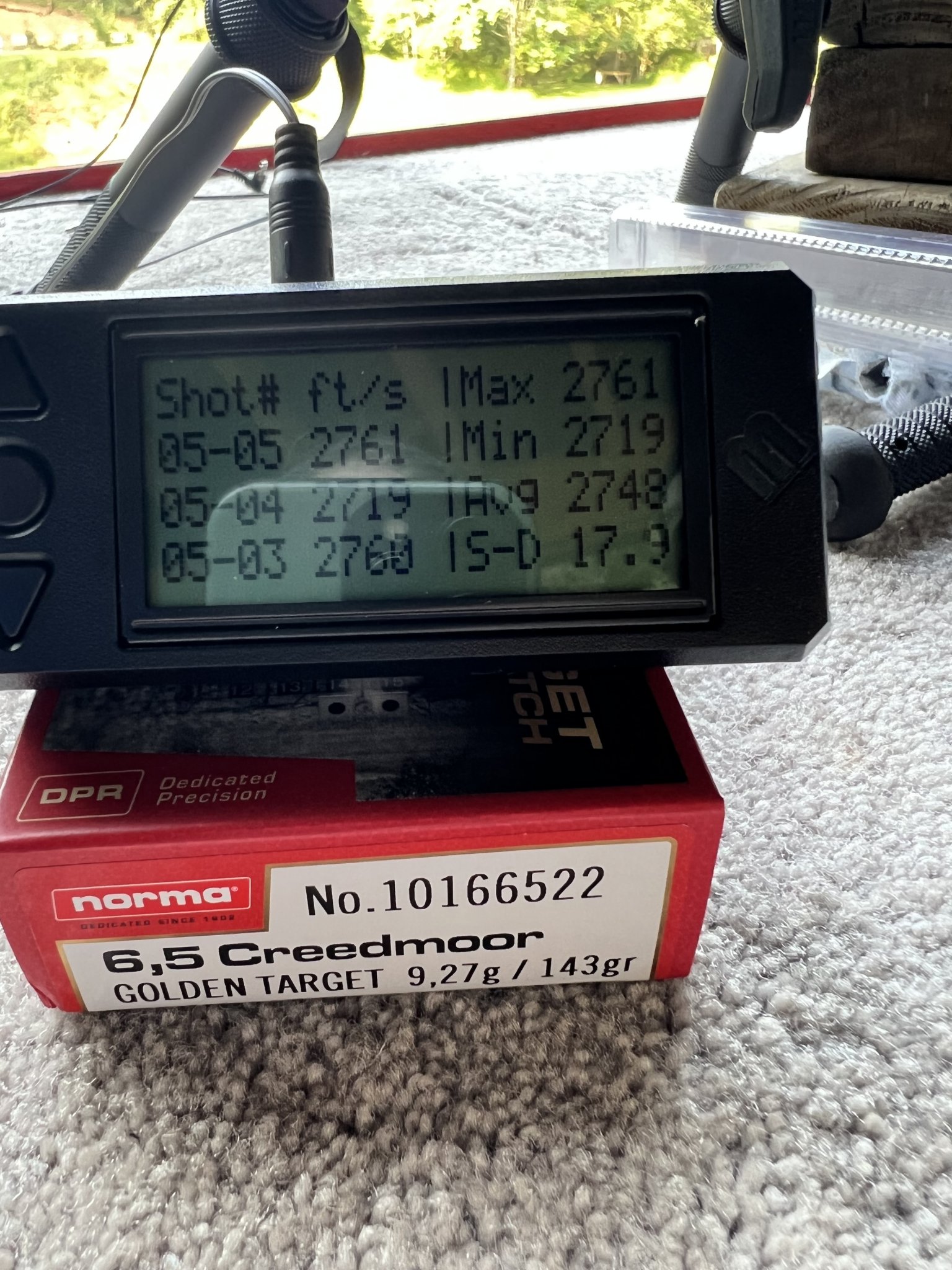

How does that Norma 143 shoot, I've been looking at that lately.
I took it to 1040yds successfully, just a little slow out of my TRG is all.
Pictured figures are at my local DA in late summer with a factory 26” barrel (bolt gun). Trued down closer to 2675 in the ballistic software to match up with actual shooting. Same lot was 9.5SD and about 25fps faster out of one of PVA’s 26” barrels (bolt gun).
I figured it might be a little slow, but if SD and ES are decent enough, the price is right on that stuff, especially for gas gun fun
