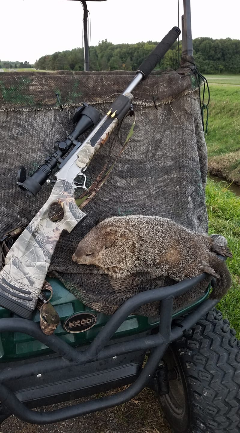

Threaded this TC 223 barrel for a customer a couple years ago been smoking chucks ever since . The barrel steel is strange hard to get a nice thread on seems to tear not cut .
Thanks for the input. The smith mentioned the barrel material itself being a bit wonky to work with. He mentioned talking with S&W about it and it seemed to come down to the way they treat their barrel steel... but that level of discussion is beyond me.
