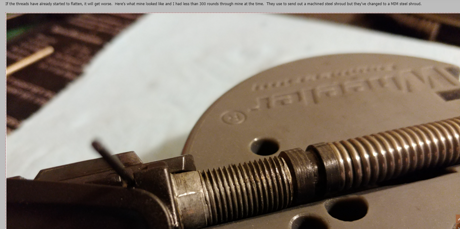

I've never removed the extractor, but per this thread, looks like you just tap it out also:

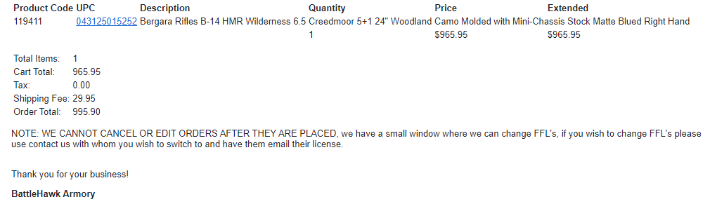

Sounds good. The Wilderness looks like the winner more and more, and it still meets the 1K budget.

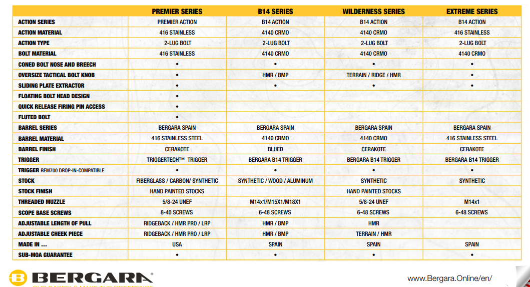

1. Area 419 will substitue the full slotted version (I prefer the full version as well).
2. Wilderness uses the same #6-48 screws as the B14 HMR. See the table below.

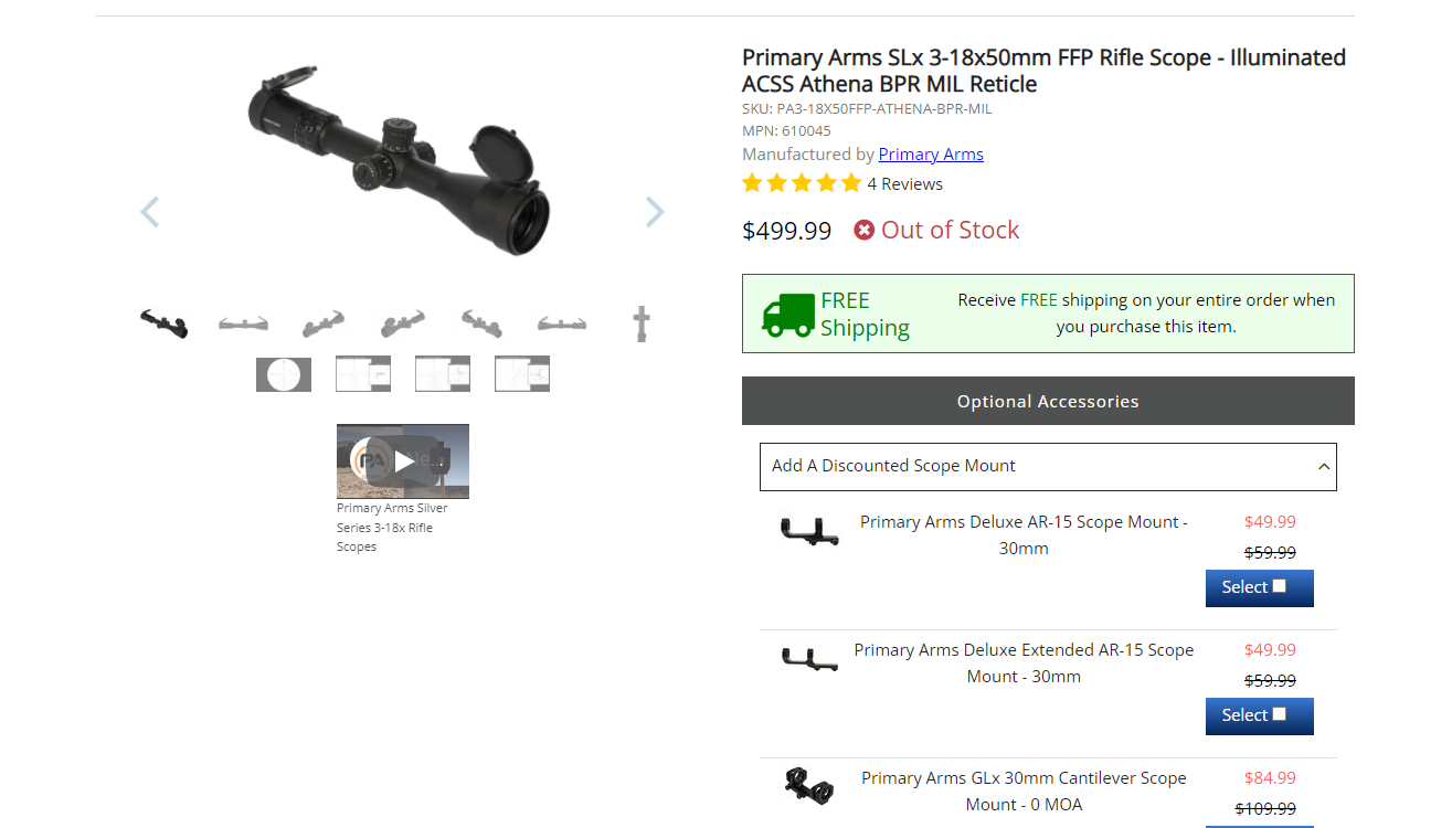

I plan to use PA's 3-18 scope for this bolt action. I have used PA scopes in the past (4 of them for AR, AK, Tavor and GalilAce). Extended scope mount was used. For the bolt action, I assume extended scope mount will push the scope too far to the front. Will the cantilever scope mount work (third one on the bottom)? I don't want the seperate scope rings.

Not sure of any changes to the bolt shroud other than changing the material from some type of pot metal casting to a
steel casting.
Disassembly should be the same.

Yes. I just ordered the Wilderness version. It is at the point of no return now. Hopefully it works out.
My guess is it will be very dirty inside your HMR Wilderness bolt. Let us know how it works. It could have an impact on reliability and accuracy.
