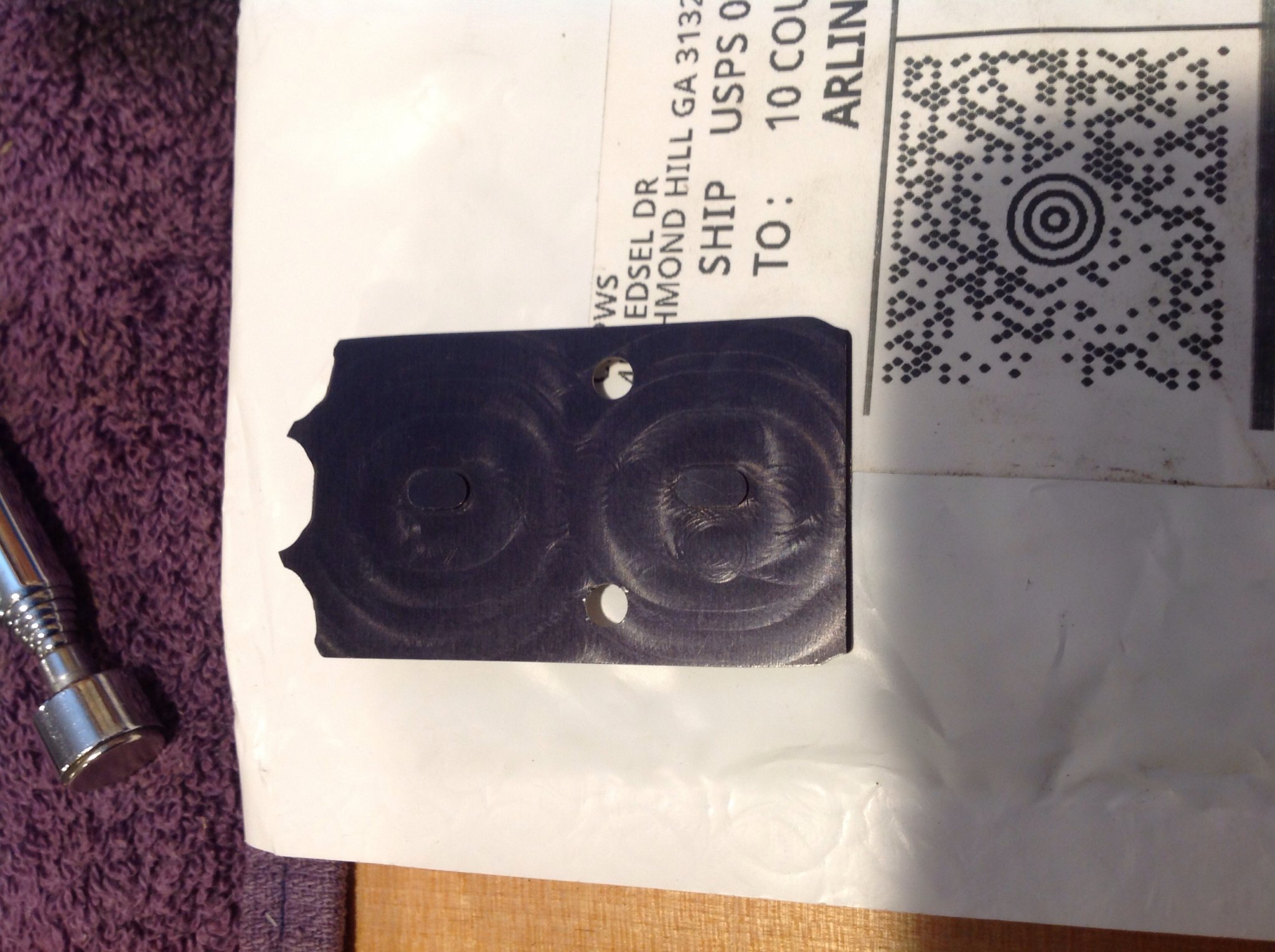

Got the CHPWS plate.
Plus side....
It's thin which is desireable to keep the RMR as low as possible.
It has bottom recoil lugs that fit into the slots for the DPP/Romeo install.
It sounds like metal and appears to show some silvering like it's metal so light though I'm thinking its plastic. The machining marks make me think it's printed or something....it won't attract a magnet.
The down side

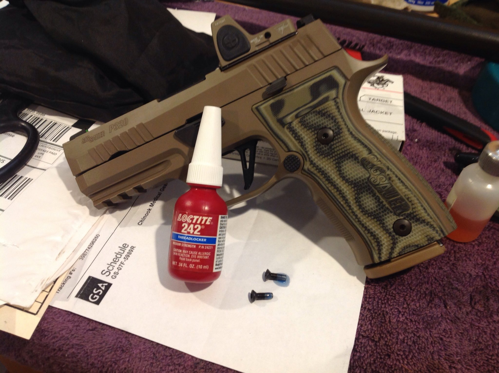

Looks like my Vibra-Tite blew up n shipment...
Would have used my own Loc-Tite anyway.
This is disturbing though
The plate is slightly longer than the sight cut. A couple passes over a stone would likely custom fit it. Almost as if the FDE cerakote was not taken into account.
The surfacing feels reasonably smooth enough that a good gasket seal should be obtained on the RMR. As the actual Trijicon moisture seal appears to be of similarly thin material it may not be bad practice to use it with this product.
My other option is the Trijicon part which looks thicker and utilizes a set of screws to secure the plate to the gun, than a set of screws to secure the RMR to the gun.
Any engineer thoughts regard this?

Well, didn't get too deep into that "CHPWS sucks" thread, but think you should call 'em before you take a stone to that plate if you might need a refund... and please be sure to save any entertaining future texts for us.
Truthfully, my sole experience with CHPWS went ok in that they had a suitable plate for my S2/SRO setup when everyone else was sold out, and it's been fine for nearly 2 years and ~10k rounds, so I've got no complaints.
That said, there should really be no need to have to go to CHPWS or anybody else really for optic plates for these guns, you would think the firearm maker's and optic maker's would've had this stuff worked out before their models were released...

Yes Im not doing anything to the plate and have sent them a picture as posted here.

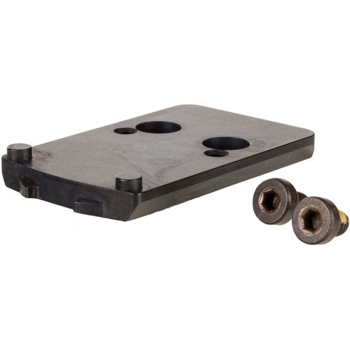

This is the Trij option...
Will result in a much higher installation but looks like a solid plate.

It'll be little higher, but it sure looks a lot more robust. Is it needed? IDK.
If it were me, if that plate wasn't very expensive and won't kill you to chuck it if it doesn't work, if everything looked like it was going to fit up nice once you fit the plate a little, I'd go for it with the CHPWS plate.

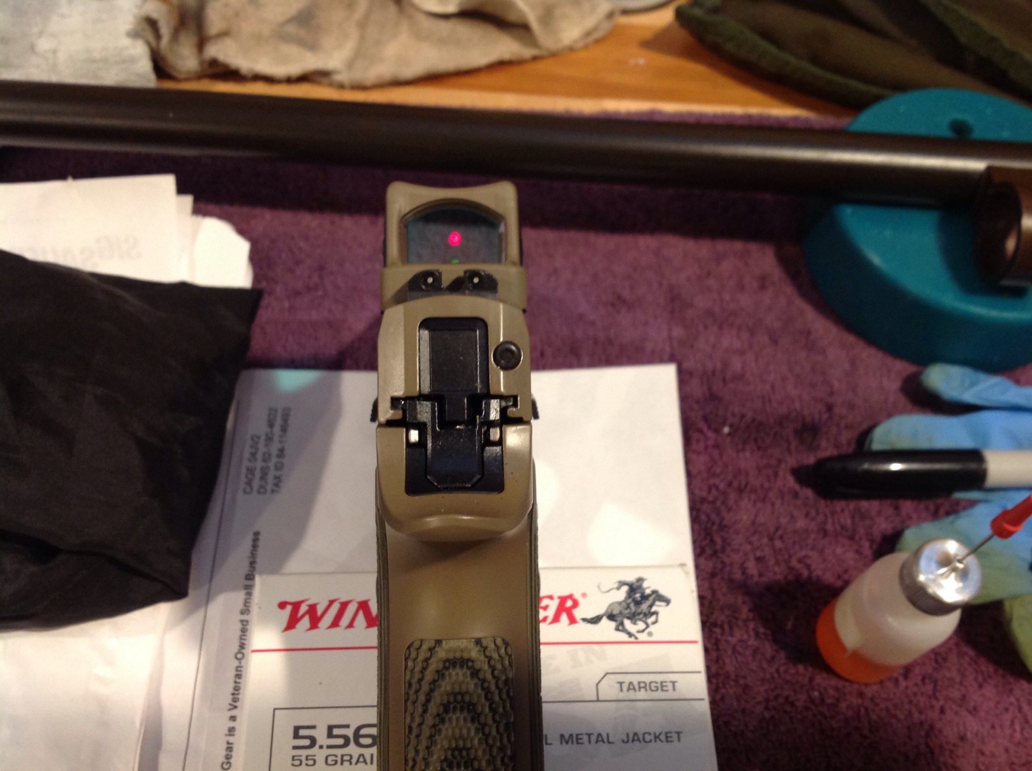

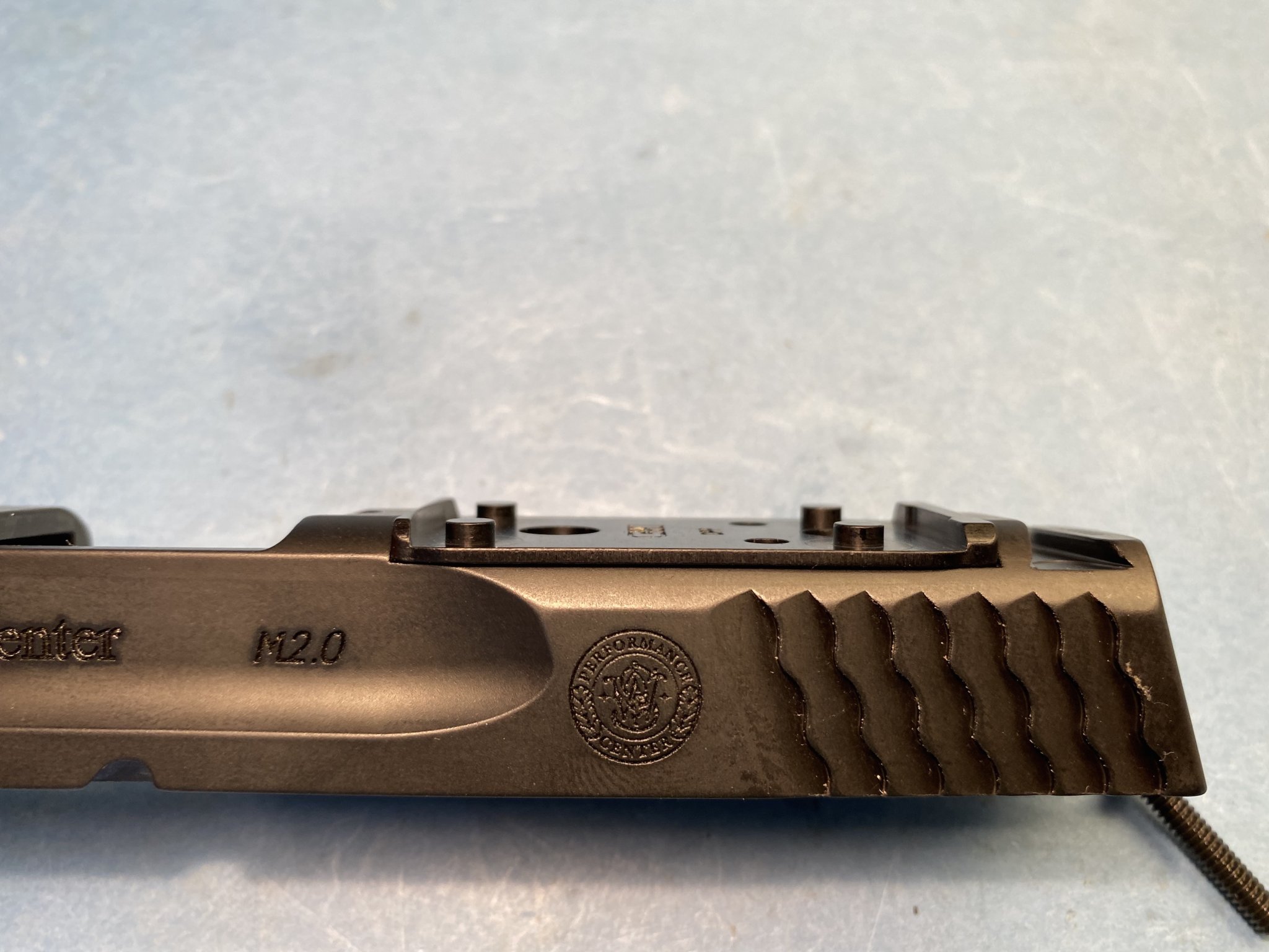

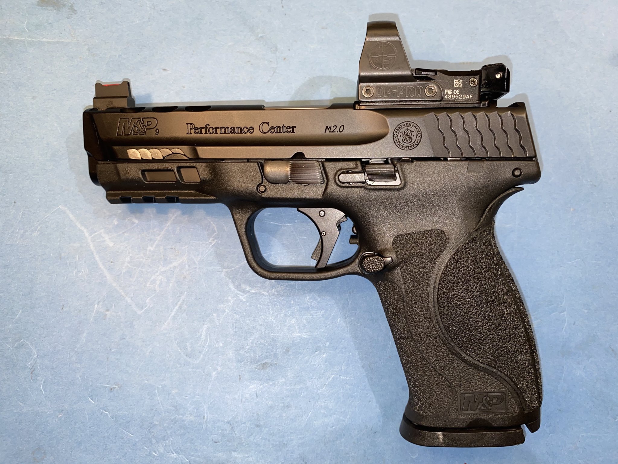

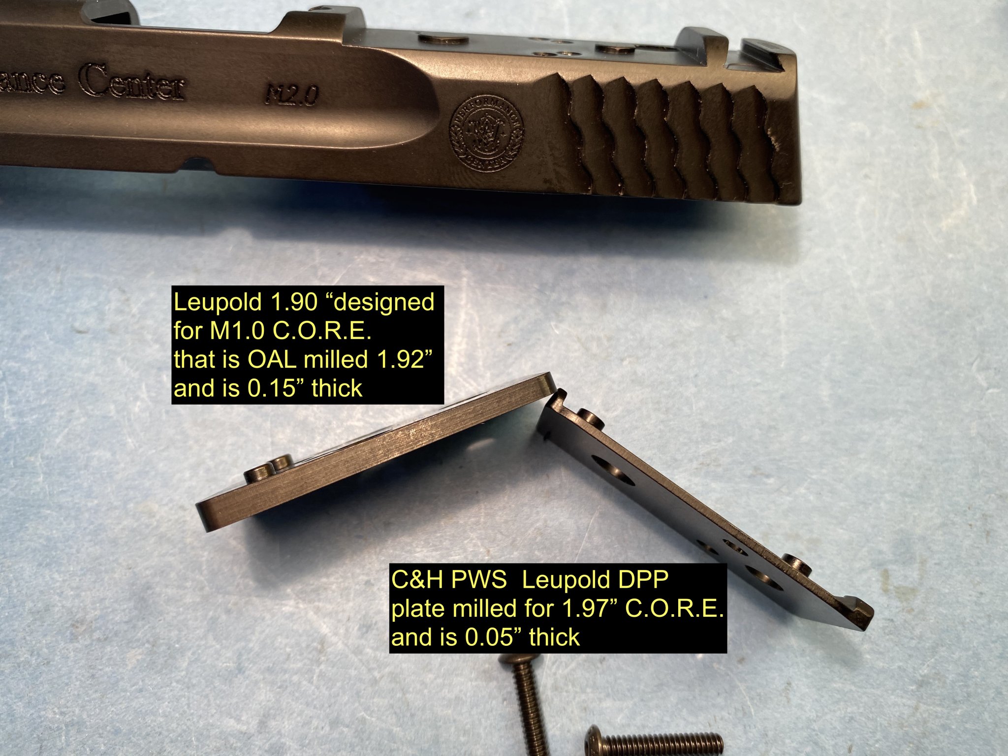

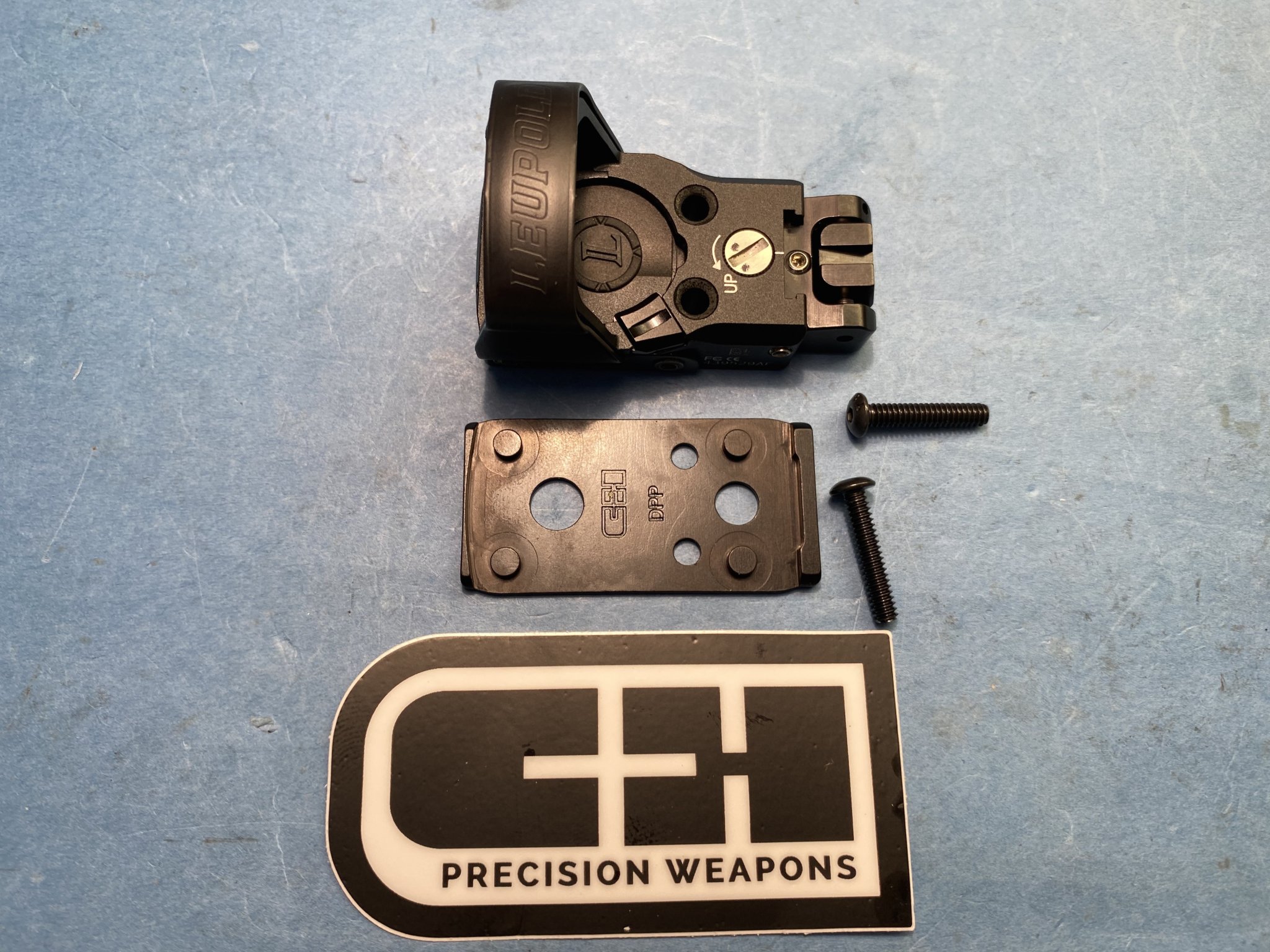

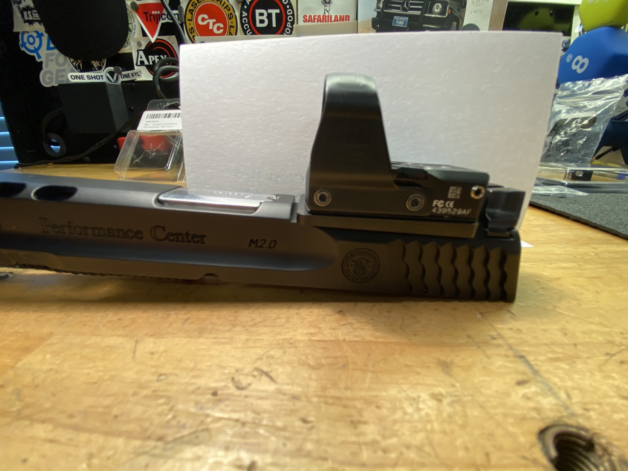

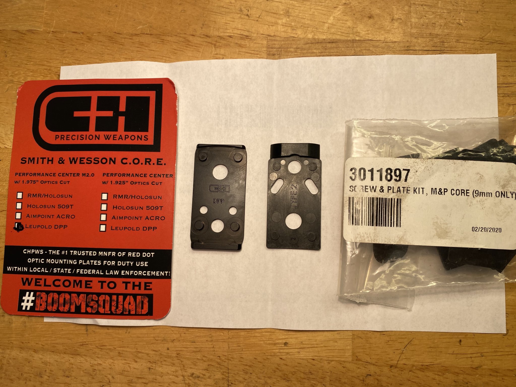

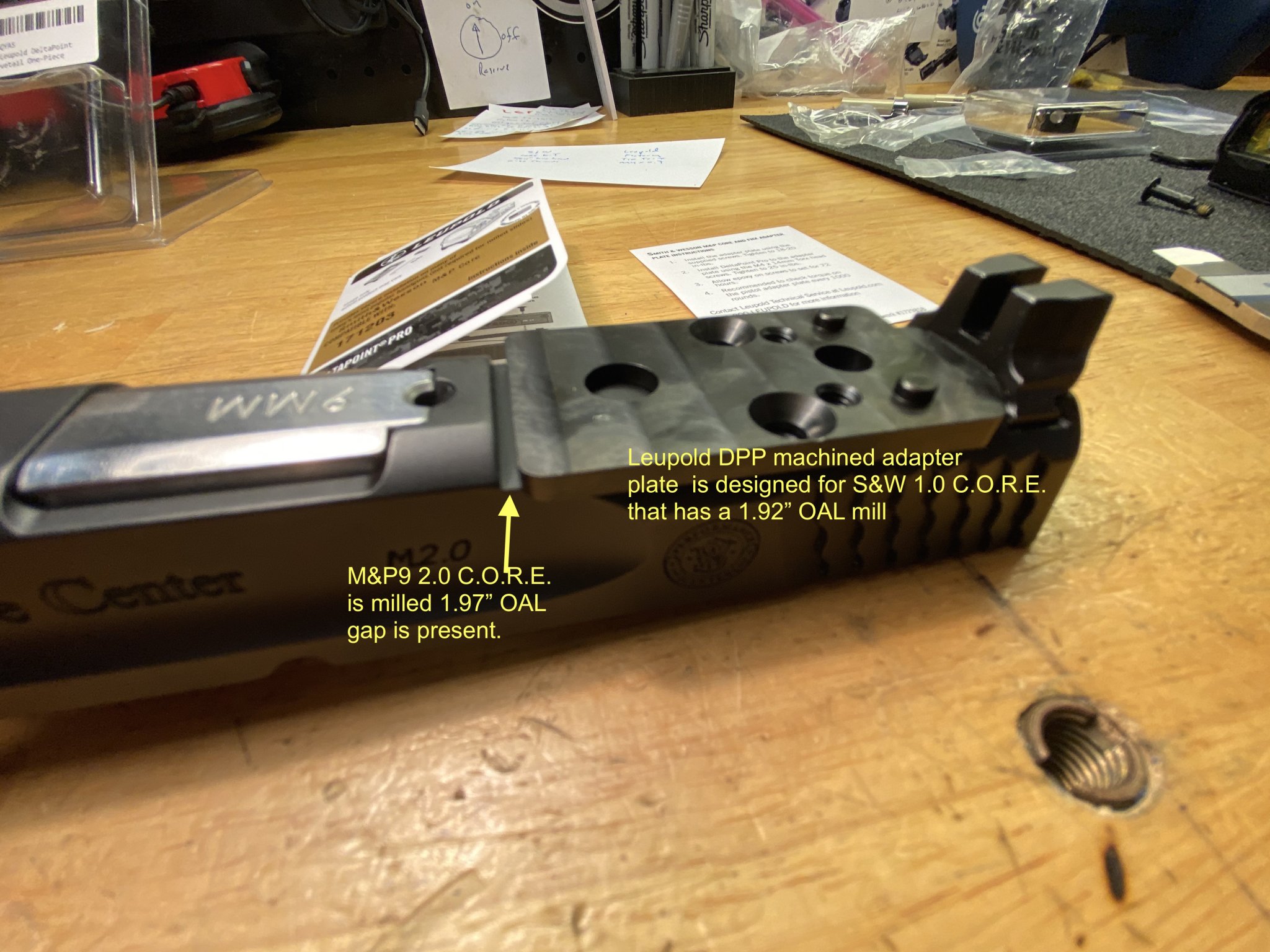

I chimed in on the other thread that trashes CHPWS, to report my apparent anomaly good experience installing their plate for
a S&W M2.0 PC CORE, as the existing Leupold plate was not designed for the 2.0 PC CORE. I think I took some dings on that that for
disclosing I had to "lightly tap" the plate into position, since it looked a little like your situation. Nonetheless, the final result was a very snug and satisfactory fit for the Leupold DPP.

@ Pmclaine.."all in the just exactly right places to give it that pugnaciously forward-leaning, eager look"
My 9th grade Latin teacher, Ms. Crofton, always said I was "pugnacious" , usually when I was leaning forward on my desk wildly shaking my hand to answer her questions, however she conceded to change her opinion IF I could properly conjugate "pugnacious" in all five derivatives.
disclosing I had to "lightly tap" the plate into position, since it looked a little like your situation. Nonetheless, the final result was a very snug and satisfactory fit for the Leupold DPP. View attachment 7671565View attachment 7671566View attachment 7671567View attachment 7671568View attachment 7671569View attachment 7671570View attachment 7671571

A light hit with the file/stone may be all its needs but it shouldnt need that.
The plate is more like a steel gasket. Im loathe to pressure it into place in case it bends.
Can't really tell but it appears the rear edge is hanging up on an overhanging edge? Did you try putting the rear edge in first?

Stone it to fit and screw everything up together. Throw the VibraTite in the trash and use a proper threadlocker.
The plate is aluminum. Yeah, aluminum that thin weighs nothing. It's not printed, those are end mill marks. Don't even need to "refinish" the edge that you stone to fit it. Bare aluminum turns to aluminum oxide fairly quickly. Unlike iron oxide (aka rust), aluminum oxide is passive and once it forms a layer over bare aluminum the corrosion stops.

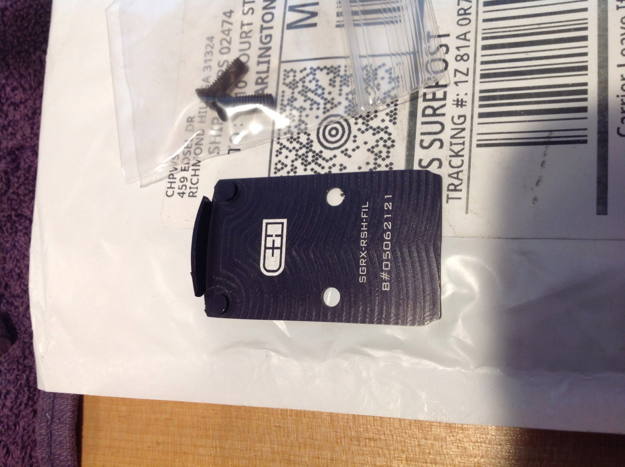

Been following that and Im in agreement something is amiss with that company.
They do seem to have an attractive solution for mounting to my specific gun.
Their plate incorporates a small filler to ensure the optic is secure against steel fore and aft.
Because the filler also follows the contour of the optic at the filler there is also some lateral security, perhaps 1%, but the screws will be doing the heavy work if there is any side impact. They also have the "teeth" that fit into the recess at the front of the slide optic cut - a little more security.
And.....their solution includes lugs to fit into the recoil recesses on the RMR.
I think this is Trijicons solution for mounting on my pistol....
The good is that Trijicon is not the shitshow CPHWS seems to be, their design incorporates recoil lugs for the RMR, The plate is bolted to the pistol using the DPP bores in the slide, than the RMR is secured, I assume, through the plate into the slide. They incorporate the "teeth" to bite into the front of the slide cut.
Searching through the internet I have seen reference that Sig and Trijicon reps (ie the guy at the counter) have recommended CPHWS in my application.
Sig/Trijicon need to come together develope a solid solution but I guess they are competitors with different concerns regards what optic to use.
Front part has "teeth" that fit into a recess at the front of the cut. Front has to go in first.
I've fit worse fitting parts.

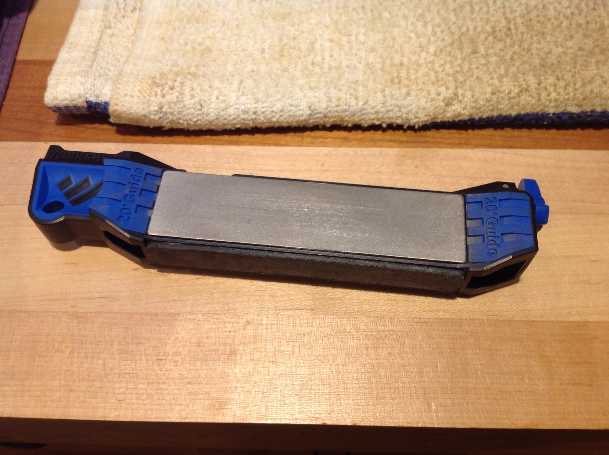

Reply from CPHWS....
Phillip,
It looks like the plate is just a hair too long. If you are able to file the plate down, that should work perfectly fine. If not please let me know and I can send you a return label to send that back to us for an exchange
Response...
I agree it is a hair too long and not a fatal error.
I will stone it slightly to fit on a fine diamond sharpener.
The part is so thin I did not want to force it unless you were to reply "That's normal. Flex it slightly and let it "snap in""
Thin is a desirable feature for this product but in this case I would make the plate a couple hairs thicker.
I really like that your design is unique in including a filler piece forward of the RMR and that it incorporates recoil lugs top and bottom.
A bit thicker than a double edge razor blade and some cleanup of machining marks it would be spectacular.

Its a great design for including that little wedge to fill the open slot at the front of the cut to secure the optic front and rear.
Trijicons block is thick, probably would occlude the sights I plan on using and it puts all the force on the little hockey pucks and the screws.
If you get your hands on one though, seriously, a double edge razor might feel stronger.....
PS........just measured .024 thick. Half the thickness of strikeeagle1 s plate pictured above. Like I mentioned I consider it more of a steel weather gasket to mate with the rubber O-ring under the RMR. The hockey puck recoil knobs may be a little taller than .05 but not much. The bottom recoil lugs similar maybe smaller.

Just placed order for CHPWS plate. Please let us know how it goes. Did you end up stoning the plate?
Havent mofified it yet. Wanted to place it under the RMR before I make it "non returnable".
Ill expect it to show an ability to properly seal the gasket, recoil bosses fit reasonably tight, has a general ability to help rather than hinder what I expect it to do.
You buy the extra $15 gasket? I just don’t see needing it.
Nope.
If I dont think the CPHWS plate will be substantial enough I will buy one while at Sig next weekend.
Ideal install is that CPHWS is all that is needed. RMR will be low as possible on slide.
Next best will be sealing plate over CPHWS. Probably be .05 inches with both plates.
Best engineered but highest install will be if I have to scrap the CPHWS entirely and go with the Trijicon plate.

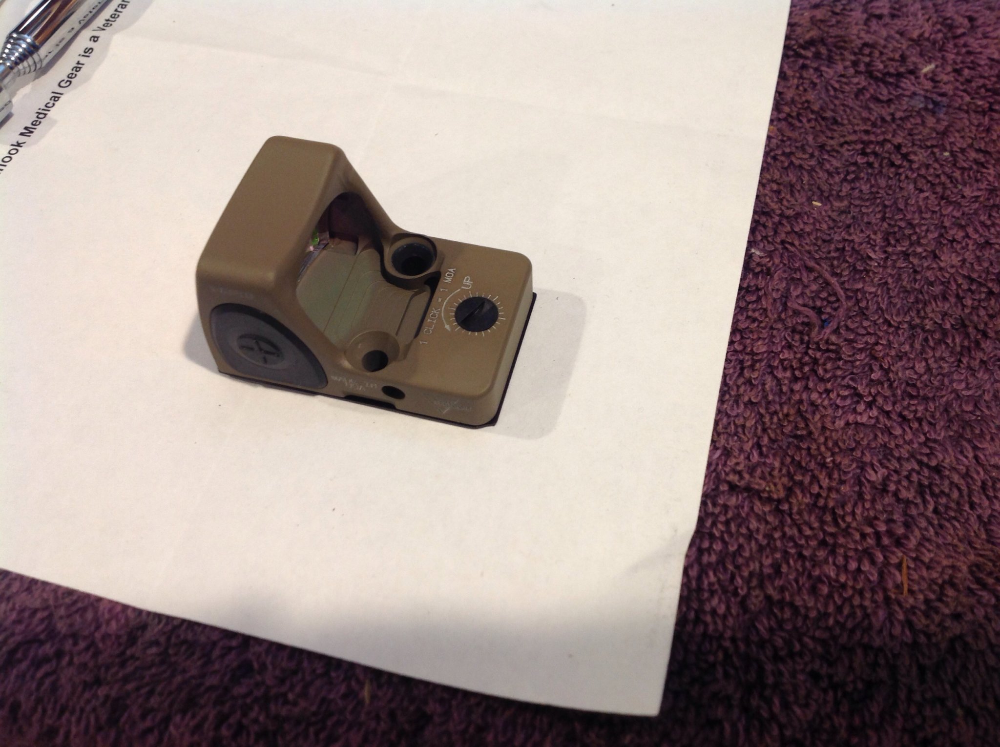

Whew!
There was shit under the foam....
RMR is solid n the CPHWS plate...
I will have to remove some of that black line....
