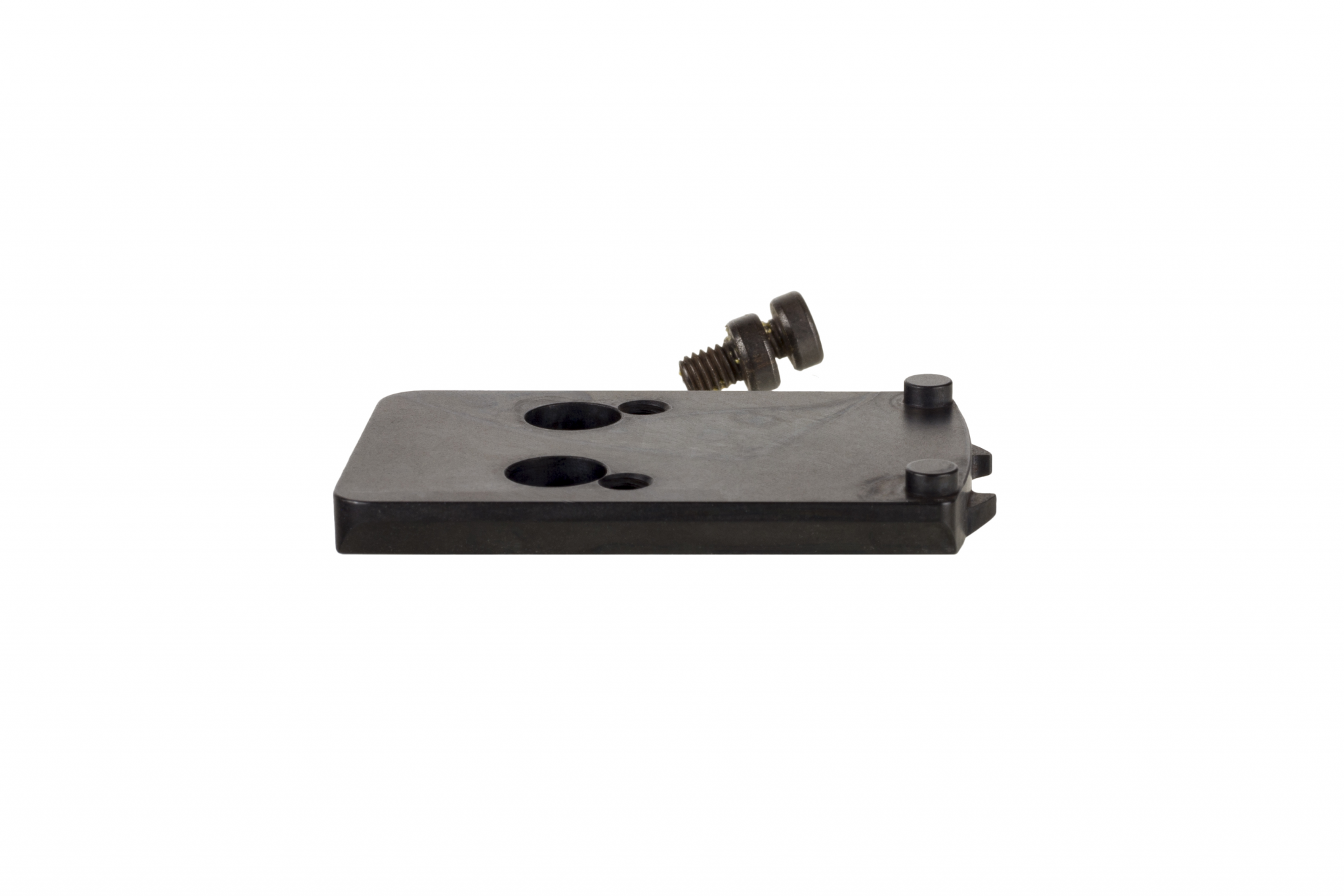

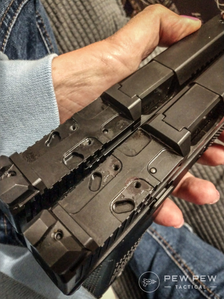

I'd prefer that the mounting surface makes use of the locating holes in the RMR sight body, but the Suarez Glock slide cut is a snug fit to the external profile of the sight body and thus holds it very securely. Either way, I feel that there needs to be mechanical location of the sight to prevent improper loading of the fasteners.
For RMRs, ensure that either the slide mounting surface is dead-flat, smooth, and fully utilizes the seal on the bottom of the housing, or use one of the metal sealing plates.

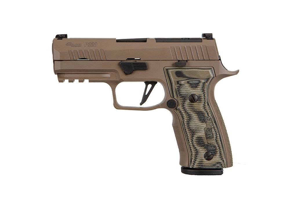

Cost and its foot print being smaller than the slide cut are the remaining concerns.

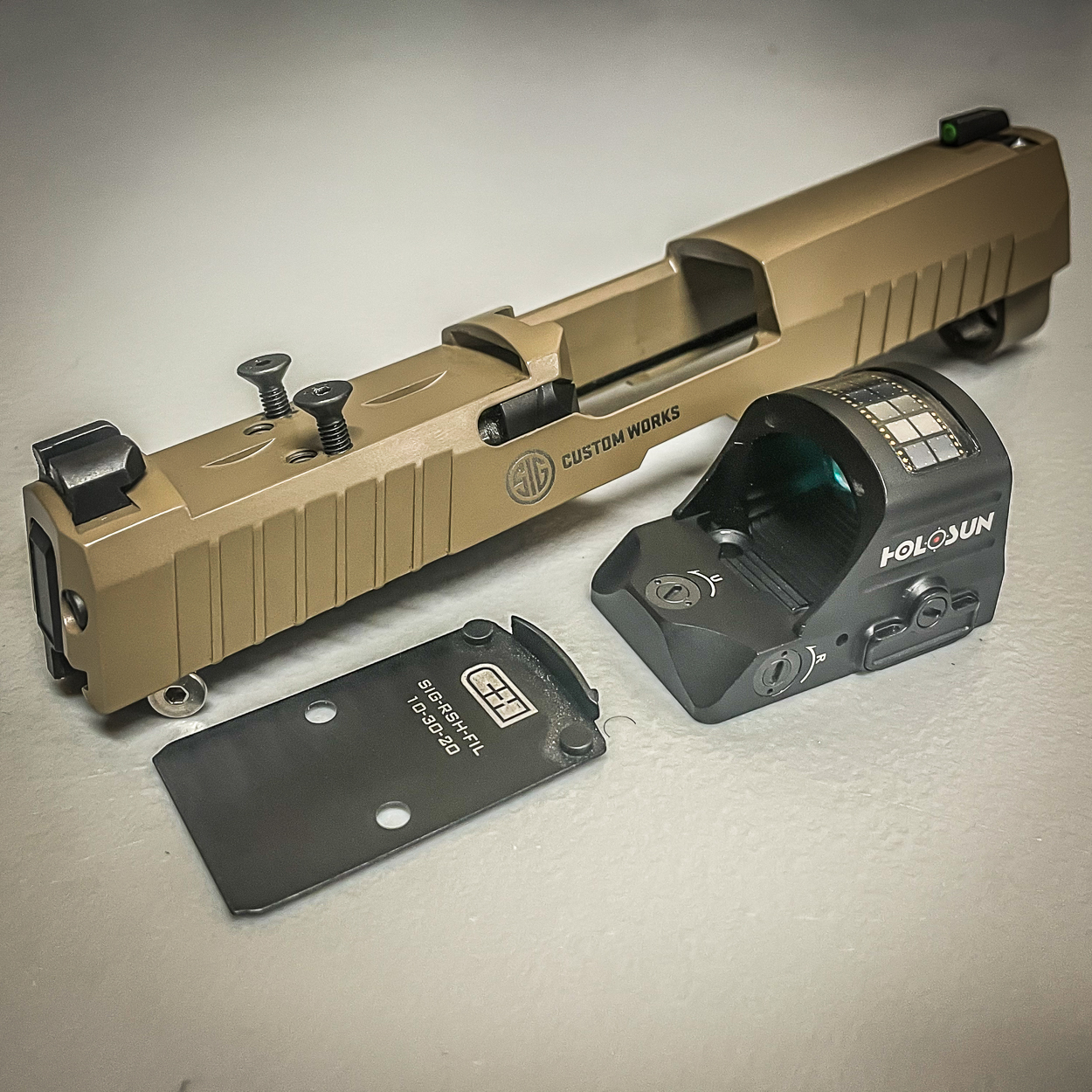

It doesnt look like the Sig plate has any feature to fill the void space and secure the sight from recoil.
The CHPWS plate apparently does but reviews are dismal regards company performance and I watched a guys RMR fly off a CHPWS plate a couple weeks ago.......likely operator error.....he was the sort of guy in class that knew it all.

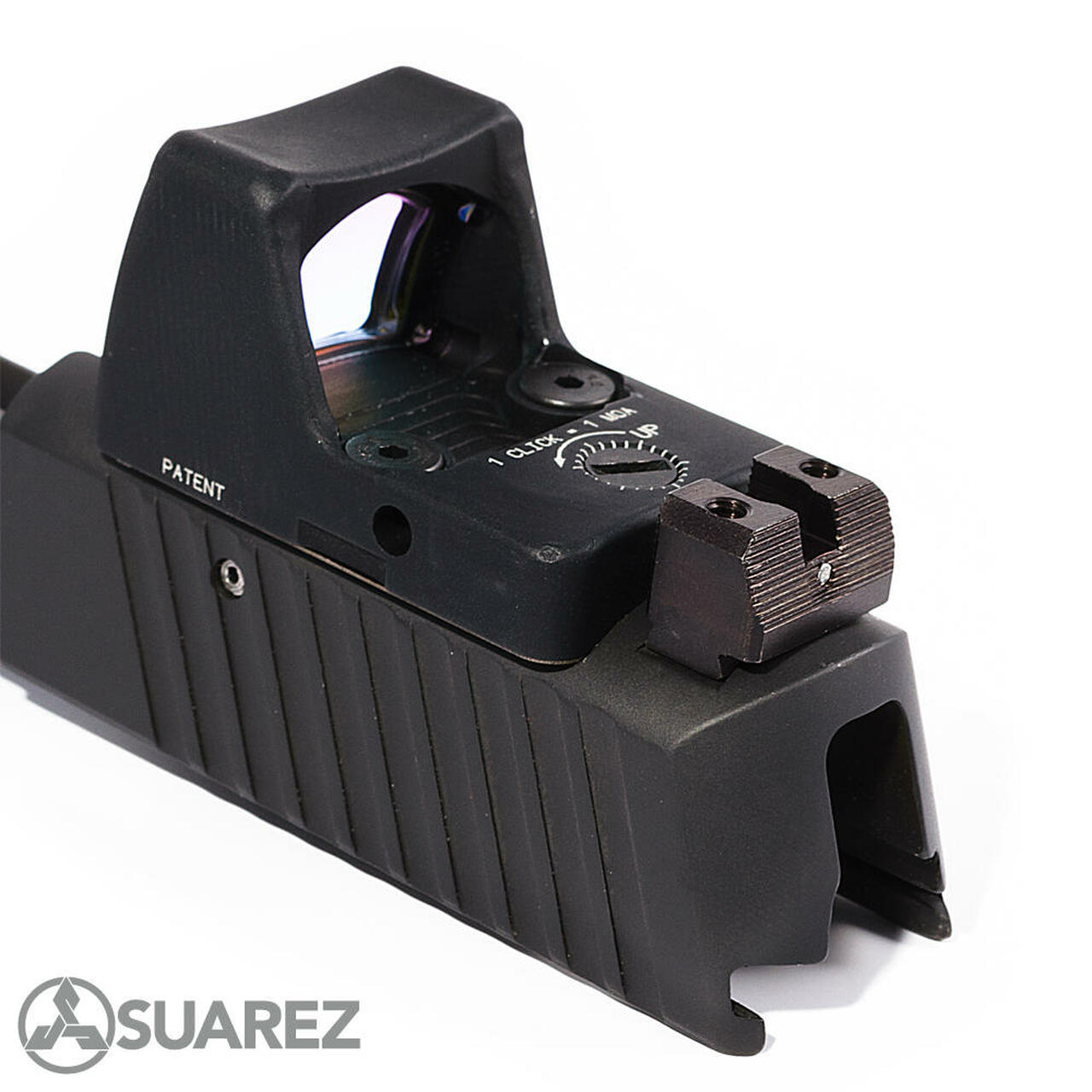

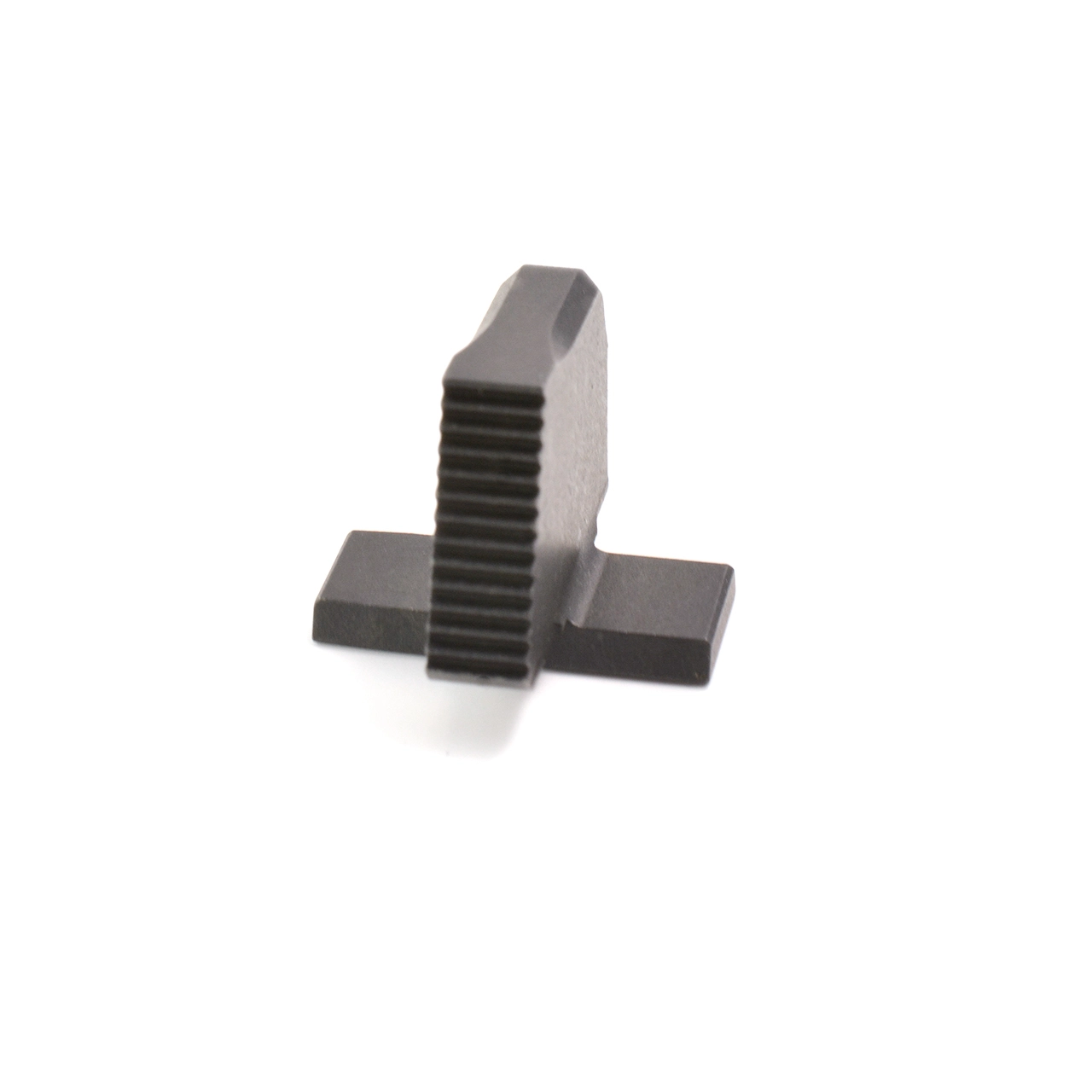

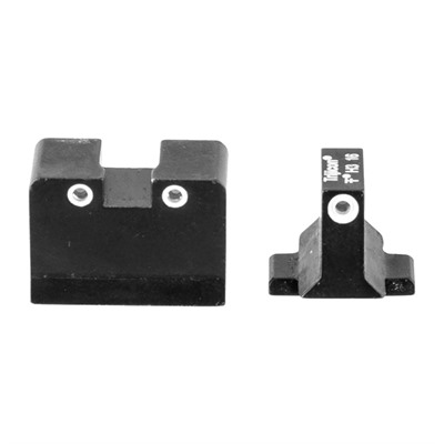

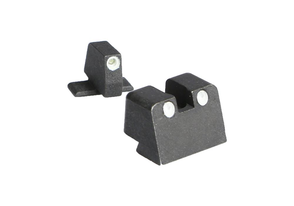

I like the Suarez sights for their lack of any "eye catching" features like tritium dots.
I only want irons as backups not interference to finding the red dot.

I'd happily hand you one of my Suarez-milled Glocks or OE-cut FN 509s and allow you to rack them using the RMR to your heart's content.
It would have been preferable that Trijicon found a way to use 8-40 screws for retaining the RMR, but the #6 screws work fine if there is proper mechanical registration provided by the mount.
Yep, user error. That design is a pass-through that fills the space, and is thin enough to not exacerbate offset moment flopping issues. (Technical term.)
That said, a design with one set of screw holes for mounting the optic, and another set for mounting the adapter to the slide, is extremely likely to be a shitshow.
It may be worth the risk to deal with CHPWS plate to fill that small void when using the RMR....
~Zero risk as long as the plate fits. Even if you weren’t using that plate you’d want to find some way - bedding, for example - to fill the front and rear gaps to minimize component stress from both parts of the recoil impulse.

That's exactly how CZ OEM optic plates work. Yet they work incredibly well.
The reason why is because CZ plates have a cruciform boss on the bottom that makes to a matching recess on the slide and a set of recoil bosses on the top that mate to matching recesses on the bottom of the optic.
All the screws do is hold the plate down. They are exposed to no shear stresses.
Oh and they're steel not aluminum.

If I go with the CPHWS plate the optic and plate are secured into the slide and the plate offers recoil bosses that mate into the RMR as well a "filler" flange to fill the gap between the slide and the optic.
Im thinking my buy will be
1. CPHWS Plate with the 6-40 screw kit they include
2. RMR in FDE 3MOA dot
3. Suarez sights
Got to talk to my engineer to confirm.

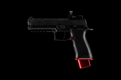

RMR with 6 MOA Dot
Suarez Sights

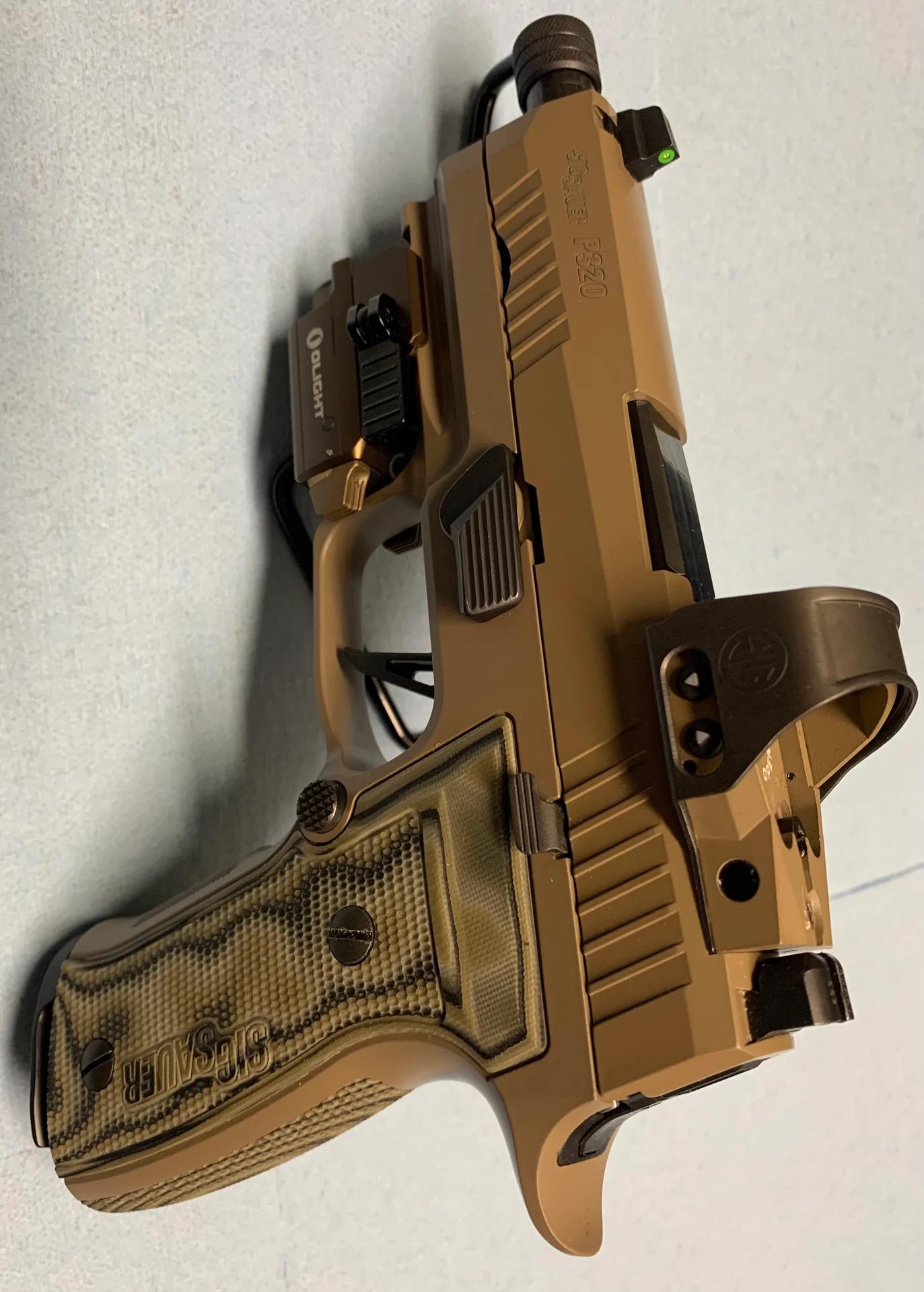

Adapter plate to fit an RMR to the Sig AXG slide.
The last remaining question.....
CPHWS has a lot of features that look great but QC apparently sucks
(Que @redneckbmxer24 for opinion on CPHWS)
Trijicon makes one has recoil lugs but no filler to take up the front gap nor teeth to lock into the slide. Uses two sets of screws - one to secure plate to slide another to secure optic to plate.
Springer Precision makes one.
Bobro makes one. Not really interested in their integrated rear though. Likely only works with M-18/M17 style guns with flat rear decks.

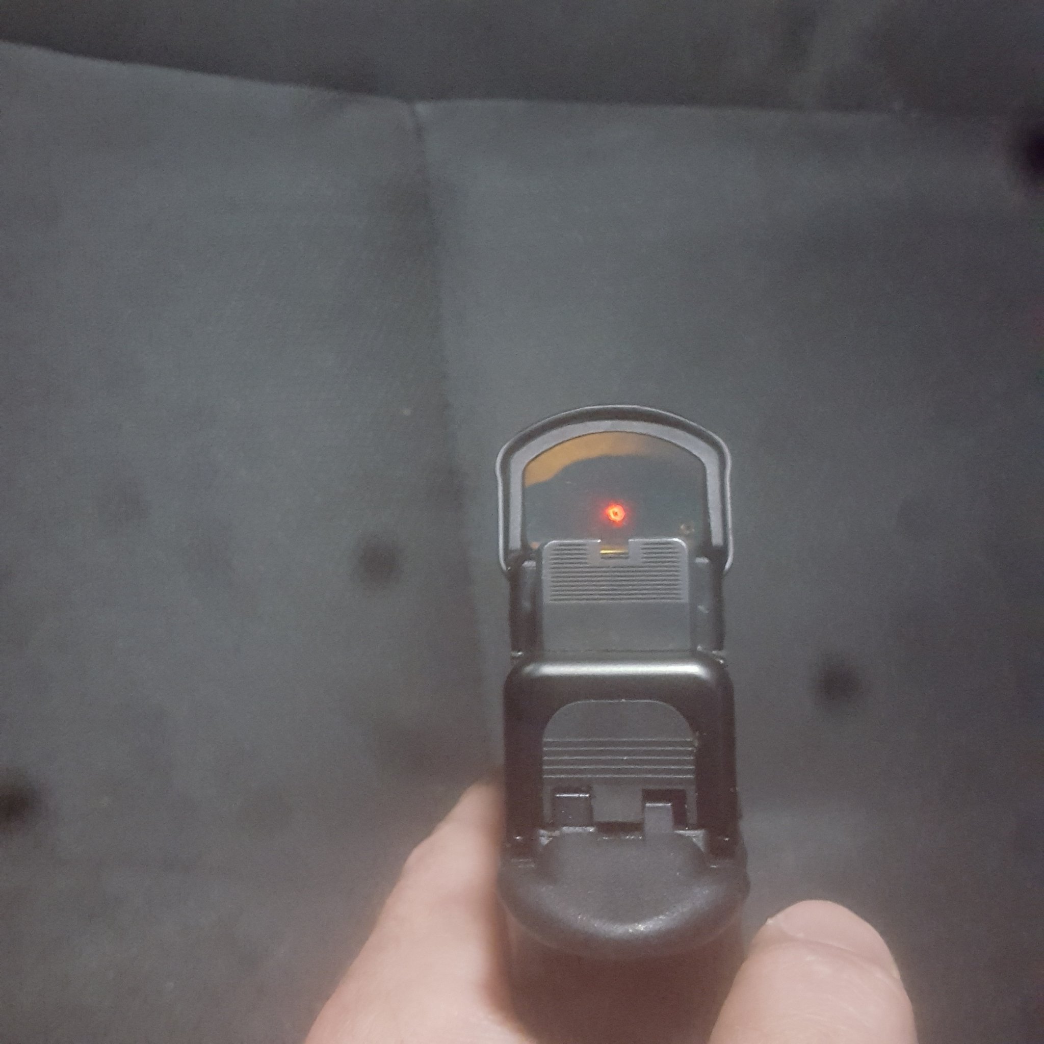

If these pictures are good representations....
1 MOA too small
3.25 MOA looks "Just Right" for a day at the range.
6.5 MOA Looks where you want to be if you want to be fast and might be stressed out and want hits without searching for the precise spot.
For my typical shooting I tend to be the 3.25 guy but Im wondering if I want this gun to be the 6.5 gun. Ive got iron sight guns for when time isnt a factor I guess.
Once again, I'll state that with my astigmatism and corrective lenses, the 3.25 MOA RMR dot "blooms" a bit (although not as bad as with Aimpoints) and thus appears somewhat larger than its specified size. For unknown reasons, the 6.5 MOA dot does not suffer from the same effect with my eyes and lenses, and so the actual difference in perceived dot size isn't all that significant.
I highly suggest putting eyeballs on both options before making a purchase.

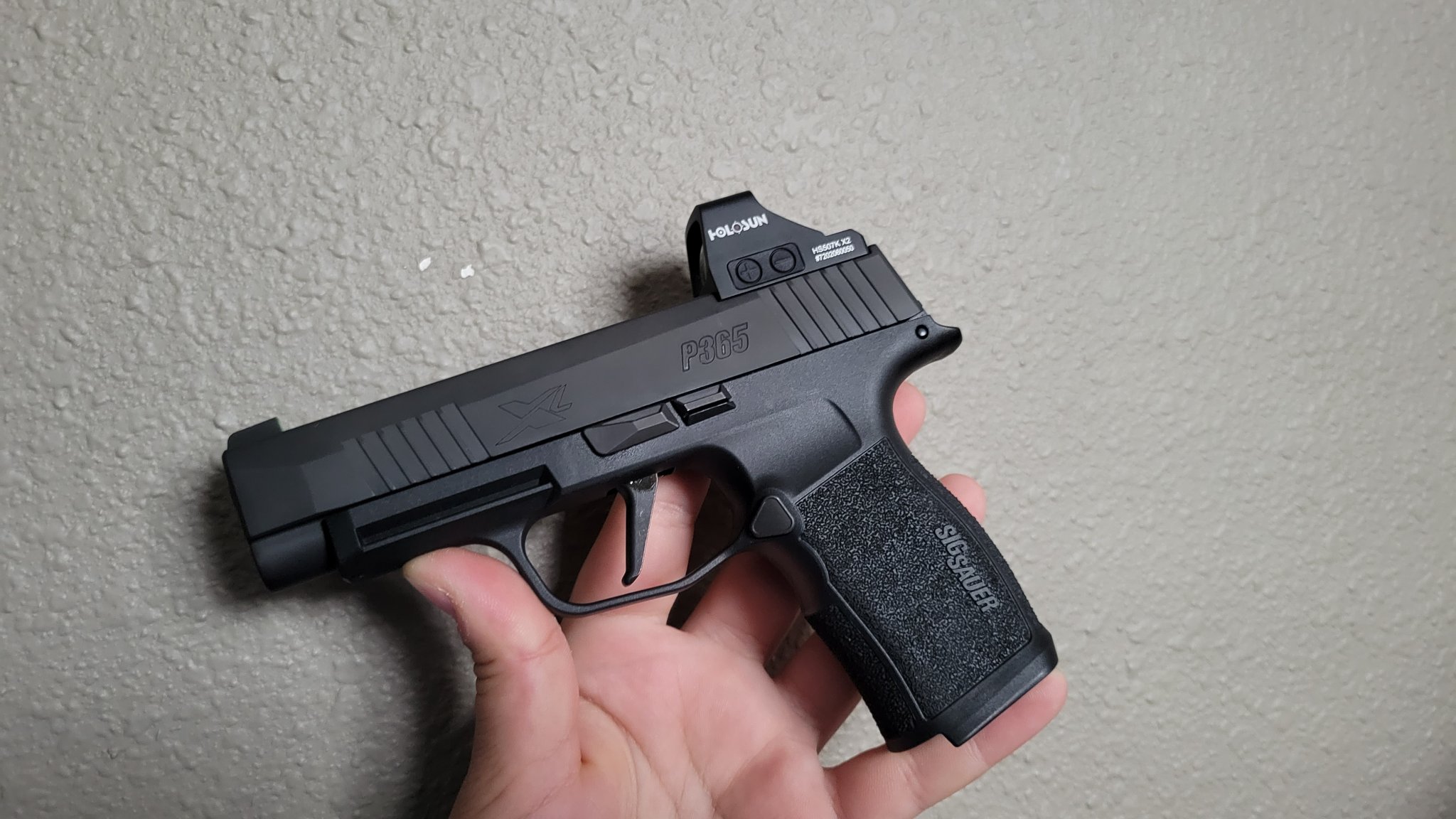

Big fan of this setup-P365xl + Holosun 507k x2. Shoots like a much larger gun.

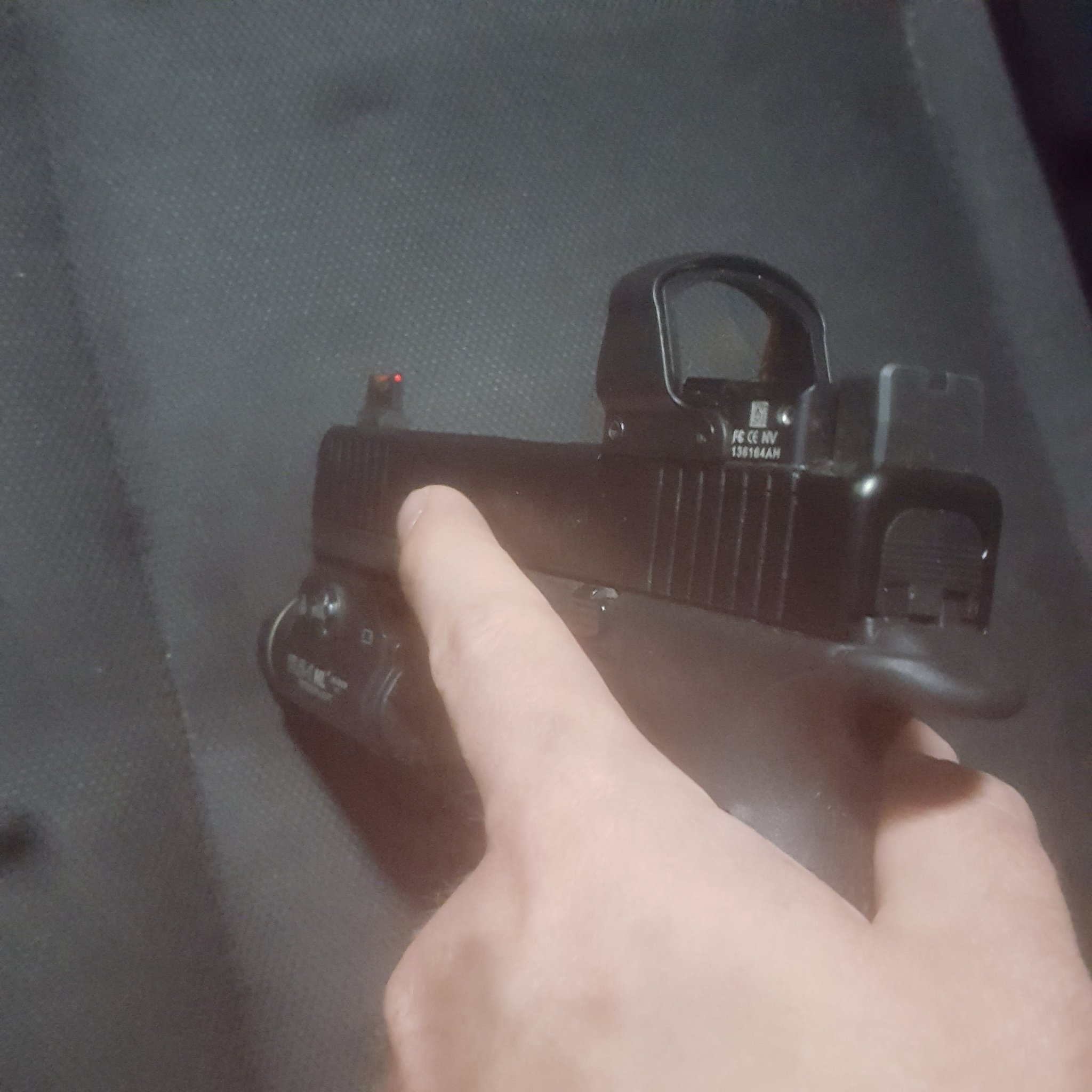

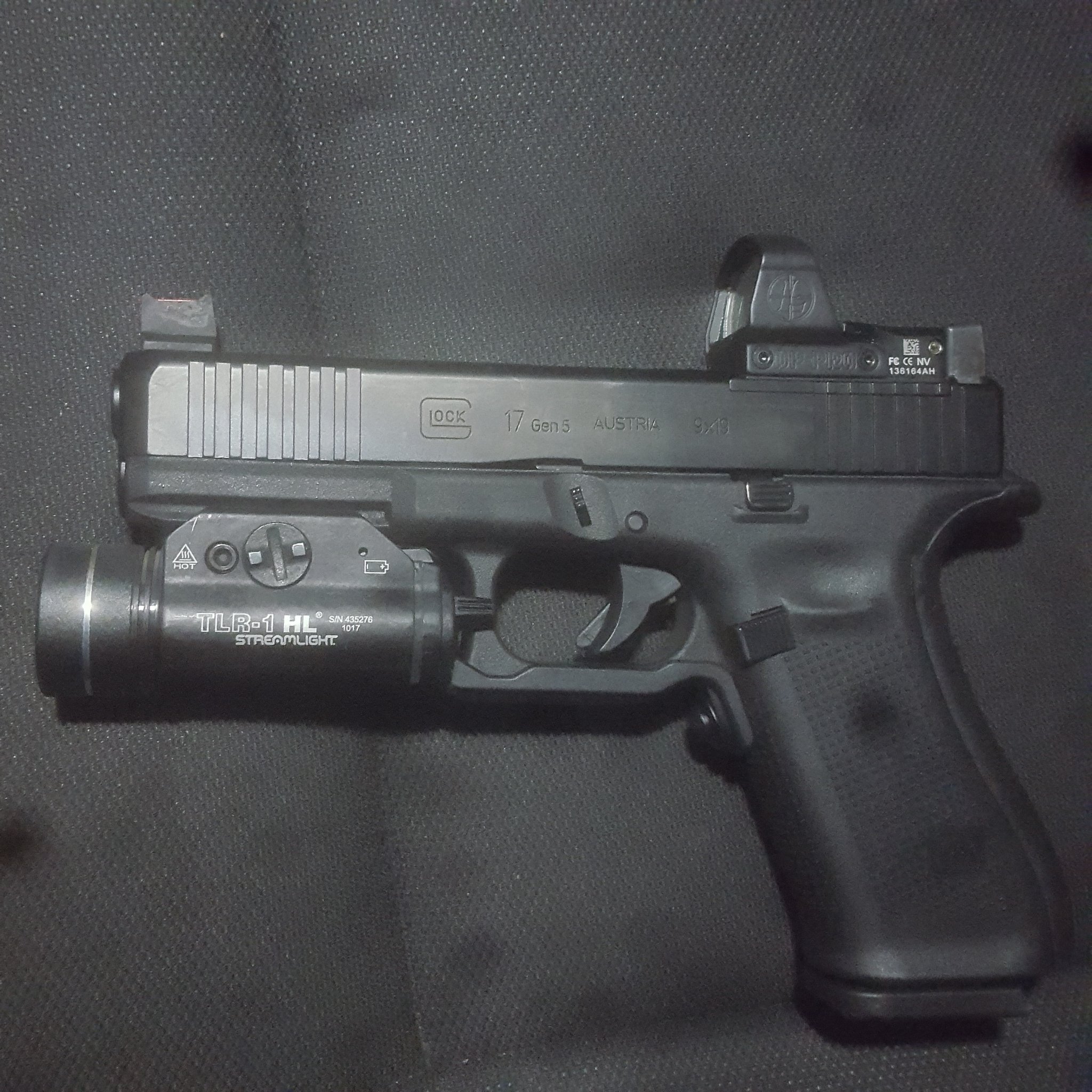

I've been using the Leupold DPP NV on a Gen5 G17 MOS for about 6 months now. I like it a lot. Eats the battery a little faster than I'd like, but that's my only complaint.
Dawson Precision makes cowitness sights that are specific to the Leupold DPP, with factory plates or custom milled slides. Lots of options for height and sight composition. I'd say definitely check them out and see if they make versions for your pistol. I went with blacked out rear sights and a red fiber front post. From what I hear, other officers are happy with the Leupold factory add-on rear sights.
Photos attached, with apologies for potato quality phone camera. I am not kind to my gear.

Im Bi-curious..........thinking of adding a red dot sight to my iron sight inventory.
Just bought this....I want to set it up for training, occasional CC use.
RDS ready and I understand it will have the ability to mount Sig, Leupold and Trijicon products.

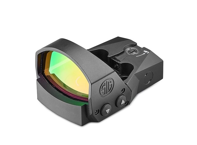

Ive considered Sigs offerings.
The upside...
1. I can get a 10 percent discount
2. Appears dot brightness is adjustable
3. Batteries change topside
4. They appear to back the product with replacement on any issue
5. Looks like its trenched to co-witness with suppressor sights
The downside
1. Lots of people find they need a replacement.

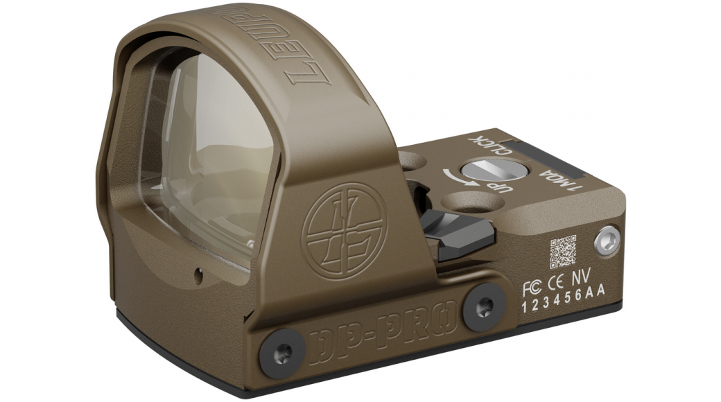

Leupold
The upside.....
1. LEO Discount
2. Parts made in USA
3. Good CS
4. Topside battery changes
Downside....
1. Perhaps I will need their CS at some point.
2. If I want to adjust dot brightness its an extra $100 for the NV model

Next I like the idea of Co-witness sights.
How important is it?
How possible is it?

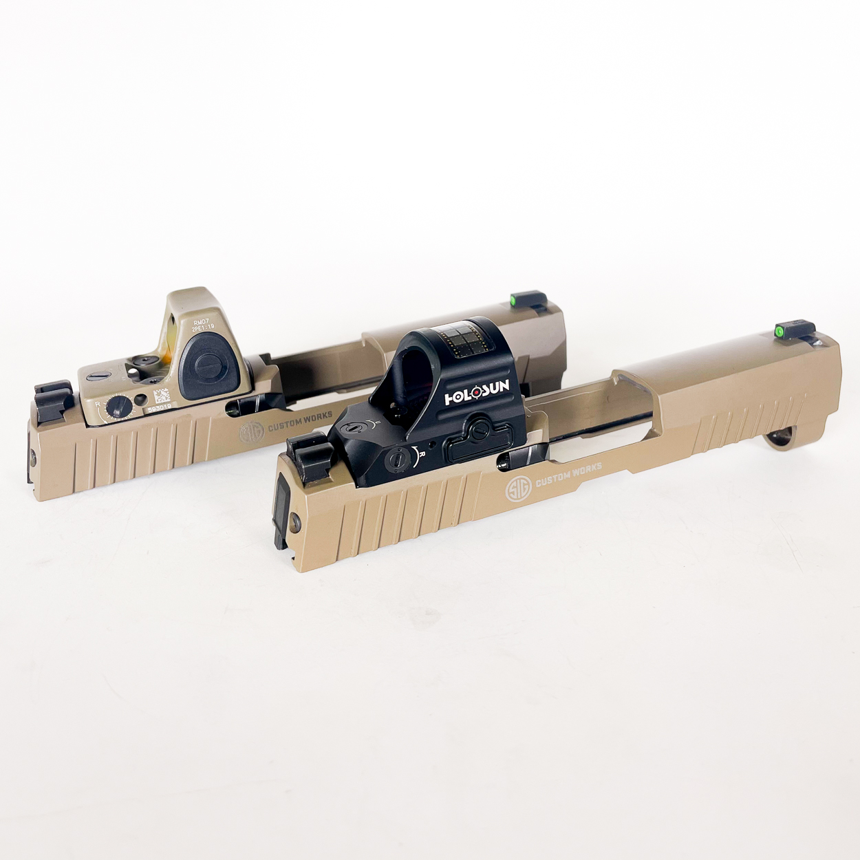

Looks like the housing on the Delta Point will prevent it. The Sig option has a cut to facilitate it. RMR housing looks so low that a suppressor rear will sight over it.
Considering Sigs options....
and judging by this picture appears they offer the X-sight version....
Nice looking pistol by the way....sort of what I have in mind minus the threaded barrel.
The X-Sights and these Trijicons
Appeal to me for the flared base on the front sight.
Im going to shoot the gun for the first time in about an hour.
I may like it so much in its present configuration that this doesnt matter.
Maybe Ill RDS my M-18 instead.
Any experience out there you can help me make my mind up.
Decisions here will decide my holster options.

I think this is Trijicons solution for mounting on my pistol....
The good is that Trijicon is not the shitshow CPHWS seems to be, their design incorporates recoil lugs for the RMR, The plate is bolted to the pistol using the DPP bores in the slide, than the RMR is secured, I assume, through the plate into the slide. They incorporate the "teeth" to bite into the front of the slide cut.
Searching through the internet I have seen reference that Sig and Trijicon reps (ie the guy at the counter) have recommended CPHWS in my application.
Sig/Trijicon need to come together develope a solid solution but I guess they are competitors with different concerns regards what optic to use.
Maybe I could be the guy that uses CPHWS and doesnt get screwed.

And.....their solution includes lugs to fit into the recoil recesses on the RMR.
Im not like other guys........they would have just bought their shit and had a few thousand rounds on their guns by now.
I see now what we were talking about on Monday. Both the CHPWS and Trijicon plates have recoil bosses for the optic. That's the two round studs at the front edge of the plate.
My concern is that SIG did not design a recoil boss into their optic cut for the plate to engage. Depending on how tightly the plate fits fore and aft, the screws might or might not be taking on shear stresses from the plate.
Glock's MOS system makes the same mistake, with a longitudinal boss/recess but no transverse boss.
The right way (CZ Optics Ready plate system). The plates locks into the cruciform boss that takes all the shear stresses in both directions. The milled pockets are clearance for the optic's screws, which thread through the steel (not aluminum) plate.

The most secure way to mount your optic on a moving slide is with a cut to the slide to fit your optic precisely, and not use a plate. Plates are handier and less expensive than getting a slide cut to fit a particular optic. Primary Machine cut my slides and wanted the optic I was using with the slide so the cut and the holes would fit perfectly. Downside is cost and being tied to one optic cut for that slide. I have used their optic cuts in a lot of USPSA Competitions and never had a sight loosen or come off. Size of dot is only one measure. Leupold DDP small dot appears as large as others larger dots because it so bright and easy to pick up. Every dot looks bright in a store, but in the light of a bright summers day it will look different. For competition if I were doing it again I would cut it for a Romeo 3 XL in 6 MOA. I have them mounted on my JP PCCs and my 10/22 I use in Steel Challenge.
I have just over 13K rounds through a P-10F OR and have never had a single issue with the plate or the optic coming loose. Maybe tightening things properly and using threadlocker properly, along with a properly designed plate system has something to do with it.
By properly designed I mean
  1. It has separate screws to hold the plate on the slide and the optic on the plate
  2. It has interlocking features between the slide and the plate to take all shear forces, shielding the screws from them
  3. It has the proper recoil bosses to engage the recesses (designed to transfer recoil) on the bottom of the optic
  4. It's made of steel

I took a gamble on the CPHWS plate. May arrive today or tomorrow.
Their solution is less a "plate" more a "weather gasket" with recoil features than any other option I have found. Everything else is significantly thicker. Maybe I will get lucky in regards to their hit/miss QC.
