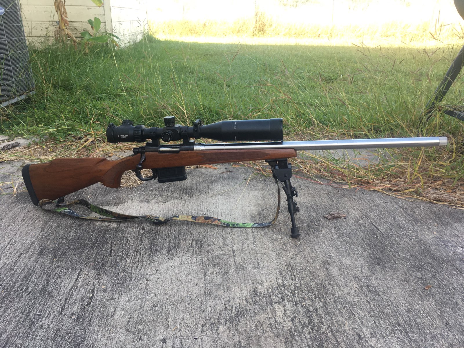

26 inch MTU should be here Wednesday. 1:7. I'm pretty big, I think I can carry it. Maybe I'll loose a little weight lugging it around. I carry a 28 in Remington 870 with a 9 shot tube and 5 in the saddle and a backpack for a little over a 2 mile loop, try to do it a couple times a week.
Its a straight 243, Hodgdon reloading shows about 2,900fps. I am going to get a chronograph in the next week or so.

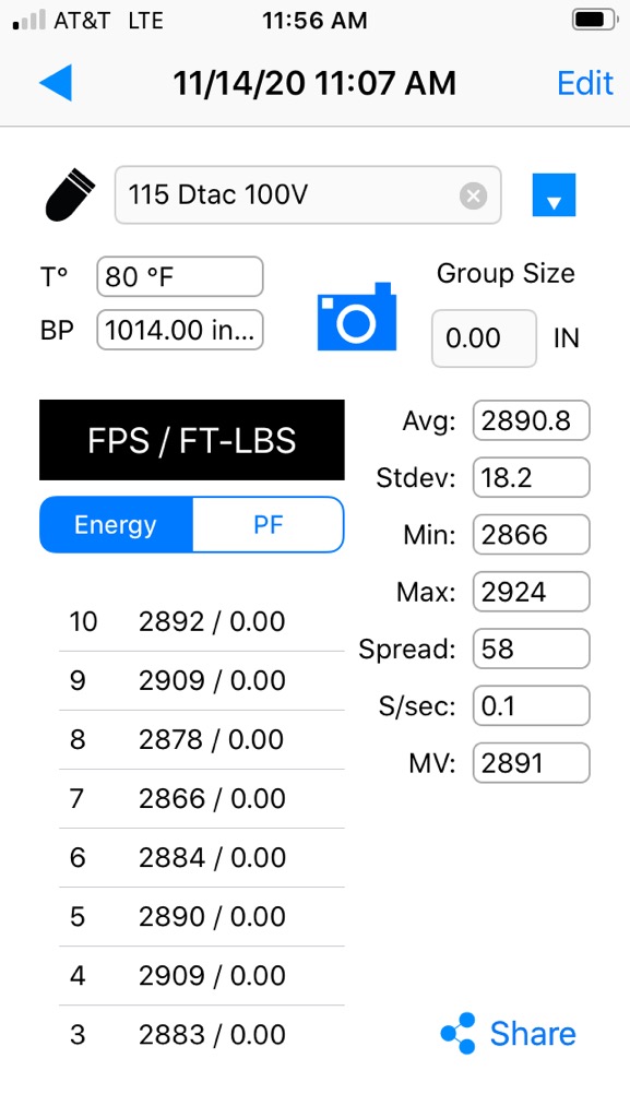

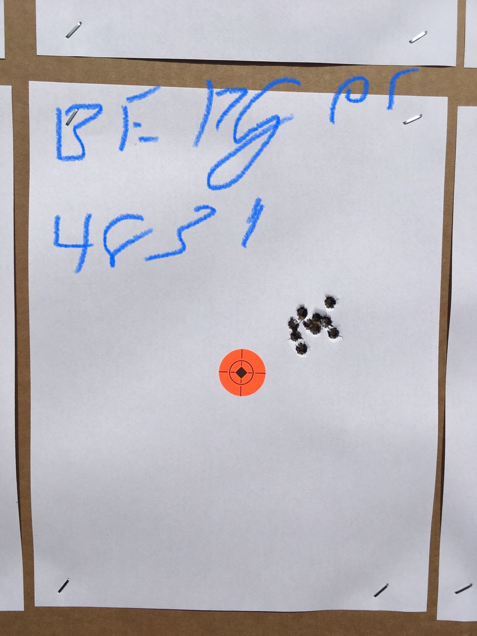

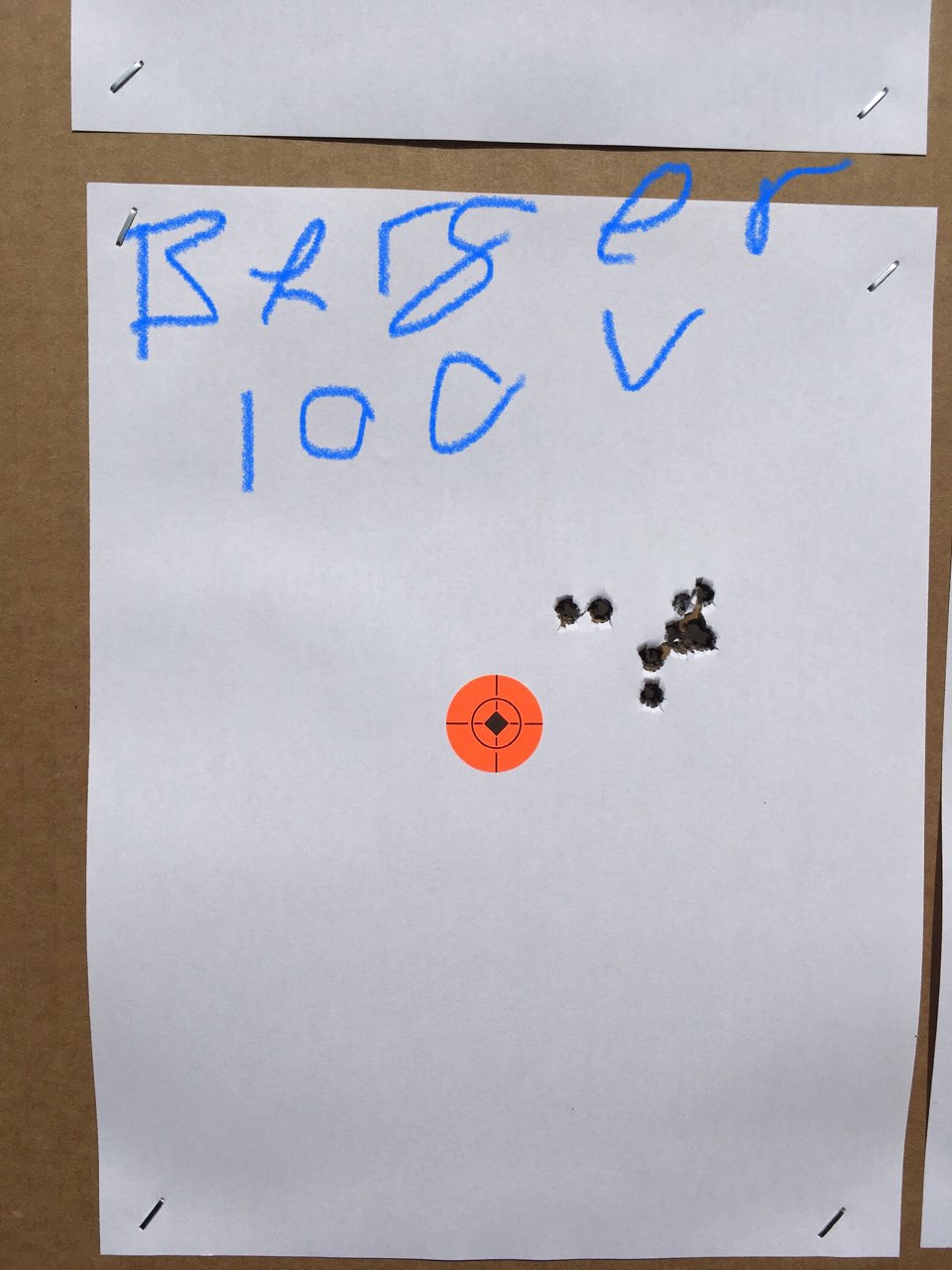

I didn't know if I should start a new thread or bring this one back up. So I just came back here.
The barrel has been on for a while and a few different loads put through it.

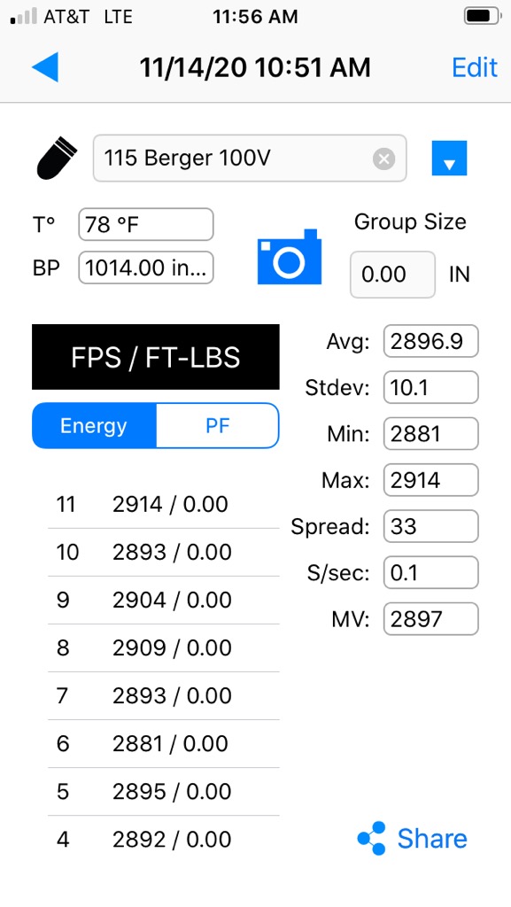

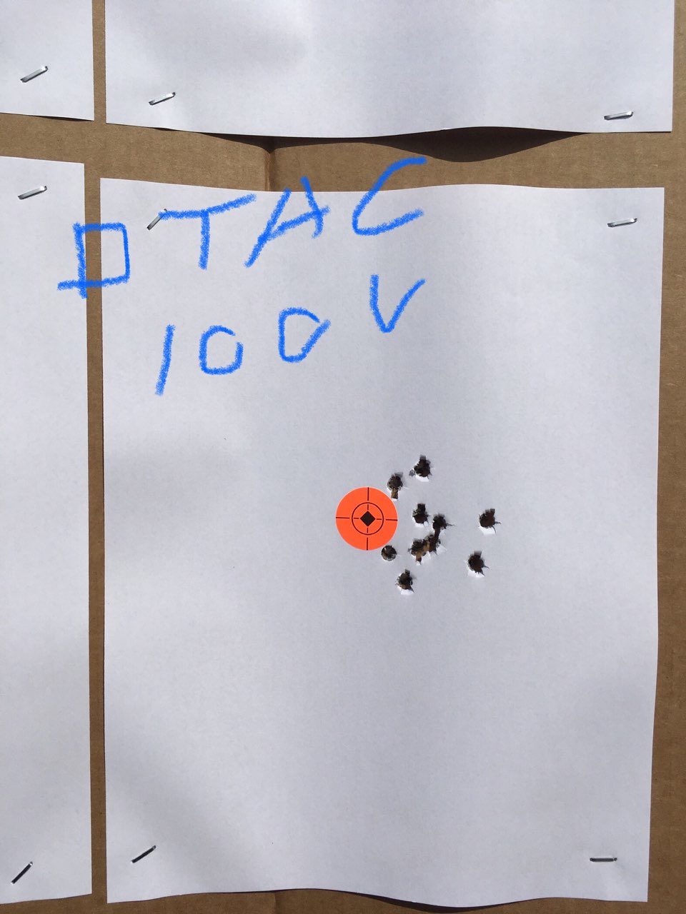

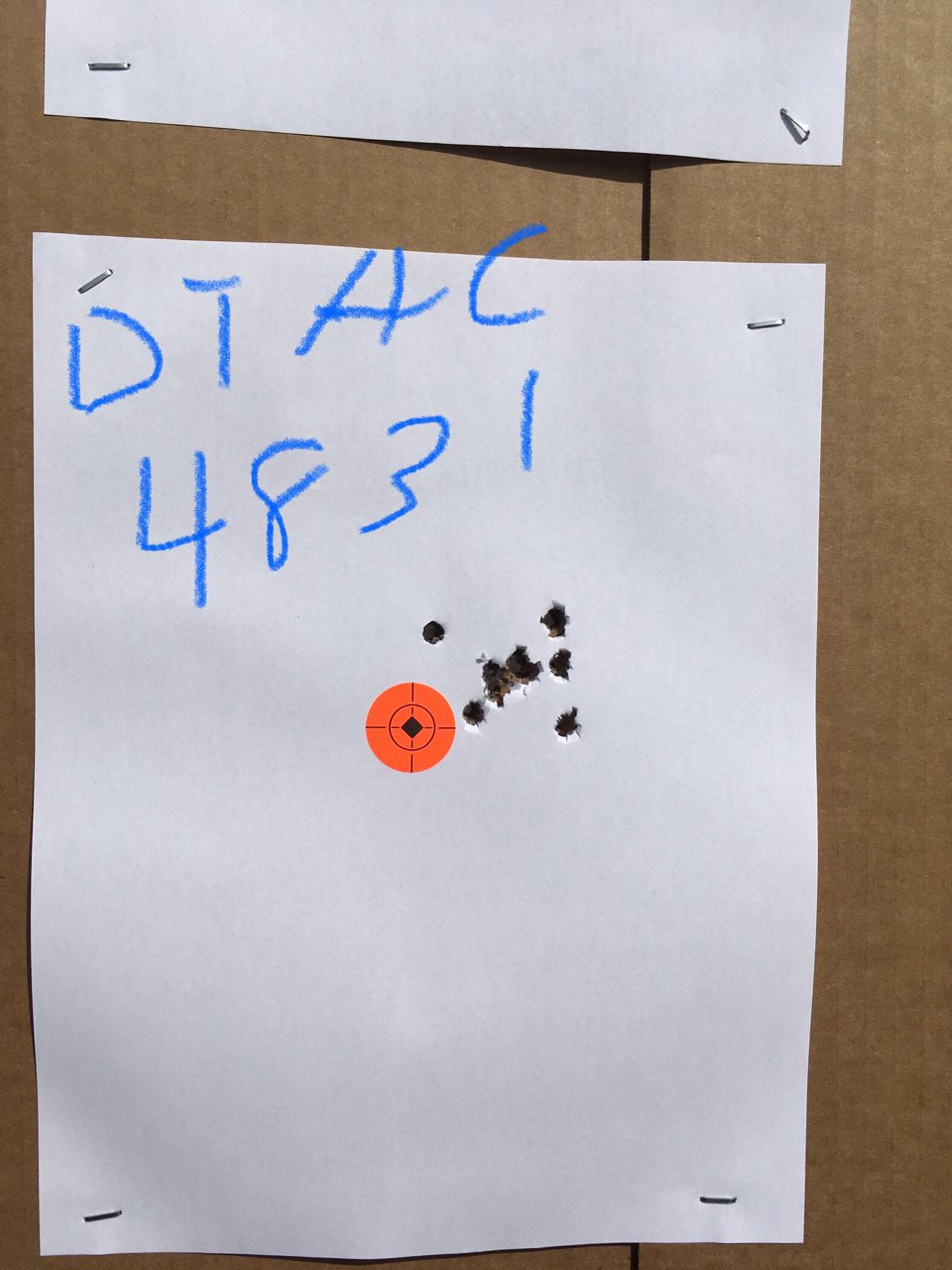

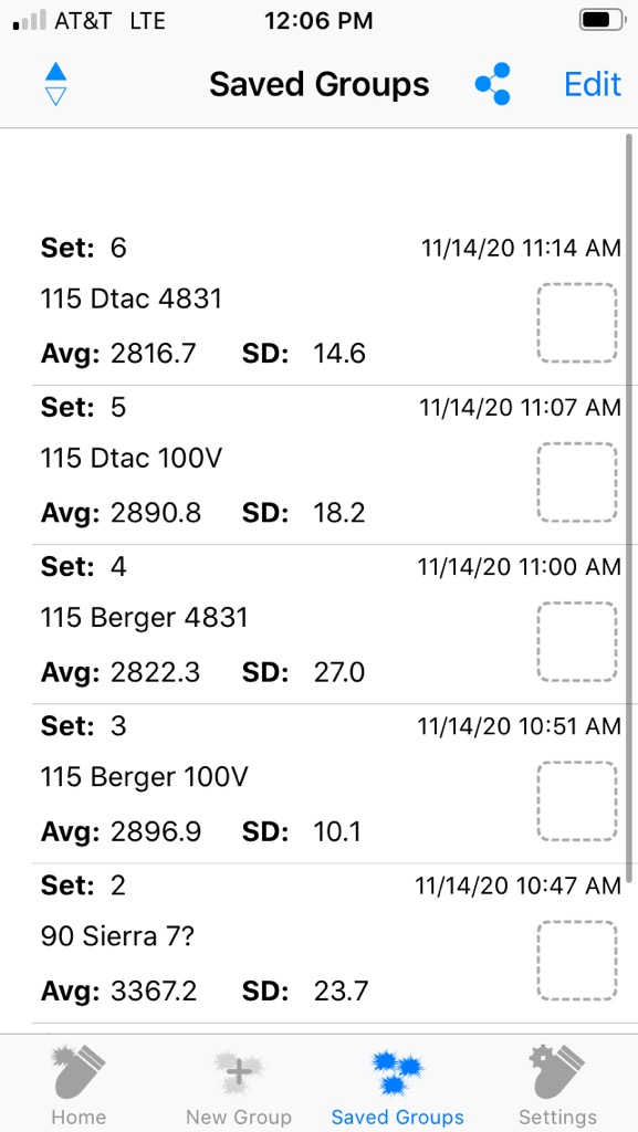

Finally fired groups over a chronograph. 115 Berger VLD hunters and 115 DTACs
Also forgot to mention
100 yards, 10 shot groups.
Prone on top of carboard in a freshly turned field. With a pool noodle rear bag.
Powder is a little hard to come by. I'm low on 4831 and have no 100v. So I put in an order for a 8# of 4831 at my gun club.
Also going to order 1,500 Bergers.
I'm thinking I'll up my charge a little and look for a little tighter group and velocity spread.
Also need to practice more and dryfire more.
41.0gr. Its IMR 4831.
The rounds are loaded to mag length. The jump to the rifling is HUGE. I think about .120. I painted the bullets black with a sharpie and shortened until the bolt slid closed easy with marks from the rifling in the black ink. WAY too long to fit in the magazine.
It will take a little more experimenting, but I think its going to be good.
