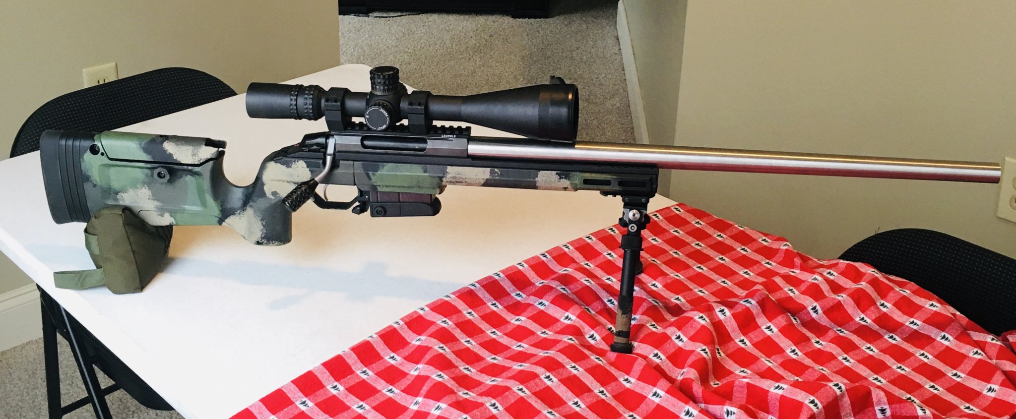

    Prefits are the way to go for Tikka’s as long as you can get one in the chambering you want. Your options are more limited vs buying a reamer setup exactly how you want. But you would be pretty hard pressed to buy a blank, have it chambered/threaded/installed for what you can get a prefit for. Fwiw I have two tikka prefits (proof) and both of them shoot absolutely lights out. When my current Tikka 6.5 saum barrel gives out I’m gonna grab a 6.5 prc prefit.

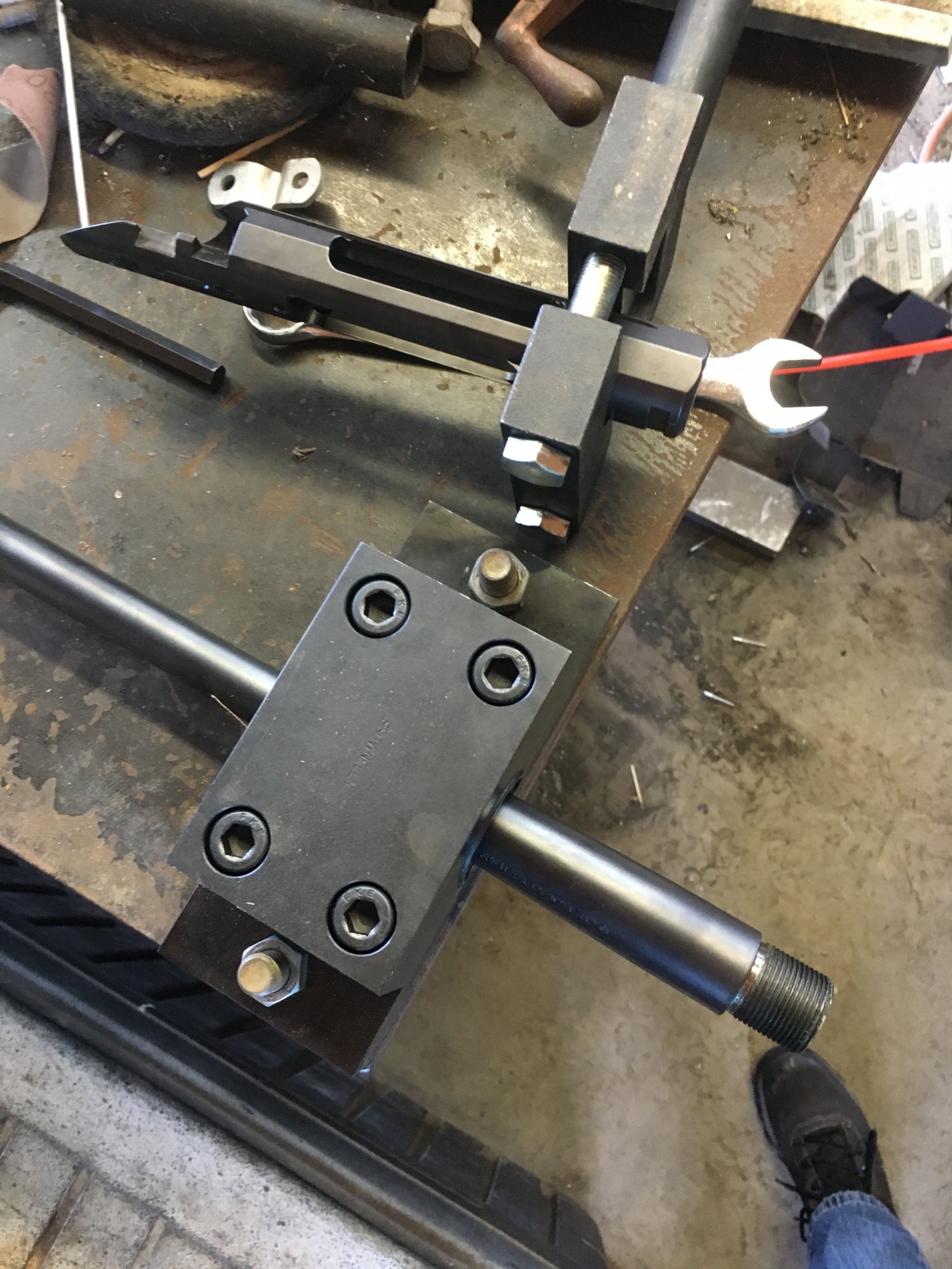

    I rebarrel them, it's not a real big deal. Worst case scenario the factory barrel has to be relief cut to be removed.
    I would charge $300 with muzzle threads. I have 6mm 7 twist Lilja in stock for $365, #8 contour 6lbs. I think I also have a Preferred Barrel Sendero 7 twist $265, 4.5lbs., damn good barrels for the money. Let me know if I can do anything for you.

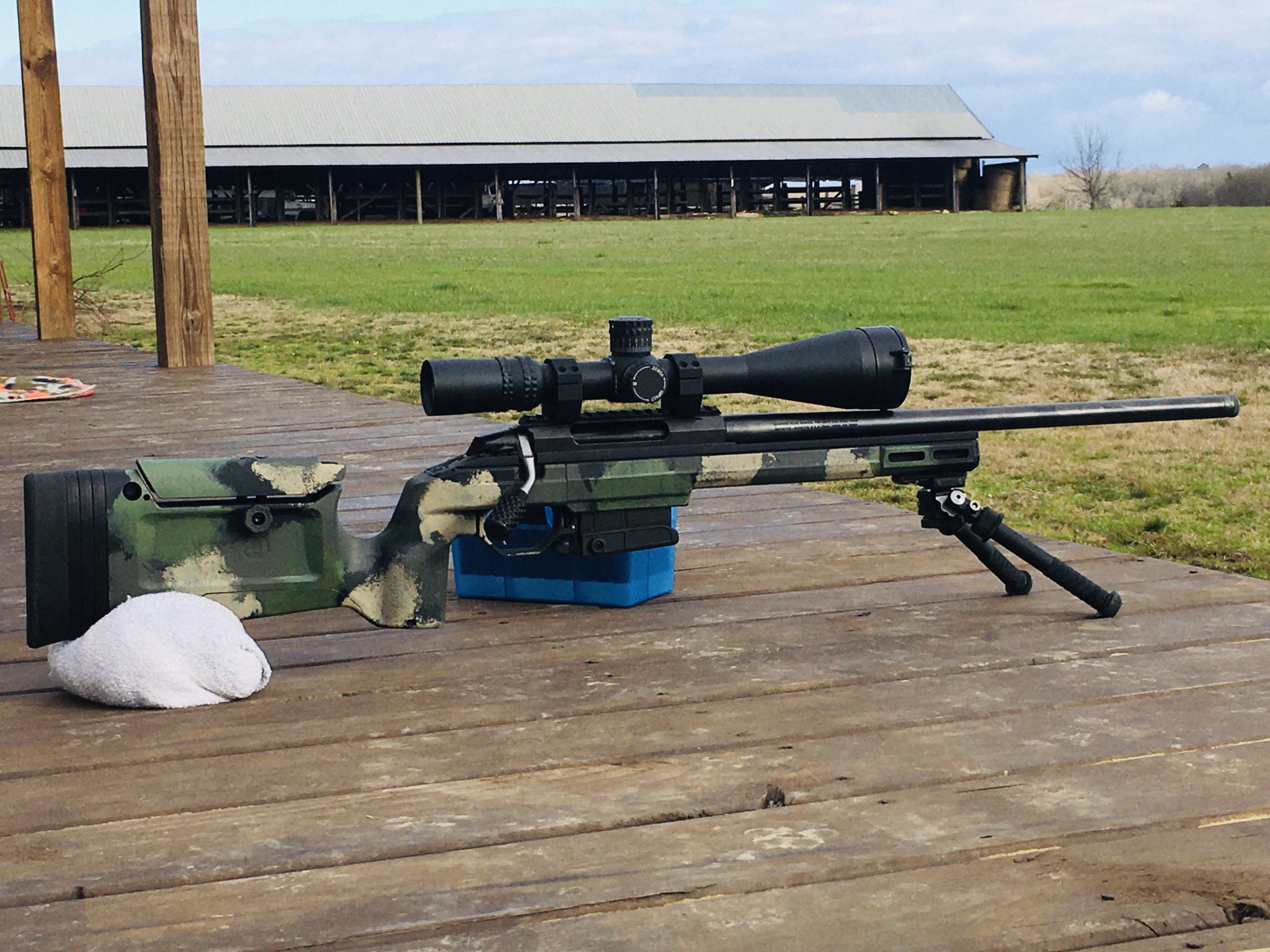

    Just went through this exact exercise.
    Stainless McGowen shouldered pre-fit $357 shipped and paid local gunsmith $60 to install it. Very please with the results.

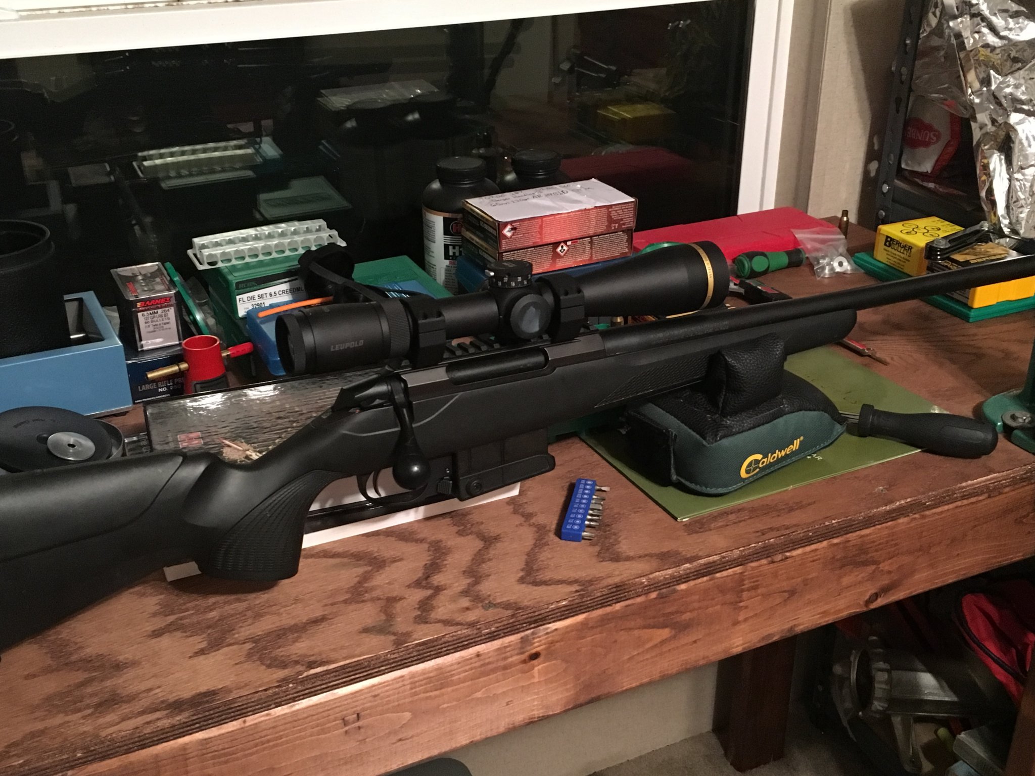

    I've done two Tikkas with McGowen shouldered barrels, and have put on a second hand CTR barrel on another. I used a Viper Vise mounted to a wall stud in my basement, an action wrench, and headspace gauges. Taking barrels off of T3 Lite models is a PITA since the barrel taper begins immediately at the shoulder.
    Cost of tools was about $75ish for guages, $65 Wheeler Action Wrench, and $75 for a Viper Vise.

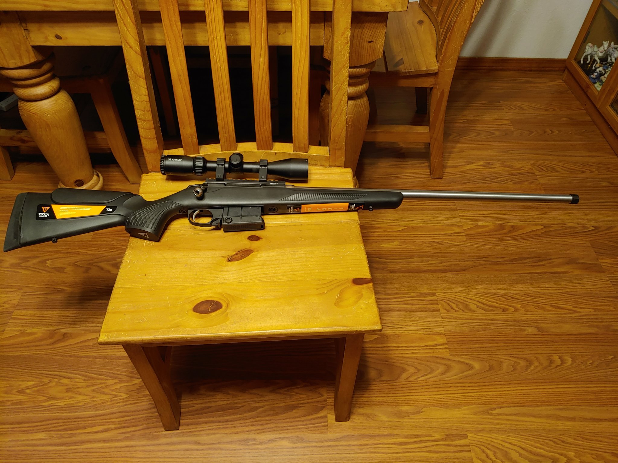

    I can attest to what you've said for shouldered prefits and headspace. I put a CTR barrel on one of my Tikkas, and my brass grew to fit. I only noticed when I switched barrels and put the CTR barrel on again, this time a bit tighter, and that brass was a crush fit now and I had to FL sized them a couple if thousandths. Virgin brass worked fine though.
    Last rebarrel I did, I sent another receiver to the smith and it headspaced perfectly on his first chamber cut. I've done a .260 AI and .223 shouldered prefit, and both headspaced fine. Freaking Tikkas, man.
