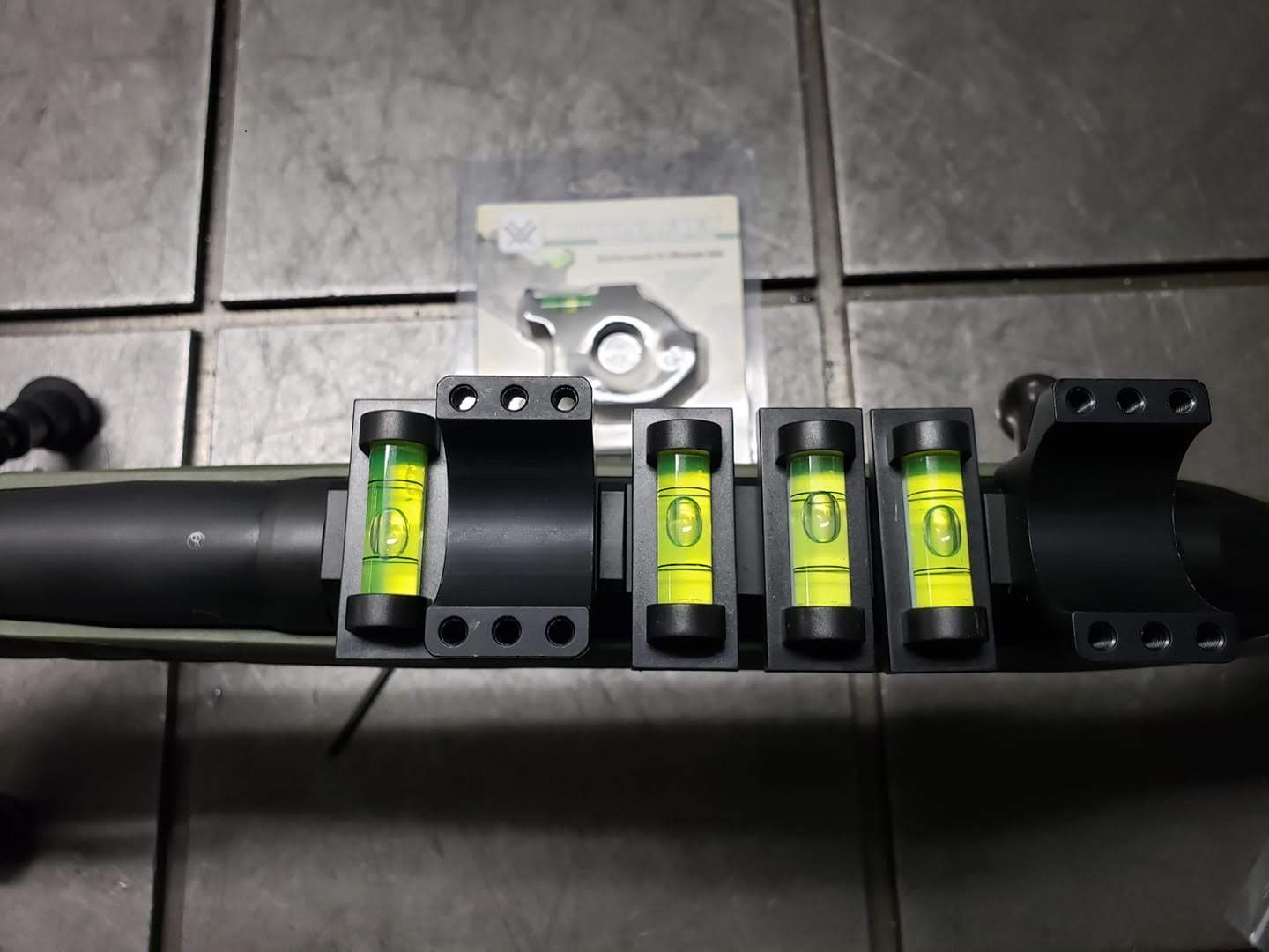

Real Avid Scope Leveling Kit
Flashlight
Bubble levels
Copy papper
T-square ruler

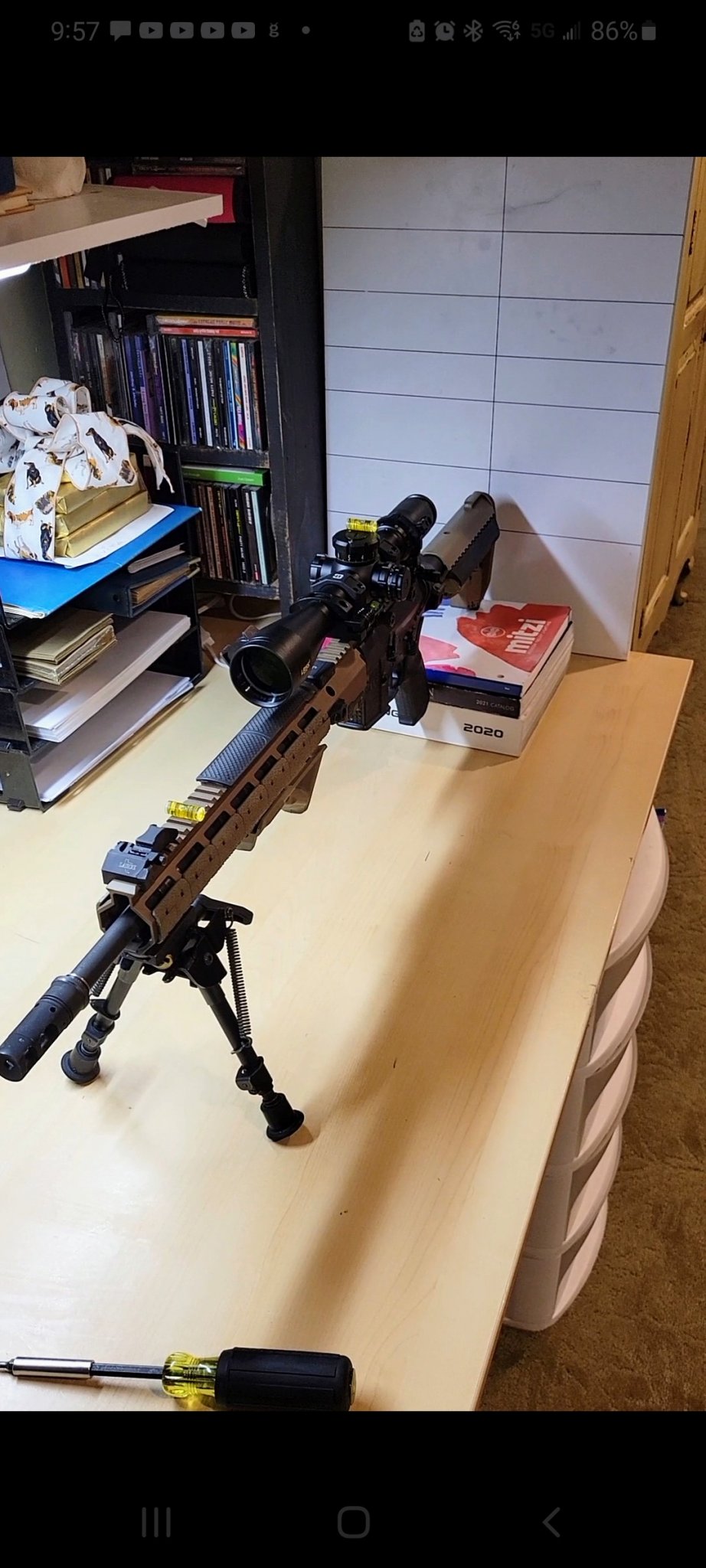

This member brings up a solid talking point. Body position and cheek weld need to be mentioned BEFORE you torque the scope down.
I highly recommend you try this procedure first.
Lightly torque down your scope so that it's in the ballpark. Get down behind the gun and position yourself with the buttstock against your shoulder. Close your eyes and place your face on the cheek riser on the until you feel completely comfortable. See if you're not stressing any muscles in your neck or your lower back.
Open your eyes.
This is the position where you will make your eye relief setting. If your eye doesn't lineup with the scope, adjust cheek riser for perfect alignment.
This builds a "Natural point of aim".
Then go and level your reticle. I've had great results with this procedure.

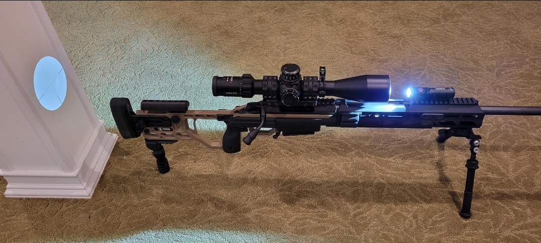

I don't understand. Can you unpack this a bit more?
If you shine a flashlight through your scope from the front to the back, it will show your reticle line on the wall. Get a plumb line on the wall and line the two up. I prefer getting in position and using a vertical line like a thick string hanging to line it up with my reticle with me in shooting position though.

I feel like this process makes sense for getting your eye on the same plane as the centerline of the scope and it would also help with getting the correct eye relief. However, it also seems like you could introduce a small amount of windage error if you don't have the centerline of the scope exactly above the centerline of the bore. Think of how an old SMLE rifle scope that is canted off the left side will hit to the left of the POA on targets closer than the zero and to the right of POA on targets farther than the zero (assuming a converging zero and not a parallel zero). This is an extreme example but is similar to if you had your rifle canted to one side as part of finding the most comfortable position and then you leveled the scope.
Reactions: TacticalPlinker
Sorry I should have been more specific. The flashlight and plumb line picture makes perfect sense. The copy paper and t-square was what I didn't understand. The way he presented the information made it seem like 4 things were required. Was he really just trying to show two ways of doing the same thing?
I think he was just using the copy paper to draw the line on
I'd assume the t-square was to draw the grid and a stack of copy paper/notebooks as in the pic to raise the butt of the rifle to the grid.
Yes. Read the comment again and the one he is responding to: You intentionally induce a tiny amount of error instead of accidentally inducing a bunch of error when you shoulder it.
Anyone ever use this thing? Seems pretty simple. I couldn’t find anything about it in the search.
Amazon product ASIN B08563G87M Real Avid Scope Leveling Kit & Precision Scope Level System, Complete Scope Mounting Kit for Mounting, Aligning & Leveling Rifle Scopes, Perfect Tool for Gunsmithing & Hunters

Yes. I do the grid pattern at home first with the flashlight. Then move everything outdoors for a plumb line at distance. Ideally a tall target test would be the way I'd prefer , but thats usually not available to do for me.

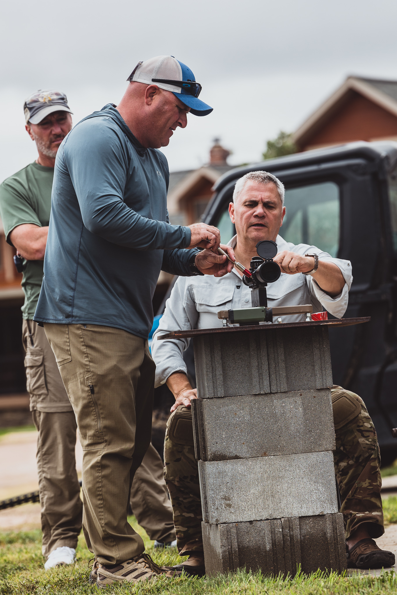

As a piece of history, information, whatever you want to call it,
We now test every scope in our classes, we used only test scopes in the PR2 ones, and now it's done in all of them.
Most people don't understand rifle setup, and this goes beyond just getting the scopes plumb on the rifle.
The reality is that manufacturers use the flat at the bottom, so if you match the Flat with the flat of the rail, you are probably 99% there; the final test is quite simple, get behind the rifle and drop a plumb line to confirm.
The leveling kits are a straight-up gimmick, majorly overpriced for what we are doing.

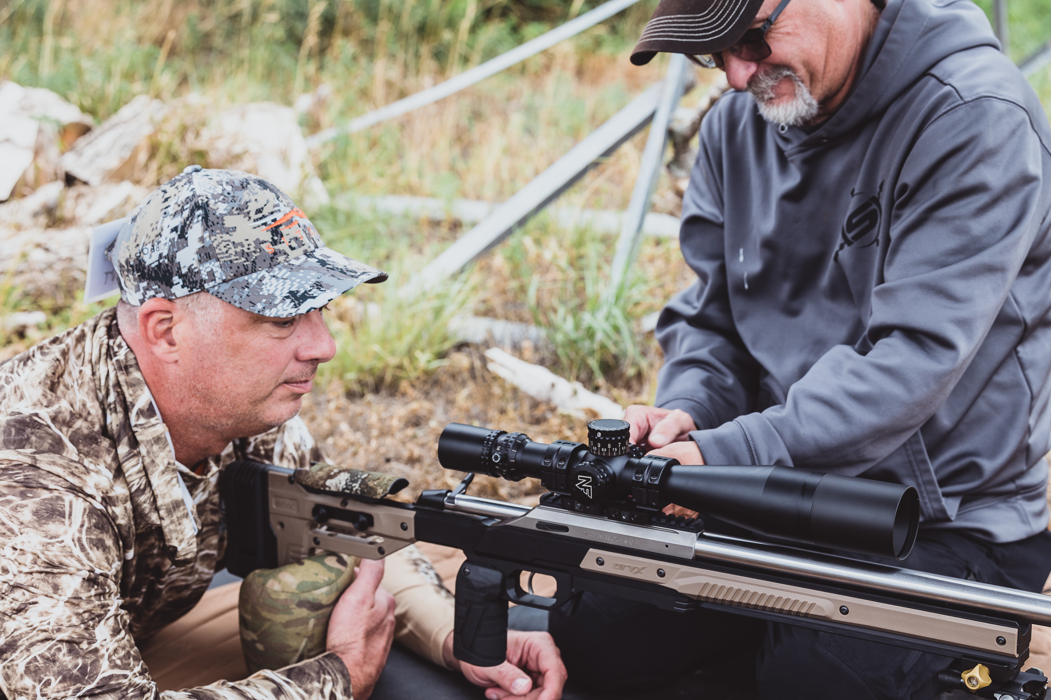

As someone noted, the bullet only cares about gravity, but how you set the rifle up matters, as that is one of the biggest problems we see. Students hunting for the optic, the shooter doesn't bring the scope to them, instead, they stretch to the scope. Once we remove the optic, check its travel and make sure it's not canted in the rings (More on this), we mount the scope with the shooter in place to ensure everything is correct.
Notice there is no scope on the rifle above we set them up first
Then we mount the scope with the shooter in place. Torque it properly and begin class.
In a 12-person class, we find that 1/3 of the students arriving will have the scope canted in the rings. This is not necessarily a mounting issue where the person doesn't know how to level the scope. But more of a case of scope rings biting the tube and pulling the scope over while tightening the rings. In this part of the process, the installer is not necessarily watching the reticle anymore. Such tools like the Spuhr Key help and the Business card method because it holds the scope straight when torquing.
We find the best defense to make sure the scope is correct is a Plumb line; it costs nothing and is about as effective if not more so, than the bubble levels. The bubbles suffer from the device it is being held in. Those devices are not well made and not calibrated correctly, as demonstrated in two posts now, mine and the other, where every level is "off."
Don't overthink it; make sure the reticle matches the fall of gravity, which a weighted string can tell you in a second and you are good.
The shooter should then set up the optic with them correctly positioned behind the rifle. Bipod and Rear Bag in place as if you are actually shooting, get comfortable behind the optic, and aim at a plumb line, End story
I use a construction laser level to true the rifle vertically through action and stock in sandbags. Then, I project a vertical across the neighborhood onto an unoccupied structure. Align verticals and tighten carefully to avoid torquing scope out of true. It works pretty well. I used to use a plumb line, but wondered about the rifle itself. The laser works pretty well but you have to consider if the stock has a cast to it. Bubble levels are ballpark at best.

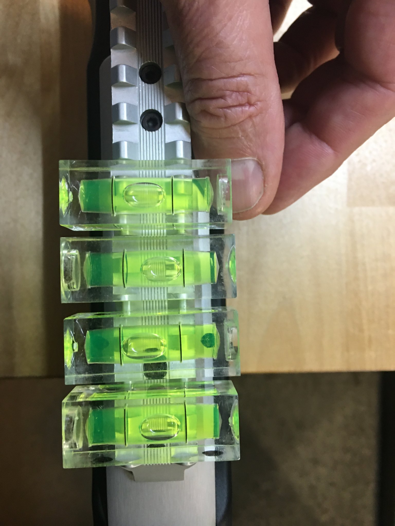

Seems kind of hokey to me. I just use a Wheeler scope levels and laser to rough it in and then go to the range and fine tune it.
I’ve got some bubble levels and Arisaka wedges somewhere but when it comes down to final adjustment it’s always plumb line and eyeballing it from comfortable shooting position. That’s what works for me. As HMFIC says don’t overthink it.
I bought one for my M40a1. I found it easy to use. I could not find a decent way to use the business card or feeler gauge trick on it. I also used it to checked my other scopes I did with a feeler gauge and they are dead on to it.
Is it over priced for what it is. Yes. Does the plumb bob work. Yes. I used Cabela’s points and nothing technically came out of pocket. It does work but like everyone else said I would use the feeler gauge/business card trick and it’s way cheaper.

That Starrett looks like a fine little quality instrument. How do you mount it to your rifle? I don't see a mount offered on it's Amazon site. Tks.
The Starrett level isn't meant to mount, is meant to replace the crappy plastic housing levels for the reference level on your rail or turret.
mm
This is correct. It's a multi-purpose level. That said, it is very precise, and this can give the impression that it is malfunctioning because you can't find anything to test it with that will center the bubble. That's because most things are not level.
Also, it is not a substitute for getting behind the rifle and doing the plumb line test. That is the ultimate test. I use it to get the rifle as level as possible on a vise before I do the plumb line test. Then I get behind the rifle and do the real plumb line test again.

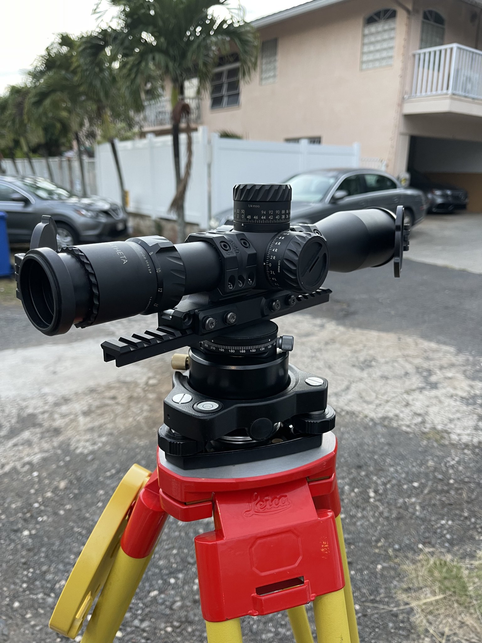

I sometimes borrow some surveying equipment from work to level my scope before lock down. And a plumb laser against my garage door right around dusk. Kinda overkill lol. On a side note, that 10 degree wedge that Spuhr provides when you buy their mounts is always spot on. No bullshit! I just don’t know why I still check it. Wth…
