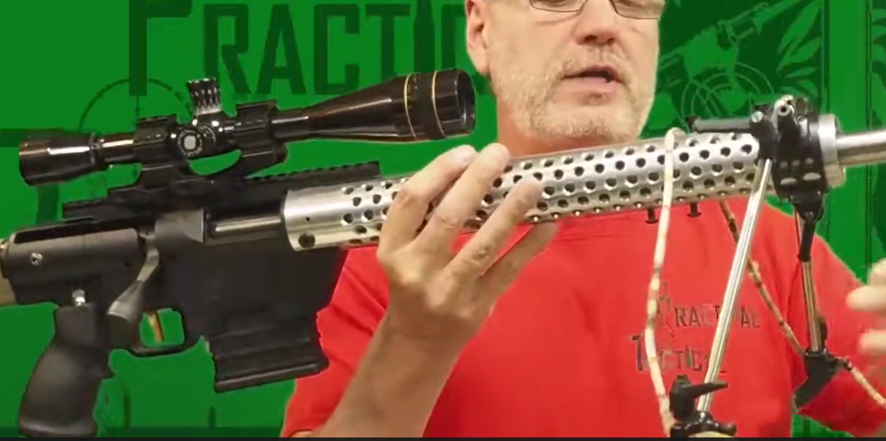

I hear you Diver... But let's not to throw the baby out with the bath water just yet... The principle can be utilized in more palatable ways for a more diverse audience... Like PRS.
I'm just kicking this out there as what I think would represent the maximum evolution of the concept.
Consider this picture indicating a barrel in the center with a two piece forend with the green outer sliding along the red inner hull and along the axis of bore via dovetails.
With soft silicone bumpers at the front and back of the dovetail the compressive pressure would hold the inner and outer forend system in place so nothing would rattle, but it would slide in either direction under recoil, but along a controlled axis.
The green outer sleeve attached to an Arca rail grabbing the barricade would slowly transmit the recoil to the barricade but not all at once like an Arca rail will do.
The difference being that such a forened would allow the rifle to track with many common bipods with raptor feet or barricade hooks and contribute to recoil mitigation in a wider variety of applications.
A forend like this could easily be 3D printed to try it out.
Just throwing this out there.

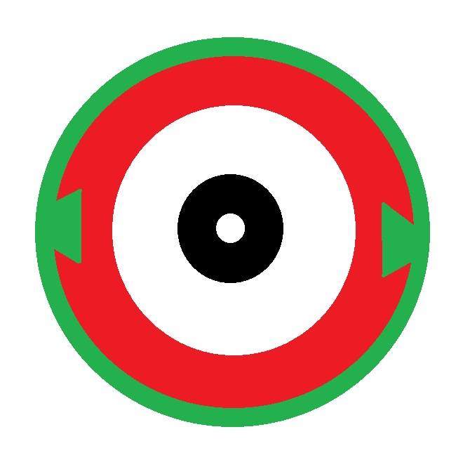

Here are a couple of screen captures. Come on look at that scope and amazing set of rings - he obviously knows things we don't even understand about precision positional shooting, that's why he isn't listening.
Remember that you need an AO (objective parallax controls) as it is easier to fine tune parallax out of each each shot.. It's silly we forgot that.

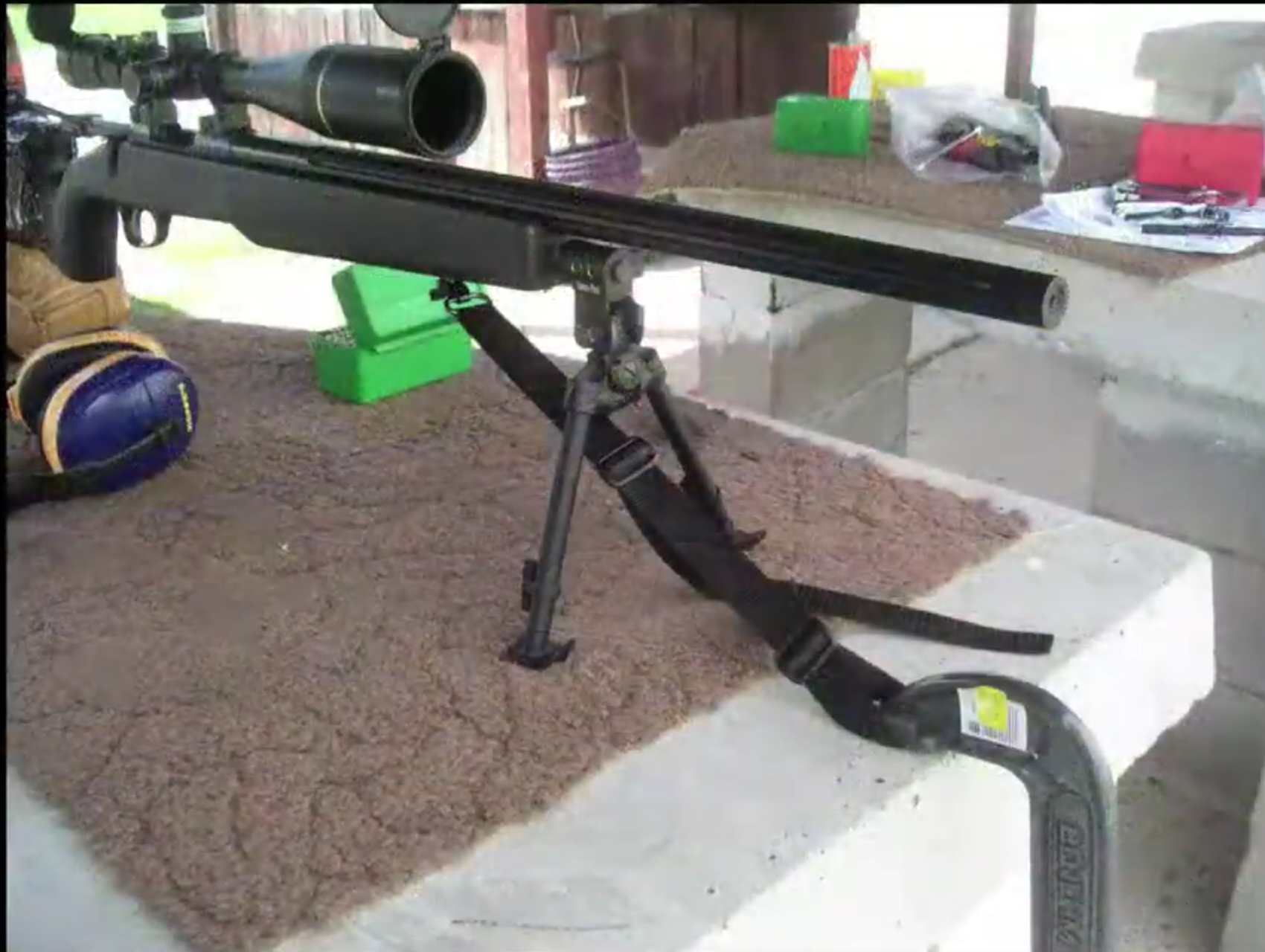

Has anyone seen slo mo footage of what goes on to the barrel, action and chassis of a light weight hunter gun when you stop the recoil?? It is very brutal and violent.. you'll even see scope tubes bend, much more so that if the recoil is allowed to move the gun somewhat.
Here is his newer video how he shows reverse loading and he upgraded to a Burris or borrowed a gun
Fast howard to 6:08 thru about 7:13.. I think he get as about 2 shots off. I can't believe the fidgeting and crazy trigger finger, much less how out of sequence he seems to manage the rifle.
