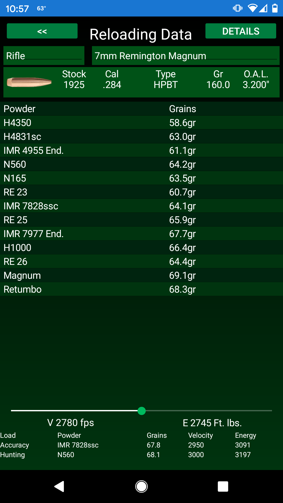

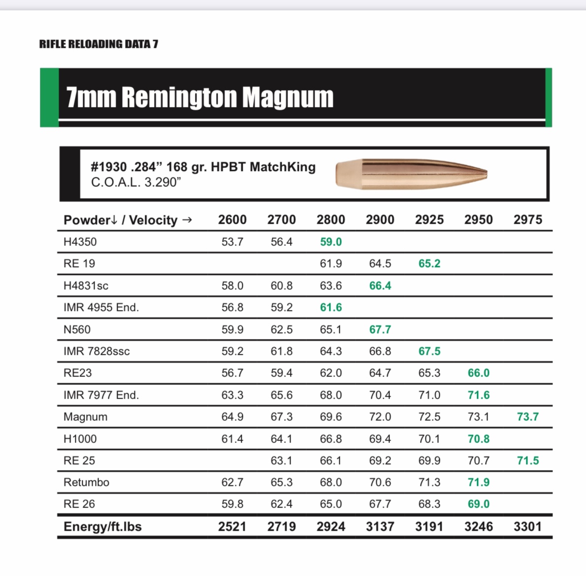

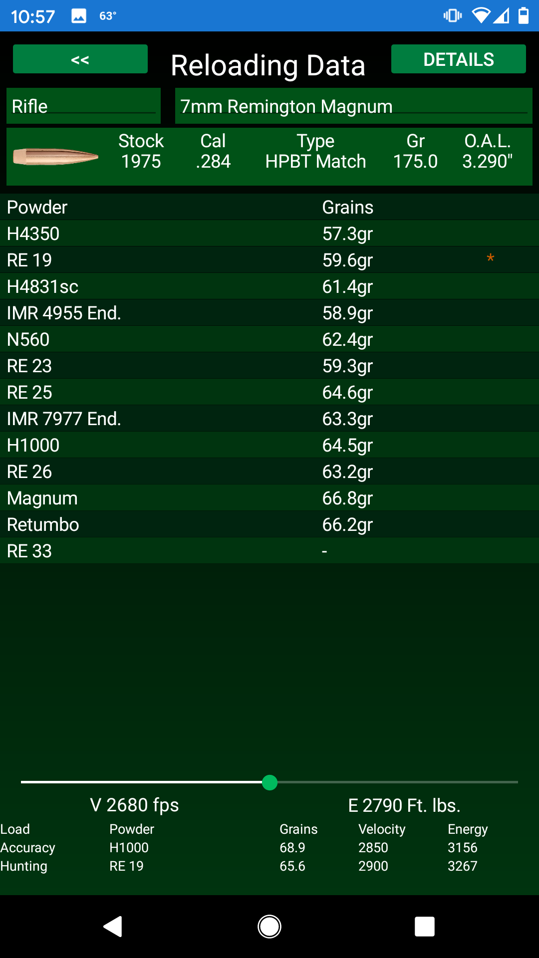

My manuals dont have RL23 and I've never used RL23 in my 7mm RM but I did find this on my Sierra App. Should be able to make your own choices from there.
Don't go crazy but these numbers are a little conservative from my 7mm RM experience. Modern Reloading by Richard Lee is a pretty non conservative load manual but it also doesn't have RL23. I would start a couple grains below what these pages show but you should be able to go a few grains past these numbers.
