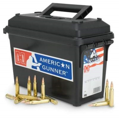

I’ve never shot the American gunner 140’s only the eld match, and the 140’s are usually more than the 147’s

the Hornady American Gunner shoot great, they have a low sd for off the shelf bulk ammo, seems like it was 13 on my Christisen MPR
