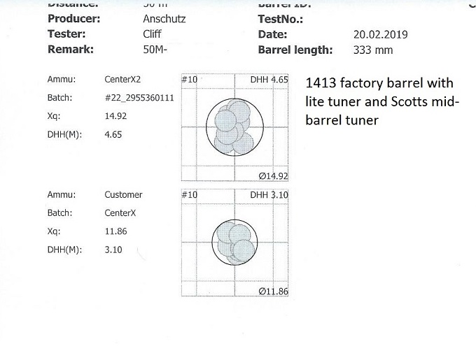

Even if tuners work, the amount shots required for a reasonable confidence level to determine the best setting is a lot more that what most of y'all are doing…. I think @stats_guy just dropped an app that will do these statistics.

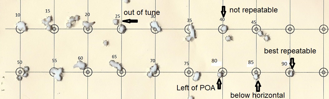

The minute barrel movements that produce a positive compensation tune aren't going to be detected in a video of the sort presented.
The amount of shots required to determine an effective setting is astronomically large if the shooter does not understand how a tune works. For those that do, I think Lee's estimate is ballpark for many, I'm a little higher but then I've got a good tune applicable to a case or two more of that lot.
