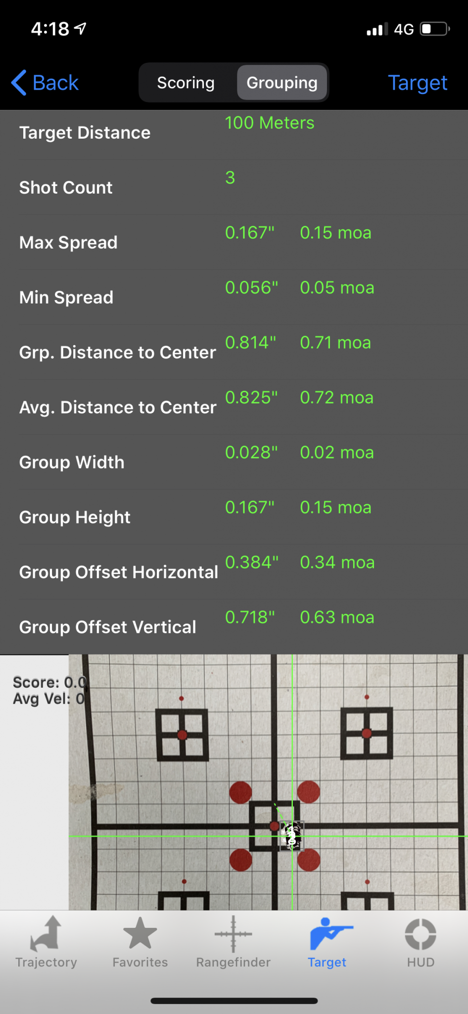

I ran 49.2 grains of RL17 under a 178 AMAX. Velocity was a 2710 out of a 20" Krieger and it hammered out to 1000 yards at sea level. During load development I had several 3 and 5 shot groups measure .3 or better. I had them set at 2.810 COAL. This was in Winchester brass and 210M primers.
