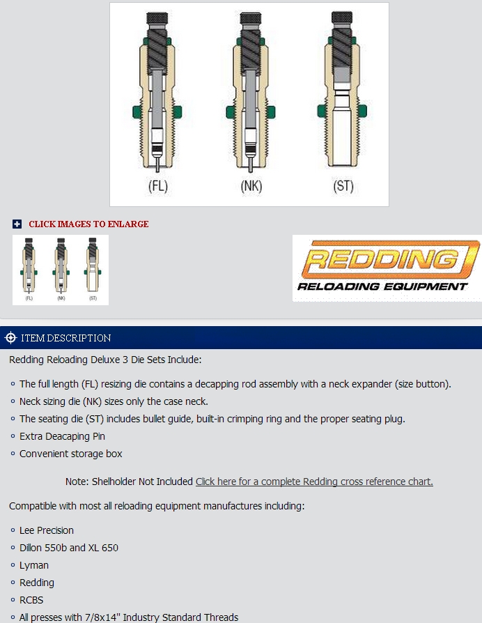

Okay, I've narrowed it down to these. Your input is appreciated.
Redding National Match 3-Die Set 308 Winchester
RCBS Gold Medal Match Series Bushing 2-Die Set 308 Winchester
Whidden Gunworks Bushing 2-Die Set 308 Winchester
Forster Ultra 2-Die Set 308 Winchester (National Match)
EDIT to add...I was just told that Hornady will make custom dies. Any thoughts on this?
You can't neck size forever, at some point you will need to full-length size the cases. If you are set on using bushings to control neck tension then I would go with:
Redding Type S Bushing Full Length Sizer Die 308 Winchester
And a Forster micrometer seater
If you aren't set on the bushings just go with the Forster 2 die set.
Short version: Redding and Forster seaters are outstanding.Yeah, none of that made any sense to me man. LoL
And check out this article on sizing: The Rifleman's Journal: Basics: Resizing - Case Dimension Changes
