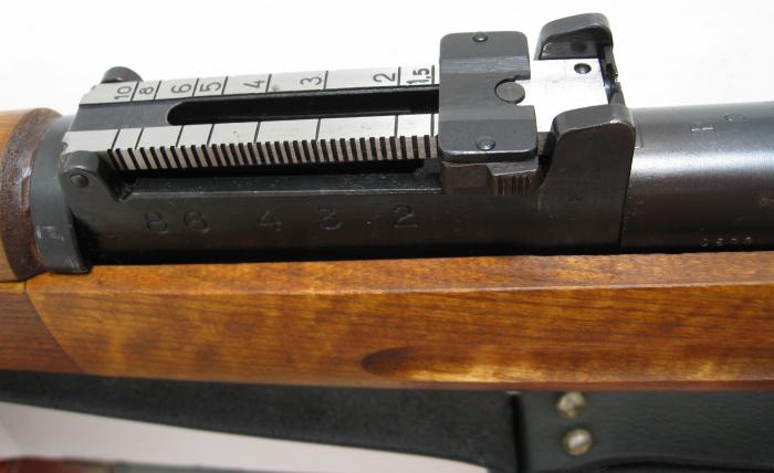

    I plan on tig welding up the numbers and right hand range elevation slots on an original m39 sight slider and recutting them to match my 175 gr 30-06 load and re numbering.

    Normally it would be really hard to tig but the M39 sight is really thick as far as sights go.
    I still see it twisting and/or becoming brittle. Even thick metal is challenging to do with the heat involved. If it is thick, wouldn't it be easier to set the sight up on a surface grinder and remove the numbers and then re-stamp? Steel would be nice and soft and un-bent.

    Grinding and restamping would be easier as long as I can make sure to not let the adjustable slider get too loose.
    From the looks of the slider you can just as easily grind the feet and tighten it back up. If you have access to a surface grinder you can work to tenths. And make everything slide very nicely. If you don’t have a surface grinder let me know you can mail it to me and I’ll just set it up and grind it for you some weekend.

    Thanks guys. Fortunately, there is a surplus of cheap parts for these rifles out there right now so it seems like the time to do it. I do not have a surface grinder but my friend does have a Bridgeport mill so that is an option as well.
    Fixturing it in the bridgeport will be a challenge, too. But, yes, you can do it that way. High speed and shallow cuts.

    Why not tig and grind the cam surface - leave the numbers as is, but change the profile of the ramp. All the alterations are hidden, and the visible parts look original.
    Just take it out, shoot it at known distances and file the ramp to suit actual impact at that distance, then fair the curve between the points. Seems much simpler and tidier.
    If you look at the setup, the cam surface is straight and the markings on the bar are varied, vs a weapon like an AK where the bar is regulated regularly and the cam surface is curved. The straight cam surface is actually better as it lets you change the bar out if you ever change the issue service load, which the Finns were doing at the time.
    The D166 load used was a 200 gr Lapua D166 bullet at around 2400 FPS.
    I may end up seeing if I can find someone to show me how to do the math so I can just make my own sight bars. I could have a few for different loads.
