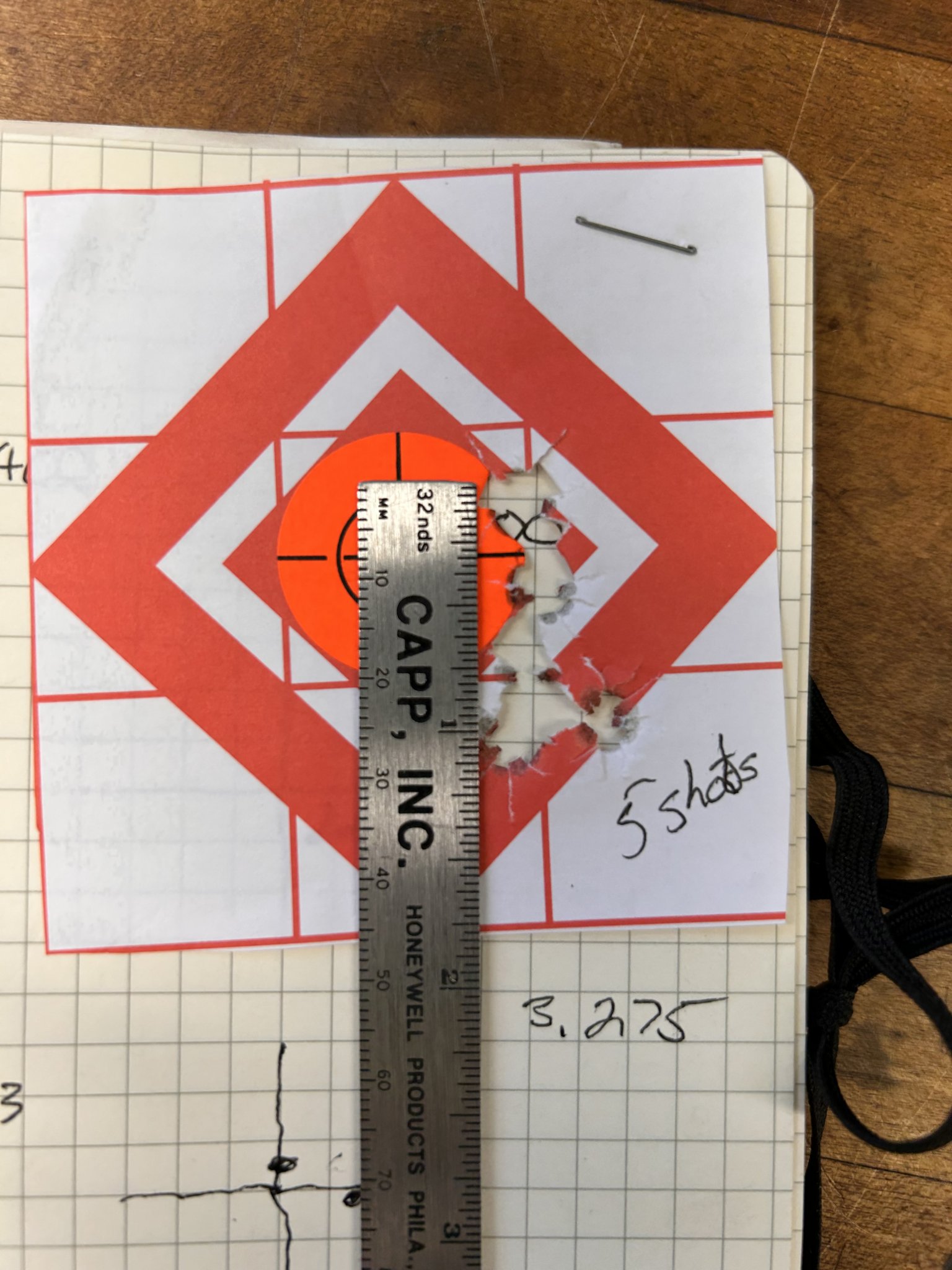

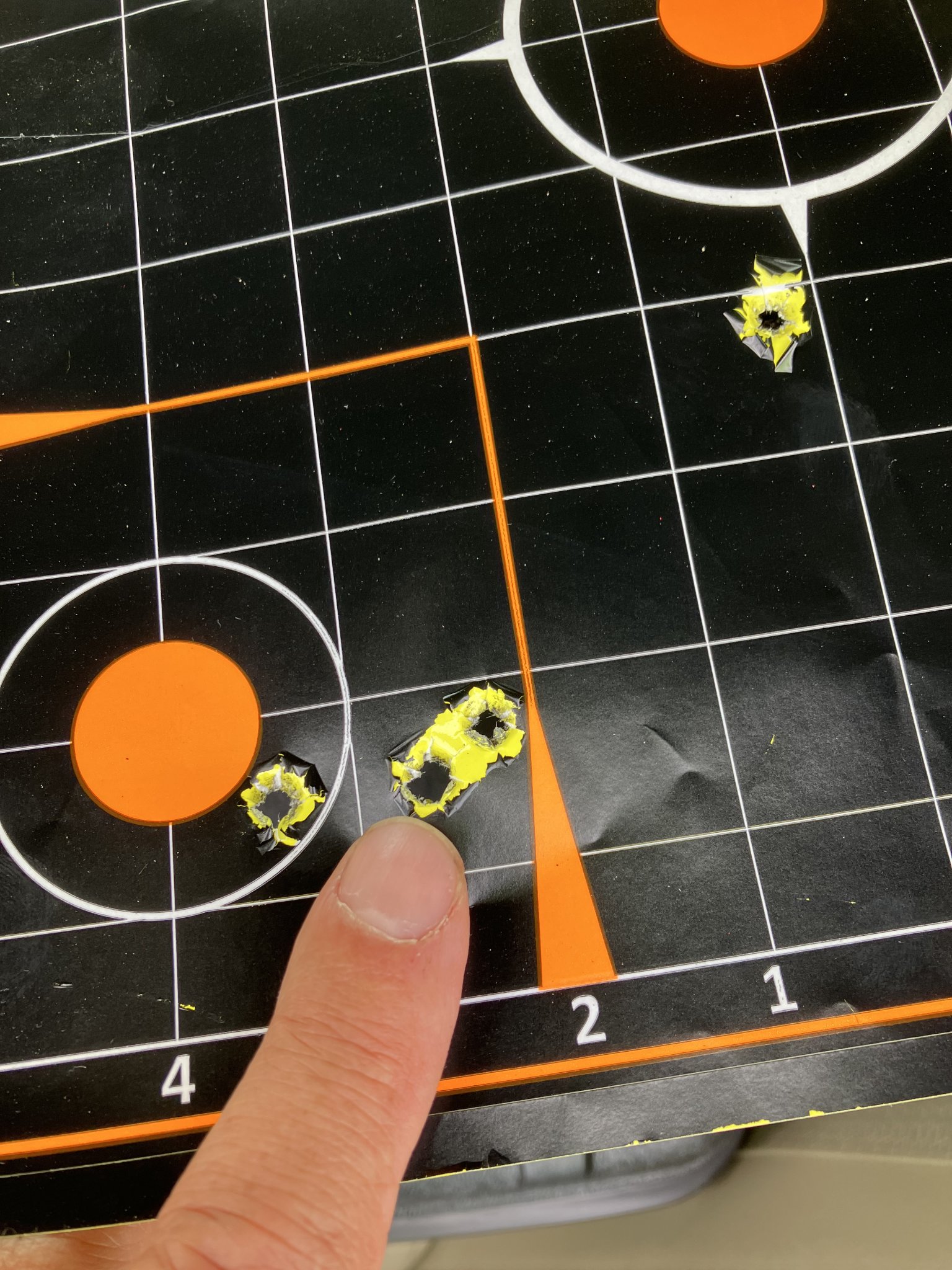

I have the new edition with H&S stock in 30-06. 06 because I’m already invested in 30-06 for my Garand.
Just started a break in procedure. A low powered hand load using 43gn 4895 and a 155hpbt did produce a 1 1/4” group at 200yds. The gun does show promise .

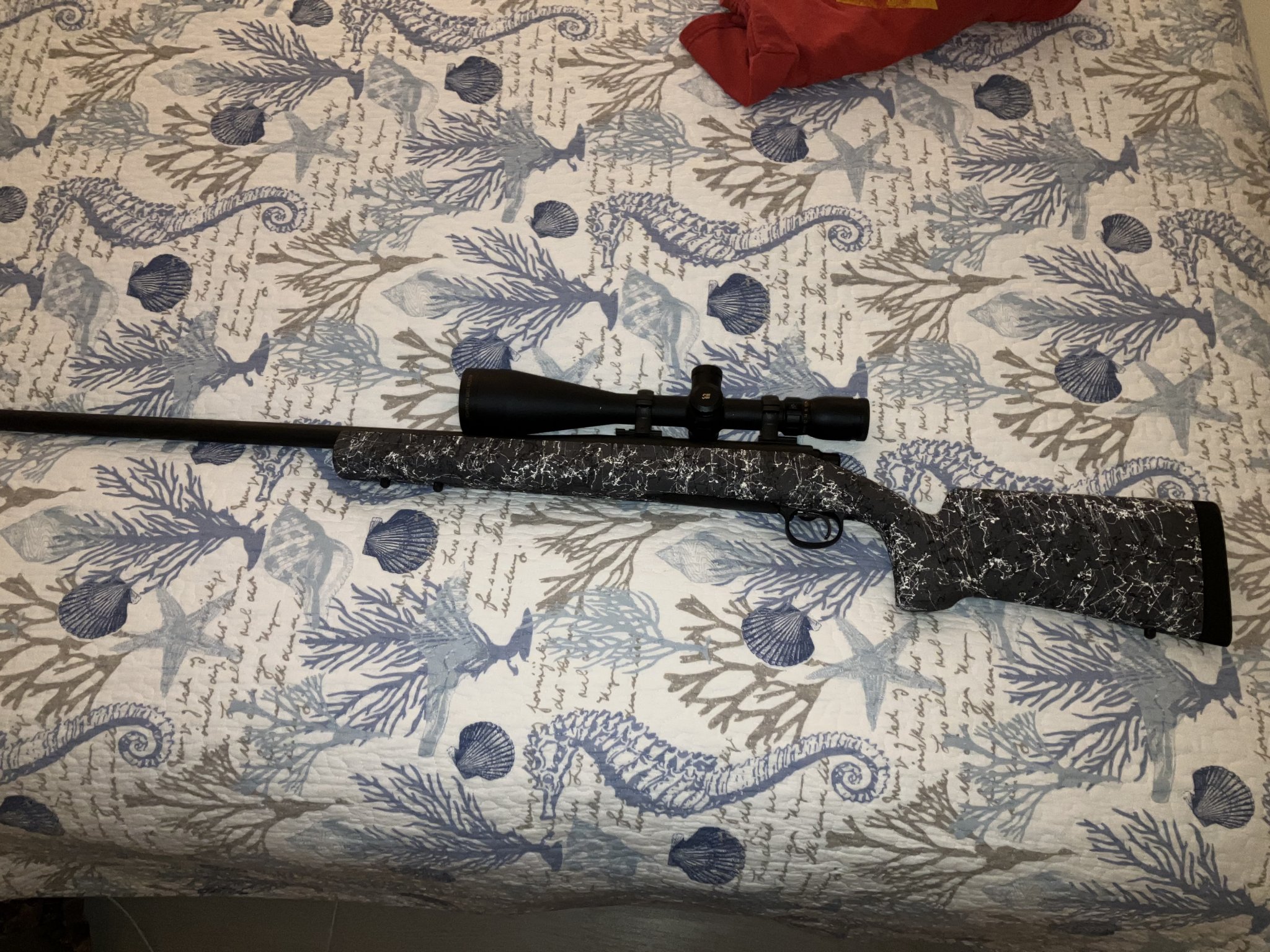

I too have been working with the Remington 700 Long Range in 30-06. Having been a Garand shooter I have about 2000 pieces of Lake City Match brass that has never been fired. I am working with W760 and Sierra 169 grain HPBT-C. I have not fired the rifle as I have a chemo-port in my right shoulder, so I rely on my cousin to shoot the rifle. We have the rifle shooting pretty good at 100 yards with 51.9 grains of W760 with a Sierra 169-grain HPBT-C. My next mod will be to replace the stock trigger with a Timney 2 stage (I like two-stage triggers.)
