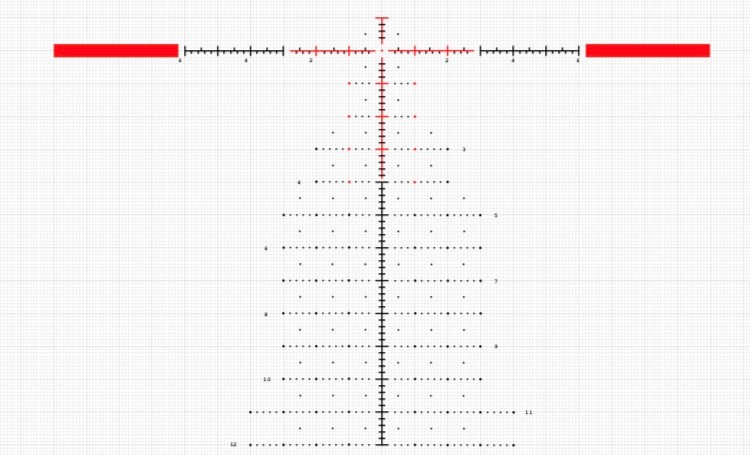

Gentlemen, here it is:
I like it as well,
.2 on the underside of the x axis with .5 holds above.
.2 the whole way down the y axis
.5 dots for inbetween elsewhere.
The inly thing I dont like is the alternating labels, 10 on the left, 11 on the right, 12 on the left etc but thats a minor quip in that its clear above 3 mils and if I were holding that much then I would be taking more time to look and make sure anyways.
